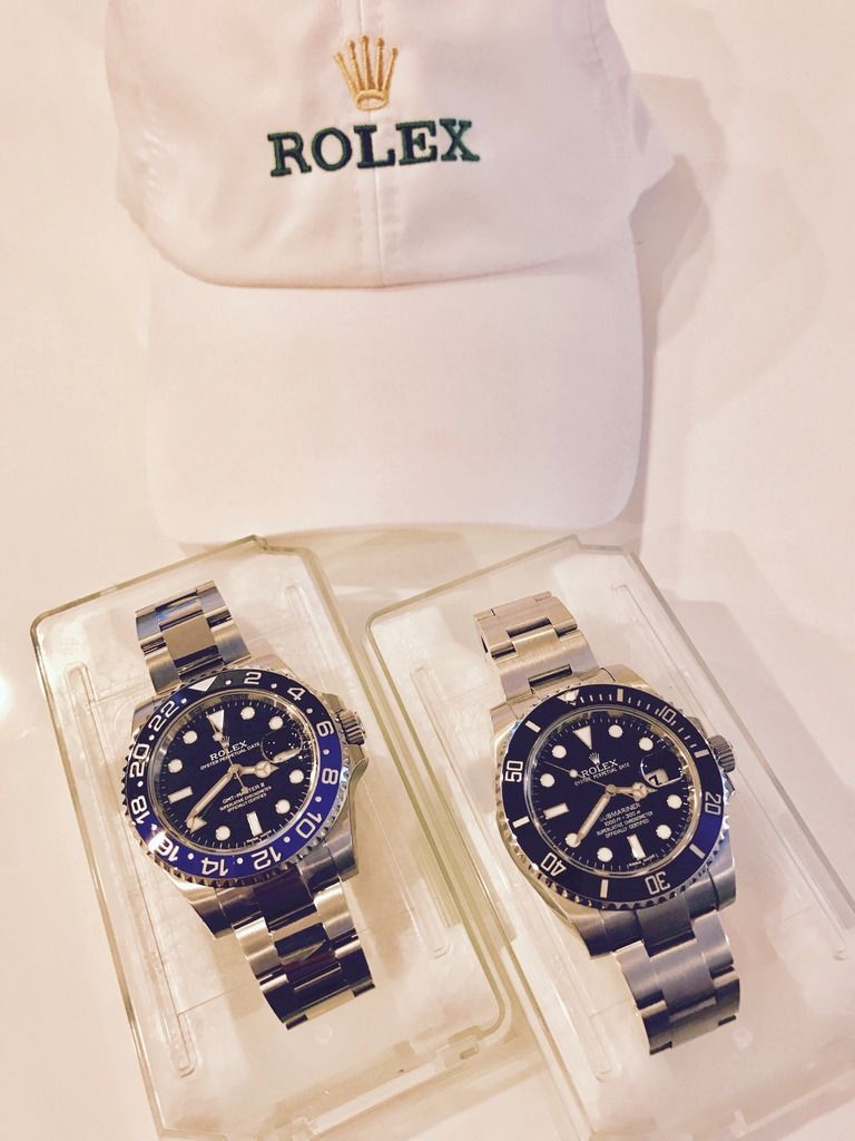

Thanks man, just got the blnr a couple weeks ago. I'm actually out of town right now and kept it locked up at home, here's the one pic i have on me right now, sorry for the quality and filter
the sub in that pic is my brother-in-law, we got them on the same day. and the AD gave us a hat. ONE hat for buying 2 watches lol. o well it was a good deal.
the silver djii is a bp v2. but when I got it, the bracelet felt like all the screws are glued down, and basically couldnt remove any screws. I actually had bought an extra bracelet, but that didn't actually fit the case! so i basically sent all of it back to make sure they can get me a bracelet that fits and actually works. actually there was nothing wrong with the watch itself but they requested it so they can see what their issues were with this bracelet situation.
Damn, nothing (including frankens) could ever compare to that gen Rolex shine and allure :D
They both look beautiful and it is always good to receive Rolex goodies and freebies - I recall seeing stuff given by ADs or Rolex private events over the years, like hats, bags, pens, ashtrays, swiss army knives, wallets... hell even Ralph lauren Polo Shirts with "Rolex" stitched onto it lol

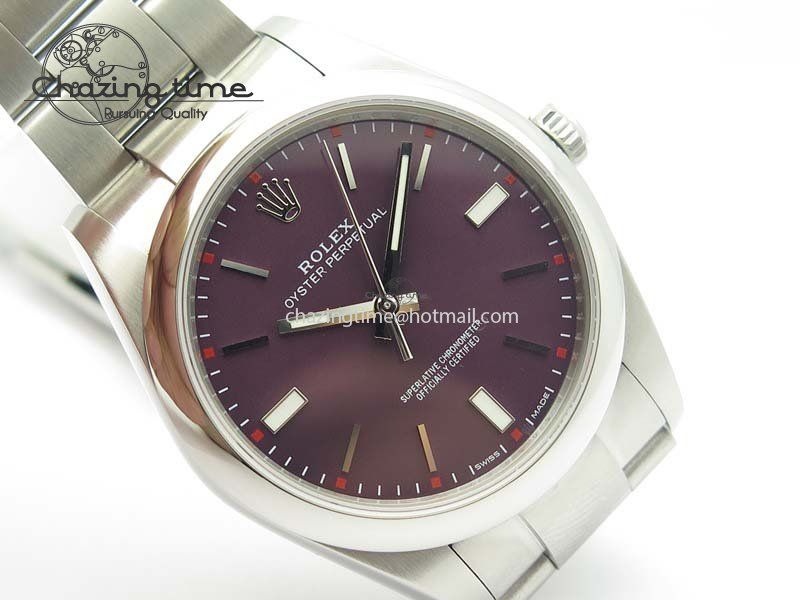

What a great review! Not much of a datejust fan but i love the thread and the work you put in the watch.
I tend to stay away from all watches that have a metalic dial coronet. I am too suffering from severe ocd :) .
The only dial i find somewhat ok is this :
Still off but better than many imo.
Nice info on the movements and stem height. I also think that a correct crown position is more important than fast date change.

haha thanks! The picture of Oyster Perpetual purple dial can be ordered with 34mm or 39mm. They both use 2824-2 so the crown height would more accurate like gen as well. But I wonder which factory are they from.
