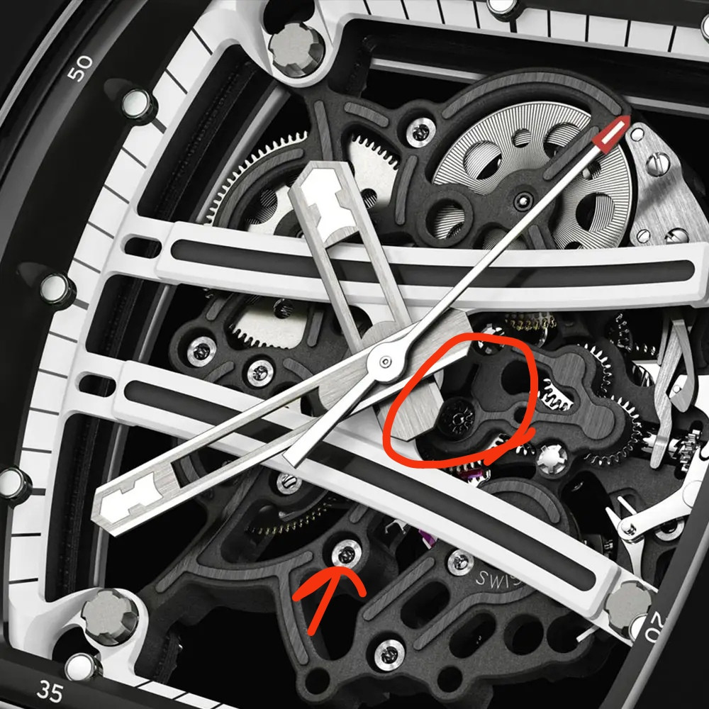

All this hard work and amazing release, it's a pitty to have wrong this details
Next to the hands, that part of the ribs is absent
And they need to add this cap silver rings
I will leave the missing extension at the back down right side of the ribs as secondary
Balance is ok, I don't expect from a stock one to have free sprung

It's funny, you don't often see the clone version have more skeletonization than the gen, ha. Also odd is the previous version of ZF on the 55 doesn't seem to have that fault.
I definitely agree on the silver rings (I'm assuming they are threaded inserts for the screws on the other side). So many cheaper versions of this movement have that, but this and the APSF versions keep forgetting those and it's a huge tell. It just looks like stuff is missing, they have a bunch of empty holes.
Luxury watches have considered details and nicely finished parts. For me, if something is inaccurate, I at least want it to look considered. So the rib not being there? Eh, fine. But the holes instead of inserts is just weird, and the caked on paint on the back side of the ribs looks cheap.
But wow, they really nailed the front side ribs on this version. Looks as good as the 15k versions people have been getting, in that regard at least.
