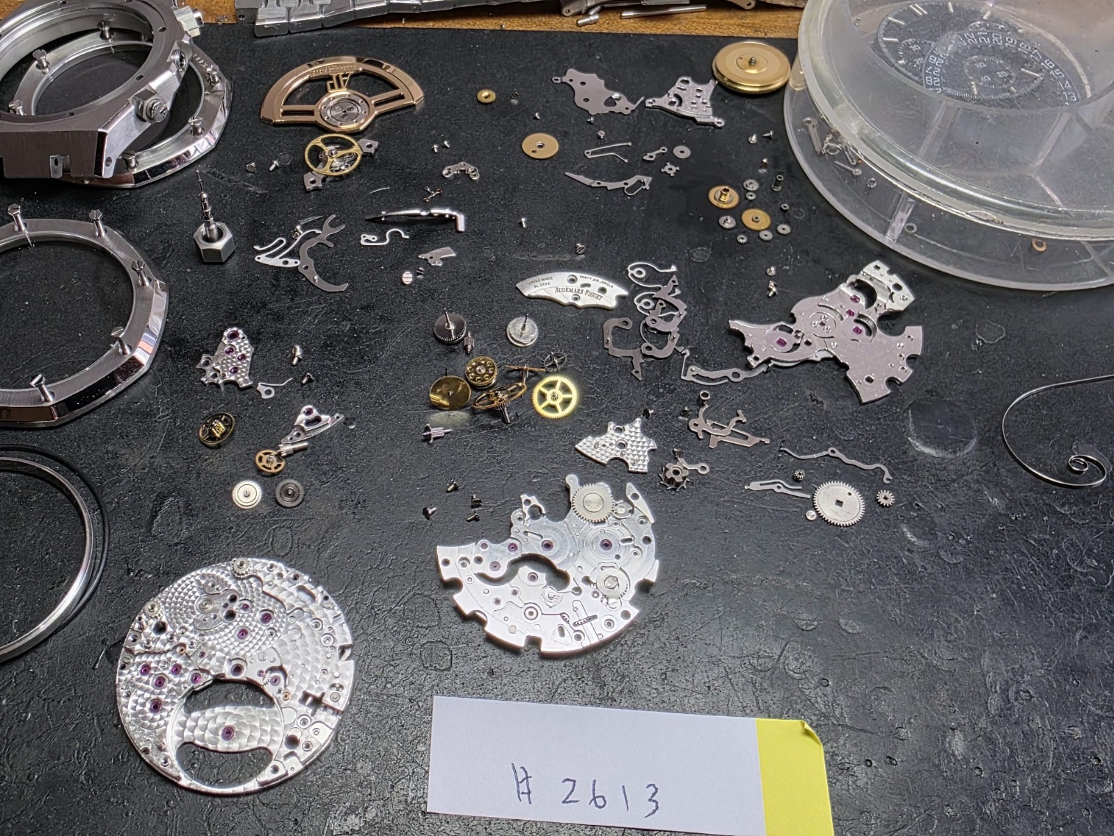

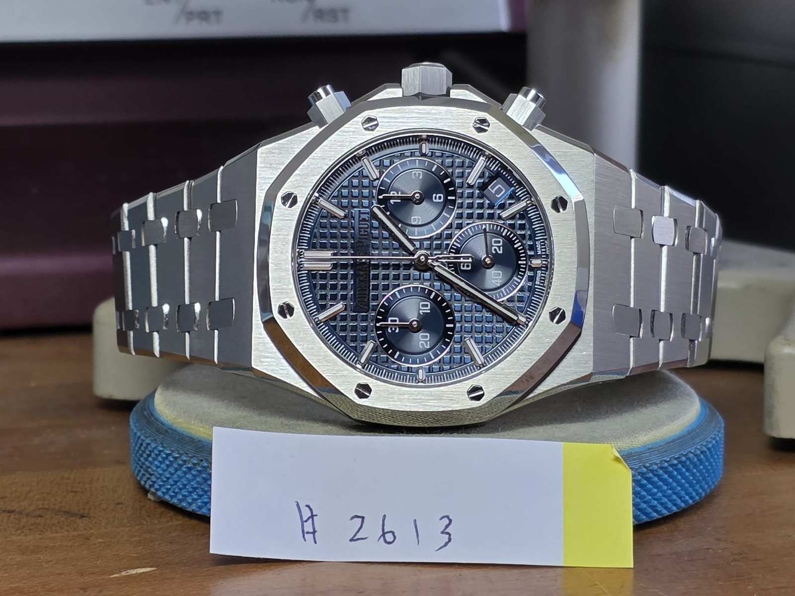

Out of curiosity, how could you sort the customs issue out?
Thanks to @legend I got them proof that the watch was there for repair. I told them that my son threw it on the wall and the dealer asked for a lot to repair it.
Also the packaging had this number on it (2613) After they saw the pictures attached, they believed me. Especially because the pictures also had (2613) on them. So they were convinced it’s the same watch.
legend, the legend with legendary builds... what a beauty @legend did i mention legendary?

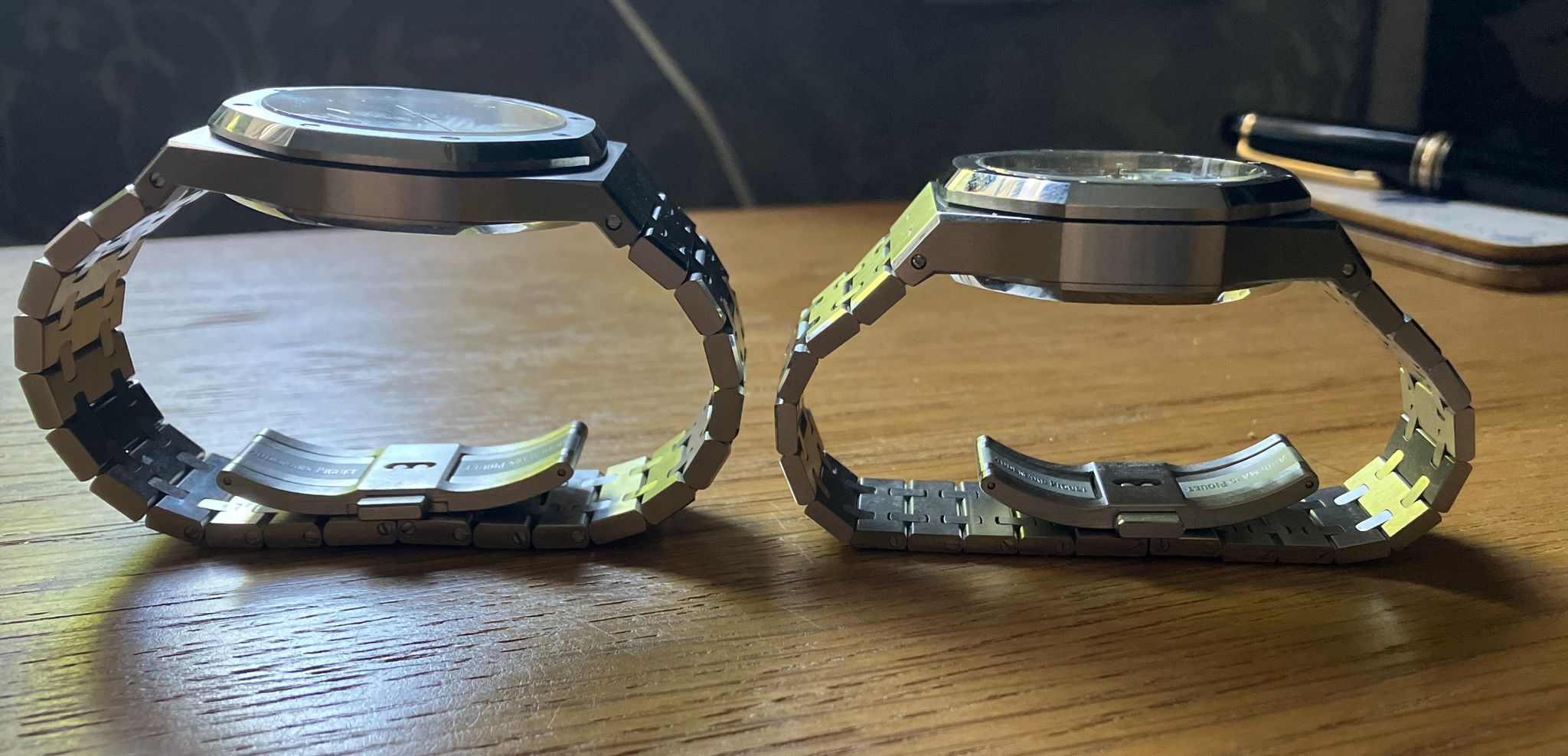

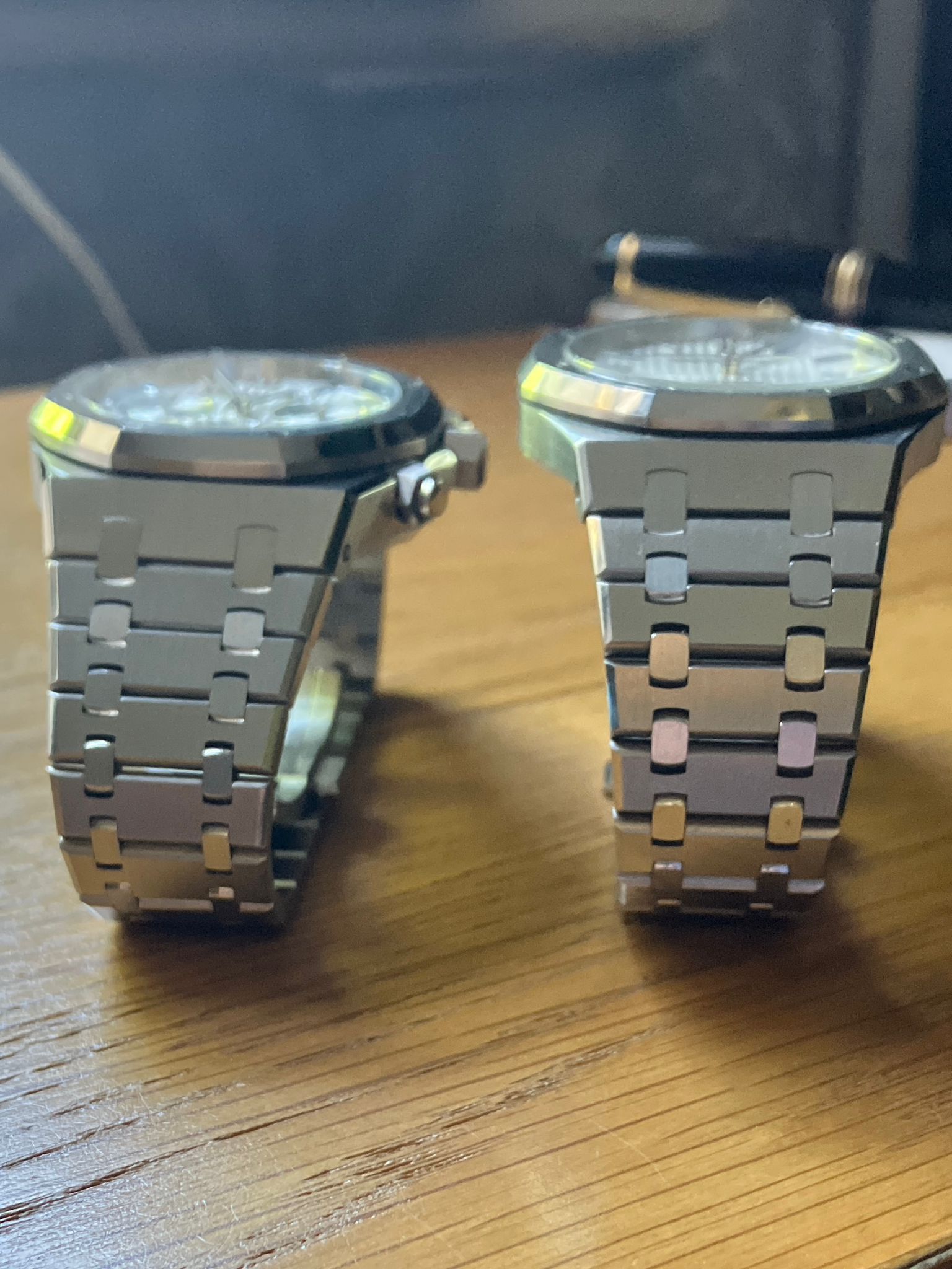

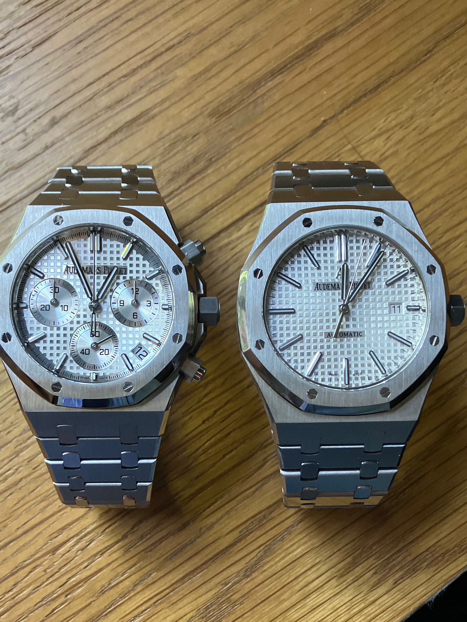

with the thinner bracelet the APSF chrono sits much lower than the APSF 15400. Both of mine very comfortable, no complaints. Visually I think the 15400 looks larger face on
Since you have both do you mind swapping bracelets between them to see if they fit? Really want ROC bracelet on my 15400.
