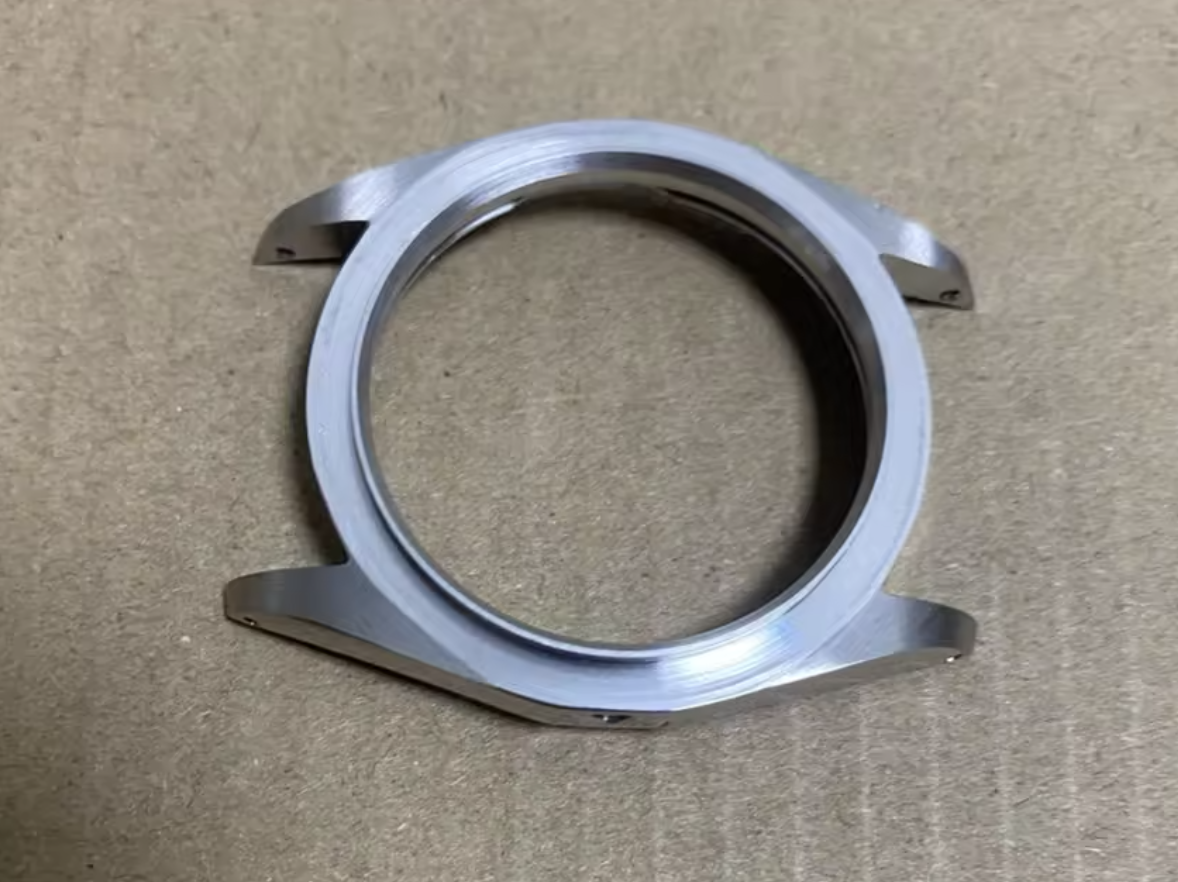

Gentlemen, drvintage suggested this may be of interest to some...a somewhat different take on the drvintage 16000 Datejust case.
Drvintage 16000 mid case
Gen Rolex crown
Gen Rolex 16000 case back
1016L 1st rendition T22 bezel
top flight Soprod Newton P092
Gleave T22 domed crystal
Markiemark Italian 78790 band
Marathon issue sterile Tritium dial
1.8mm high Cousins second hand
Fat 2mm springbars with pivots slightly tapered to fit the drvintage 1.1 mm springbar holes...they absolutely do not move or flop about.
Raffles 2mm endlinks...fit like a charm with no adjustment.
The Tritium dial I made up out of two old Marathon dials that I have owned for a number of years, it is probably worth noting that the movement holder/ring from the Raffles 34 mm case set fits this case just fine as the Marathon dial fits the drvintage dial seat like it was grown there.
I will say flat out that I am extremely pleased with the drvintage midcase, and more than happy with my experience dealing with drvintage.
But for the icing on the cake...the watch looks like someone has modded a Datejust...showing just the right amount of disdain for Rolex branding.
Regards

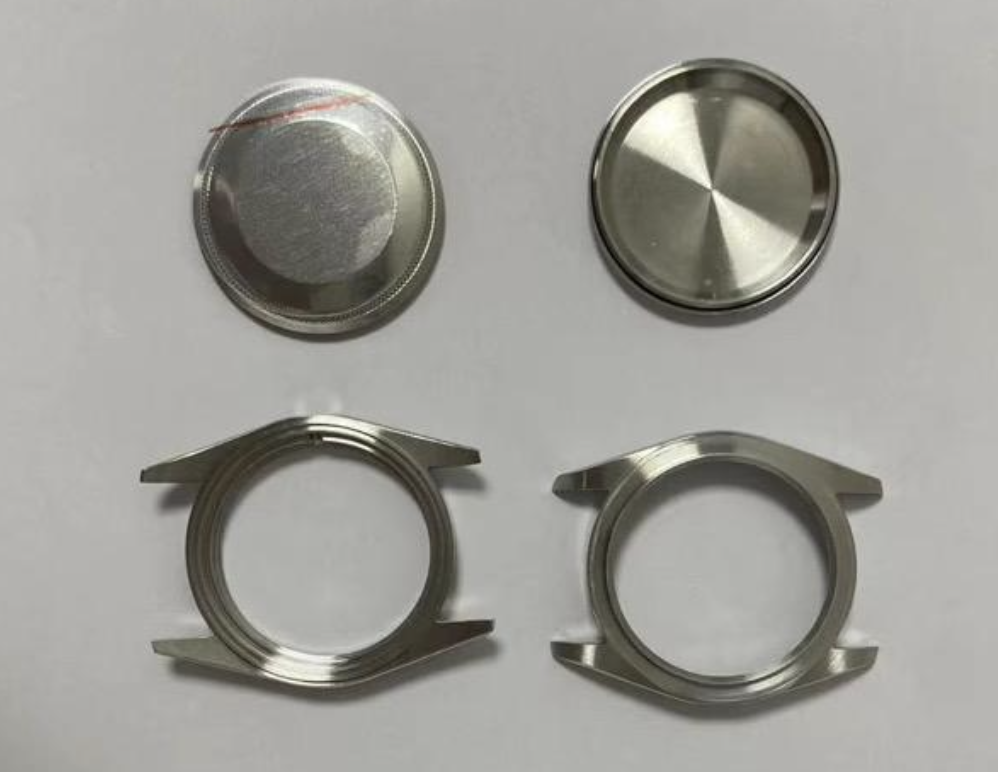

I just finished my 16030 build with the OC case, looks really good compared to the raffles. Is there any word on a slimmer profile case back however? Or does anyone know a replacement case back that’s less deep?

Haha mate you got a good price and these are good too.. and v2 will be little bit more expensive.

Haha no complaints on this side sir! Will probably buy a bunch of v2s at some point too 🤣 is the caseback going to be slimmer than v1?
