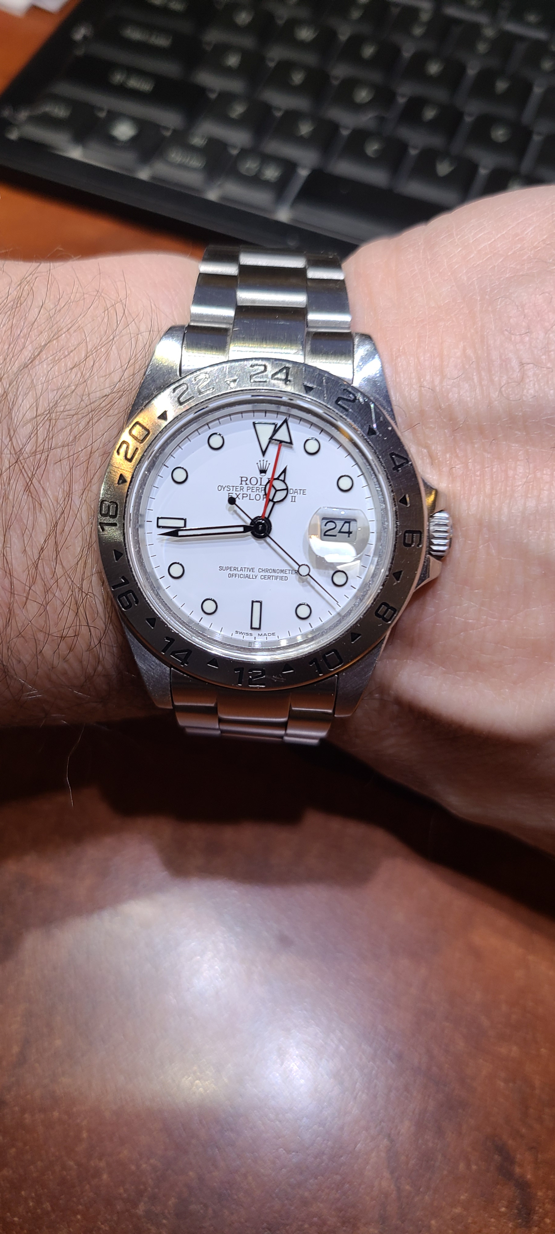

Update: 92350 from my ARF 16610 worked almost perfectly. There are some slight gaps in the lugs that bracelet tape helped fix (thanks @KJ2020 for your insane amounts of knowledge and guides as always)
...and now I have the perfect excuse to buy a Ginault bracelet for my 16610 Franken 🤣

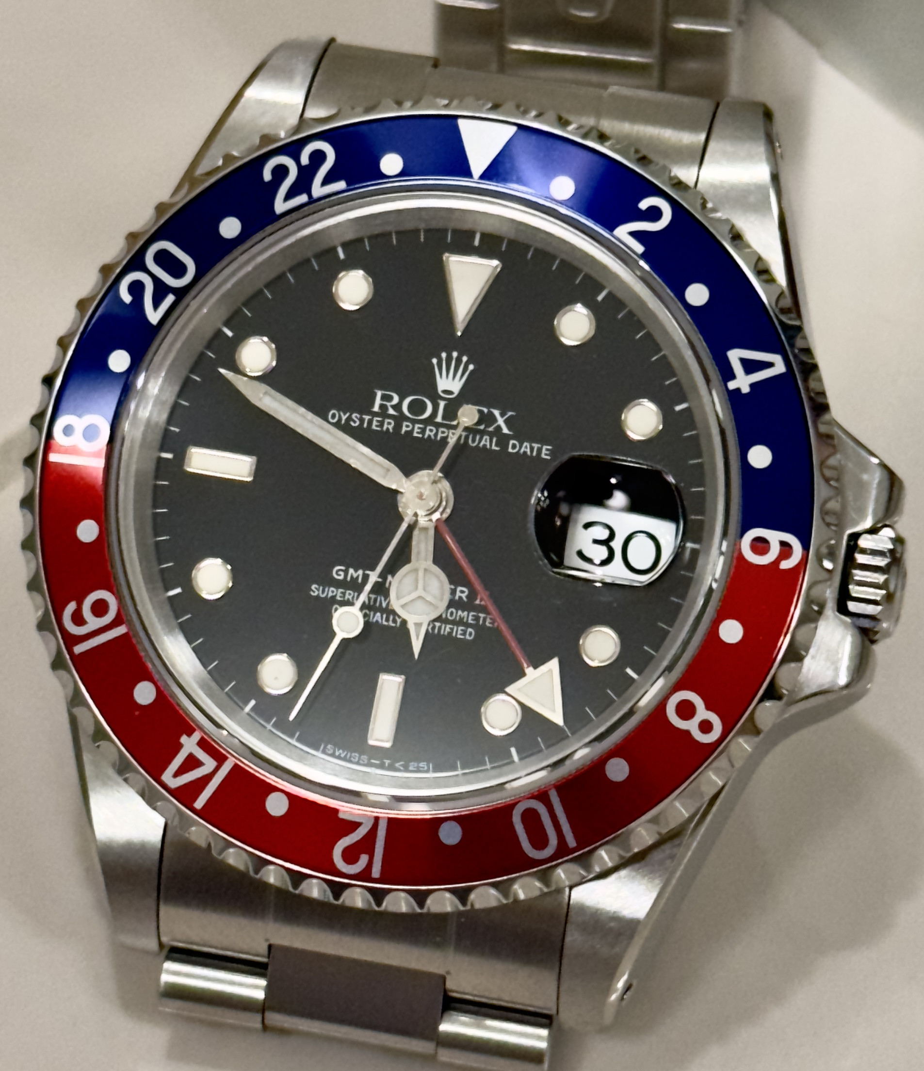

Not a gen insert, I believe it’s eBay. But any gen spec insert should fit perfectly
Thanks of the info. That insert looks really good. Do you perhaps remember where in eBay you got it from? I've been looking around and the gen ones prices are a bit crazy especially the Pepsi , I'd rather spend on a gen bracelet than pay those prices for an insert..

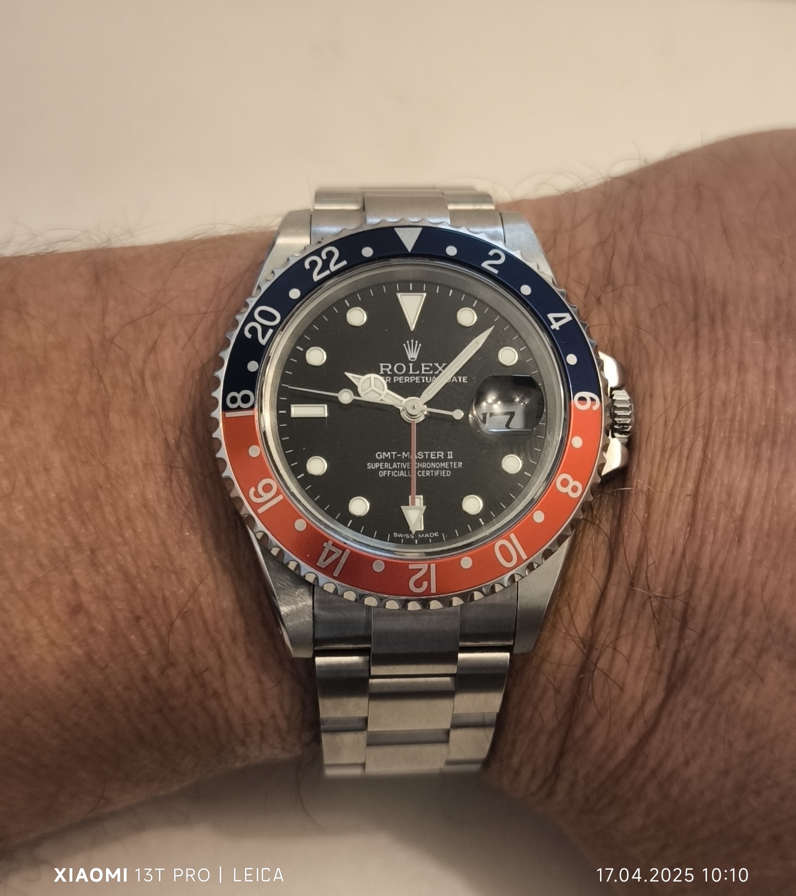

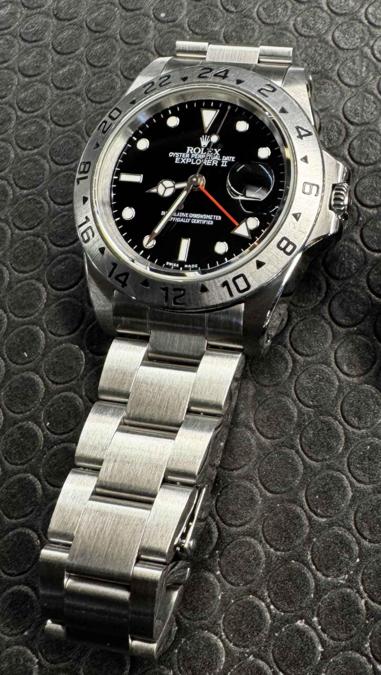

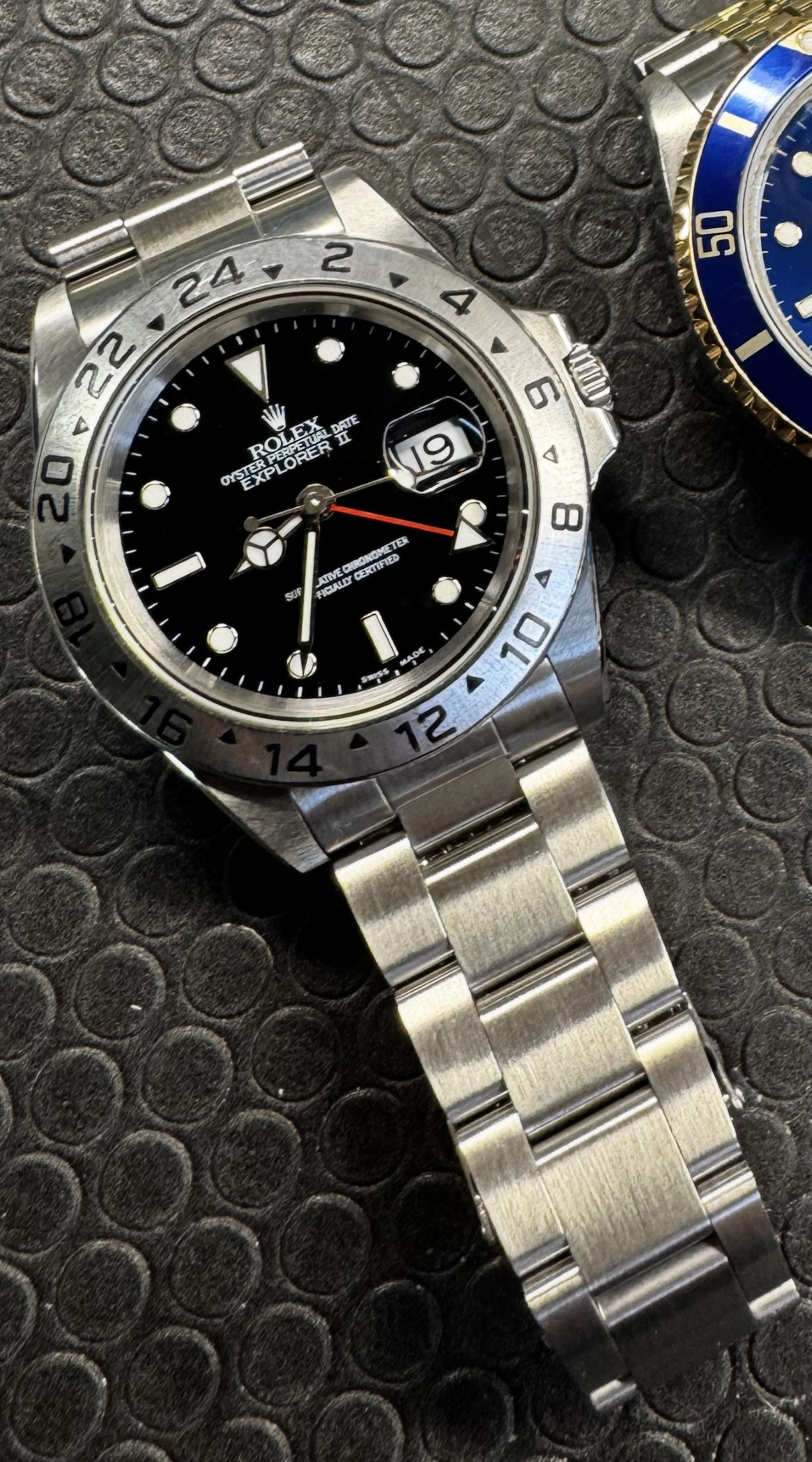

In meanwhile I completed my 16710.
Dr vintage Case reworked Cg's inside out complete.
Installed new Tube and Crown
Case back is now changed to work with Rolex opener.
SEL modified to fit perfectly on the Case.
1,8mm Fat Springbars.
Installed a new Crystal
New Pepsi Insert
VR 3186
New Hands
New Dial
Now it look like this.
I'm happy with the result😉
