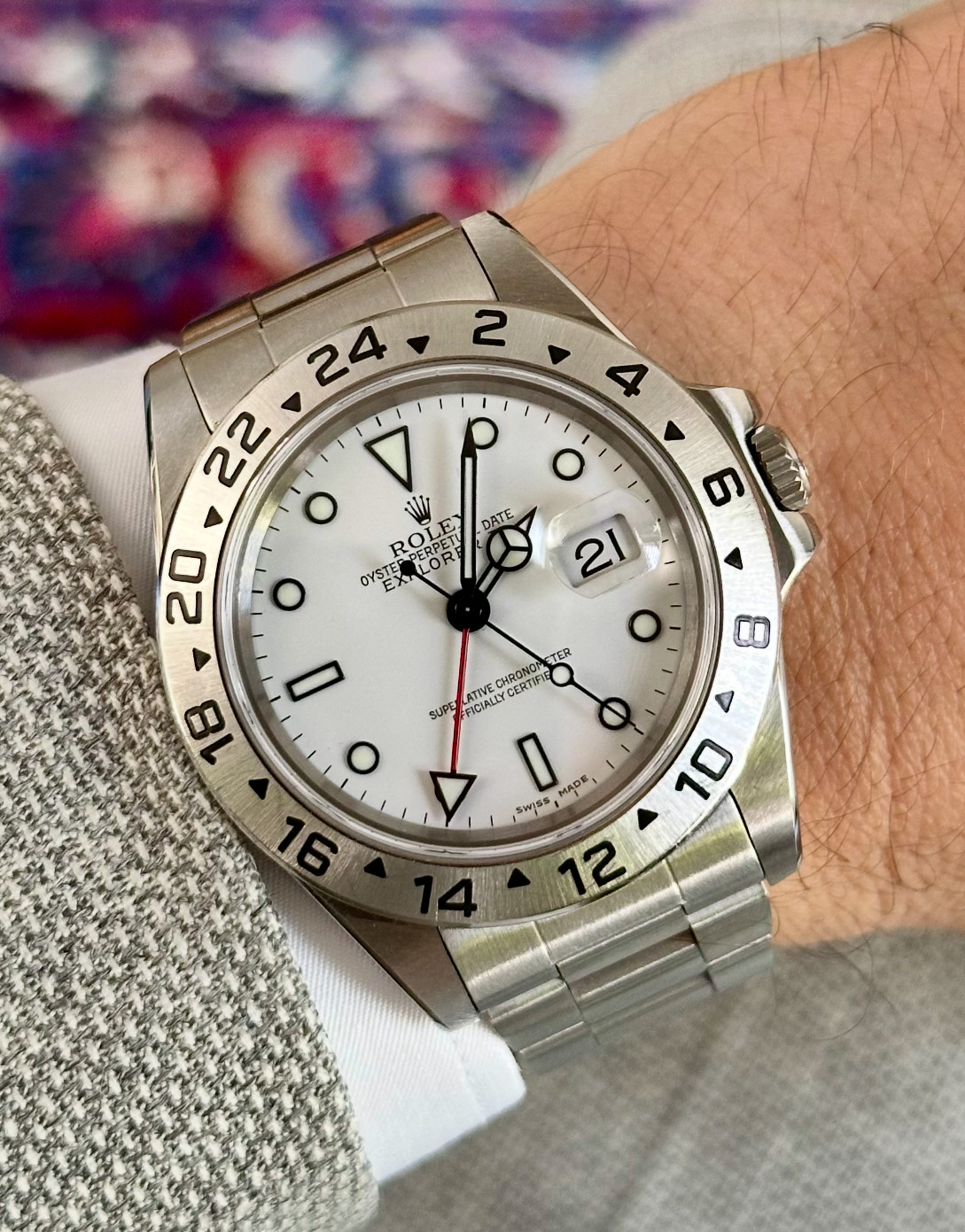

Yes! GMT hand looks nice. I’m gonna order them for my 16710 also.Looks great! I think the minute hand from Sillan is also more accurate than the mccaw but might have to order a set for the GMT and hour hands

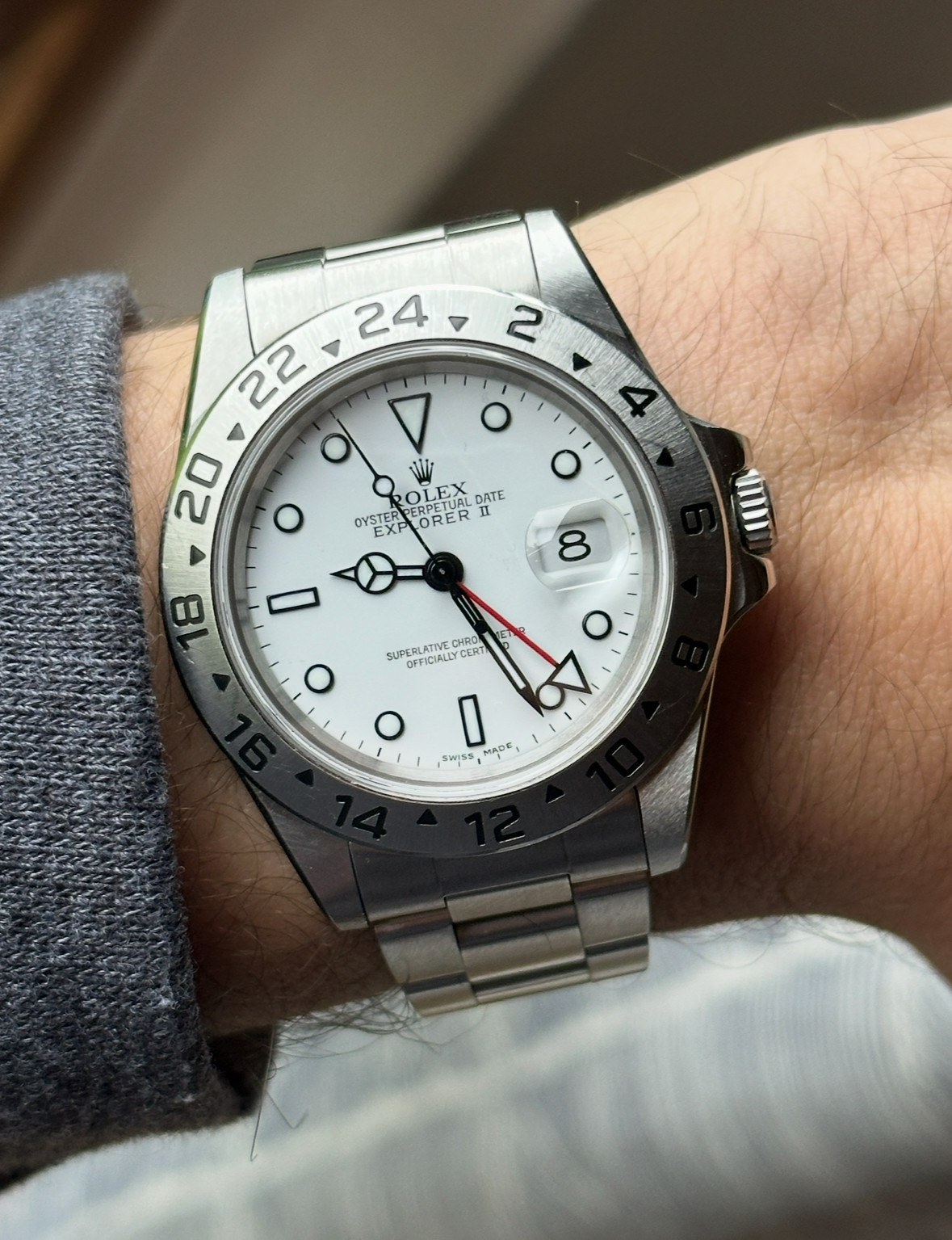

Looks awesome! What’s silian, where do you get it and what’s the price range for example a dial? Is it like viet?Have been meaning to share my build for a while but haven’t gotten around to it till now
- Dr. Vintage case
- Sillan Dial
- Sillan Hands
- Aged Sillan Bezel (waiting on Gen Pepsi to arrive)
- VR3186
- BP datejust crown (my AliExpress high quality one wouldn’t fit properly and couldn’t order another bc of tariffs)
- Parts bin crystal
- WSO click spring
- Ginault Bracelet
- Swiss spring bars
- Reshaped the lugs to remove some of the chamfering
- Reshaped CGs
- Recessed the Crown
- Full polish and softened all the edges

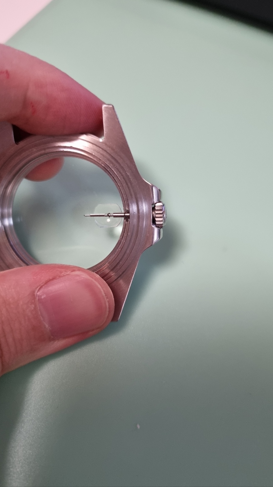

Does the vr3186 fit the silane hands exactly without processing?Have been meaning to share my build for a while but haven’t gotten around to it till now

Yep, perfect fitDoes the vr3186 fit the silane hands exactly without processing?
The tube has to be sanded down a bit from the outside. I bought an aftermarket 24.532 tube from eBay from a uk seller (came with all gaskets) and perfect fit with a 604 crown.I'm not sure I understand which crown best fits the tube already in place?
