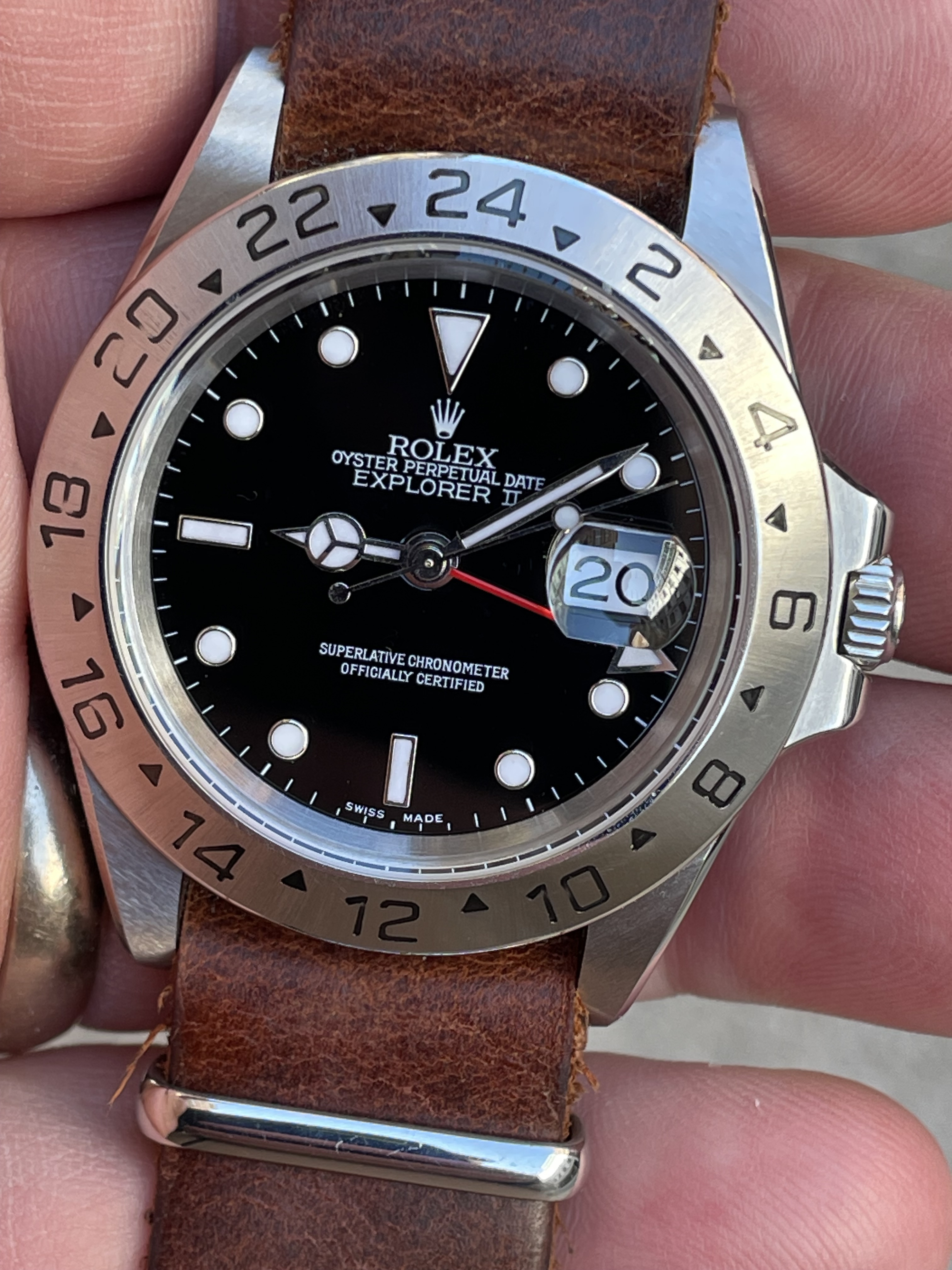

And here we go:
  • OC Case set (what else if I post it here?)
  • Gen Bezel
  • Gen Dial
  • Gen Hand Set
  • Gen Datewheel
  • Aftermarket crown
  • VR 3185 (3186 engraved), fresh serviced
  • Brown leather Nato strap from Yuki

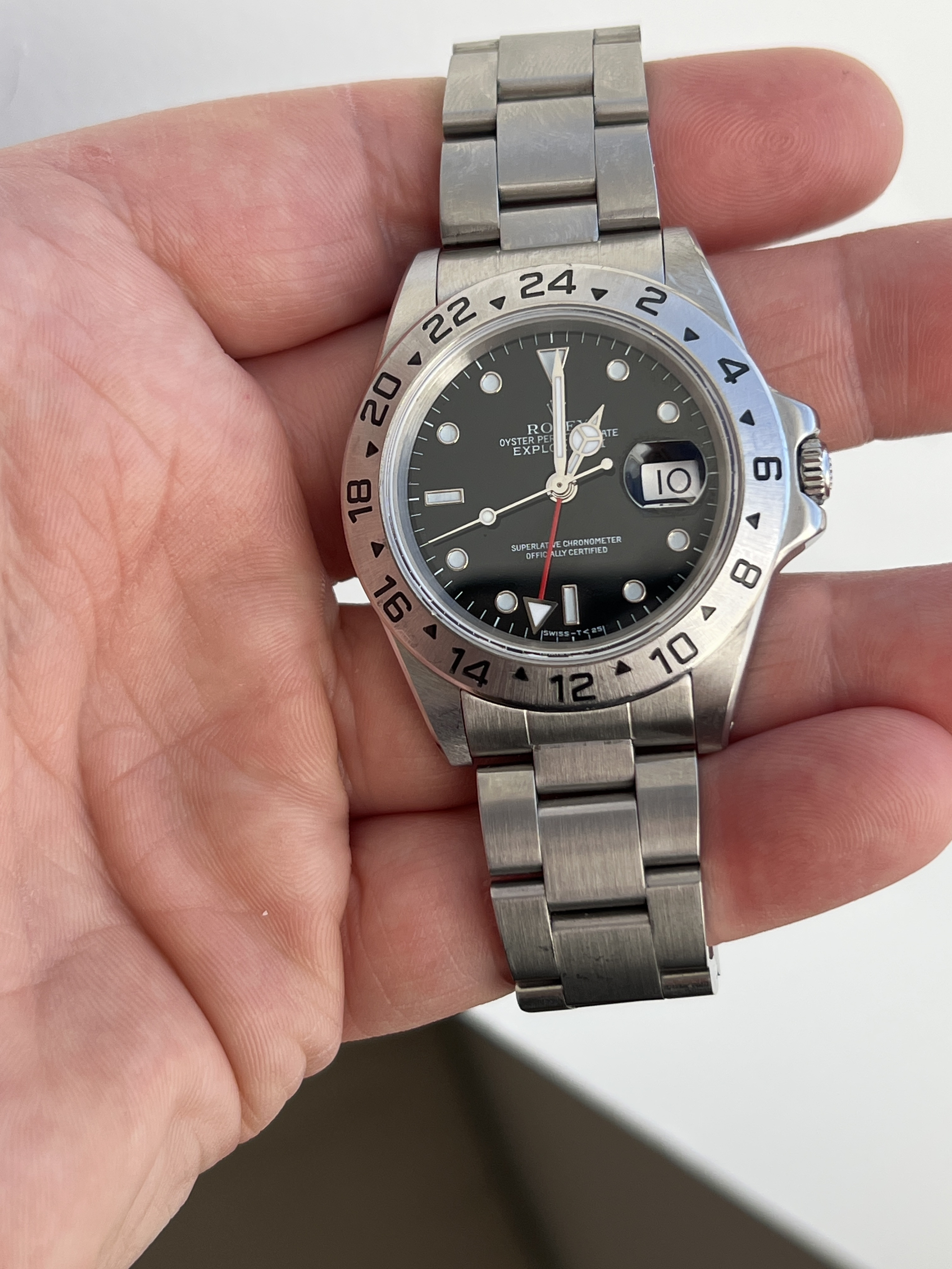

This case set looks amazing!! would this fit a gen 16570 bezel if I wanted to go that route?
kadeee
25/10/18
1,548
1,067
Have you seen the picture of my Explorer II build on page 11 here?
This should answer your question.
