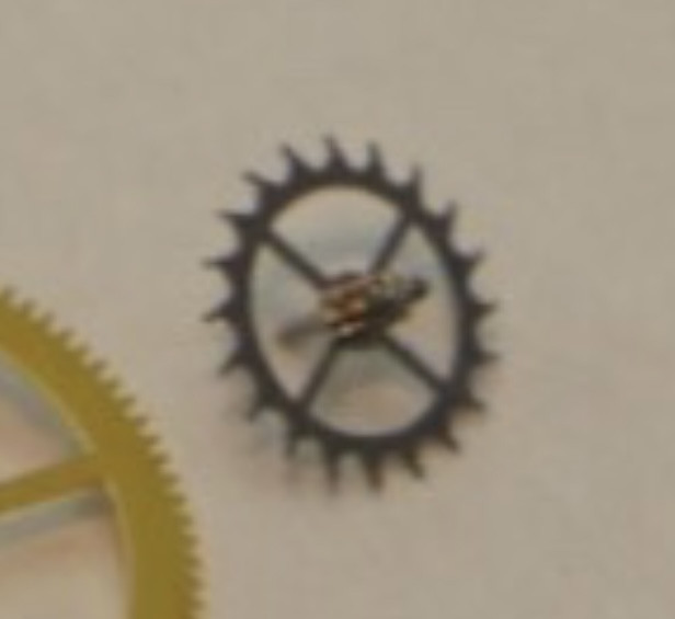

Has anyone sourced this movement? My ZF V2 IWC 5009-8 froze after an unfortunate drop. I've searched the Liaoning Peacock SL6601, but threads seem to end in dead ends. I've reached out to my TD, but any leads would be appreciated.
Reactions: SteveMcQueen1930
SteveMcQueen1930
9/5/19
1,287
489
Does anybody know which escapement wheel this movement uses? Mine is broken and I need to source a spare one.
