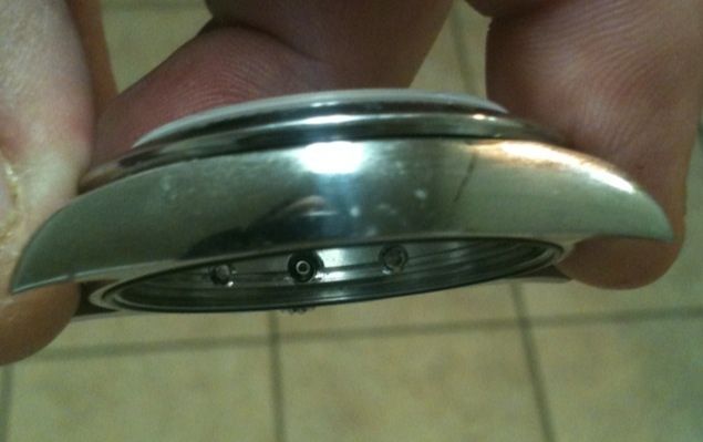

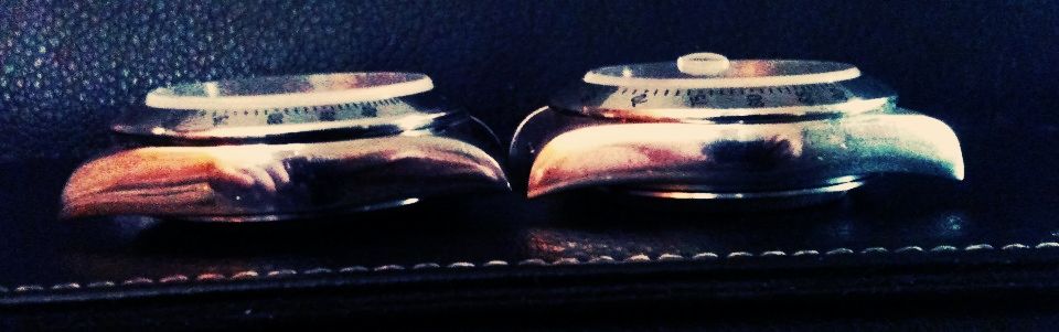

Over all from case back to crystal these 2 measure out the same BUT...the cases are clearly different and the case backs are too. The thick CG seat is also there too.
Weird thing is the thin Cartel case is marked 16520 (which is an El Primero) and the serial is X419088 or 1991.
I am guessing that this guys movement is a modded 7750 with a flatter slimmer rotor to fit that old school case. The bezels look about the same but the crystal on the Newer case is a bit taller out of the bezel.

The top pic is a pic of the bad/slopey case, not the flat bezel case.
In the bottom set of pics, it does look as if your bezel is flatter. The ridge I was talking about on the case back is also visible on your watch.

Look, it is totally different even looking at any angls. Its bezel bevel angle is perpectly same as Gen.

Looking at my gen TT, your case looks slightly fatter. The bezel is nice and flat so you definitely have something worth a damn.

The flange on the backside of the case ID's as a V1 Cartel Case...period...whatever aftermarket bezel is modded to fit it. Same case, hell I got one too.
The flange that the case back seats to, this flange.
Fat newer 116520 case
Yep, but look at the height of the crystal over the bezel edge. It's way tall. Looks to me like they updated the cartel bezel to make it flatter (and it looks very very nice) but the crystal height had to stay the same.
Compare to the pics in txrob's post, the case profile looks the same (especially the flange), it's just the bezel that's different. The bezel is a separate piece to the case.
