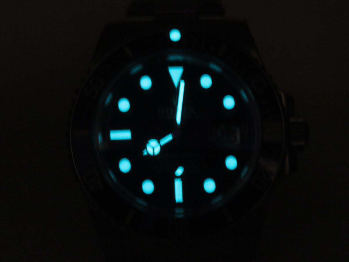

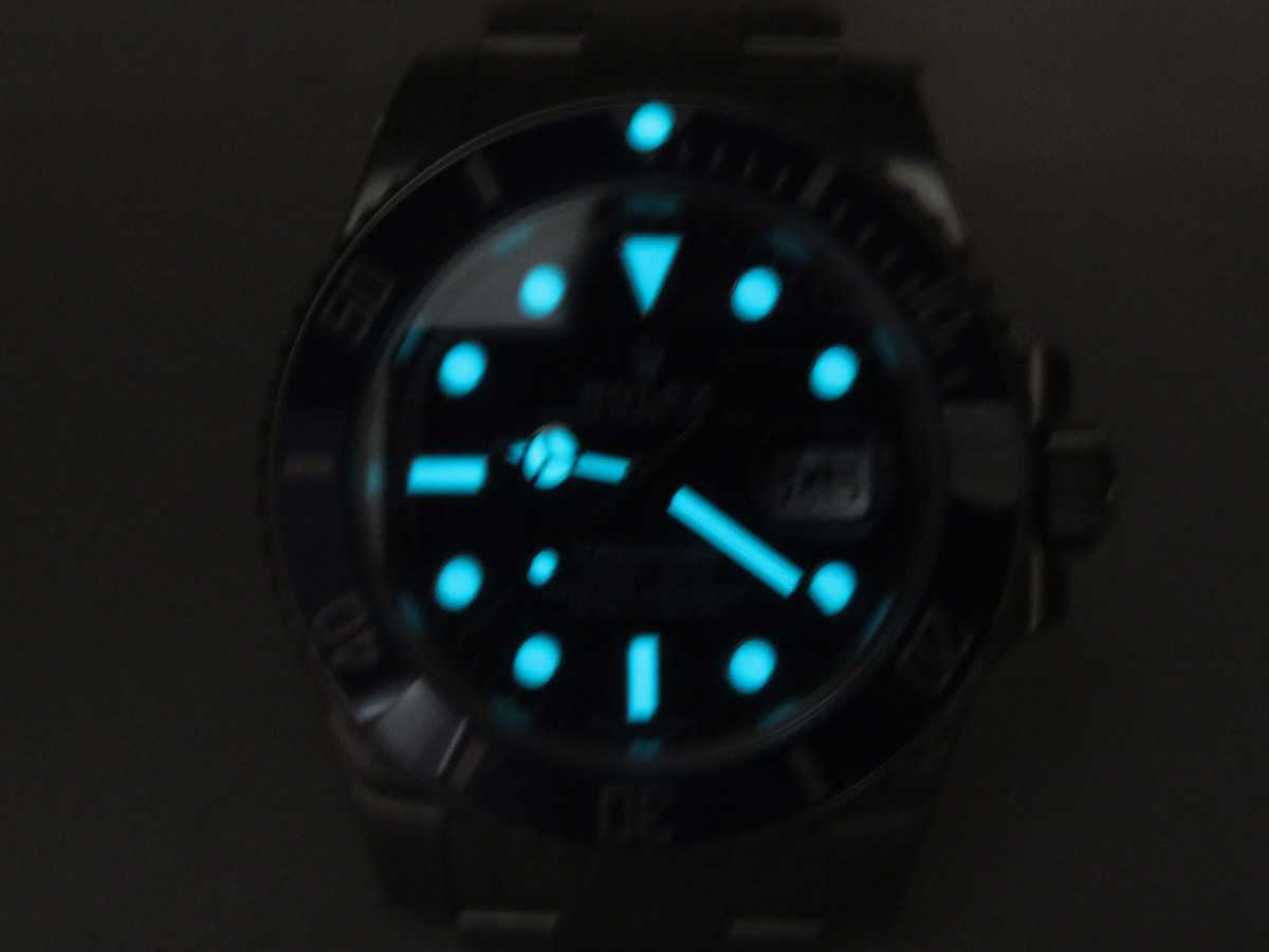

Just got a reply from Andrew with the lume shot from one of the watches. He didn’t refer which model though. Judging by the color I assumed it was the 126610LN since it is kinda “light blue” (and looking good!)
He said he would get back to me with the lume shot of the other one (116619LB - which should be green).
bersekr
7/4/25
21
Just got the last pic from Andrew. This is meant to be the sub 116619LB.
GL. Waiting on shipping and tracking now.

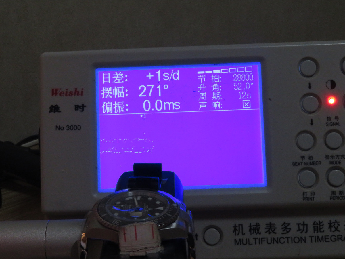

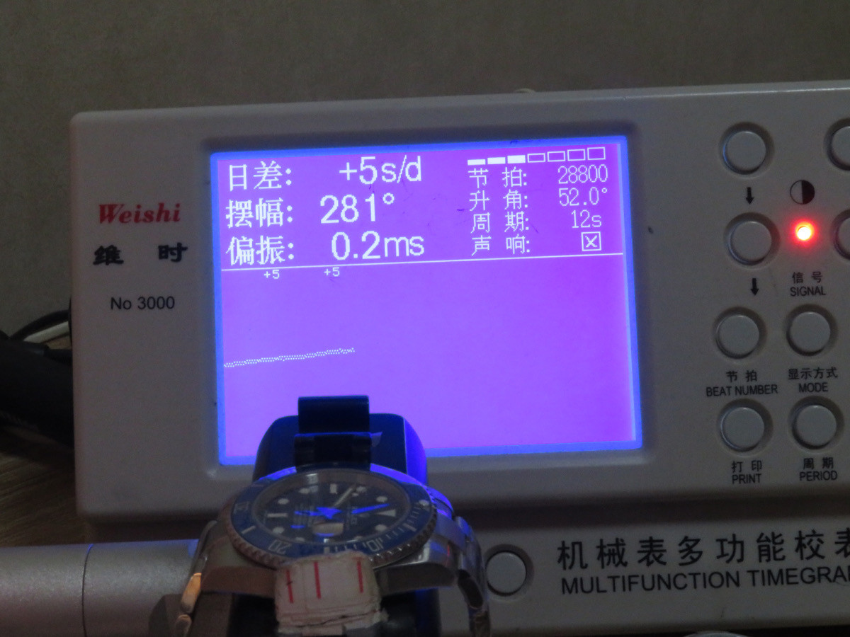

m5750
22/3/24
1,064
2,252
From what I can tell, both readings are within the GL range, right?
Not a pro here, and I absolutely respect Andrew 100%, but the second timegrapher reading tells me you might have to service this watch at some point (it's recommended anyway). Some vets here can probably tell better than I can, but looks to be either a dirty movement as a whole, magnetized or dirt in the escapement/gear train. If you notice the bluesy (hard to tell, it's dark in the photos), the lines are straight and close together (which would indicate a good beat error). I've never RL'd a watch, but my TD also sends videos of timegrapher readings. Just my two cents.

bersekr
7/4/25
21
Hey thanks for the observation. It’s much appreciated. Does any other fellow community member feel the same?
Like I said, even though I did my research, I’m new to this…
m5750
22/3/24
1,064
2,252
There are a lot of guys here that know a ton, but I can say that for me 1. I don't like that the timegrapher was stopped after 1 12 second reading and 2: The results on the second watch are a bit "snowy".
@Uhr70 - Hope all is well brother! Would you be able to, or recommend someone here that could give feedback on the 2nd timegrapher result above?
Reactions: bersekr
m5750
22/3/24
1,064
2,252
Numbers look good but look at the bigger picture and compare the two. You see straight lines on one, and a lot of "noise" with the other. I've never RL'd a watch. Not yet at least, but I would have an issue with this being that I understand how these work, build watches and regulate timepieces.
Reactions: bersekr
bersekr
7/4/25
21
So you think the second one “+1s/d” (just for reference) is a RL? Would you be so kind to clarify why that is, based on the timegrapher reading?
8,331
23,214
Timegrapher isn't just blindly reading numbers. Look at the dots on screen and how inconsistent they are at generating a line. They're all over the place, looks like "snowfall", should be one clean trace line, which is why m5750 suggests a service.
Reactions: bersekr and m5750
