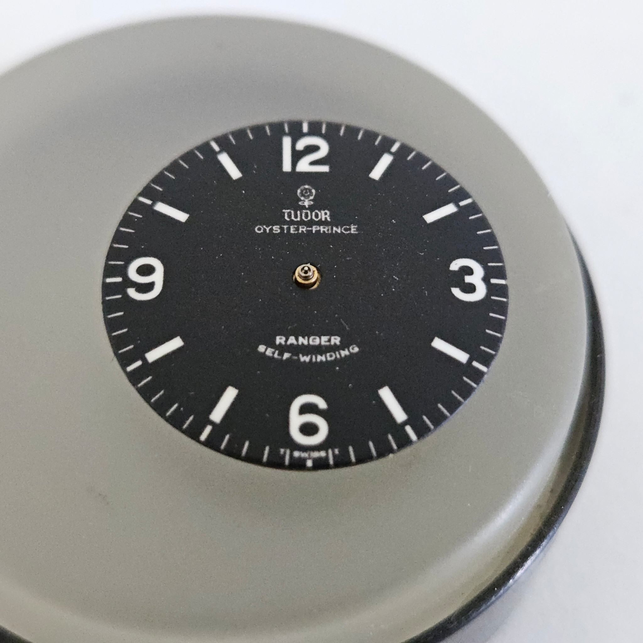

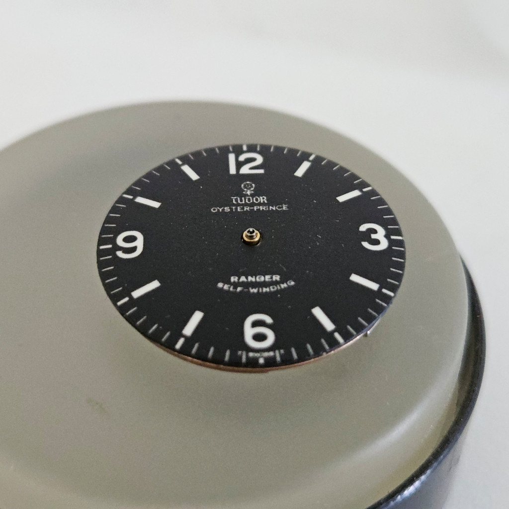

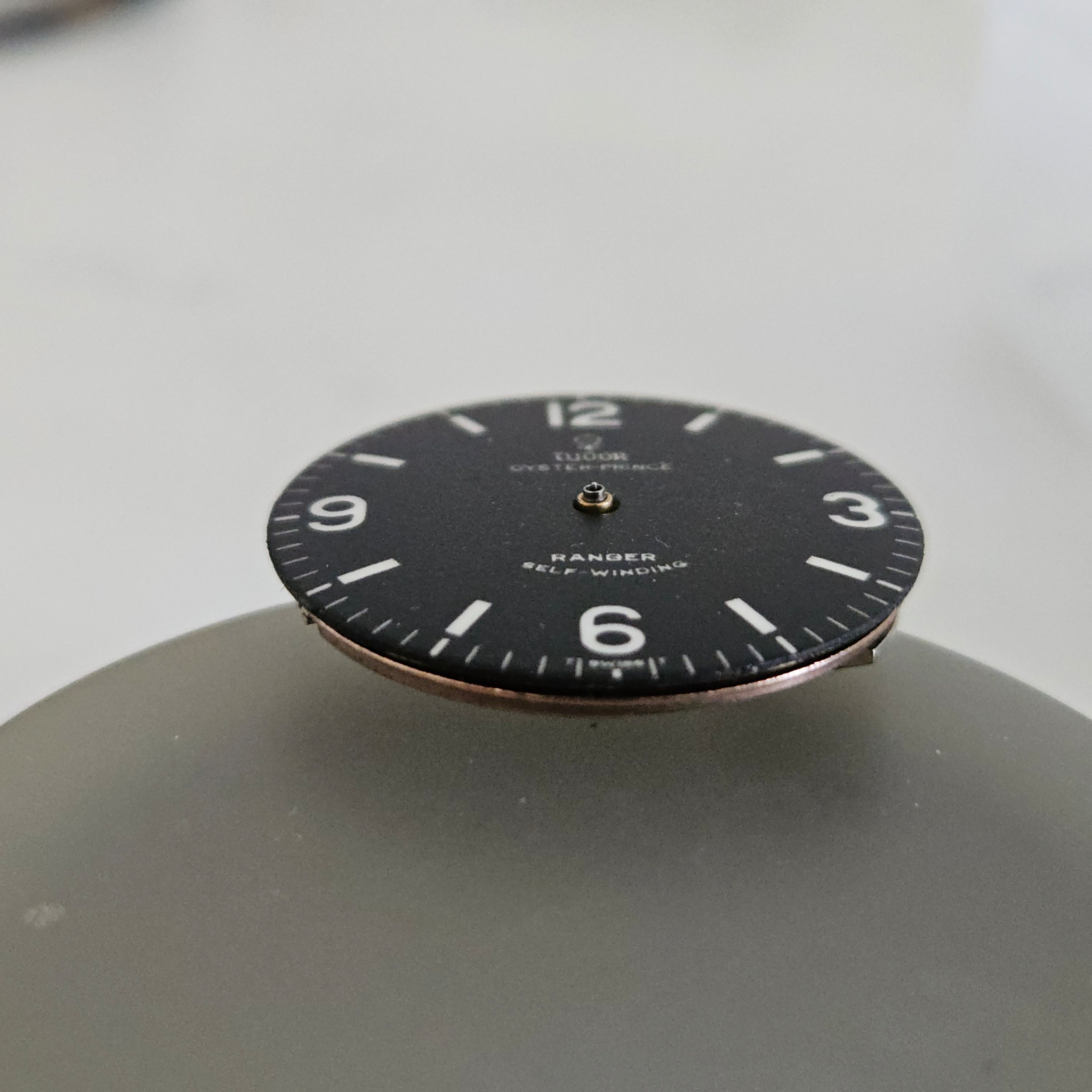

I recently finished Tudor small rose Ranger dial.
Matte finish and slightly curved ... and with dial feet for a 2451 movement :cool:

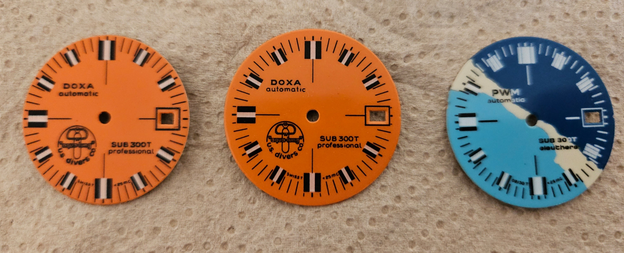

Finished 3 Doxa dials ... ready for lume ...

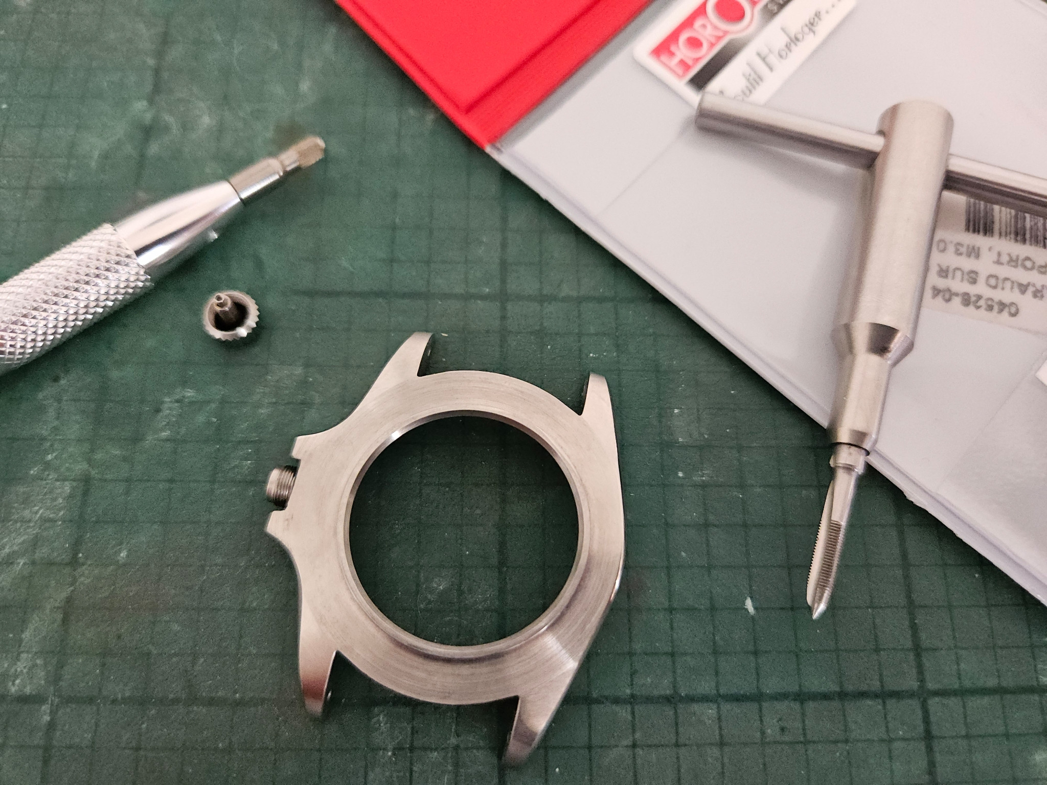

Re-tapped the tube hole on a Milk 5513 case to fit the tube of a 702 crown + tube set from Athaya.
Used a 3X0.35 tap from Horotec ... can't use cheap tools for that type of work ...
