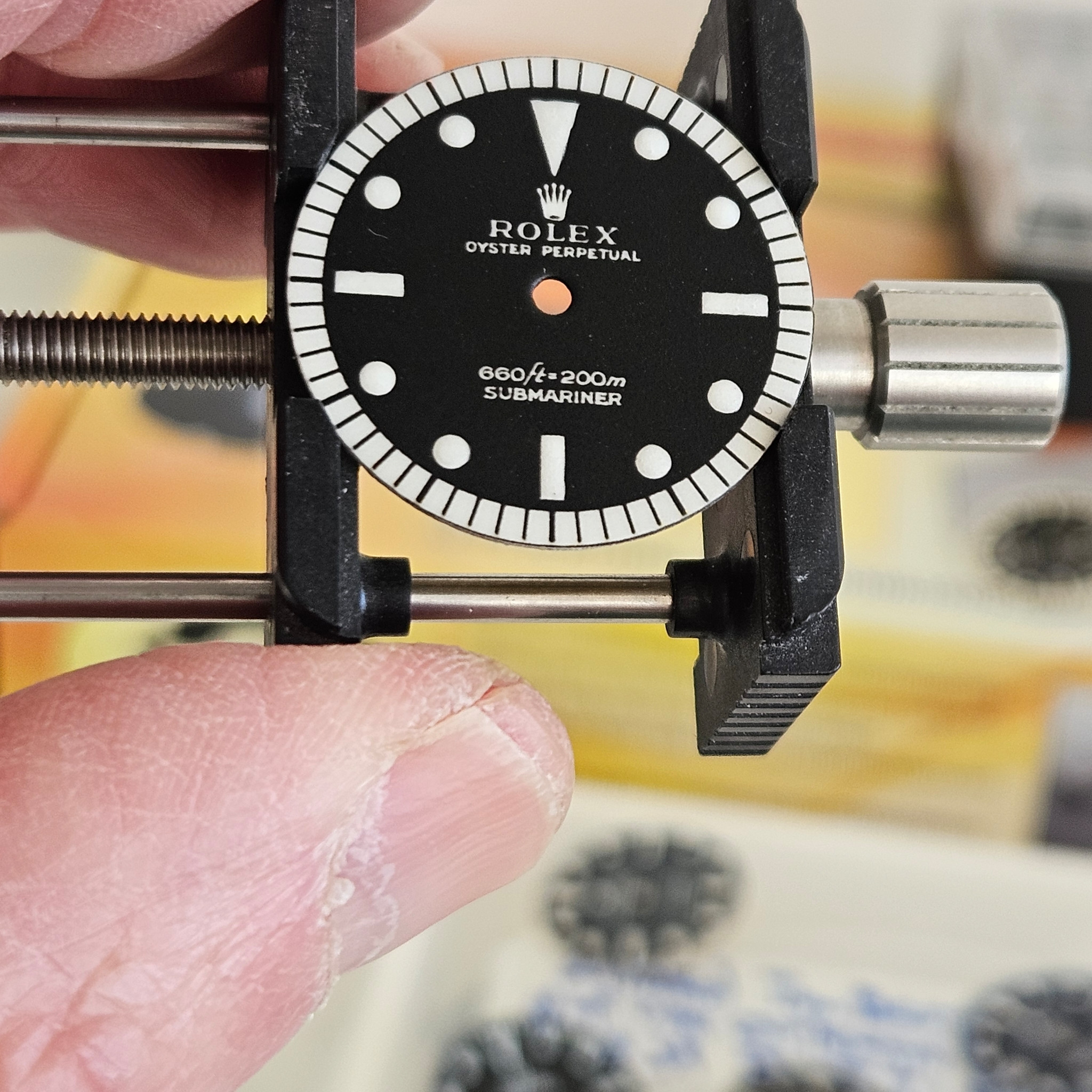

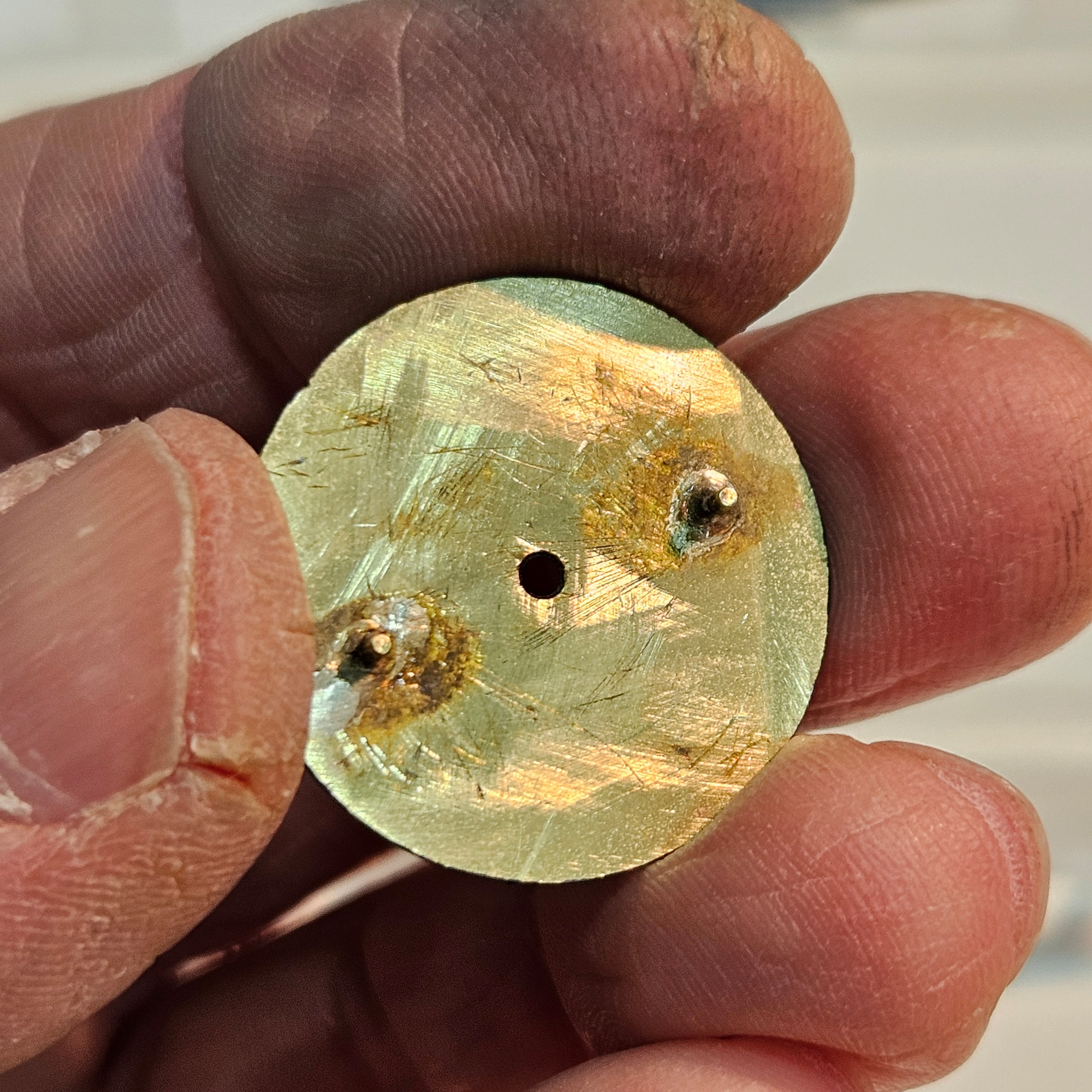

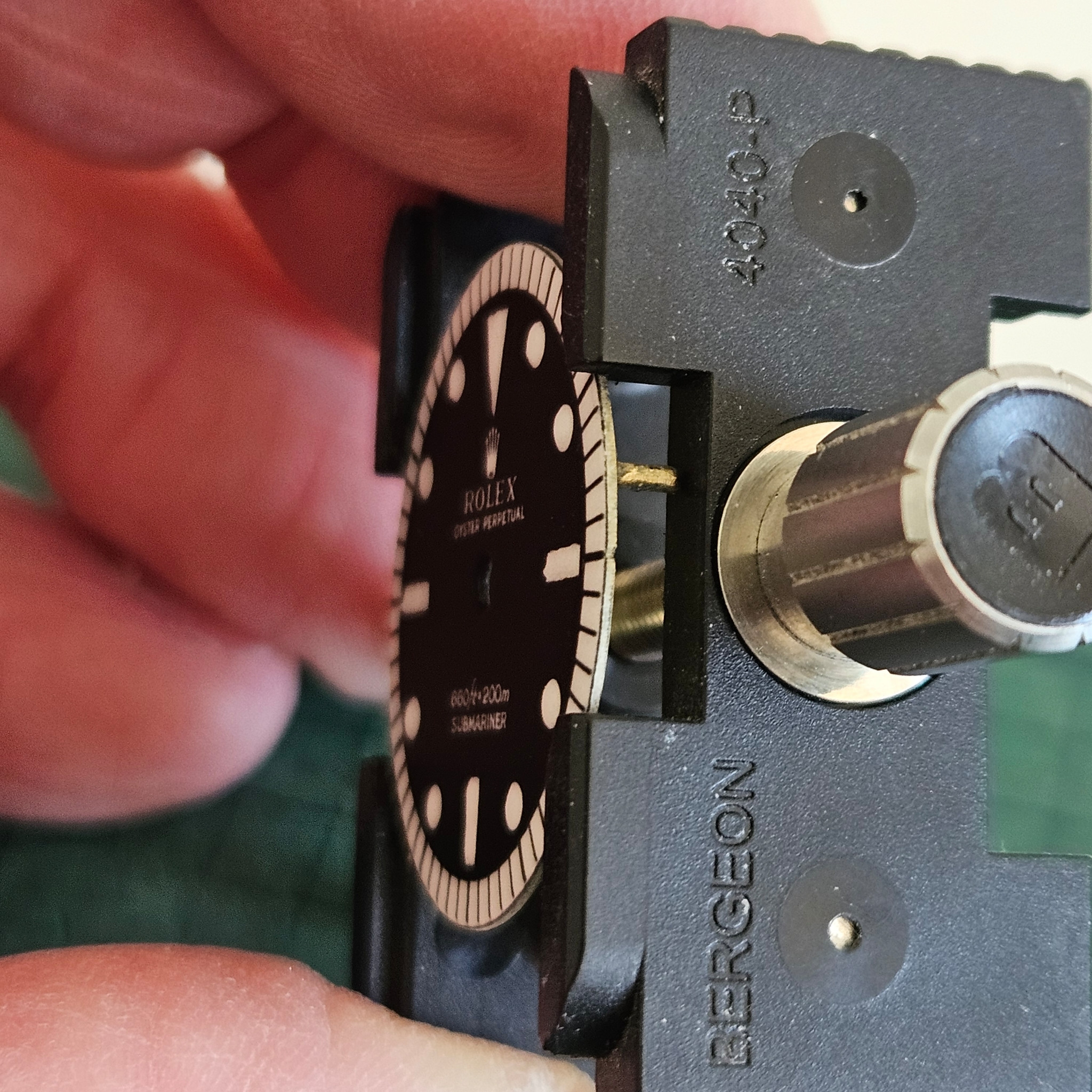

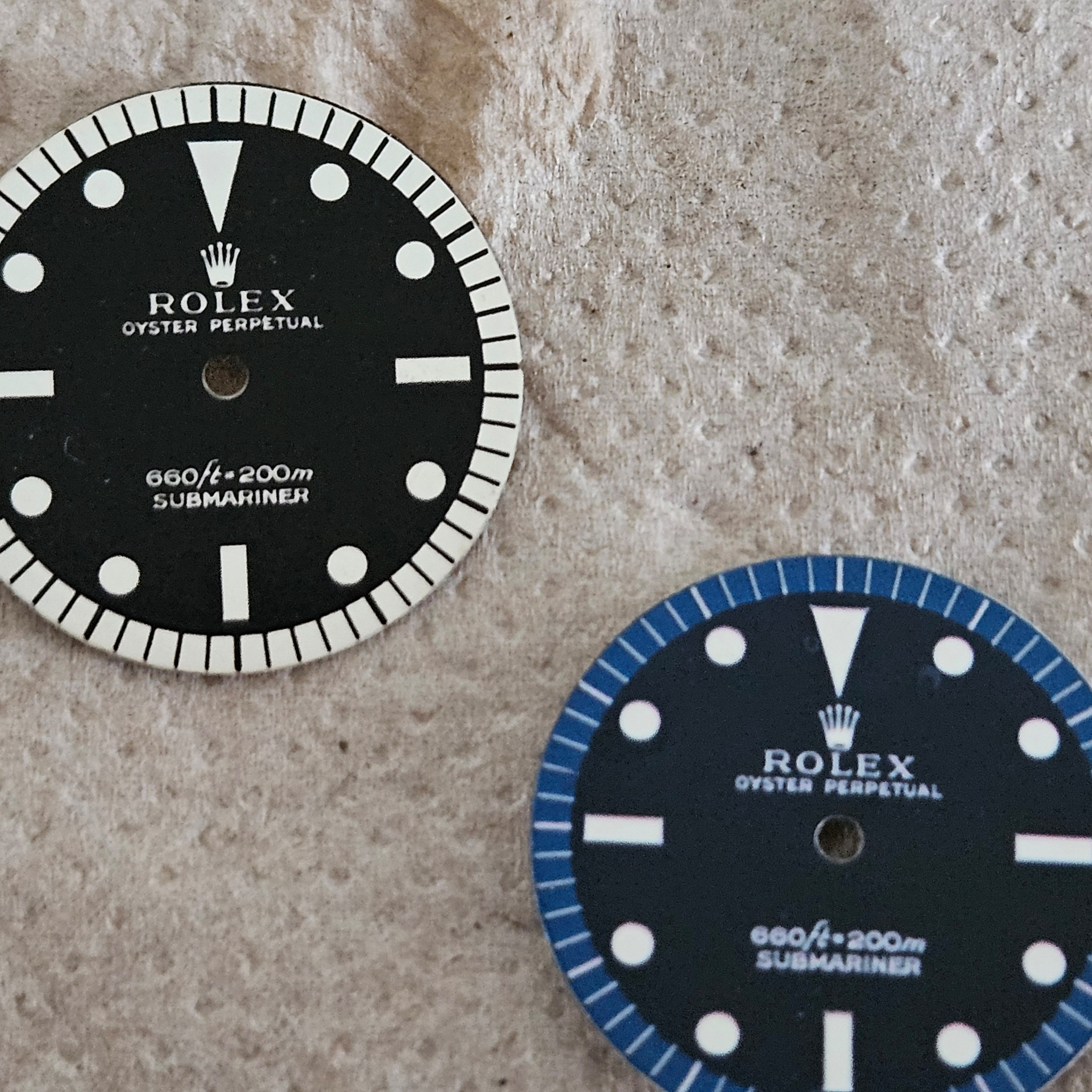

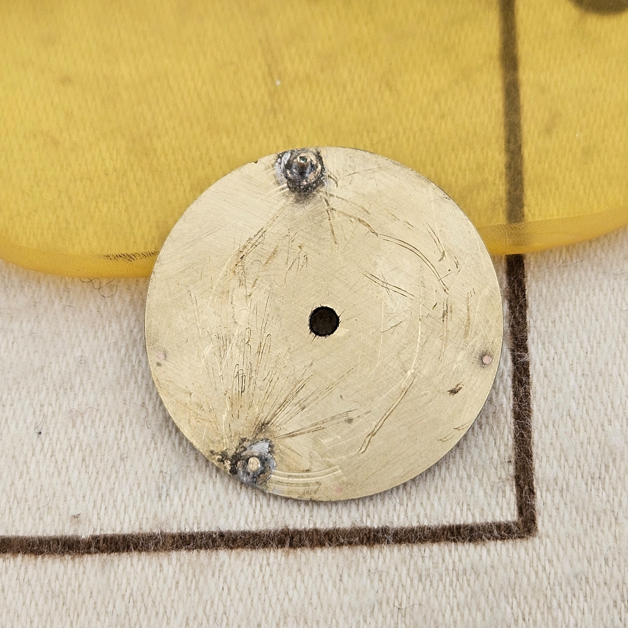

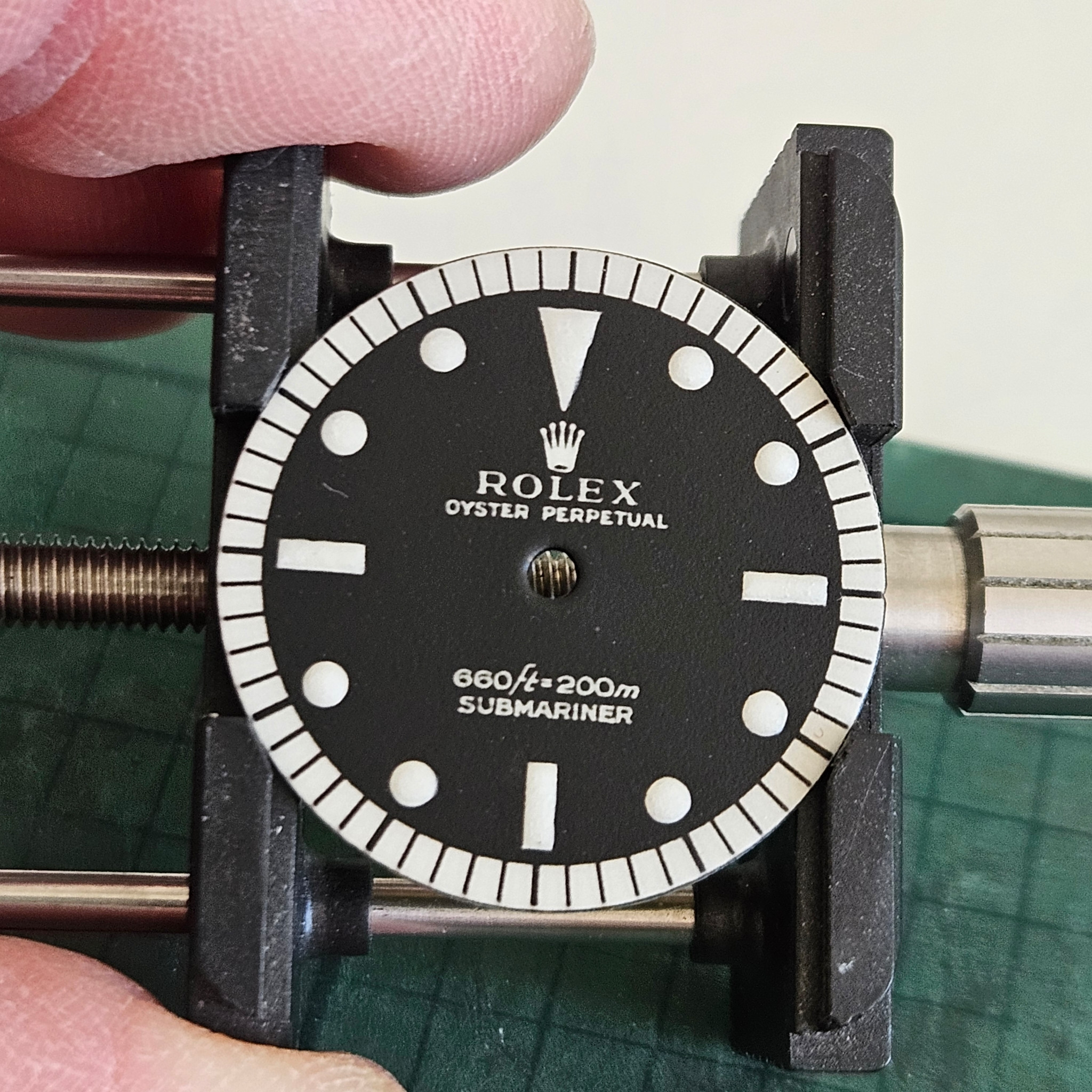

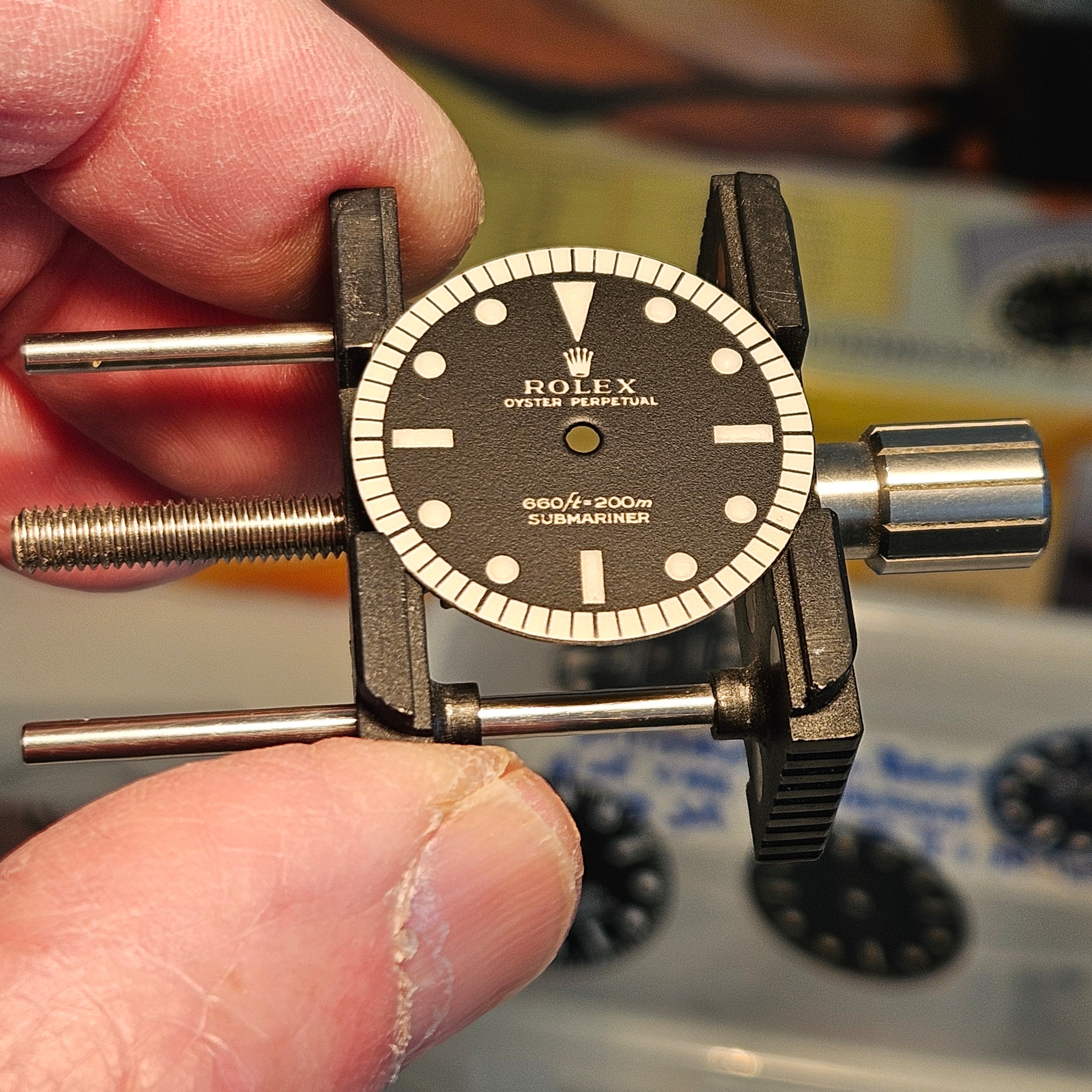

I took a course in electronic soldering.
It may seem strange to talk about this on a watch forum, but I was able to learn precision soldering.
With practice I should be able to solder dial feet for all sorts of different calibers :cool:
I lightly mill the back of the dial where the feet should rest, so that everything is flush-deck.
Then I braze using silver paste and lightly sand.
It's pretty quickly done and much stronger than two-component glue.
For the moment the results are far from perfect but I'm making good progress.
I may try with gold solder paste later when I'm trained enough :)
26mm dial plate for Rolex 5513 - dial feet for a movement 3135
26mm dial plate for Tudor 7928 - dial feet for a Tudor 390 movement

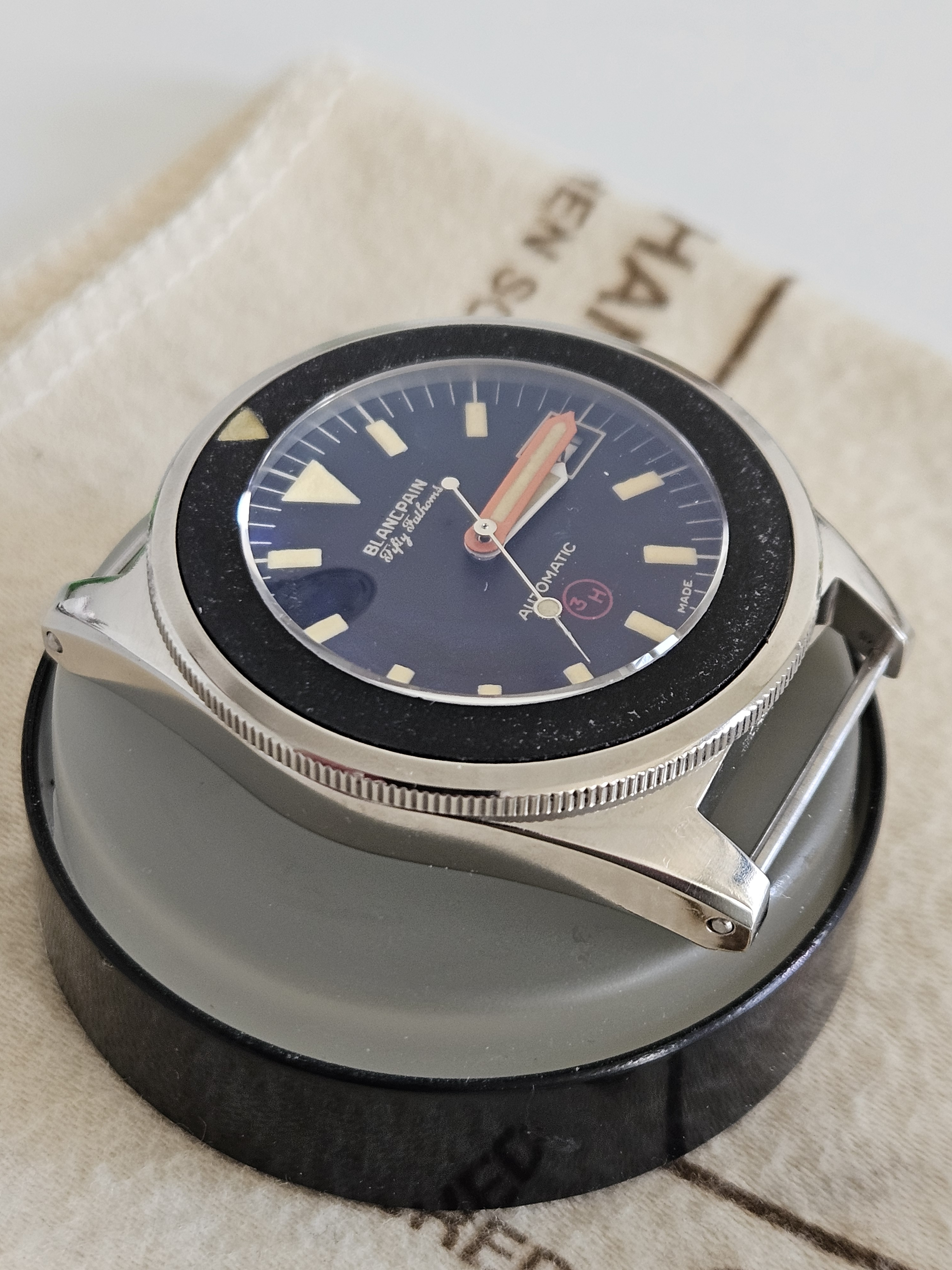

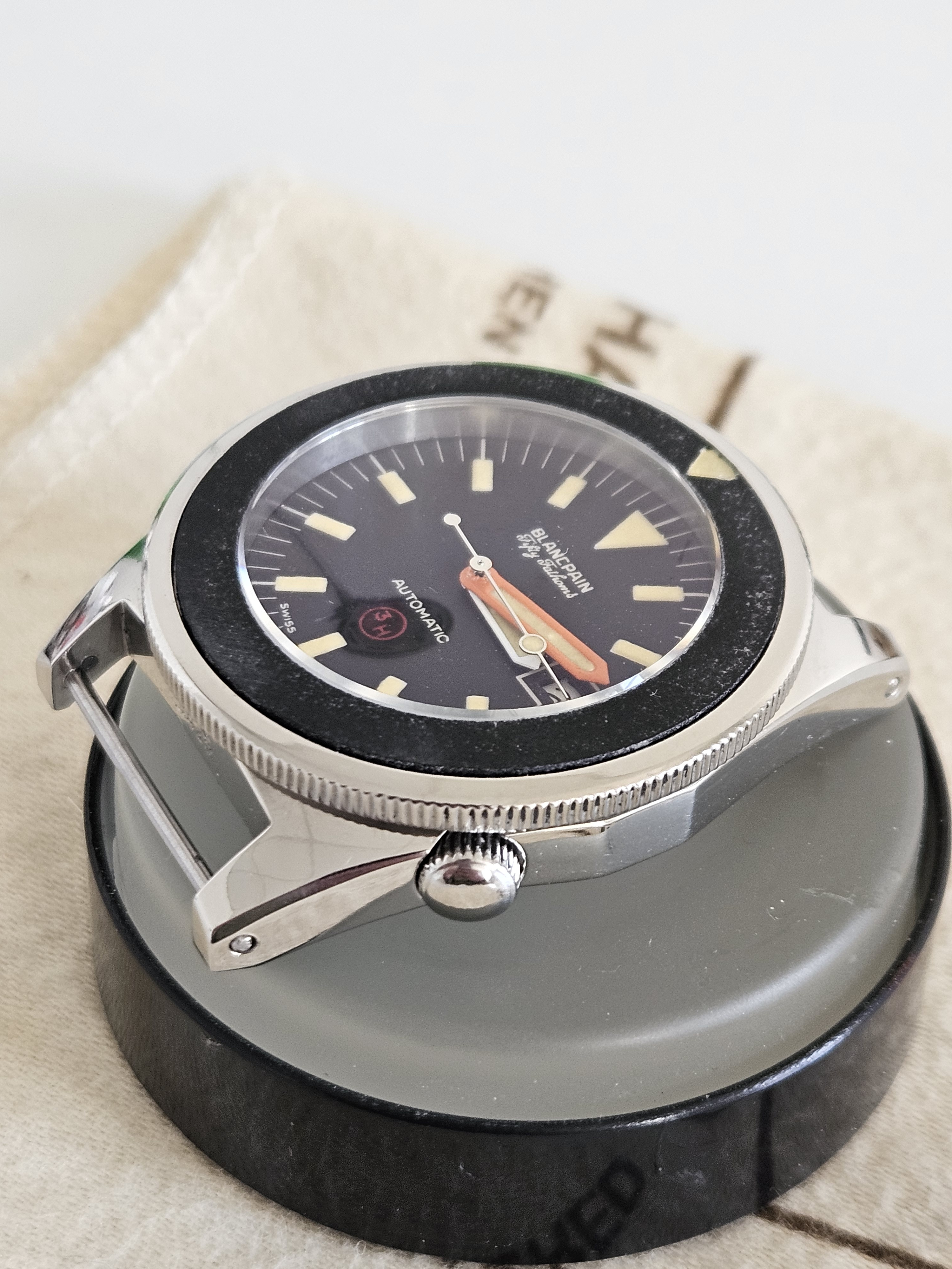

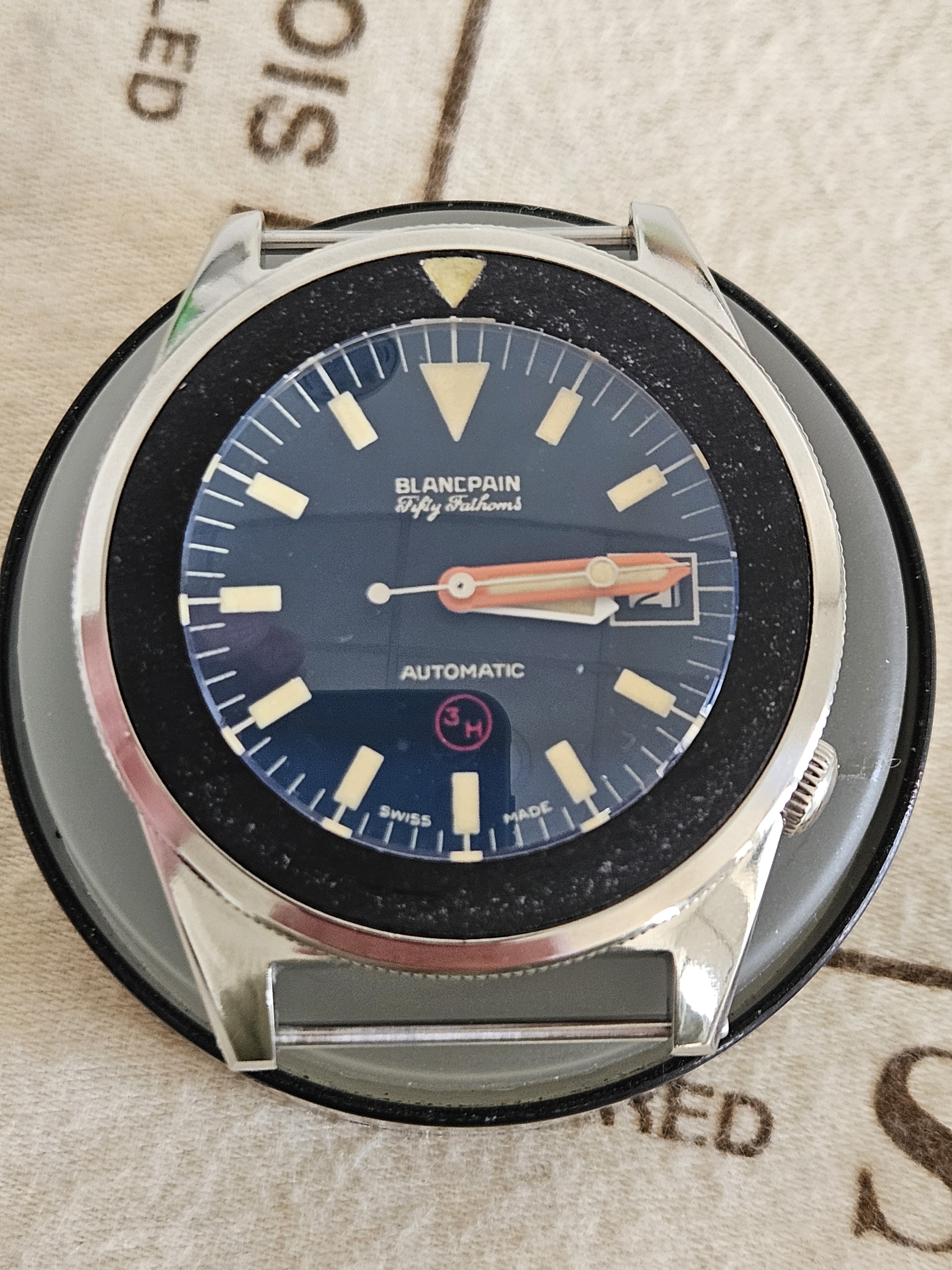

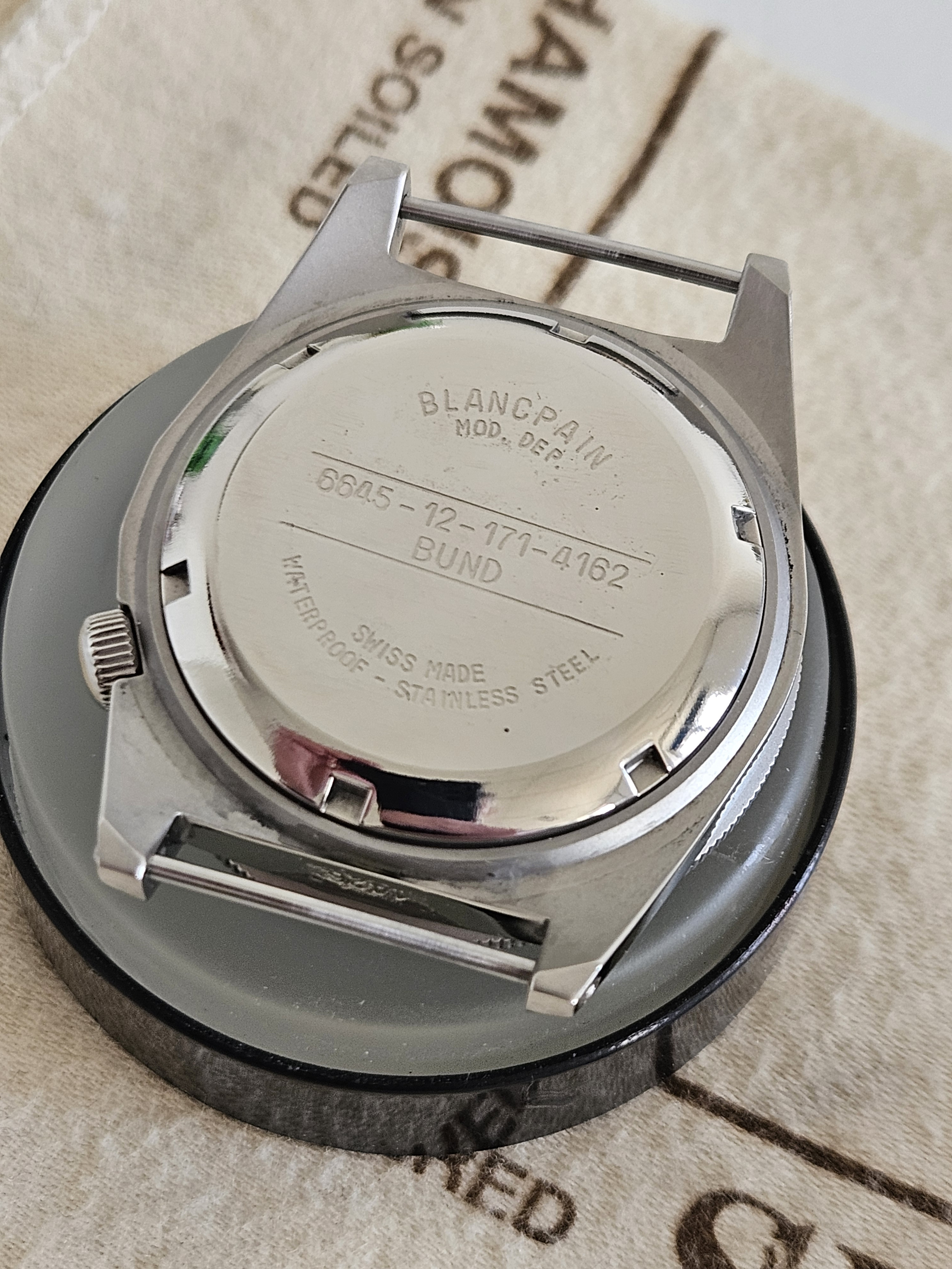

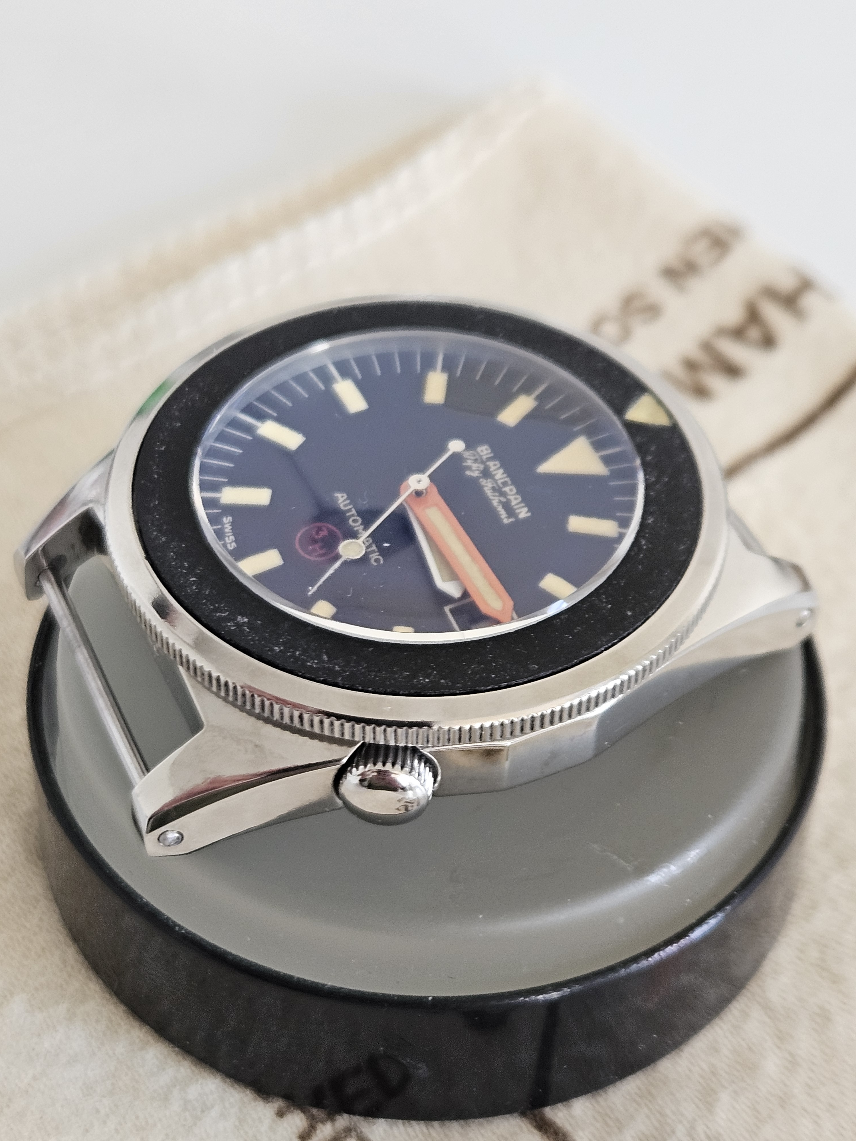

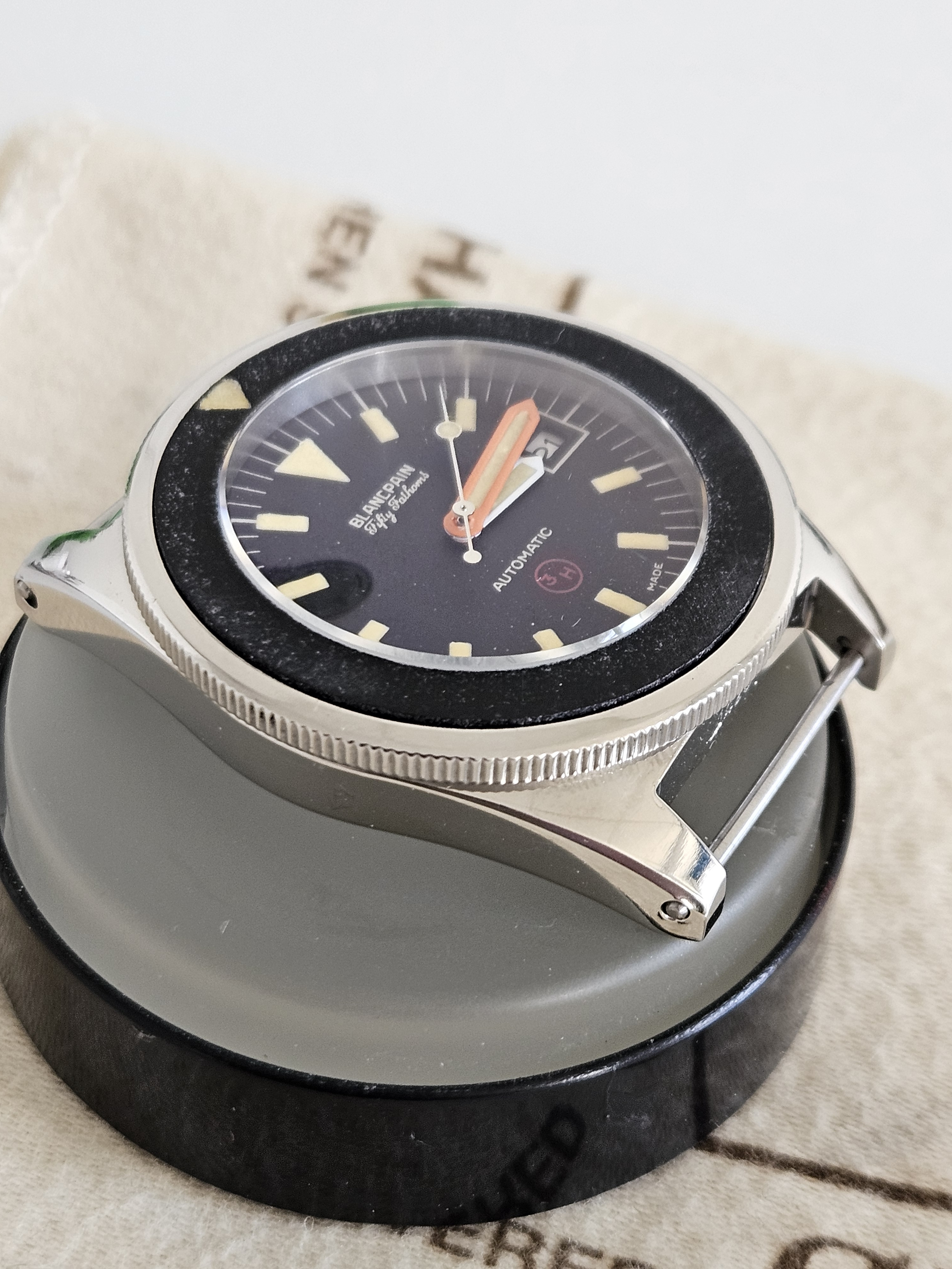

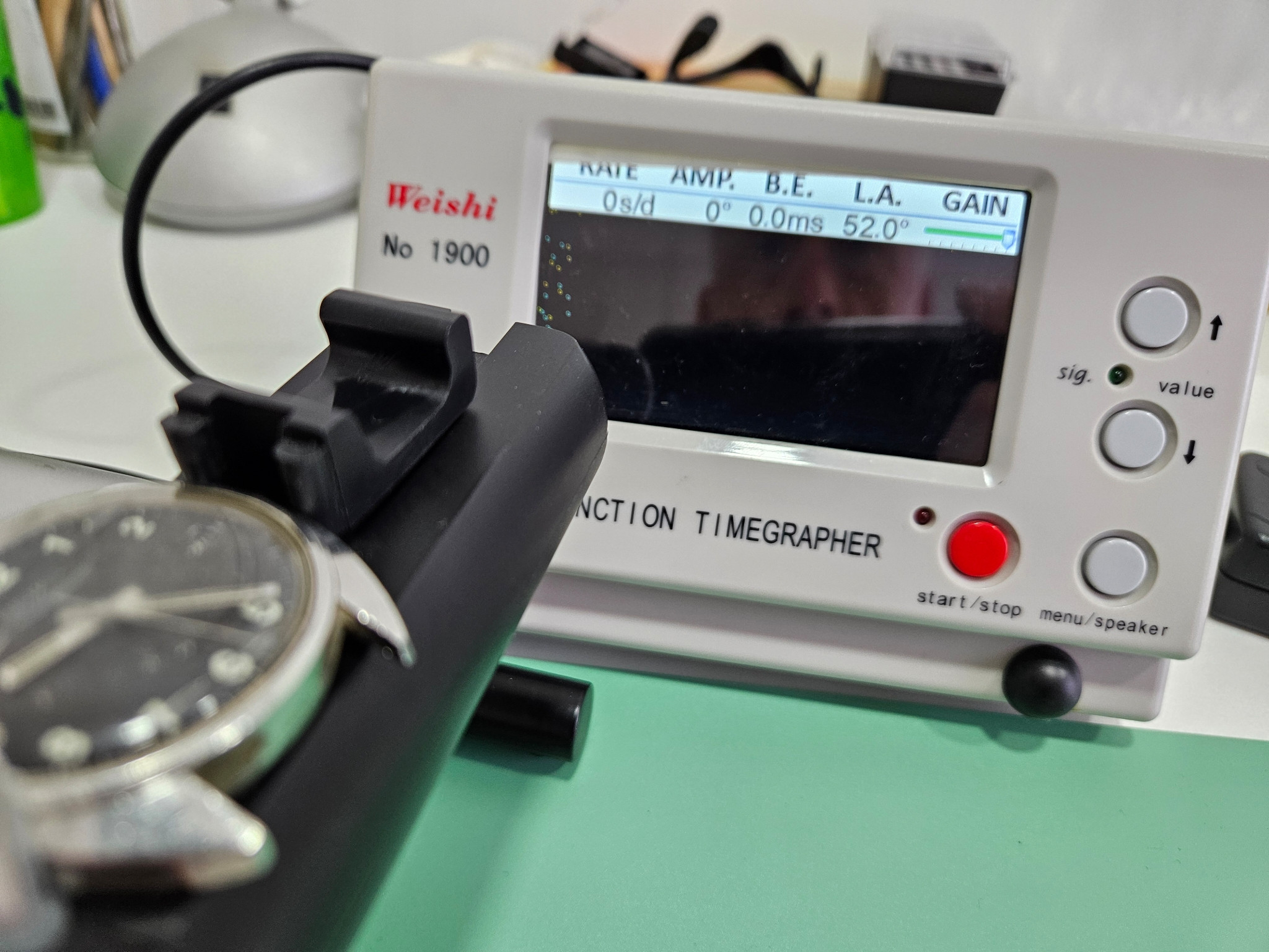

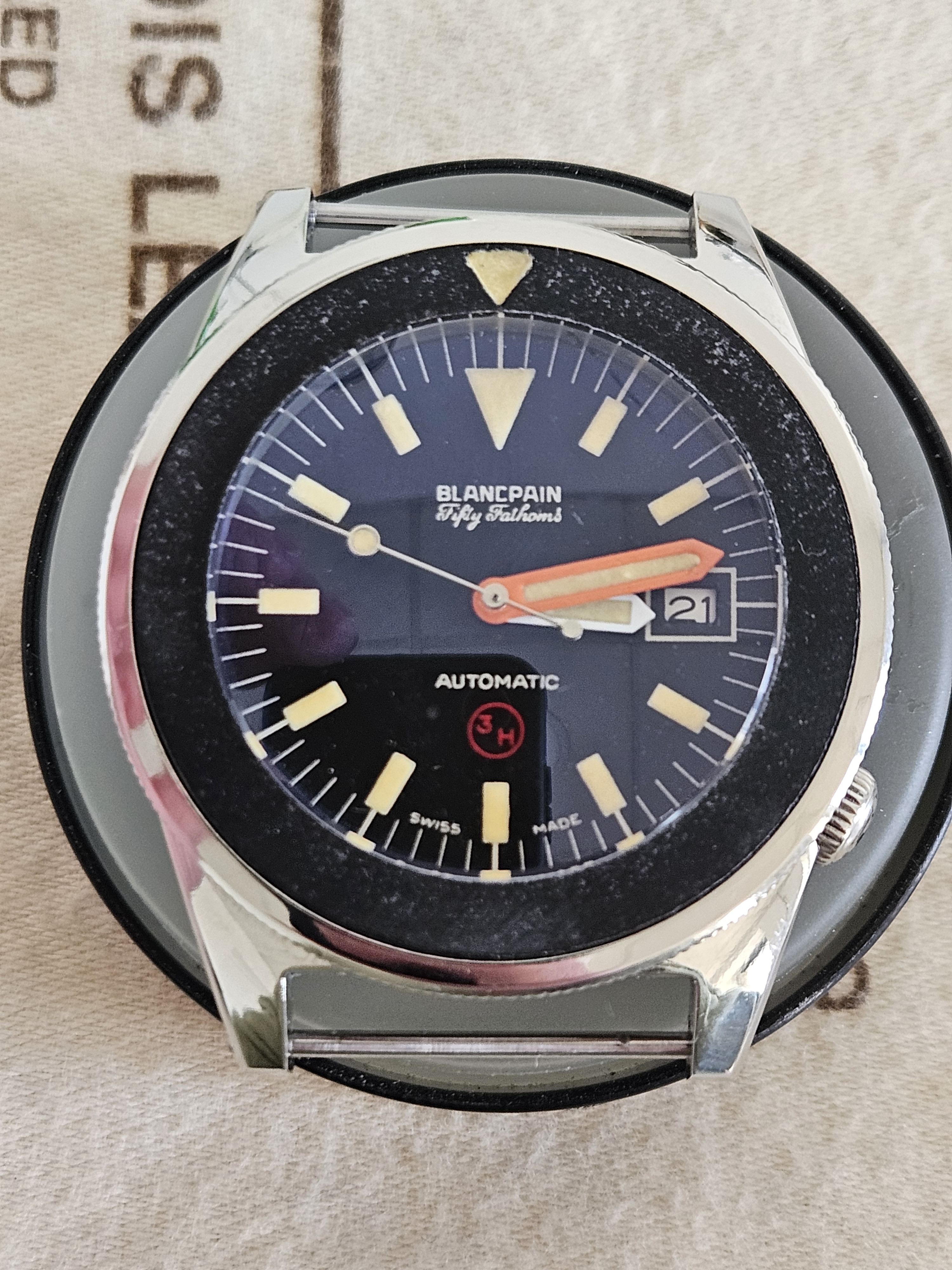

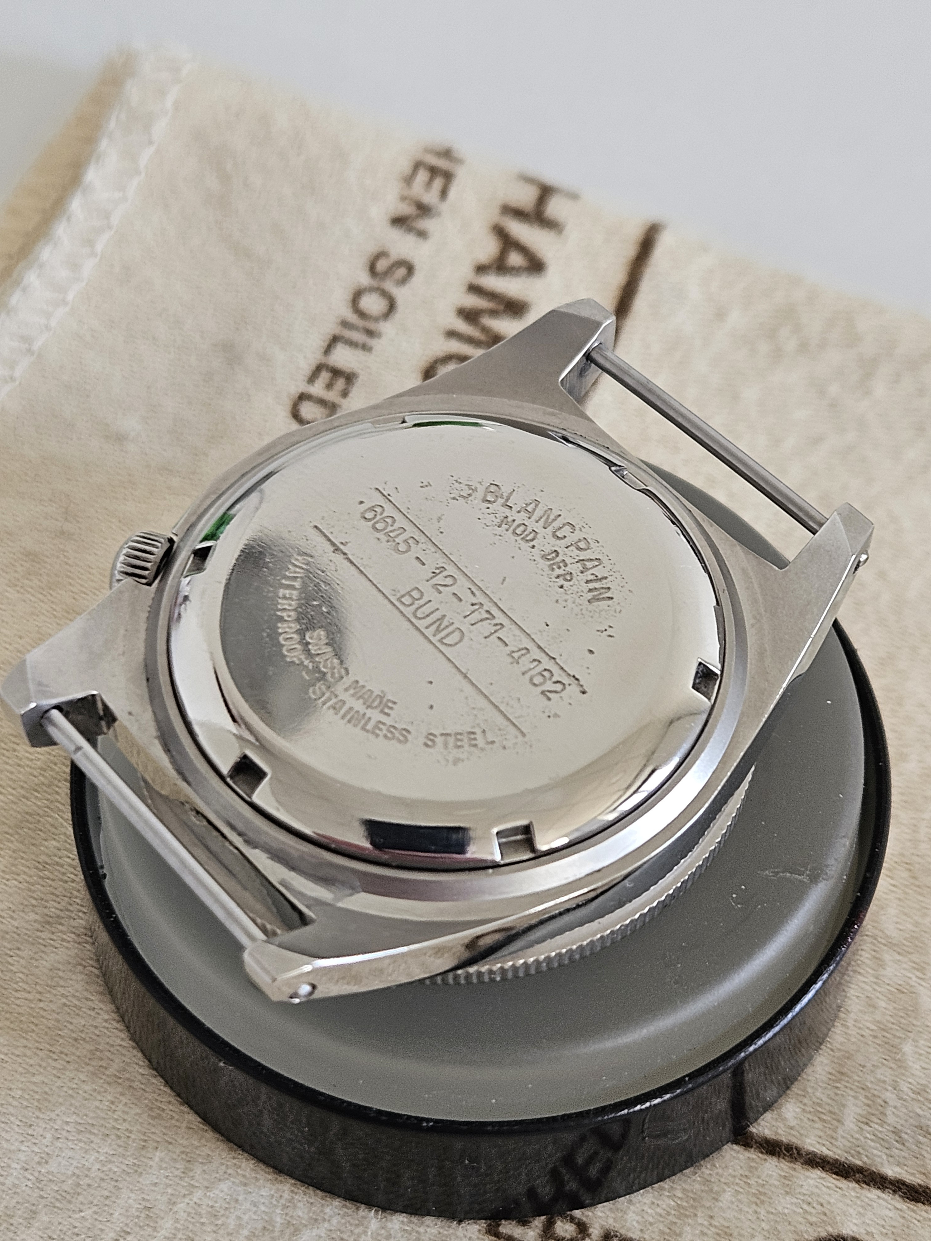

I finished 2 BlancPain BUND3H builds.
These projects had been delayed because I wanted to improve the design of the insert to be even closer to the original.
I worked on it for several months, but in the end I had to settle for making the same inserts as the previous ones.
So far, the owners seem to be very happy with the final products.
Of course those watches have been WP tested up to 5ATM and regulated around +2/-2 seconds/day
To be more precise, I've finished 3 of them, but the 3rd member has withdrawn.
So I'm going to keep the 3rd BUND for some time, even if it's a bit big for my wrist.

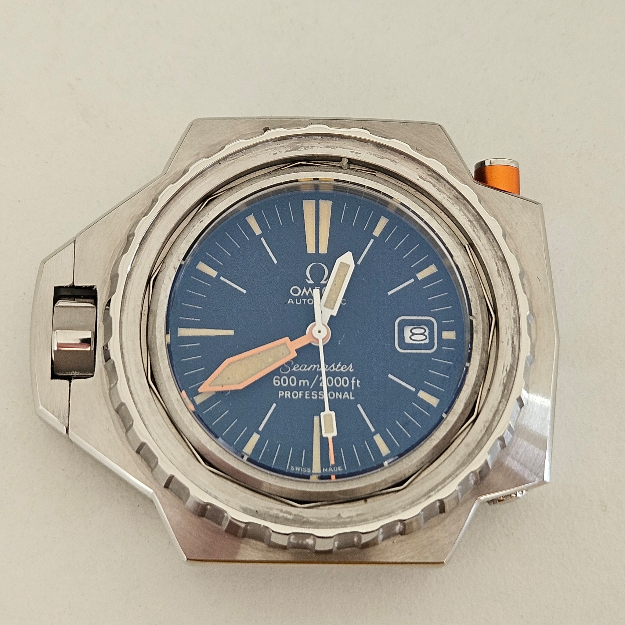

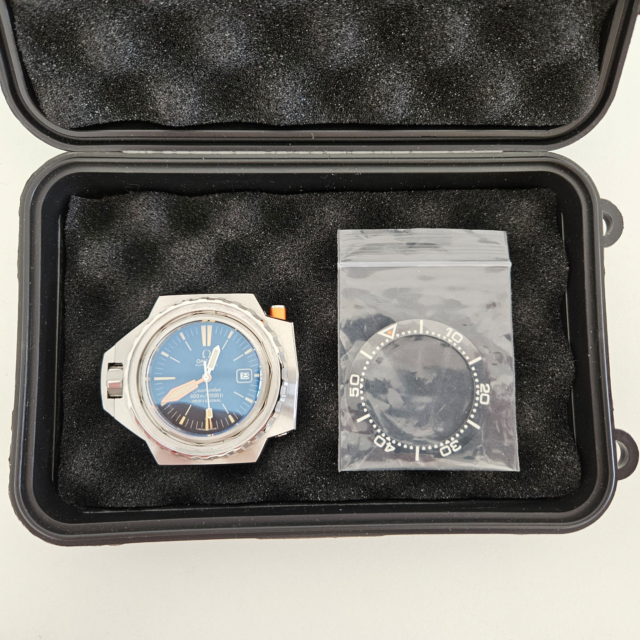

I also finished a vintage Omega PloProf 600m build with a dark blue custom dial.
That one too was delayed because of the insert ... and because of my fault :rolleyes:
The owner was happy to keep the original insert but I really wanted to make that build better.
So I delayed the finish and tried to make a vintage lumed plexi insert.
I made tons of tests but finally got results not good enough IMO.
So I finally finished the build and sent it to it's owner.
However ... I will keep trying to make a convincing vintage lumed insert on my spare time.
And if I ever succed I will send one of those free custom insert to the owner ... for free of coursen to thank him for his patience 🙏

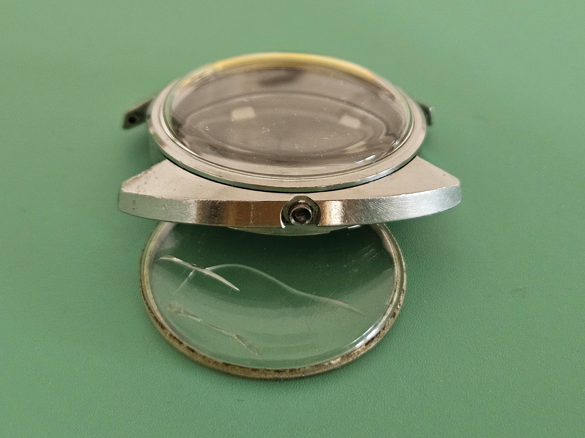

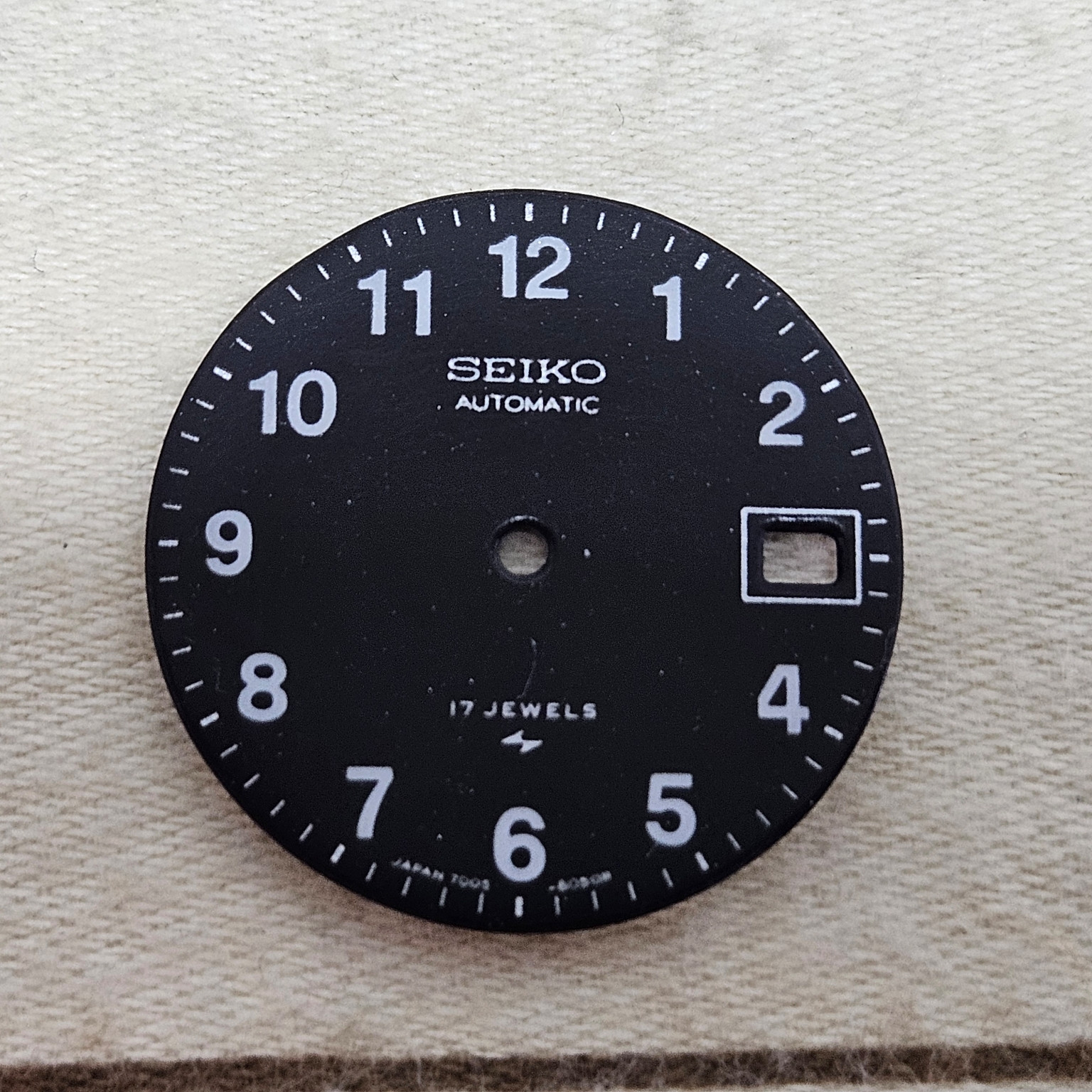

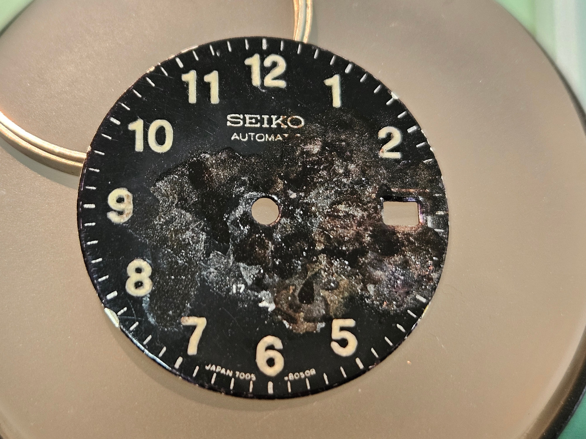

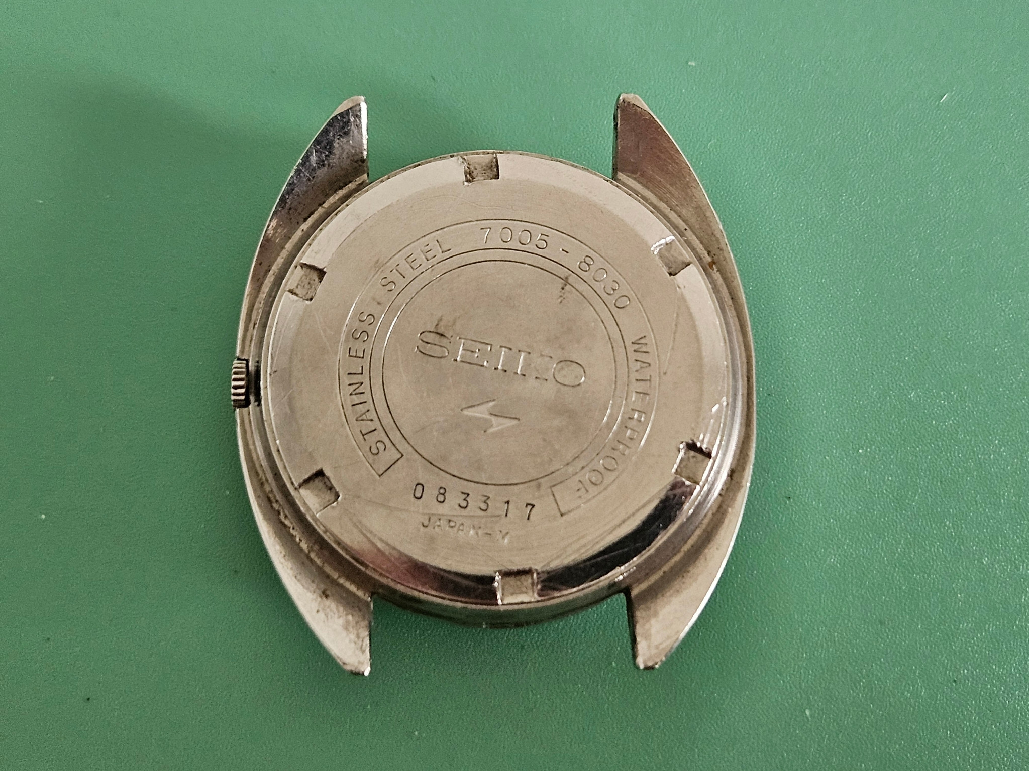

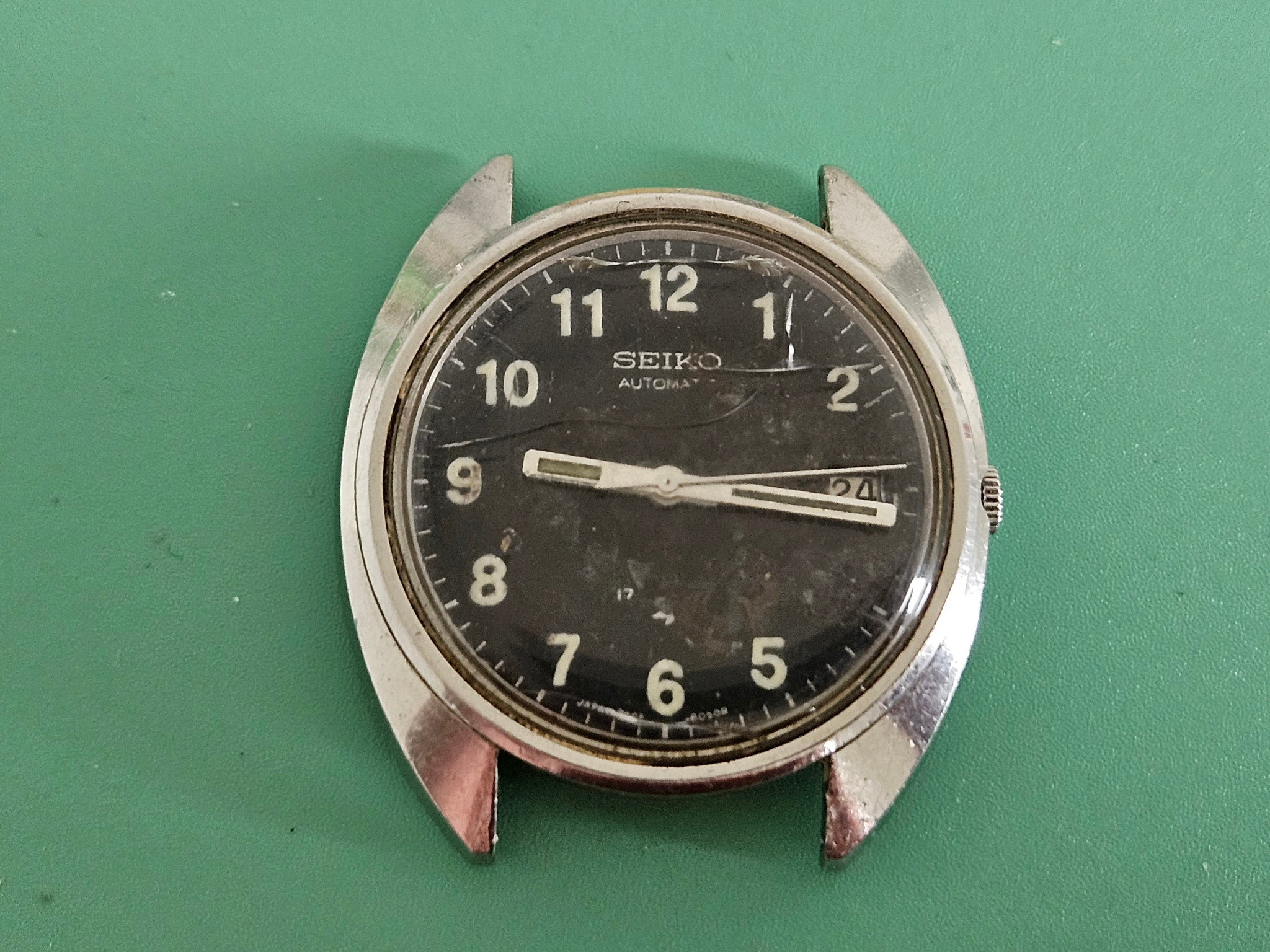

I worked on a Seiko 7005-8030 MACV-SOG in pretty bad condition :
- the movement was not working
- the plexi was cracked
- the dial was ... deadly abused :eek:
I replaced the plexi and buffed the case just a bit (the owner wants to keep the vintage look)
I've reprinted the dial ... waiting for the lume work.
BUT ... I'm still fighting with the movement to bring it back to life :rolleyes:
I'd like to keep all the parts original but I guess I'll have to replace the mainspring and the balance spring.

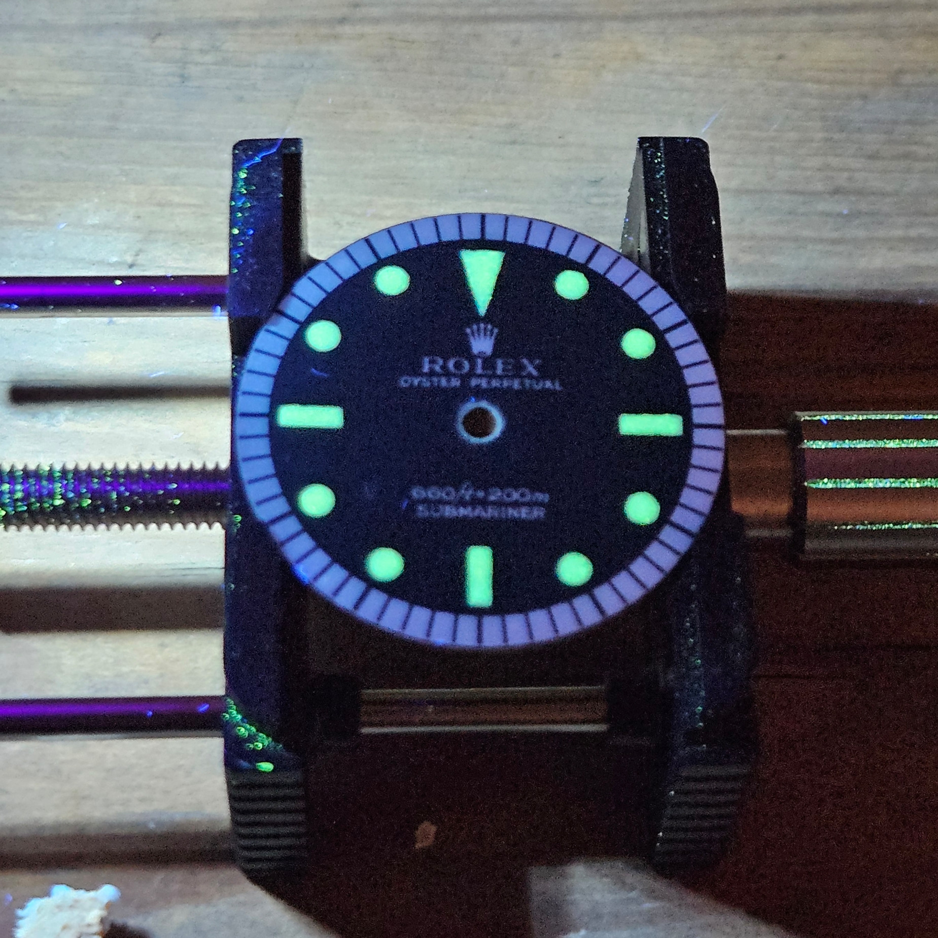

At the beginning of March I had to spend a week looking after my 94-year-old mother who had a fall.
During those days I wasn't able to devote a single minute to working on dials or watches, but in the evenings when she was asleep I was able to play little chemist ;)
The aim was to imitate the reaction of an old tritium lume when exposed to UV light :
- green luminescence under UV light
- brightness lasting a second after the UV lamp is turned off
I'll post a detailed thread on this experiment as soon as I can, but today I just want to show you the result I got.
Video of an old tritium dial under UV light :
Video of my special mixture under UV light:
It's not perfect but pretty close IMHO :cool:
I'll try to modify the mix to make it look better and I'll test it "in real" ... mixed with matte medium and applied on a dial hand handset.

I lumed an old dial and made an UV reaction test.
The glow only lasts only a second after the UV lamp is switched off 😒 unfortunately that's the best I can do at the moment.
I'm stubborn so I'll keep improving my mix but I think I'm on the right path.

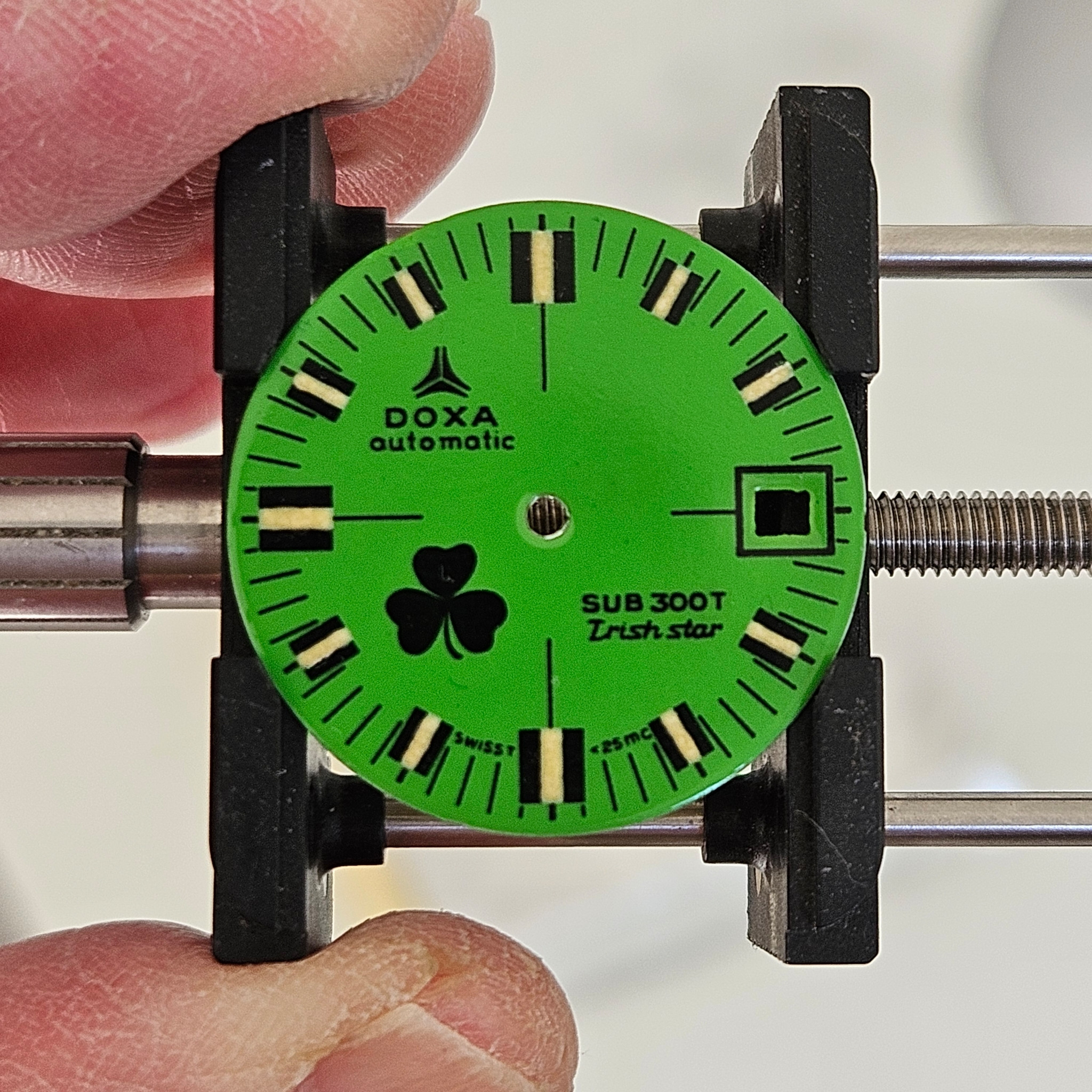

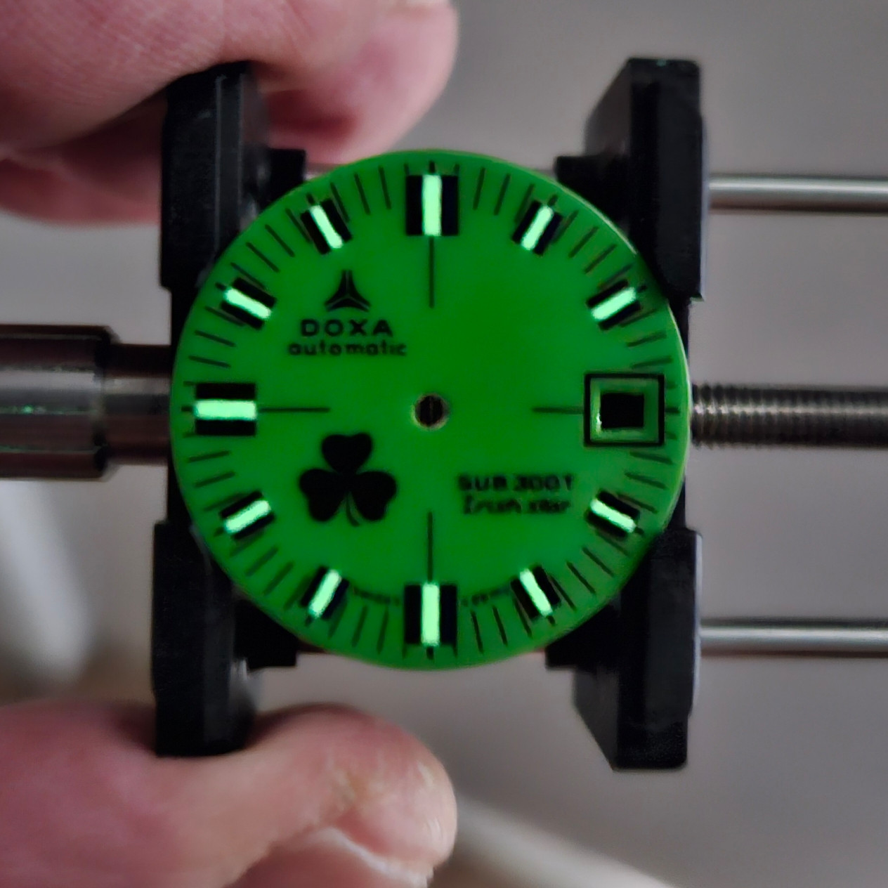

Today I finished and lumed 2 dials :cool:
DOXA IRISHSTAR ... for gen Doxa SUB 300T
5513 BLACK PIANO DIAL ... for 5513 movement
White Lume
Not too flat ... not too puffy
Exposed to halogen light
Light off ... checking the lume doesn't charge
Exposed to UV light
