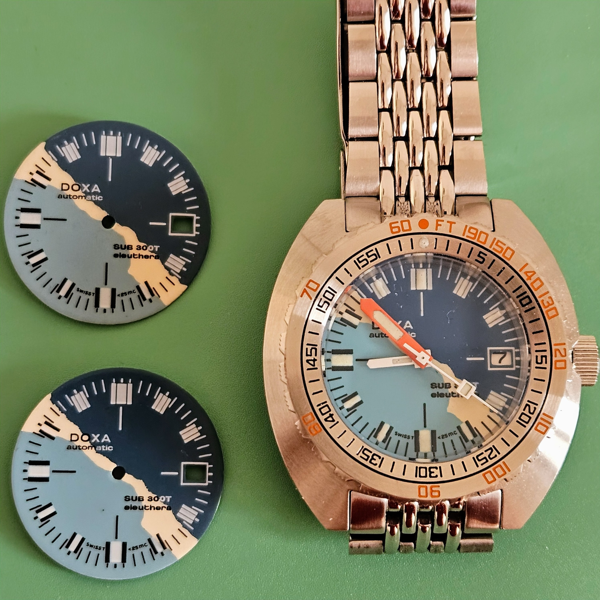

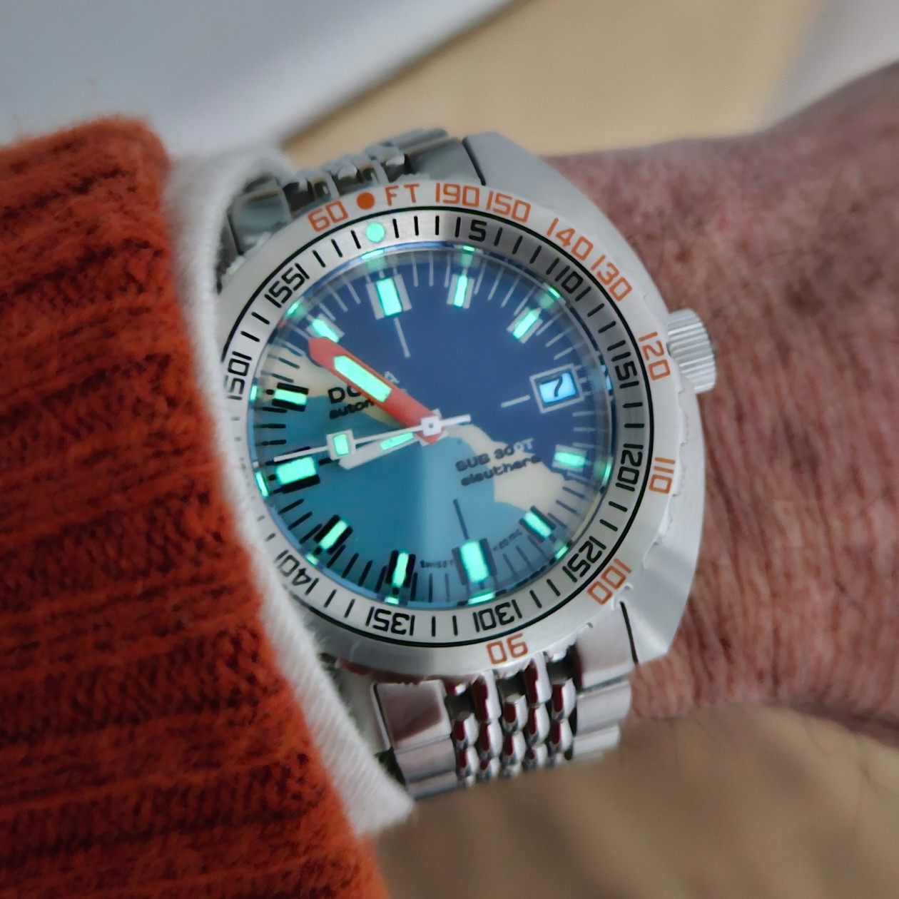

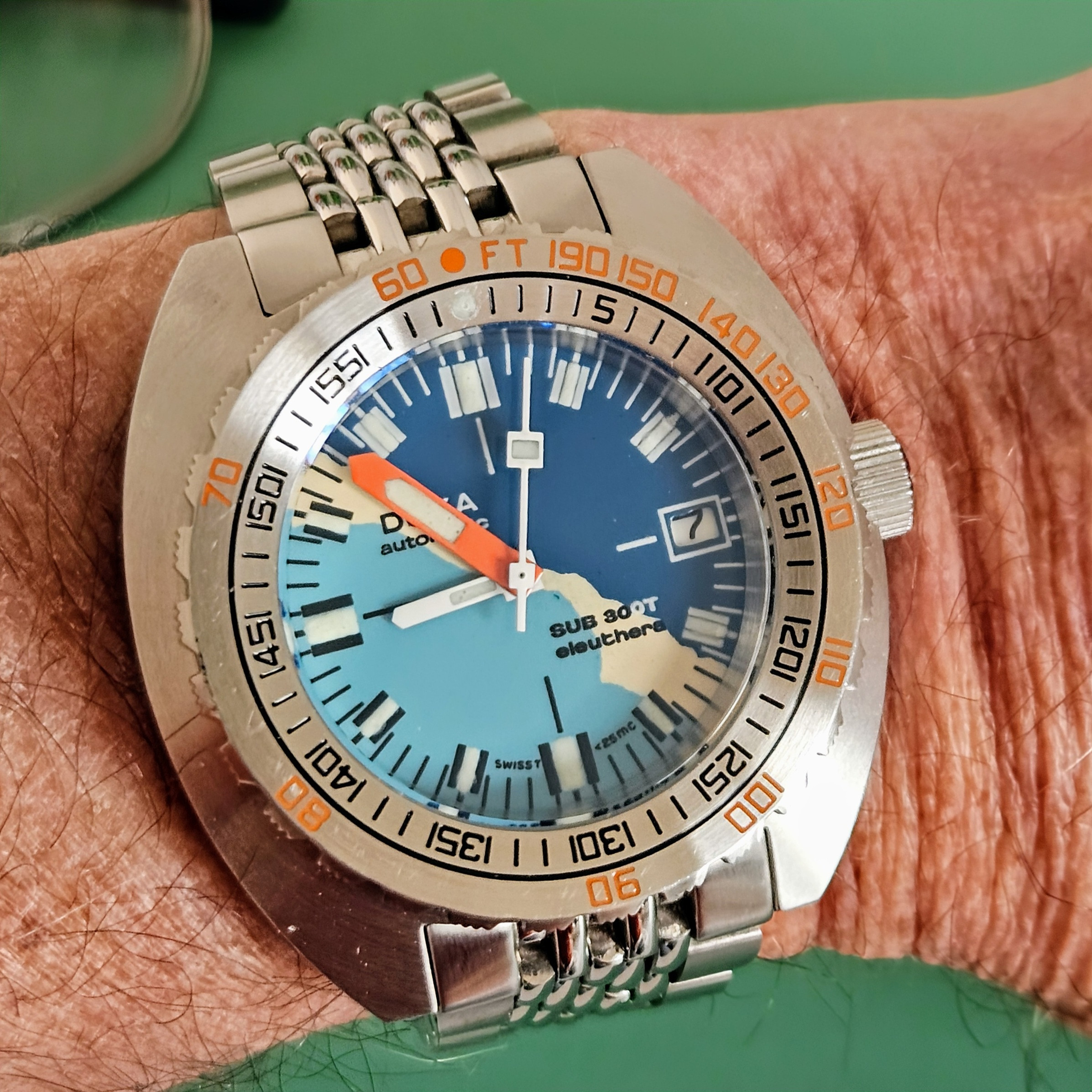

Last week I found some time to work on an old personnal project I posted here on June 2022.
When I first posted about that dial I really had no idea on how I would make it or if I could ever do it.
But time has past and I learned some new tricks ;)
So today I'm happy to tell you that the ELEUTHERA now really doest exist and ... if I may say so ... it was worth the wait :cool:
Someday I'll probably redo the lume with light blue glow on dial and handset to match the blue lume on the datewheel.
But all in all I'm happy with that watch and I hope you'll like it.

It looks awesome, and also pretty complicated. Anything you can share about how you made something that technical, or the tricks you've learned since you originally started on it?
Really curious, but I certainly understand if you don't want to share your trade secrets. It looks like it was a difficult task, and you still completed it with borderline perfection.
Indeed ... making that one was a bit difficult and time-consuming :rolleyes:
To make a long story short it's a 9 steps process :
- 3 steps to paint the dial plate (1 step for each color using paint masks)
- 2 steps for the white print (to get a clean white)
- 1 step for the black print
- 3 steps for the final varnish (varnish / matte sanding / semi-gloss polish)
I had to make tens of tests (trials and fails) until I got satisfactory results :eek:

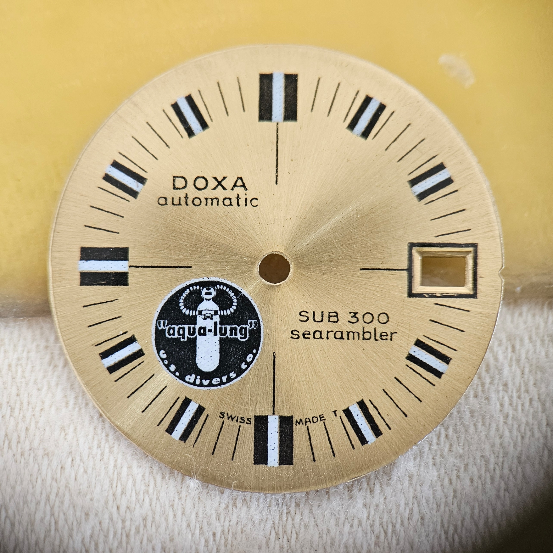

I forgot to share pics of another dial I first posted about late December 2021.
At the time, I had already done the drawing and it took me several years to complete it.
But today I'm happy to share the BLACKLUNG SEARAMBLER :p

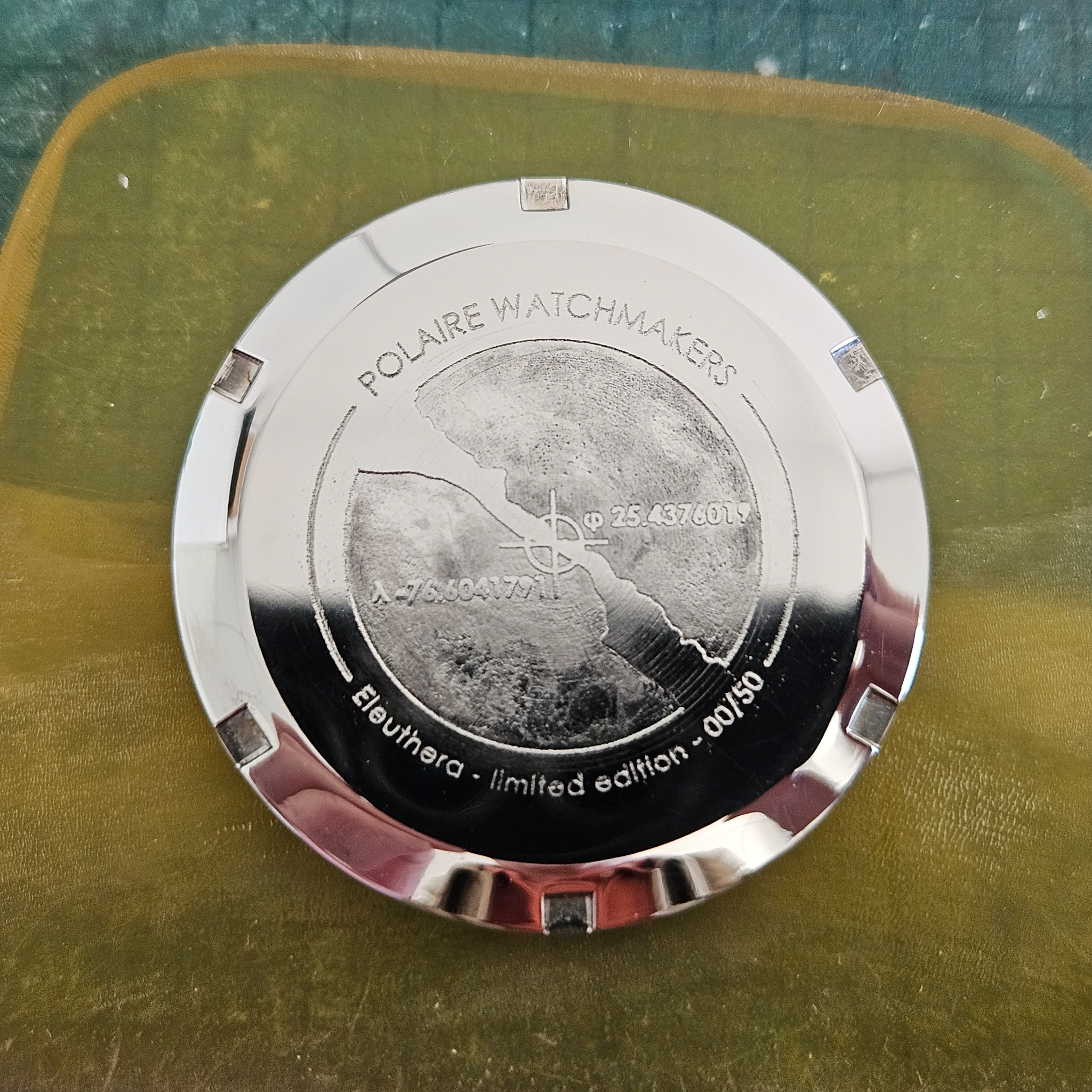

Recently I took a different route with my Eleuthera project.
Rather than do a Doxa tribute, I decided to make a watch in my own name ... more precisely in the name of my brand new company "Polaire WatchMakers".
I'm planning to produce a limited edition of 50, which I'll put up on Kickstarter before the summer for production in the autumn, or sooner if everything goes well.
The dial, which I'm still working on, will remain virtually the same except for 2 differences :
- PWM (for Polaire WatchMakers) will replace DOXA above the "professionnal".
- SWISS at 6:00 will be replaced by a unique number (01/50 to 50/50).
As usual, each dial will be made by hand, but this time each dial will be unique, as it will be numbered from 01/50 to 50/50.
Both caseback and clasp will be engraved.

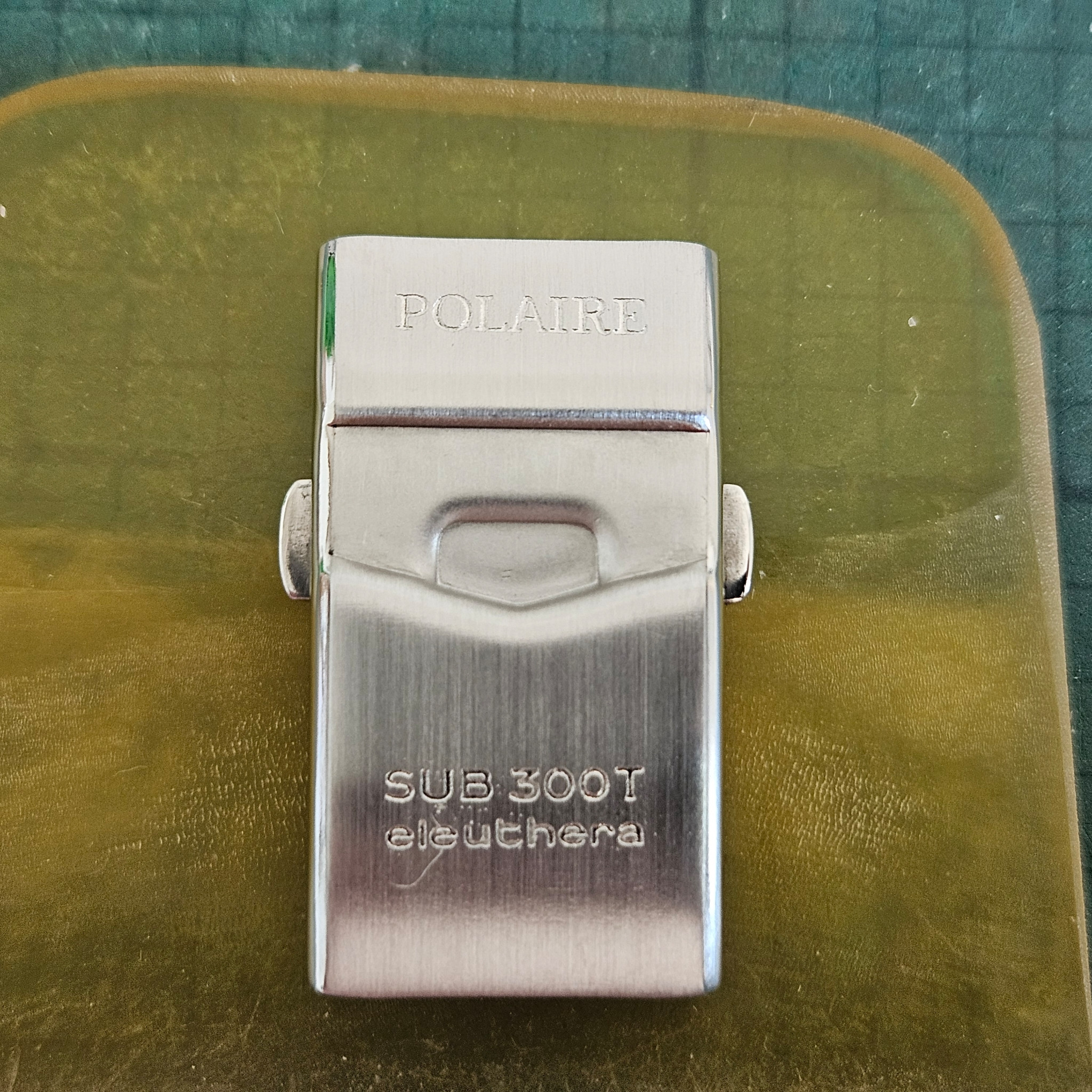

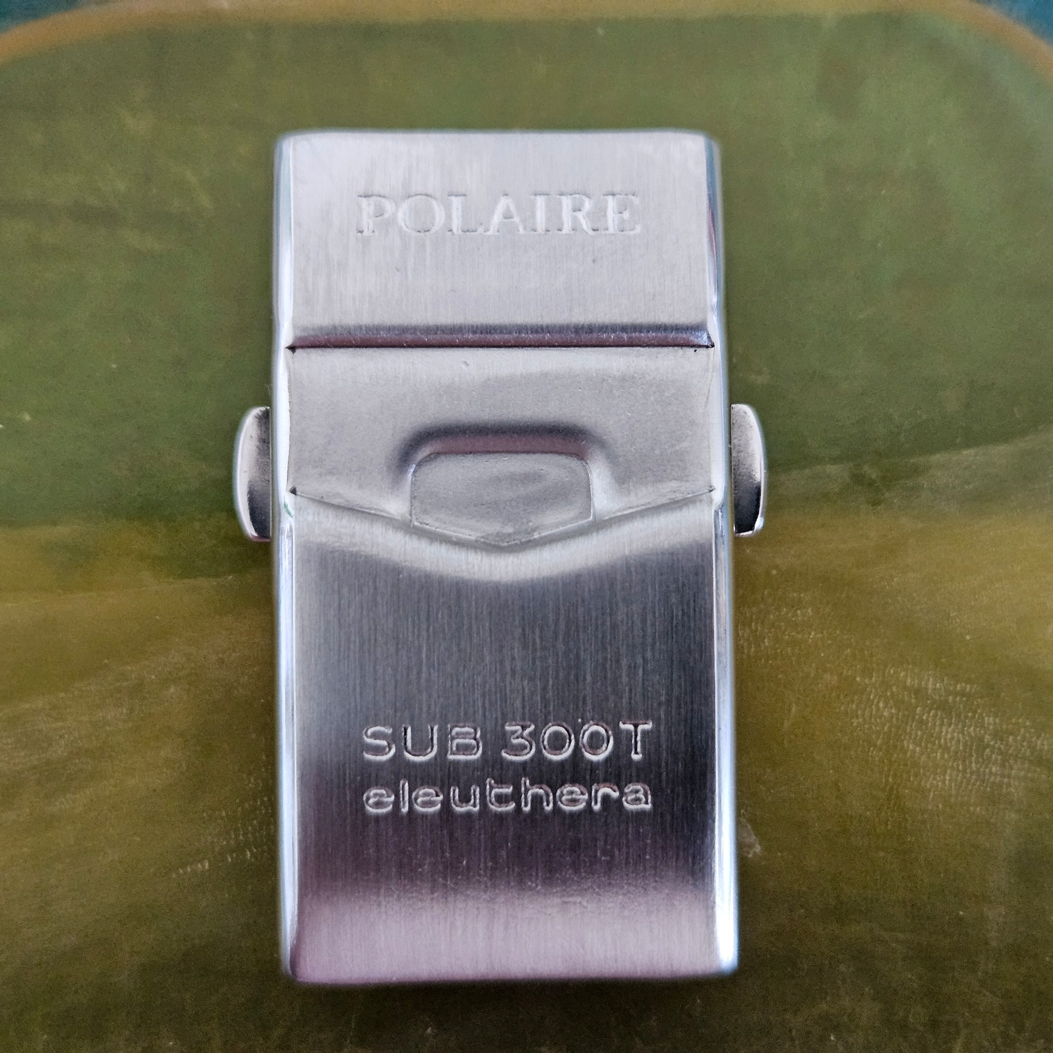

The clasp will bear the name POLAIRE and the name of the model.

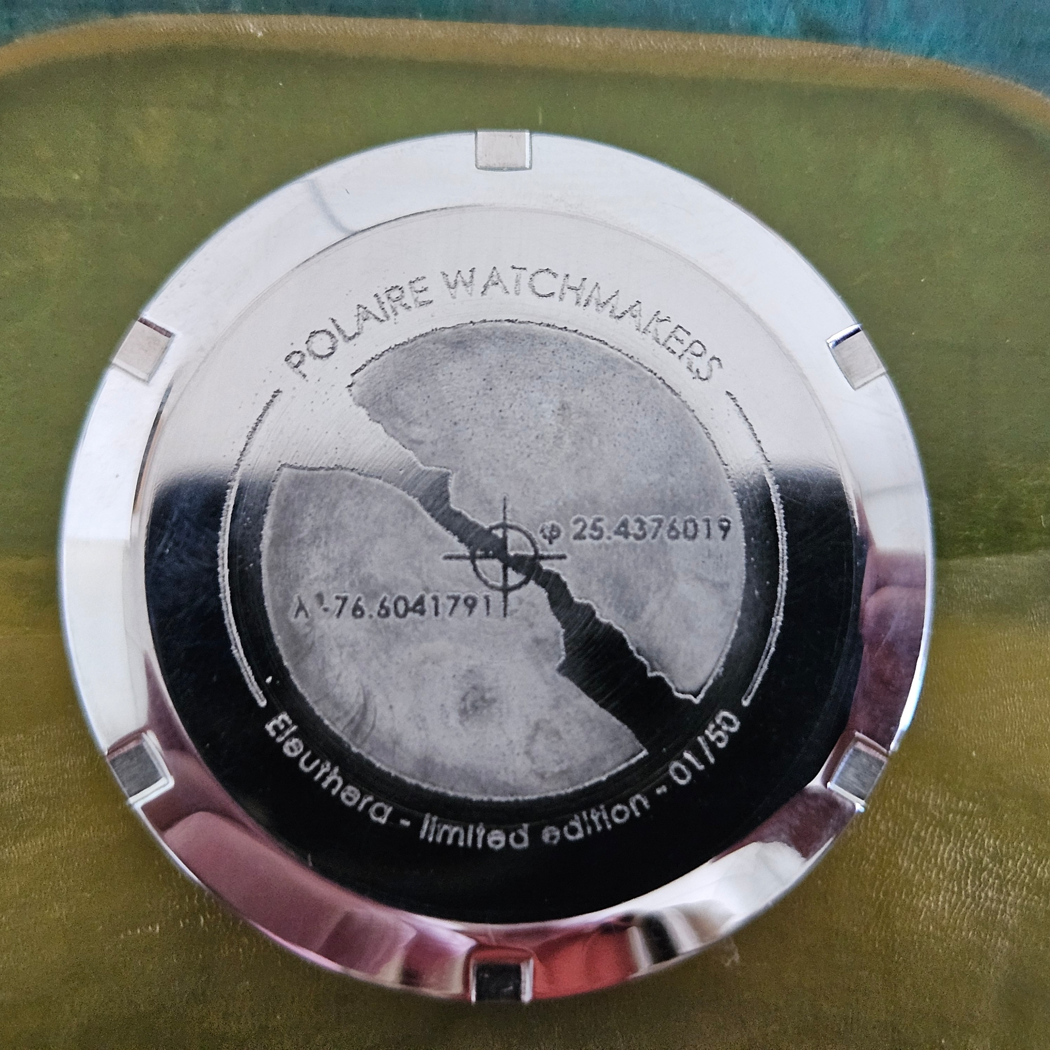

The caseback will be engraved with the Eleuthera silhouette, the name of my company and the model, as well as the inscription "limited edition" followed by the number of the watch in the serie.
I've also added the latitude and longitude coordinates of the "glass window bridge", the geographical point on which I've centred the dial design.
I hope to be able to complete the prototype (00/50) and the first example (01/50) by the end of this month.
For the moment I can show you the case back and the clasp of the prototype.
I hope you like these pics ... don't hesitate to let me know what you think !

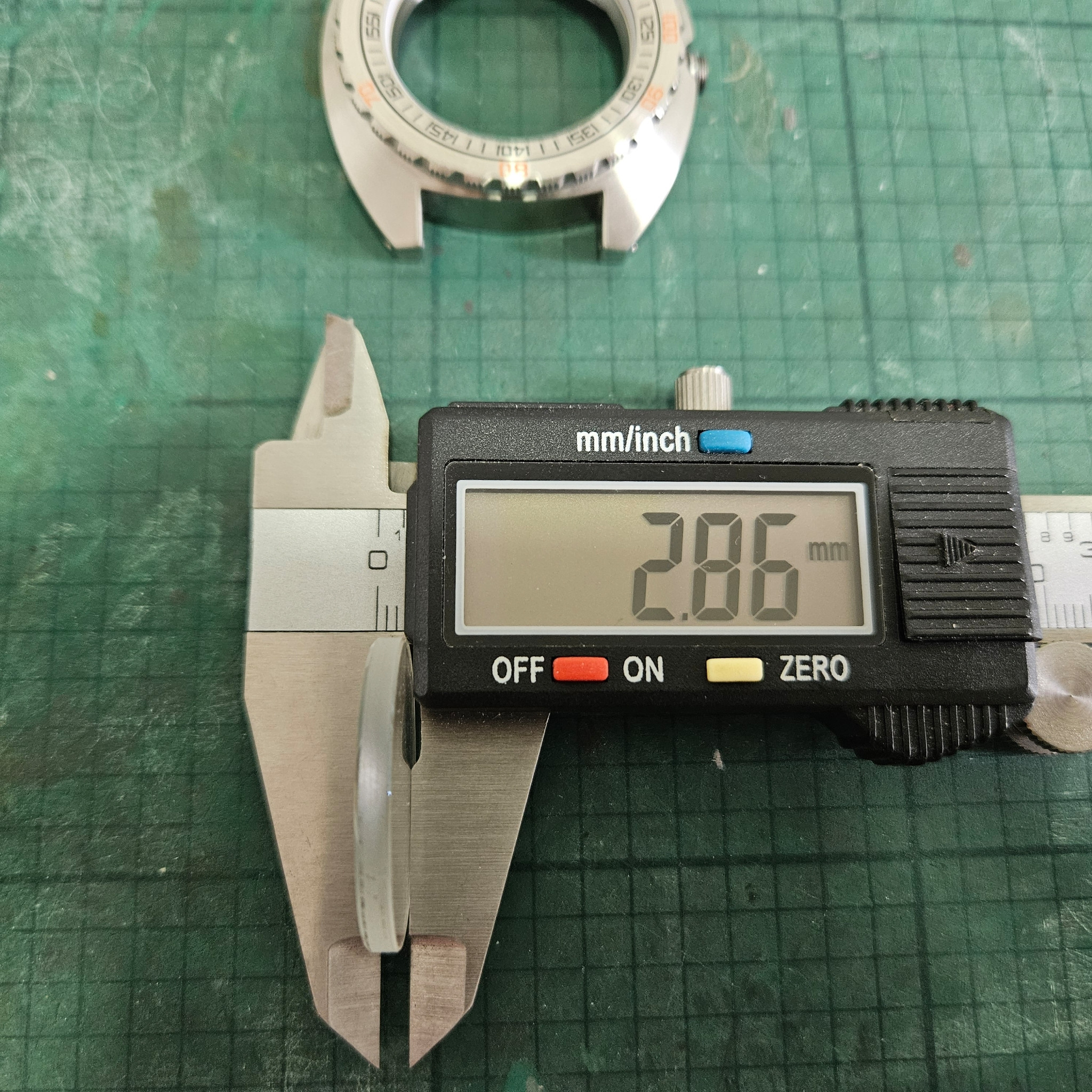

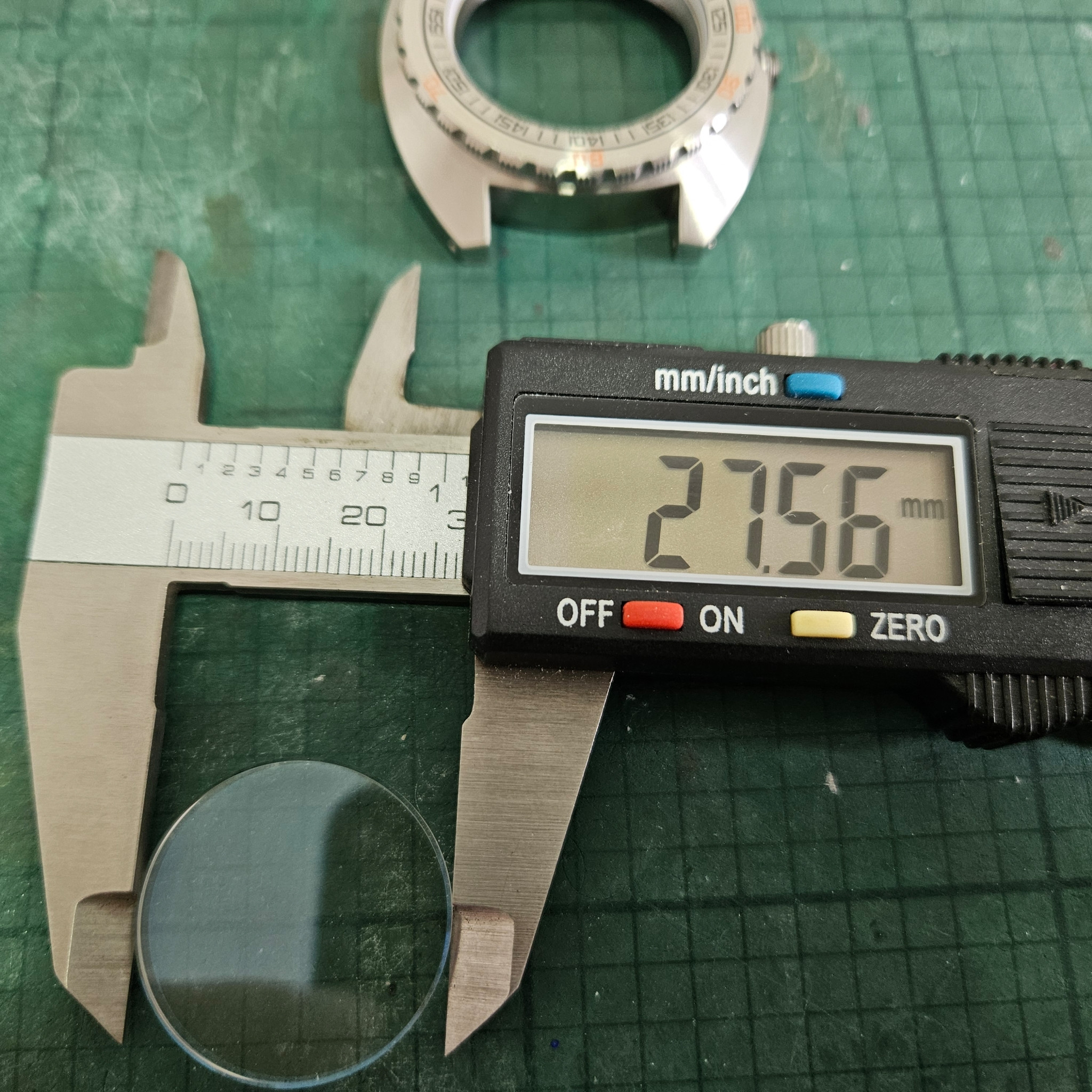

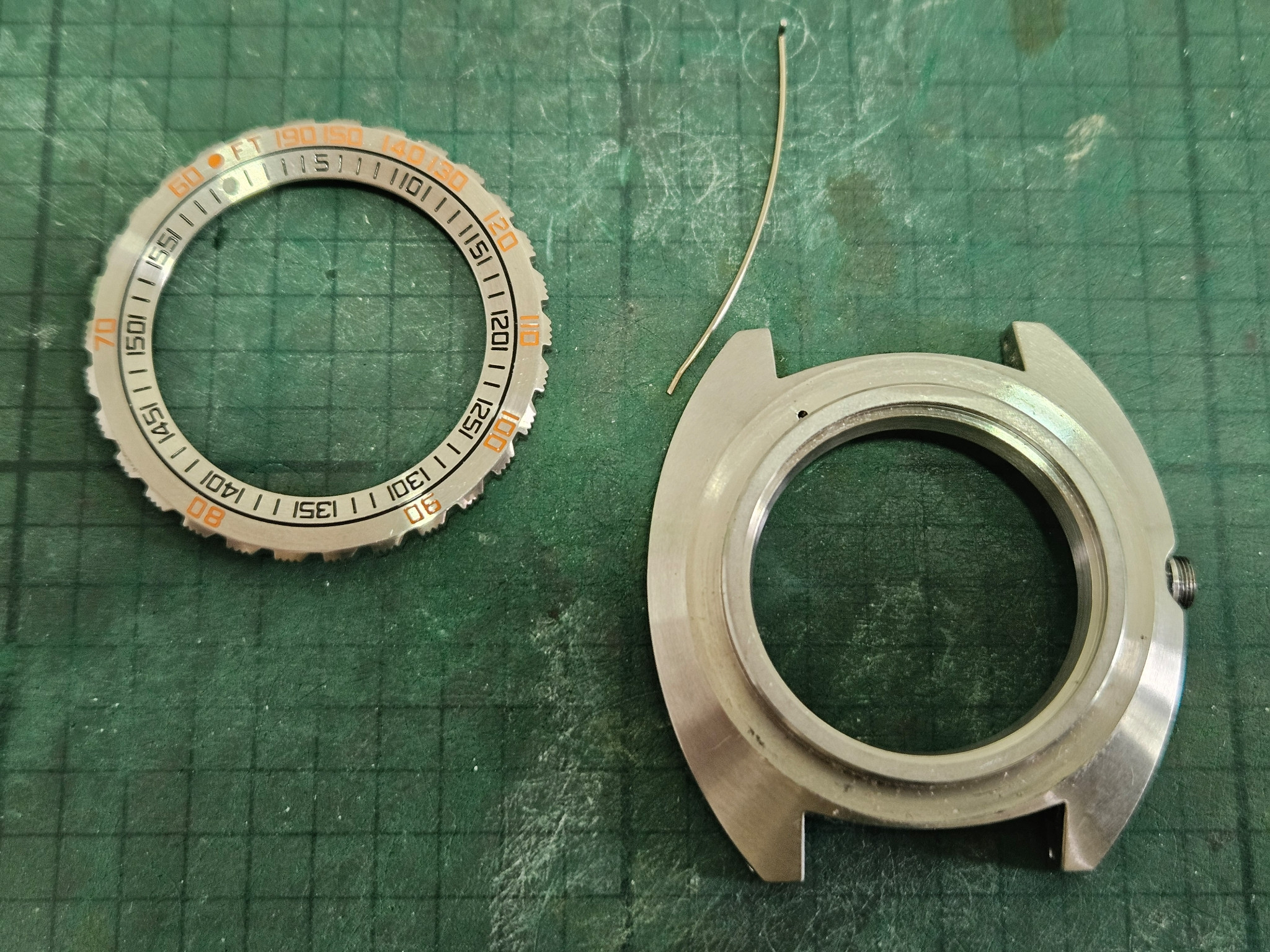

Many members are wondering whether it would be possible to modify a SUB 300T Seestern case with a thicker domed glass... and to be honest, I've been wondering the same thing for months/years.
So today I decided to check by myself :geek:
I disassembled one of my SUB 300T cases and popped out the sapphire to measure its dimensions:
- Diameter: 27.56 mm
- Thickness: 2.86 mm
After some research, I ordered two lenses that might work :
- 27.5 mm diameter curved mineral glass ... 3 mm thick at the edges and approximately 4 mm thick in the centre
- 27.6 mm diameter curved hollow acrylic glass ... 2 mm thick at the edges and approximately 3.5 mm thick in the centre
I'll post an update here as soon as I receive them and try them out.
But the hunt is on, so feel free to look for yourself and reply to this post.
Since I was taking a risk, I might as well take two.

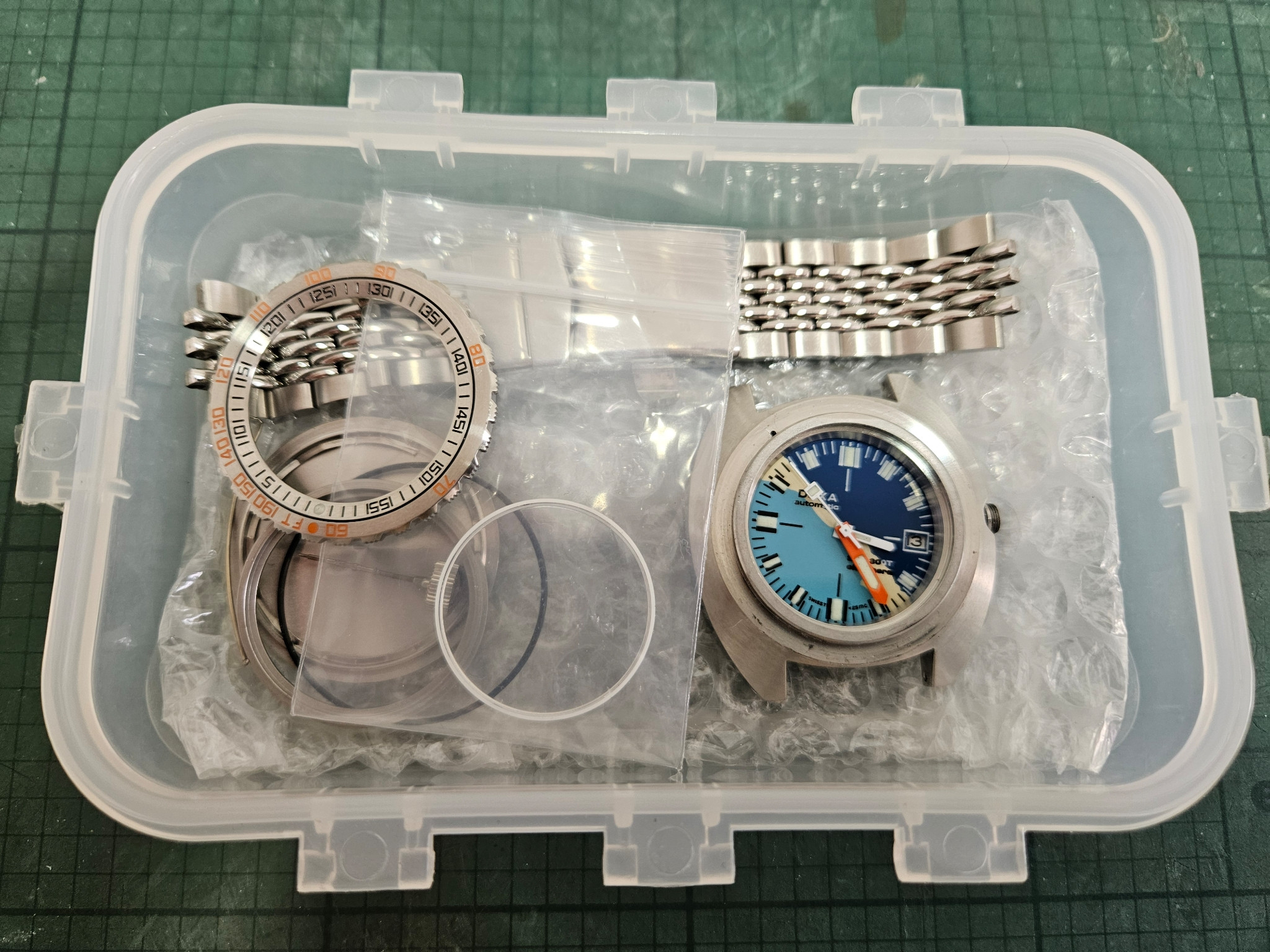

So I decided to remove the rotating bezel as well.
It turns out to be solid (no insert) and is held in place with a paperclip spring.
After searching for 20 minutes for the click spring (the one that fits into the inner grooves of the bezel) I managed to put it back in and then take it out again.
My watch will remain in this state, safely stored in its box, until I have tested the glasses I ordered.
