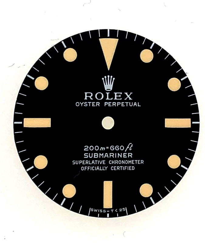

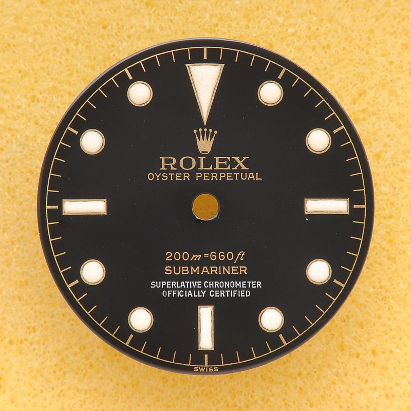

Thought about doing one of these, but think the Ruby's is probably a better choice
Dial - https://rafflesdials.com/vintage-st...ota-8215-movement-29mm-super-yellow-luminova/
or
https://rafflesdials.com/vintage-st...movement-29mm-gilt-and-super-yellow-luminova/
