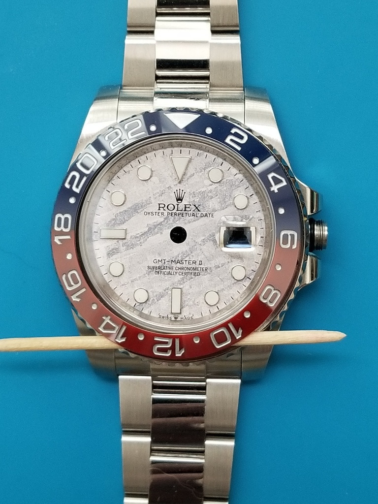

The bezel is fitted and the spring then should slip on the teeth as the bezel is rotated.
Sometimes bezel rotation is not perfect and this step needs a few attempts. On this occasion it went well and the bezel turns perfectly. Perfect alignment of the crystal retaining ring can help here so that there is less friction, and as mentioned before, the spring washer thickness and surface quality can make a difference too. It is best to check for friction by doing a test fit without the spring washer, only fitting it when the bezel turns freely without it first.
For these steps the insert has been removed, because it can be inserted once the exact position of the bezel is known with the click spring in place. Otherwise you may get poor alignment of the insert pip wish the 12 o'clock marker resulting in having to start again.

Next step - aligning the insert and pressing it into place, starting at the 12 o'clock position. The reason for this is to prevent the area where the pip is glued in from being stressed as there are some thin areas of aluminium there.
The insert was again, quite a tight fit. I couldn't press the last bit in easily, so employed a bit of help from my press.
I was super careful in two ways: 1 - I didn't squeeze too hard (especially to avoid breaking the crystal!!) and 2- I made a cut-out in the plastic first to avoid damaging the insert pip.
After a very small compression it went "click" and I'm now able to move into the final stages of assembly (bracelet, end links).
