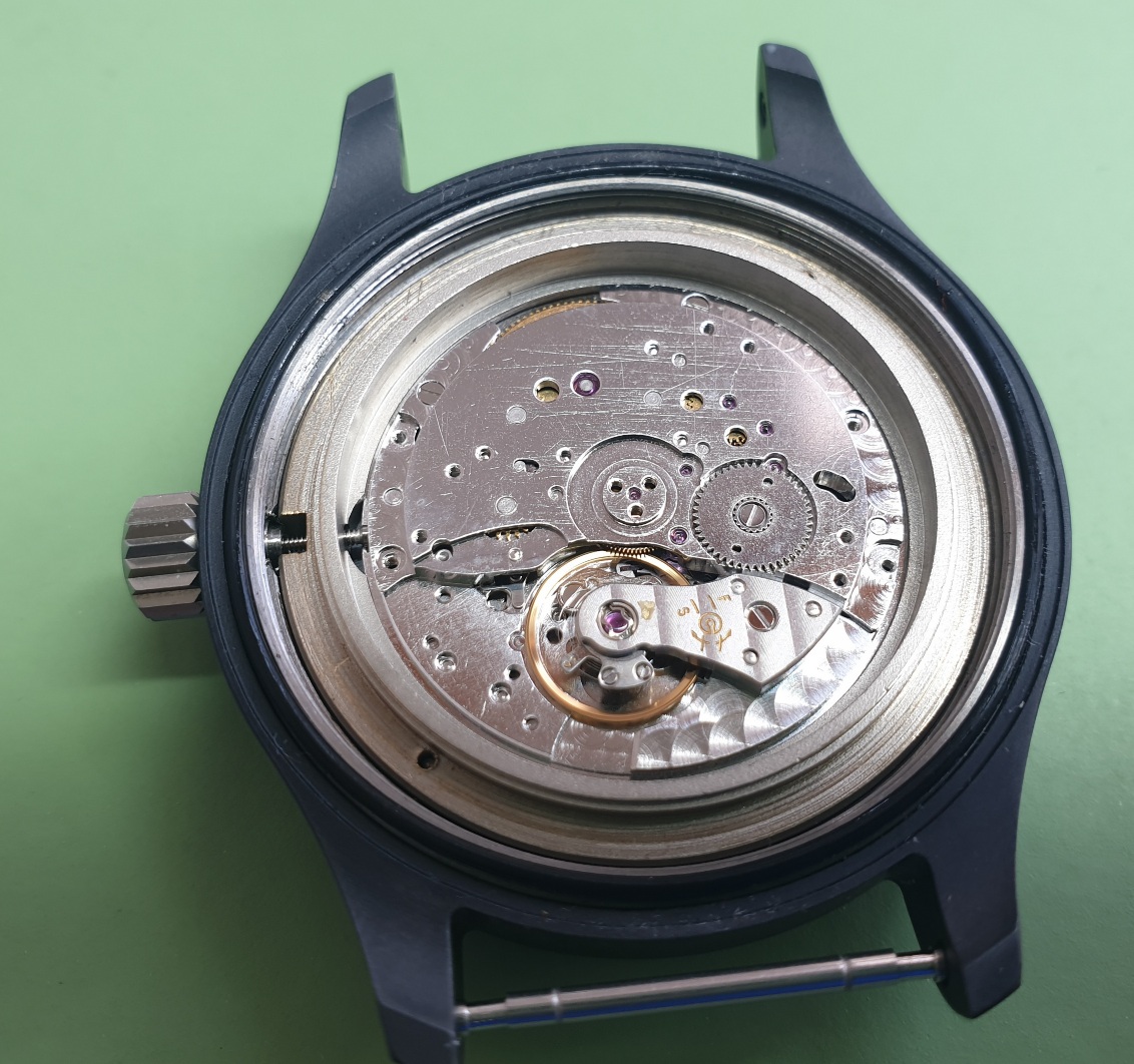

I agree, I was very surprised when the stock rotor wouldn't seat at all. Forgive me for not knowing the proper terms if I make a mistake here, but this is what it appears:
The trainwheel bridge is of a larger diameter on the modified movement and the rotor supplied is not only cantilevered up as noted in the og post, but the weight crimped to the bottom is also thinner. A stock Miyota rotor has a weight that extends too deep towards the center and thus hits the bridge. This also means the stock rotor is a good bit heavier and is why I wanted to swap it out.
On the other side, the calendar wheel is of a larger OD than a stock Miyota and the top plate has a slimmer lip around the edge to accommodate. I didn't take a picture, but I seem to remember that this extra diameter was largely unused, meaning it could be shaved down to fit a stock 9015, but I'm not certain on that.
I wonder if this movement is so heavily modified for a different watch made by ZF and it was just carried over into this one? It really seems that this level of modification is wholly unnecessary for the small market that is IWC, especially ones with a closed caseback.

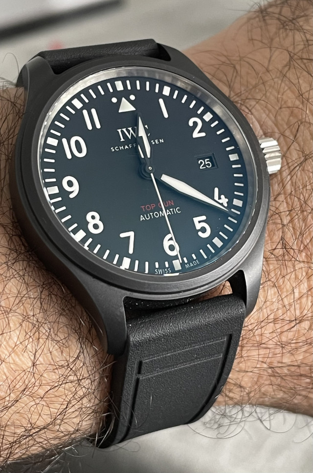

I have had the ZF Top Gun for 4 months and I am overall very satisfied with the watch.
The only thing worth mentioning is the one with the comparatively slightly louder rotor. But that doesn't bother me at all.
Overall, it is a very nice and well-made watch.
Reactions: Everett270

swapped for a 2892A2.
very seamless process, everything fit perfectly.
So no modifications to the date wheel? My newly acquired mark xx only has a power reserve of 3-4 hours and I am thinking about a movement swap given everything I have read in this thread.

The ZF VC 4500 has the same fake rotor plate glued on.
And the same screws barely glued in. I took apart the VC and over half the glued in screw heads came off with a light touch from the screwdriver

My theory is the have a bunch of PPF/ZF Miyota based Patek "clone"-movements on stock, which the can use. Because this is how a ZF IWC Mark looks like without decoration. :LOL:
