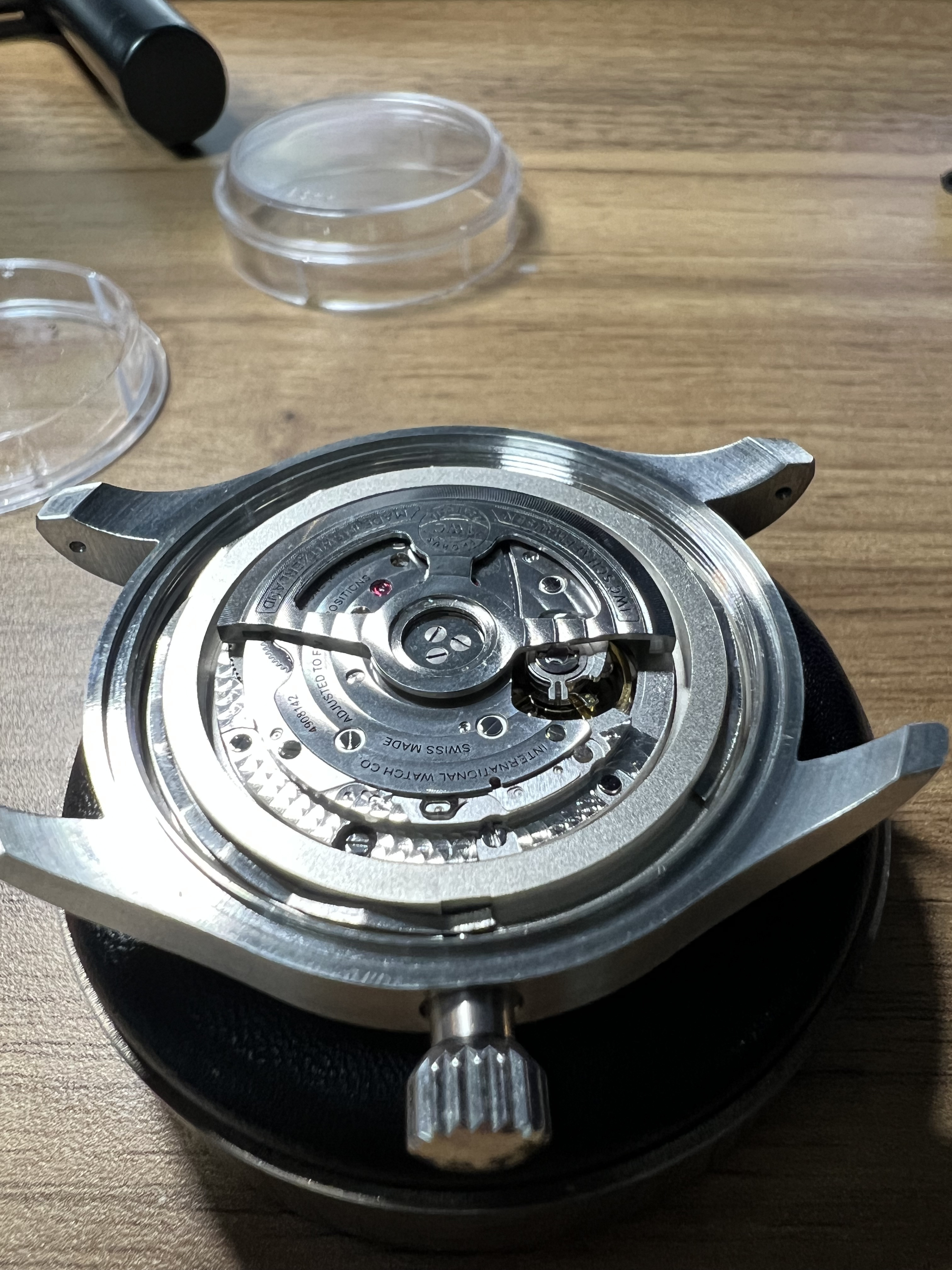

1. ZF does not use case mount screws for the movement. The movement sits in a metal case mount, but the mount itself isnt secured to the case. So the only thing holding the movement in place is the crown stem; and theres a bit of wiggle room between the mount and case. I know some watches use this style, but I dont like this design for a couple reasons: the movement can shake slightly around in the case, especially if the case back doesnt actually contact the mount. It also means dial positioning in the case can vary, meaning sometimes the dial may look skewed.
Because the movement isnt mounted to the case, theres only frictional force holding the movement into the case, which also puts more force on the dial. This causes the dial edges to scratch against the case. Technically it’s not visible in the case, but it’s not a good design nonetheless.

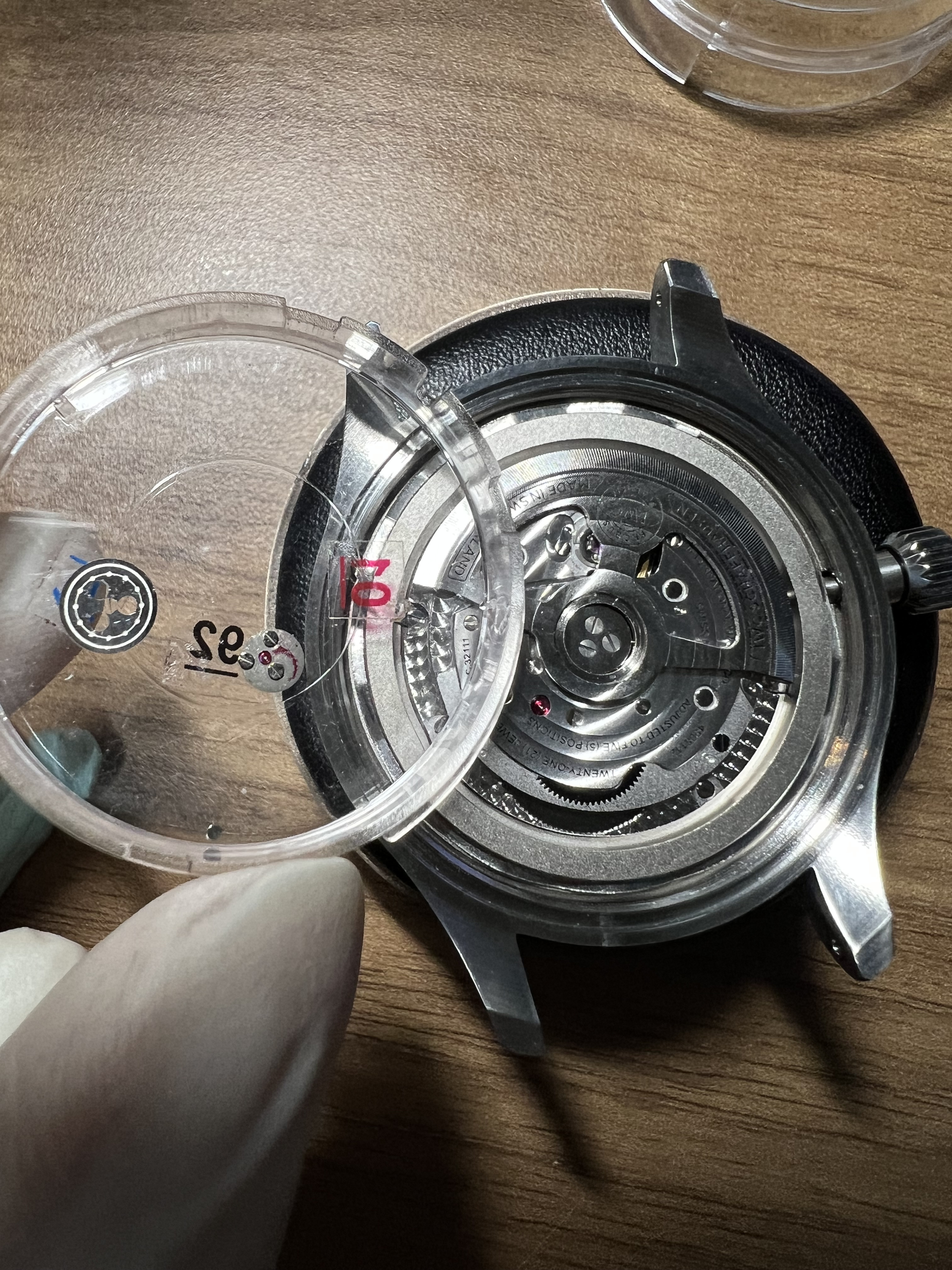

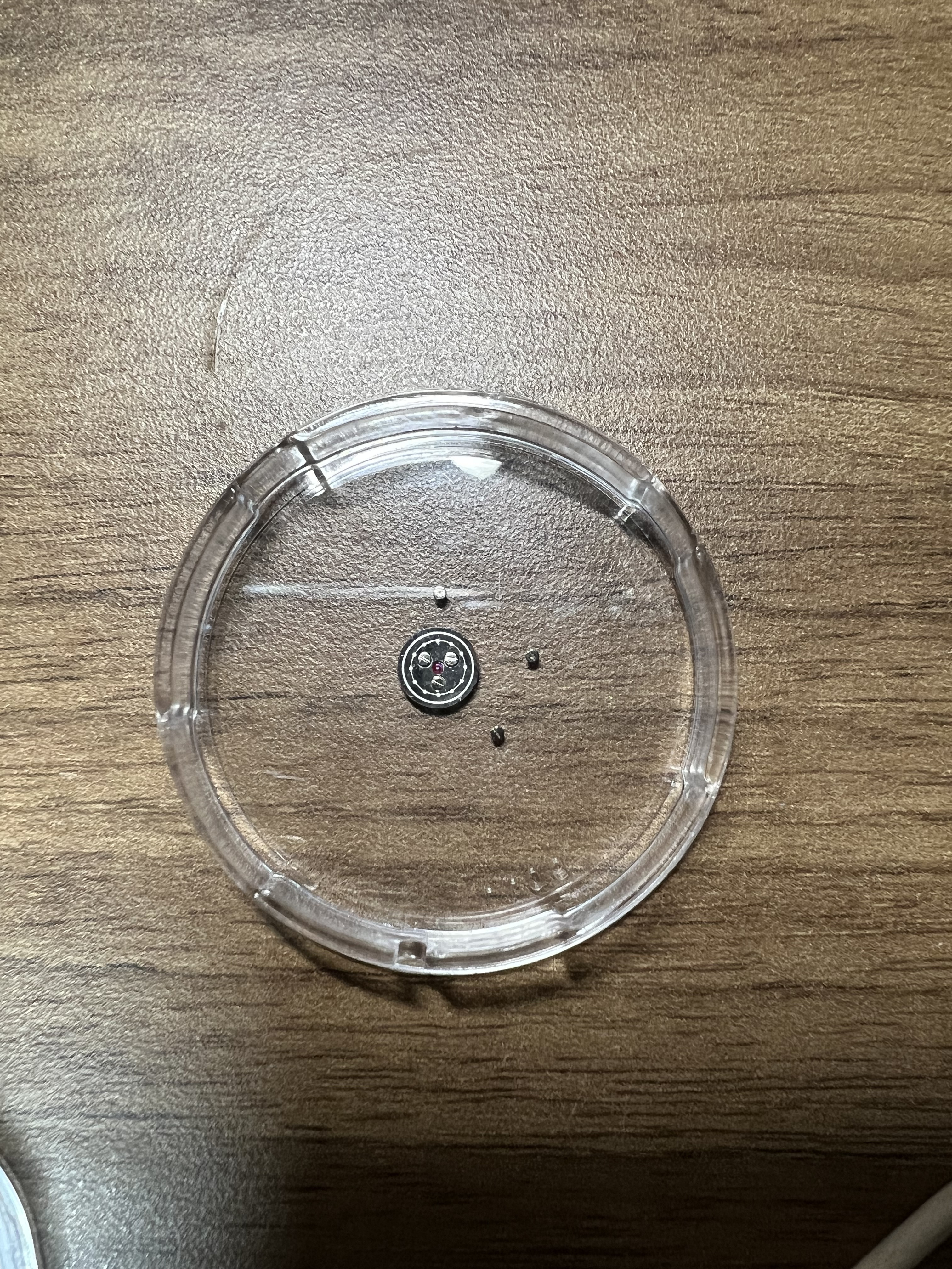

2. This watch is LOUD. It's noticeably louder than my other Miyota 9015 watches. So I went in to tighten the rotor screws to see if that would help. AND THE ROTOR SCREWS FELL IN! I was dumbfounded at first, trying to figure out how in the world the rotor is attached without the screws. But then I realized the outer rotor plate is a fake decoration. I removed the decorative plate (which was very lightly glued to the rotor) and below were the real rotor screws. (BTW, tightening the screws didn't quiet the movement so I'll have to go back in with some lubricant if it bothers me enough).

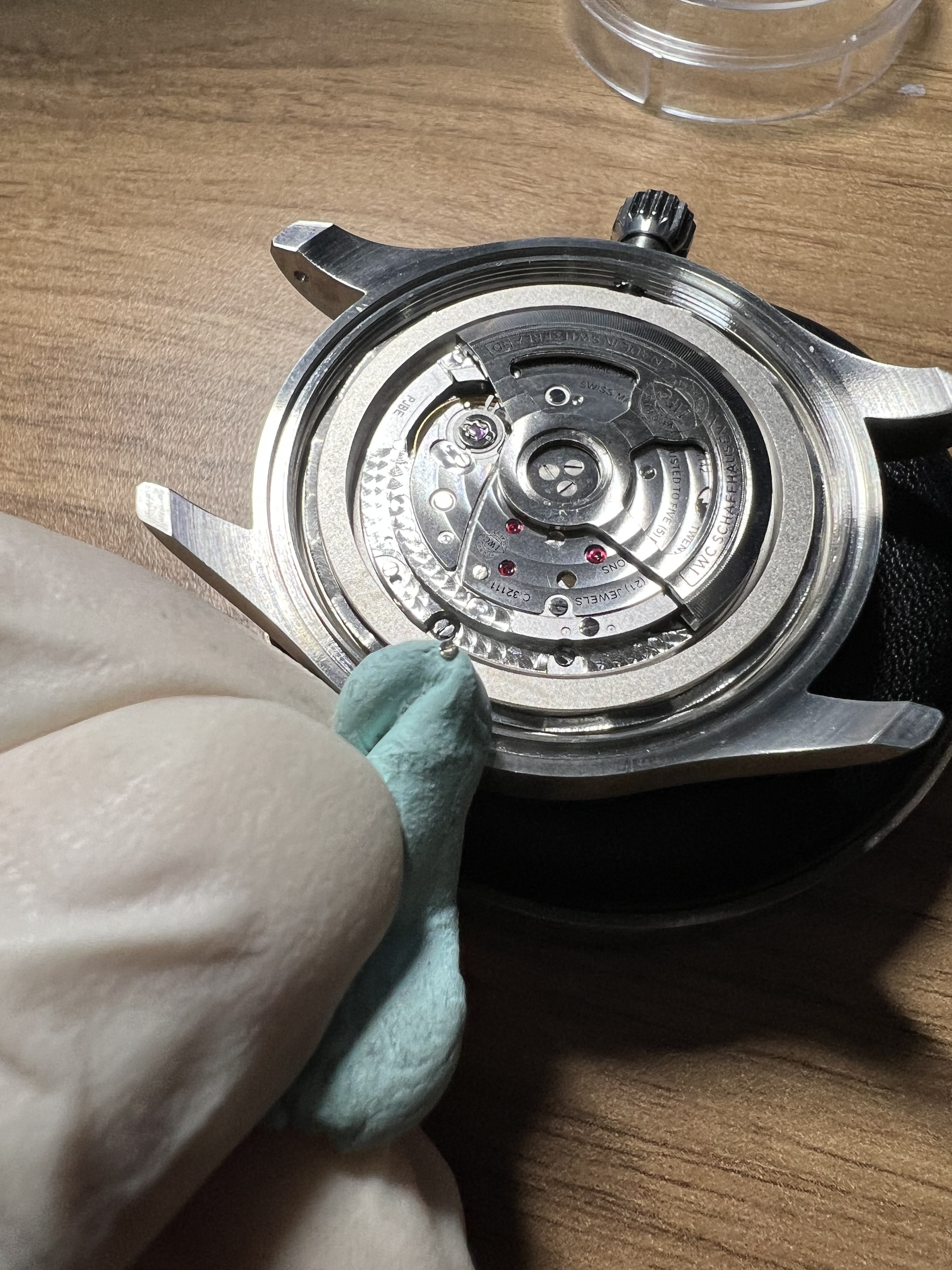

3. Then I wondered if any other decorative pieces were as haphazardly glued on. I went around with Rodico, and soon enough, at least 4 more decorative metal pieces easily came off. I literally touched them with Rodico and they just lifted off. They were mostly metal dots looking like screws.
I realized how terrible this design is. If the "screws" literally came off with the touch of Rodico, then a bump in the watch might also be able to knock them out. And bunch of tiny metal pieces jumping around the case is bound to get caught in the hairspring or gears. This is just asking for troubles sometime down the road.

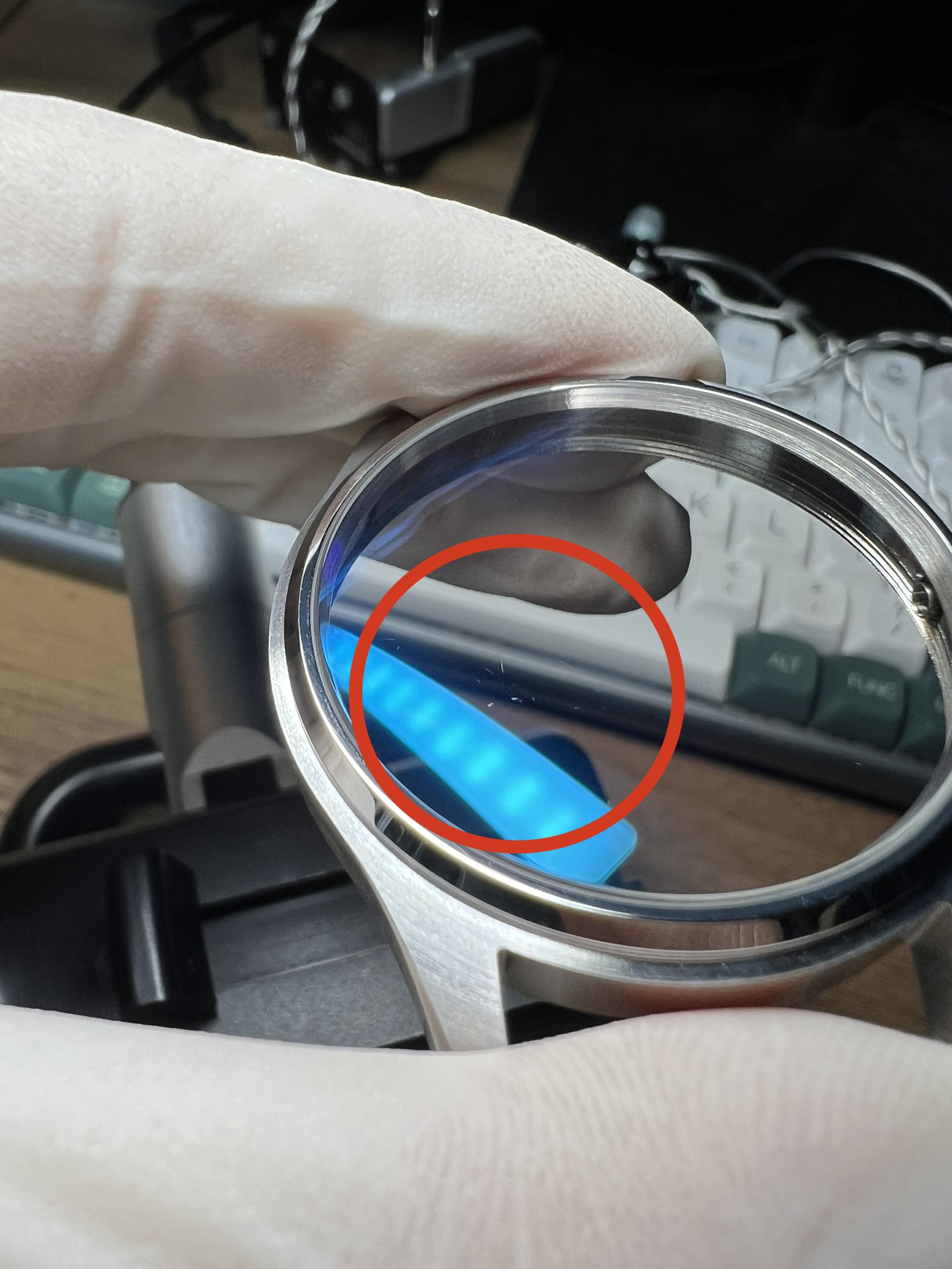

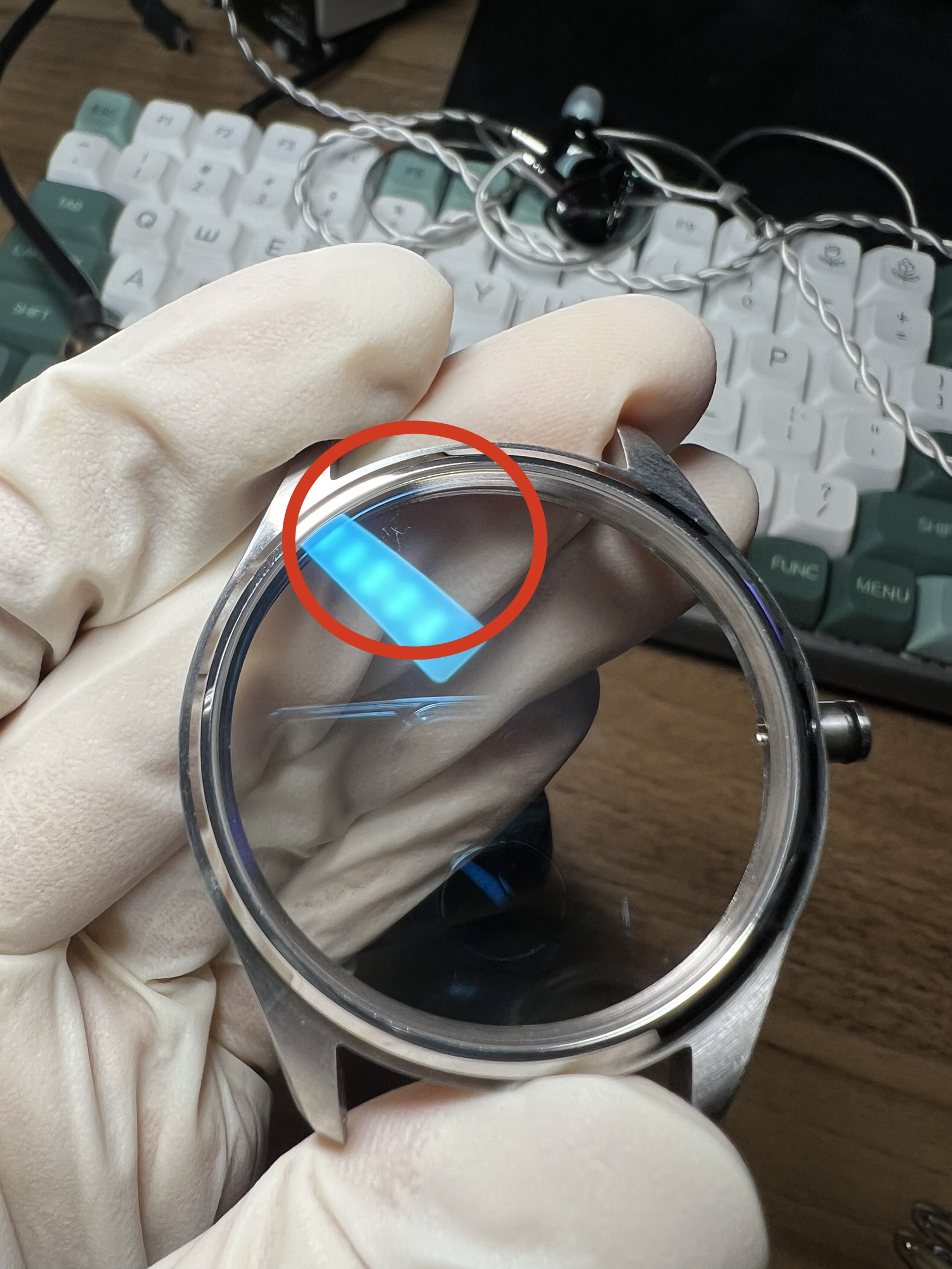

4. This is a new watch that was only just opened up. But the inner AR coating of the crystal is filled with scratches. There are many tiny scratches in the AR from the inner side of the crystal. Disappointing quality from ZF.
Overall: i waited 4 months for this watch. I have many other ZF watches, but this was a real disappointment. The watch quality itself is bad, with scratches in the AR coating. But not only that, the movement itself is flawed with too many decorative pieces haphazrdly glued on. I even doubt this is a real Japanese Miyota 9015 base to start with. ZF needs to reconsider their quality.

sidenote: One cool thing is, i’ve never seen a rotor system like this before. The rotor screw are BELOW the actual rotor. ZF must have custom designer a suspended rotor bearing system.

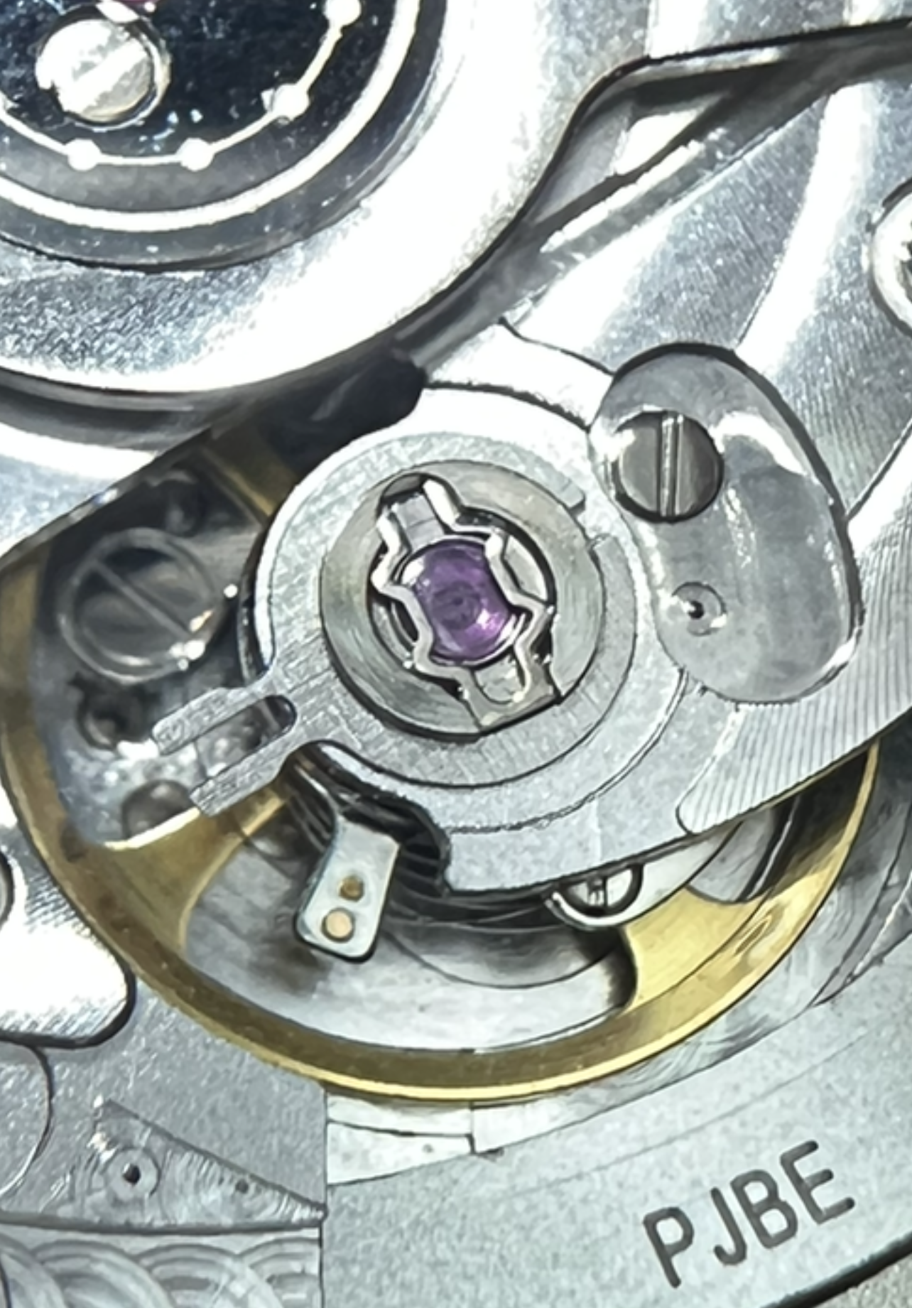

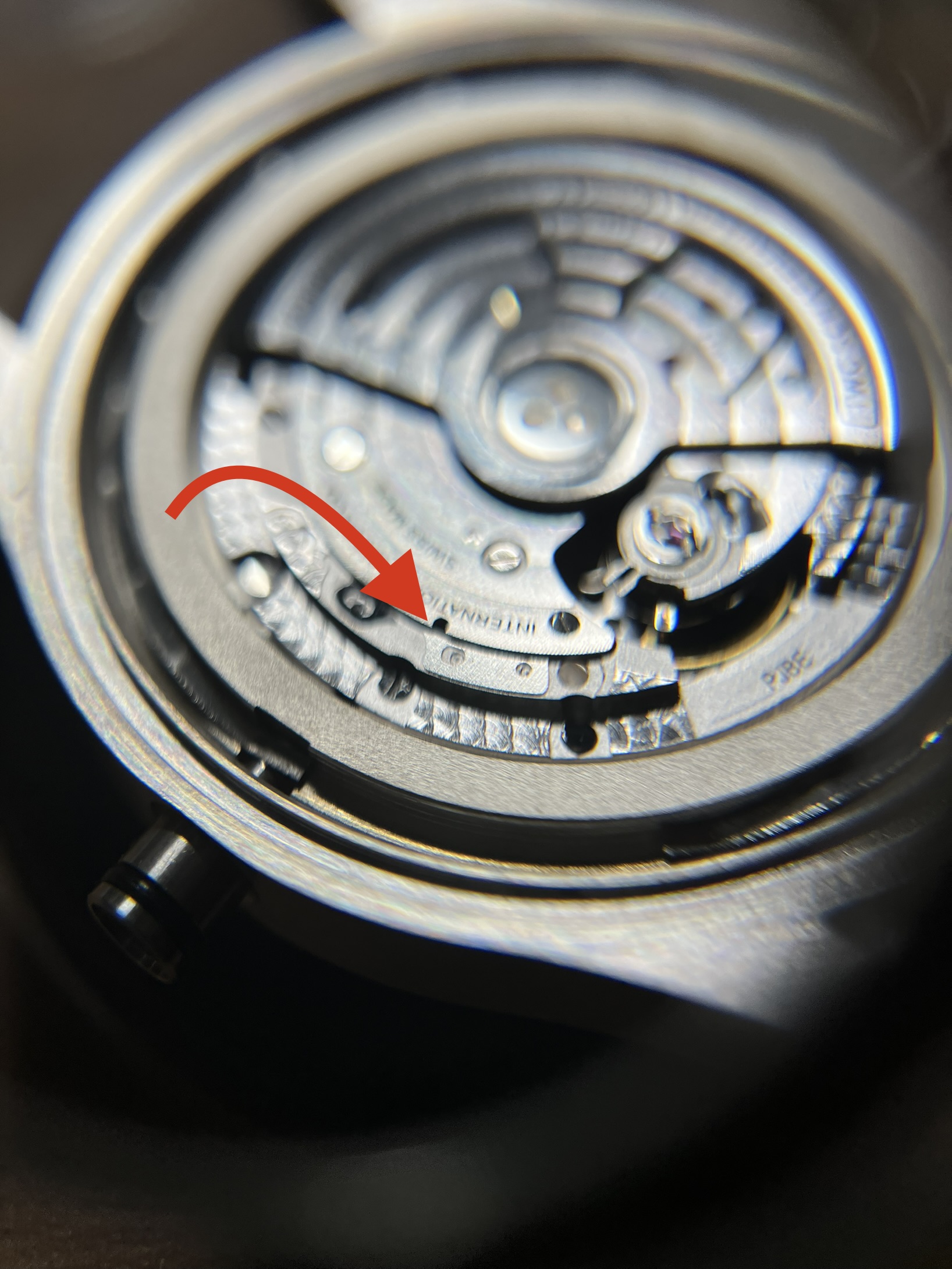

Also, for those looking in the future, this is where the ZF Miyota 9015 stem release button is located. Use a tiny needle to push the button.

Thanks for your post, this is a great contribution and fascinating to read!
For the fake screws that came off on the Rodico, how were they attached in the first place? Glued on?
Thank you.
I assume they were lightly glued on. I literally touched them with Rodico and they lifted out. And when i tried to put them back, they would no longer stick. So some kind of mild superglue im guessing.

As an owner of the ZF Mark XX, I removed that rotor screw decoration piece really quickly to lube the loud rotor. Looks real... for sure isn't! Didn't know about the screws. Might have to dig into that tomorrow! Breaking out the rodico tomorrow morning!

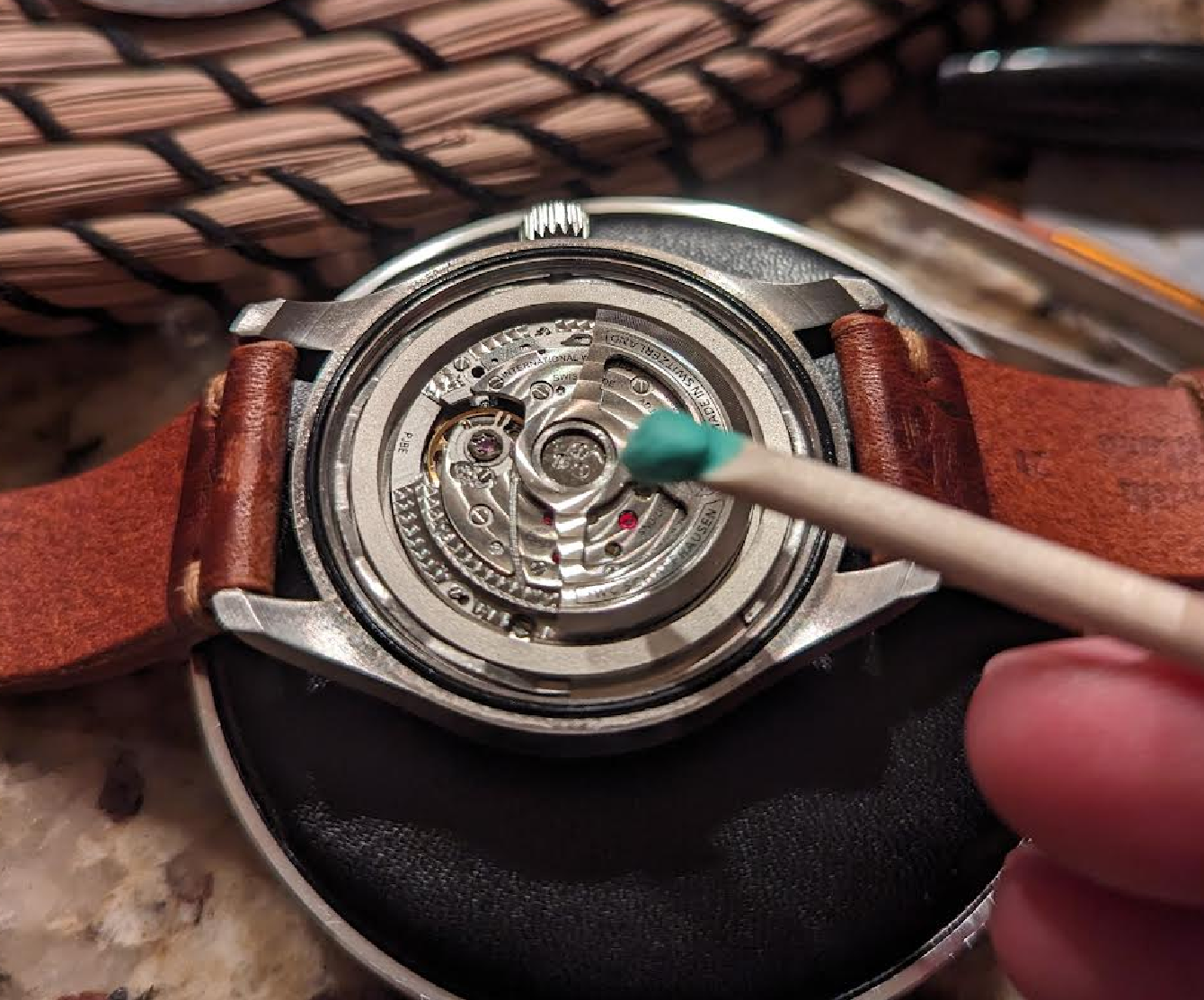

Update to my attempt to remove all the fake screws this morning with just rodico (and the wood stick of prodding). I tried at least twice on all of them, and none came off. I'm not going to apply more force laterally with tweezers or something because they seem solidly attached. However, as you can see I did remove that horrible deco plate above the rotor screws a while back!
hmm maybe i got a poor batch.
I was able to remove 4 just by tapping them with Rodico. The big ones seem like real screws and it's the tiny ones on the automatic works.
Anyways, if they don't fall out, then I guess it's all good

On the models I had the adhesive had a gooey consistency. The fake screws came off rather easily when prodded, but never by themselves and I had to really pull them off the gooey stuff.
