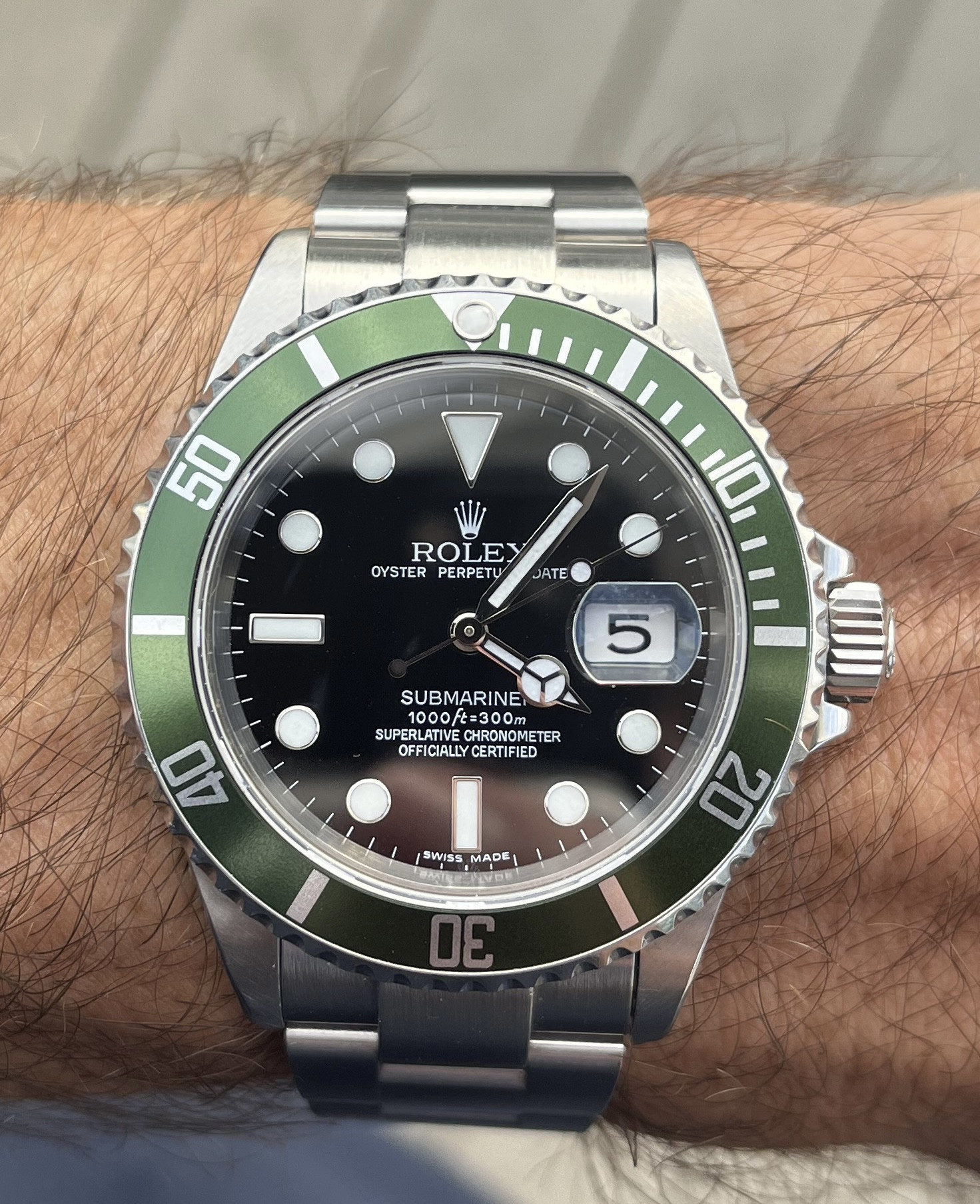

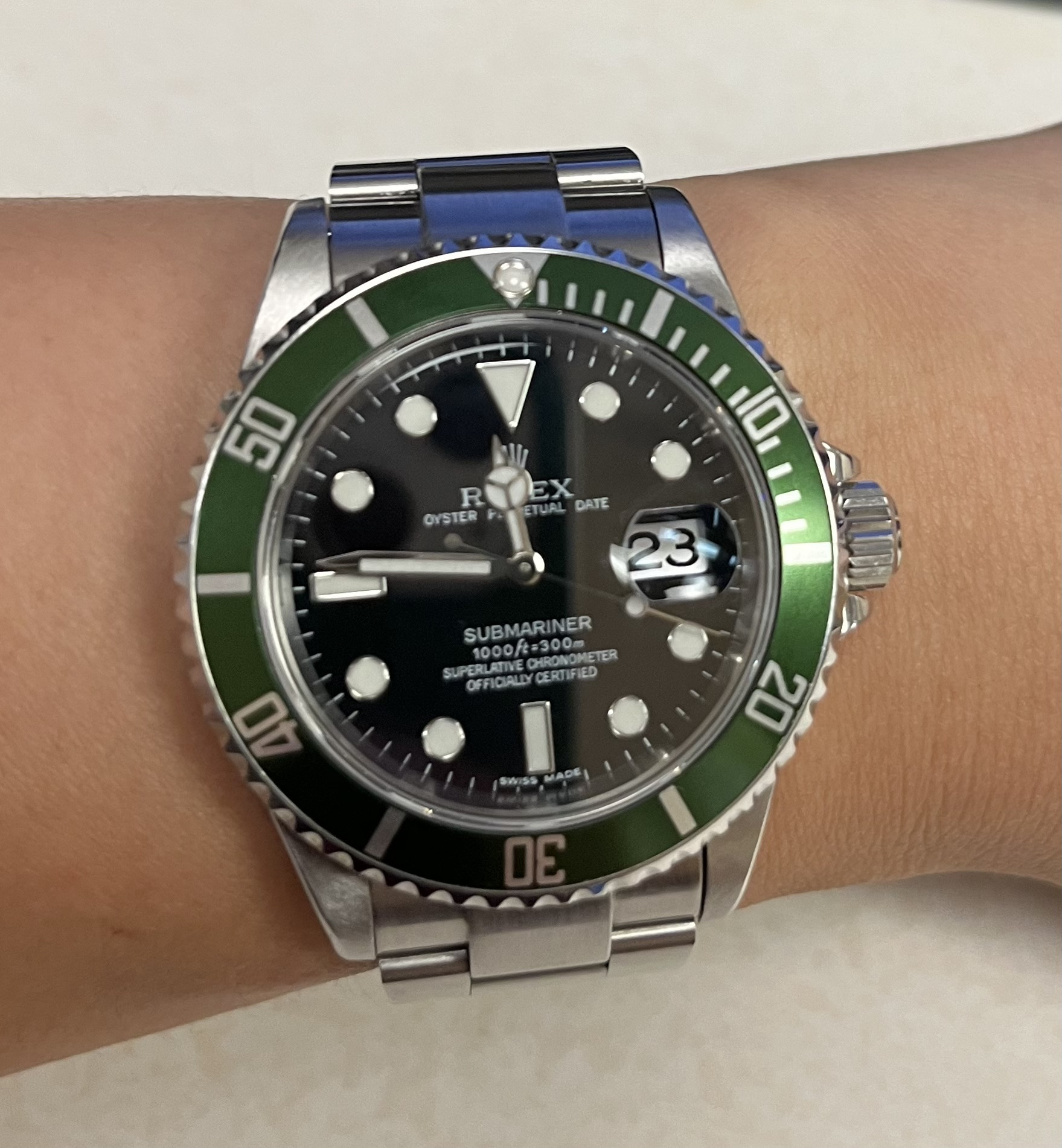

The absolute best dial is gen dial
And #1 best rep dial for Kermit is arguably
TC KH dial .. they can be found in V6 , v7 and V7 extreme TC LV, and rarely found in the parts for sale section of this forum.
TC KH dials need a bit work in order to install a VR3135/VS3135 because its originally designed for eta 2824 movement. You can remove the dial feets of the KH dial and install custom feet to perfectly fit the 3135 movement ( thats the better way) . Or you can use “dial dots/dial sticker” to secure the KH dial to 3135 movement if you wanna skip DIT installing the dial feet.
@KJ2020 has some tutorial post on how to install custom dial feet
For your reference:
