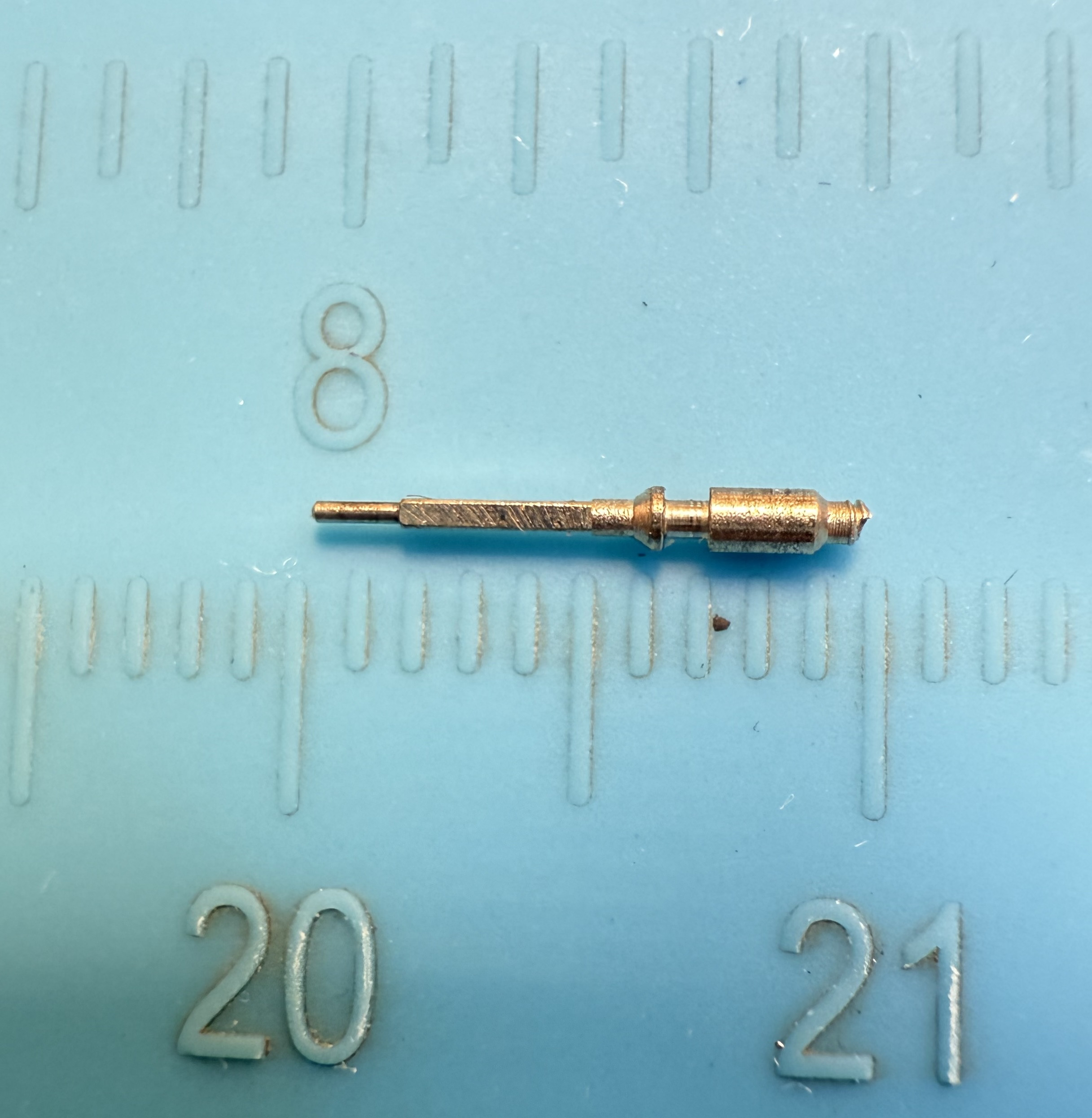

I have a VR3235 I purchased and the stem broke. I tried finding a replacement online, but I think the stem may be different than for typical VR3235 movements. Here is a picture of the broken stem. Any advice on the type to get a replacement would be helpful. There are so many variations on the stems, its hard to understand how they are described.

VR3235 uses a 3135 (VR3135) stem.
