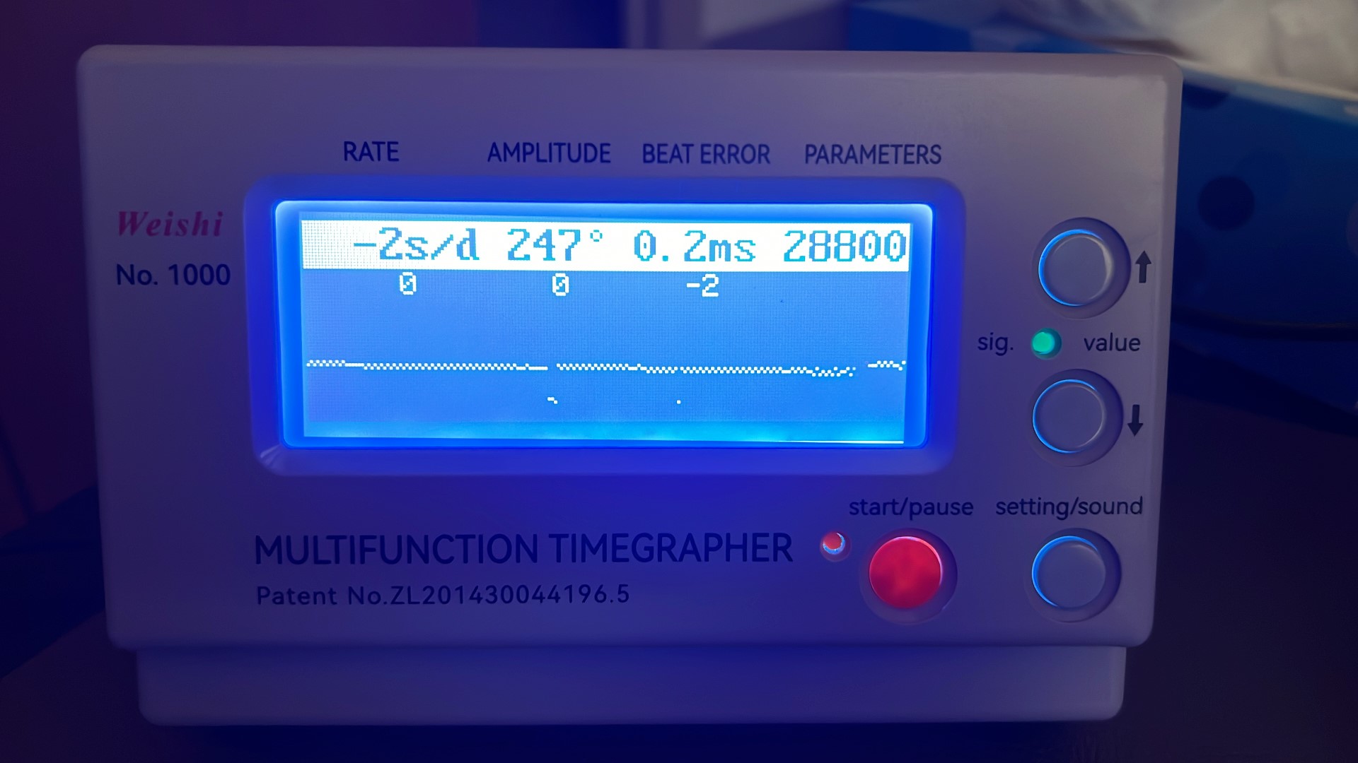

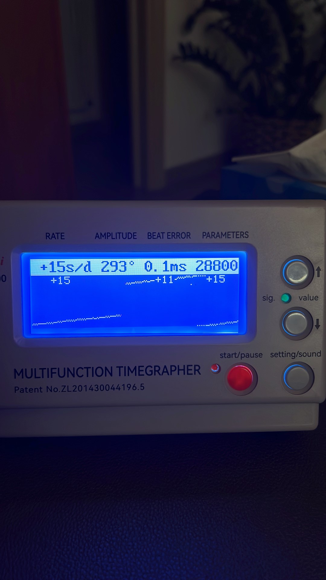

I had the same problem with the vs3235. normally amplitude about 250 degrees and -2, with a variation of about -10 in motion;
if instead I move the watch vigorously (but not too much) for 20 seconds, the amplitude rises to almost 300 and marks +18/20 compared to the starting position.
I attach photos

It appears that your vs3235 hairspring is also super-linear i.e. increase in amplitude -> increase in rate. The non-linearity of the hairspring appears to be relatively small. But interesting to see nonethless.
