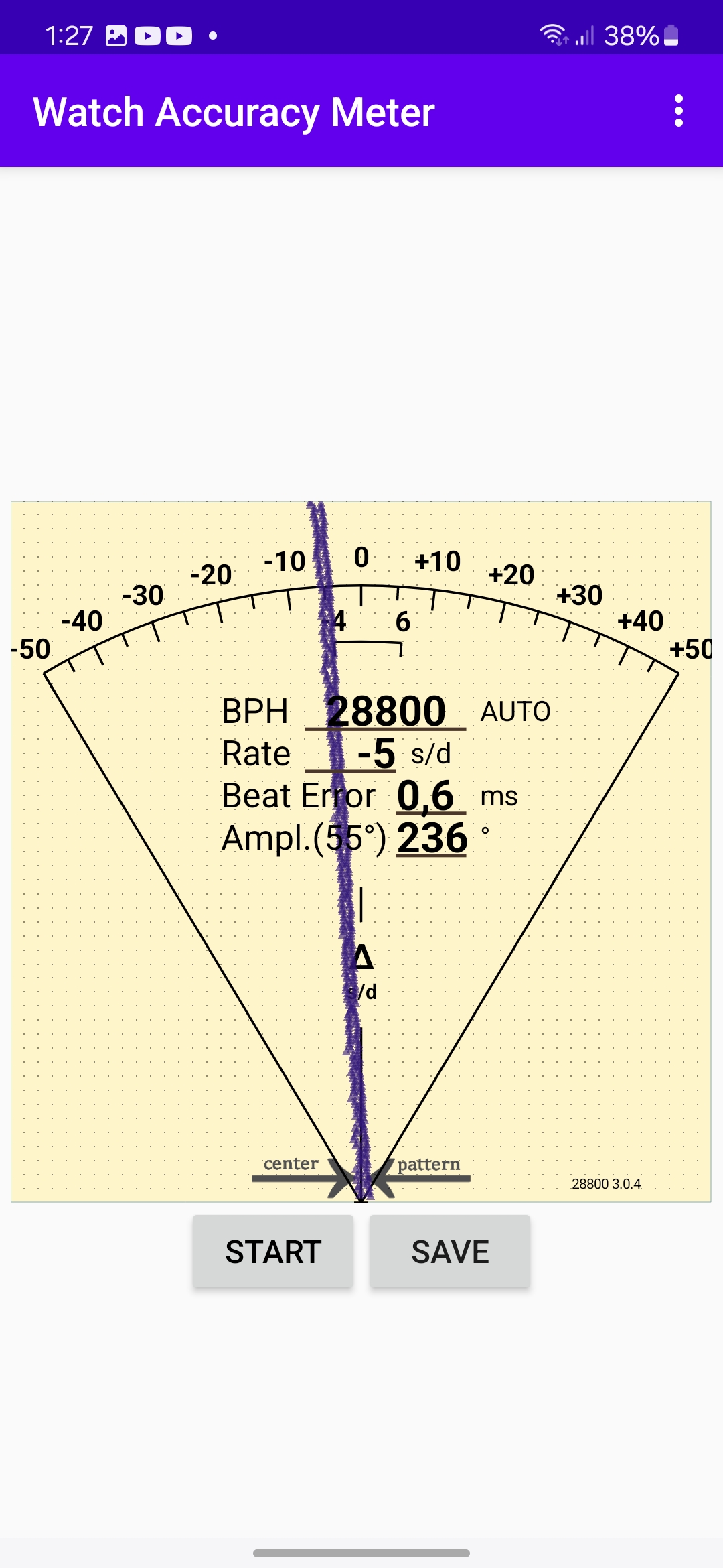

Greetings, on Wednesday 31st I received my first rep, a sub 114060 from sead, and the movement has problems.
As soon as the watch arrived, I turned the crown just a few times until the watch started to run and then I put it on my wrist so that it would take a full charge with use.
The watch was not charging, I saw with a measurement app that it had an amplitude of 130-150 and it was 2 minutes late per day.

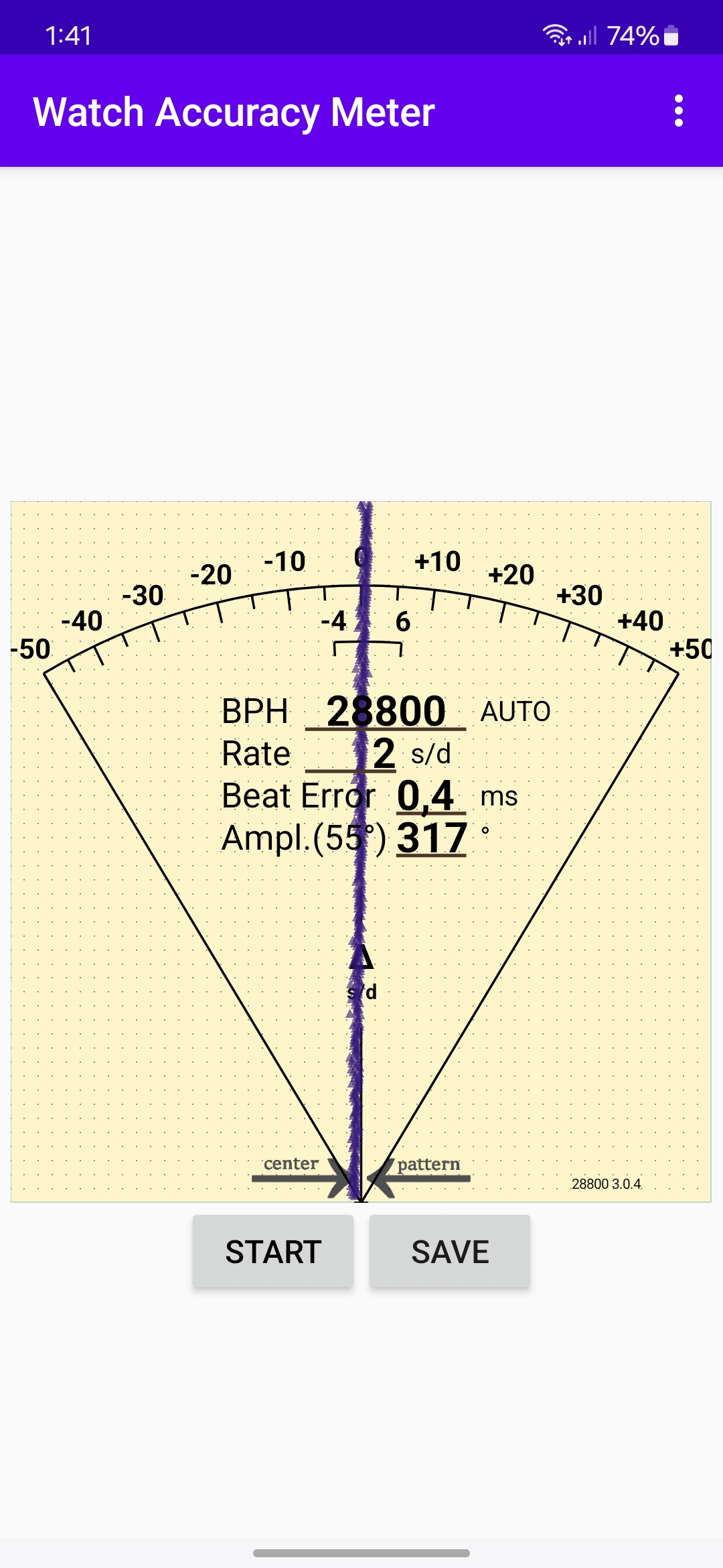

Then I took it off and turned the crown many times until I noticed that it was enough and that it would be fully charged, I checked with the timegrapher and it had an amplitude of 317 and the watch was running +0sec, then I thought that maybe I had turned the crown too few times before and that now everything would be fine.

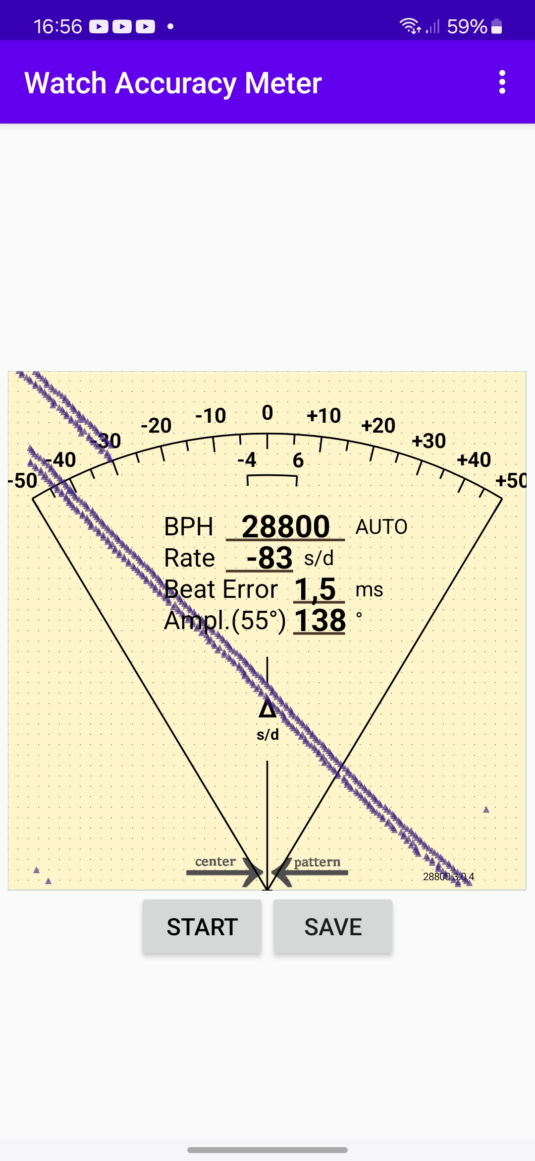

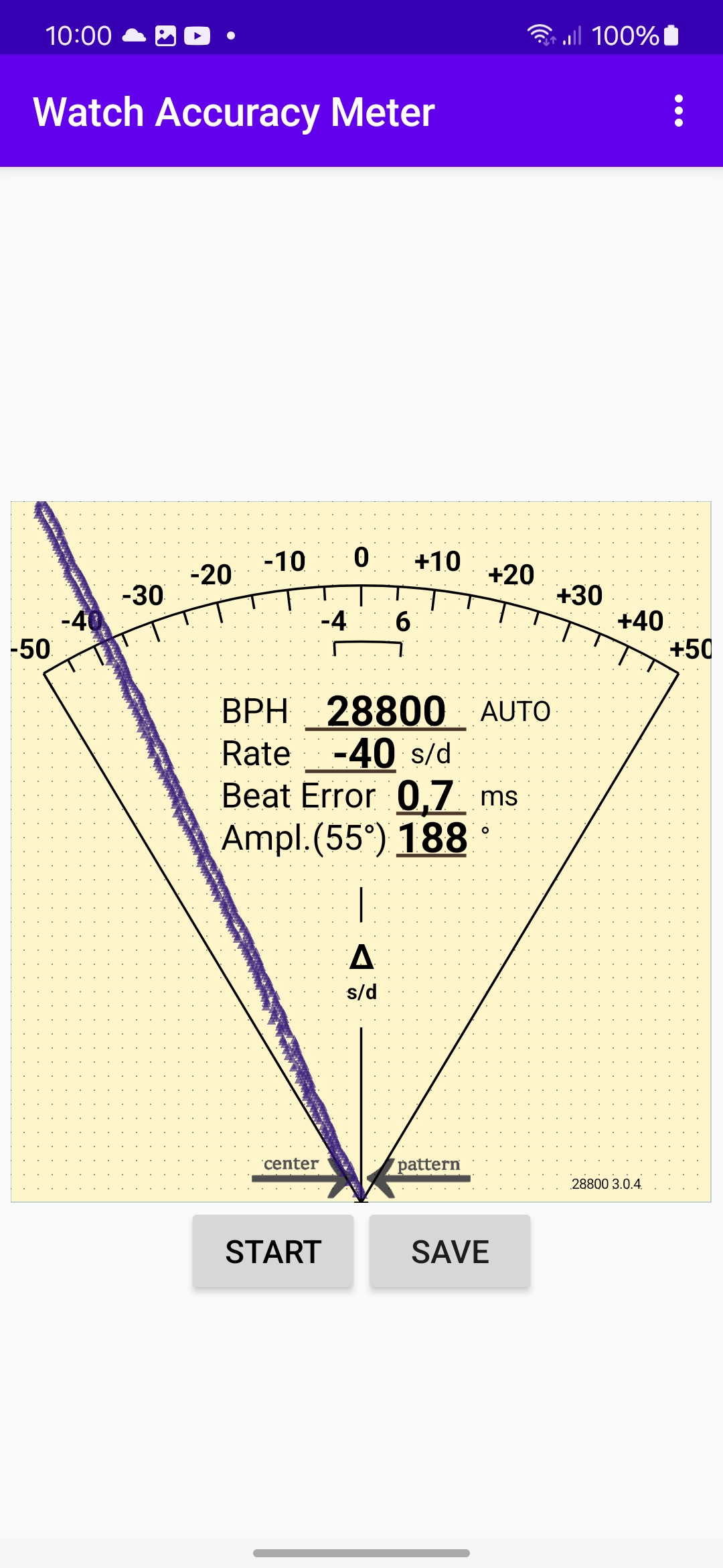

So I'm checking and the clock after about 20 hours or so is losing amplitude steadily so it is slowly slowing down more and more, going from 317 amp to 188 amp after about 36 hours, (I think it will keep going down and losing even more time, I'll post pictures later about that).
I have to say that for the tests I have not even taken my watch off to sleep, and in my job I am constantly moving my arms working with hand tools and driving.
I have also noticed that the crown makes a small click when winding the watch, every full turn of the crown I can hear this sound about 10 or 12 times.
I will upload some images and a small video where I show the movement and you will hear the click that I mention with the crown and also I am moving the watch a little, in case it helps the experts, thank you very much for your time, greetings.
This image is from Friday 2 february at 1:41 am
This image is from saturday 3 february at 1.27 am
This image is from saturday 3 february at 10:00 am.

Not that it'll change the rate and power results, but you have the lift angle set to 55°. It should be 52° for the 3135.
