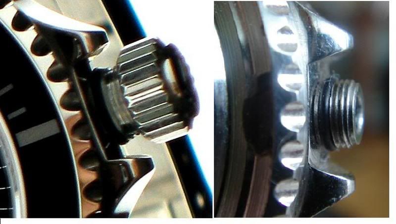

david-syd said:
bklm1234
very good.....
Can u tell me,. I am thinking of doin gmy own CG as well.
If u use a file... the CGs are flat on the inside.???
Do u have a pic of the CG looking from straight from the crown.??
So I can see if the CGs are flat ( straight) on the inside..
My reps are currently a bit curves on the inside.
tnx in advance
This may help: Genuine left, Noob w/o mods right

david-syd said:
bklm1234
very good.....
tnx in advance
You should be sanding the inner, front part of the CGs. That's a straight line when viewed from the front. Pretty clear from Vmena's picture. The inside viewed from the side, which you shouldn't touch, curves around the crown.
For example, again from Vmena's picture, it's clear that the inner lines of the noobmariner CGs are more slanted than the gen's. You need to bring those lines straighter.
-bk

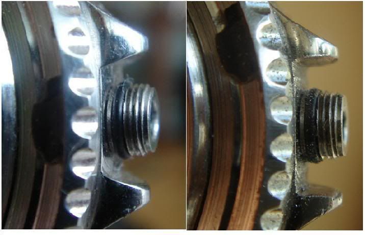

[quote="bklm1234
For example, again from Vmena's picture, it's clear that the inner lines of the noobmariner CGs are more slanted than the gen's. You need to bring those lines straighter.-bk[/quote]
Take care not making the inner line too straigh as I did with the noobmariner:
Noob before (laft) and after (right):
vmena
9/4/06
481
It's clear you can not use a flat file... must be rounded or even better cylinder shaped.
