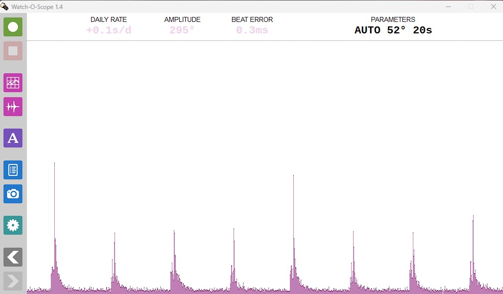

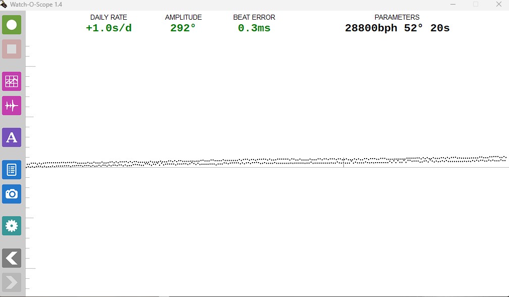

And here are some results from the software. The software also has a scope functions, that will allow you to see how well the watch signal is being read by the microphone, and you can basically see the "heartbeat" of the watch in the image. After that, you just press the Analyze button, and the software will do the rest. You can see here, that this movement is doing pretty darn good!
These results are right in line with the QC video I got before the watch was shipped, so I say this little thing with the software is working pretty well!
