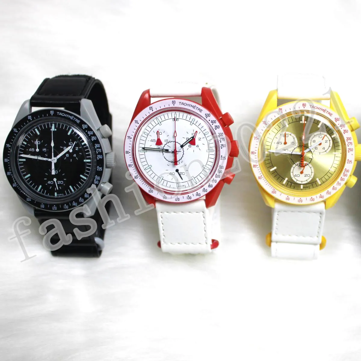

First, I needed a rep to franken and I found what I wanted on AliExpress. I bought this particular rep because it has a removable battery access panel like the genuine MoonSwatch.
Which did I choose? The Mission to the Moon for no particular reason.
