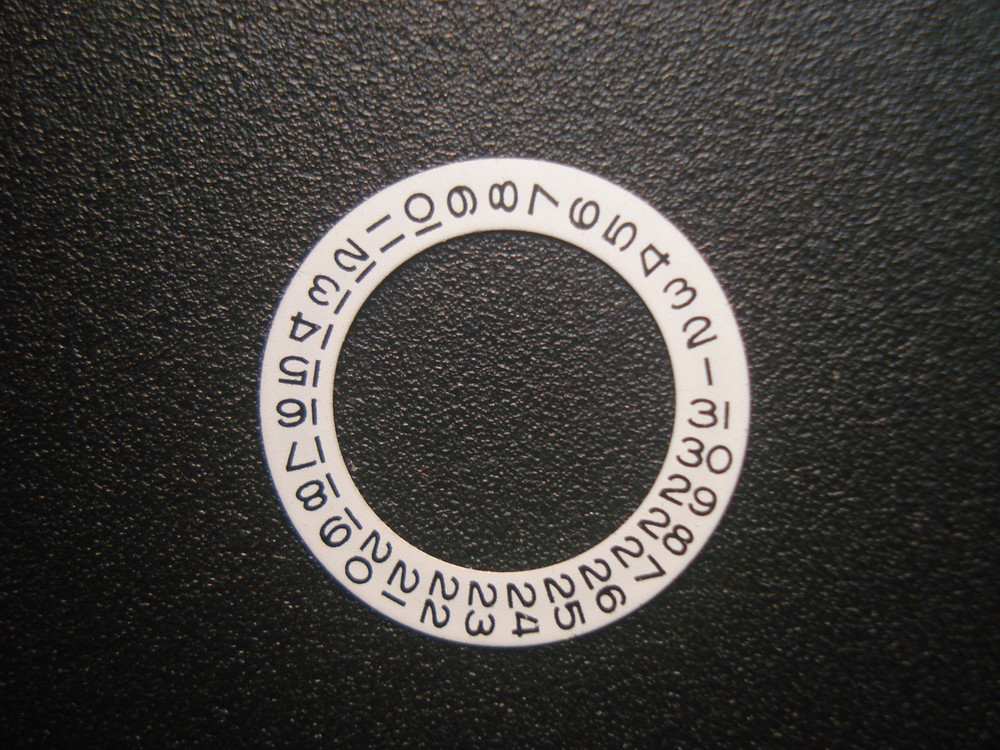

Great write up! Really glad you have dove into this as this was a frustrating project I worked on about a year ago. You are correct that ladies parts are cheap and easy to come by. EXCEPT THE MOVMENET. Those are super expensive and hard to find. You would almost be better off buying a whole used watch rather than just the movement. There are no clones of the movement to use, so that regulates us to use other ladies small watch movements.
I used an ETA 2671, datewheel overlay with a shoddy 3d printed spacer for my 26mm ladies datejust 69173 project. Had to glue everything together and messed up the movement a bit. Now I am looking to switch to the NH05 like you did. I'll document what I did below for the benefit of the group.
HERE ARE THE PROBLEMS WITH AN ETA 2671 MOVEMENT AND 26MM CASE.
PRICE/DURABILITY: ETA 2671 are expensive and the keyless system messes up quite easily. I fond this out the hard way.
SPACER RING: The raffles brass ring movement spacer that this project needs is not in stock and probably never will be again. Raffles was the only one I found that sold it and have contacted him multiple times throughout the last 2 years asking if it will ever come back. Seeing how there are no 26MM clones being produced anymore, I doubt we will ever see this ring made again.
I took the dimension of this ring and 3d printed one. The problem is I didn't have any of the holes, cutouts or screw holes correct. BUT EVEN IF I COULD GET THIS RING OR A PERFECT 3D PRINTED ONE, I WOULD NOT USE A 2671 BECAUSE OF THE DATEWHEEL SITUATION EXPLAINED BELOW.
I ended up having to make a cutout for the stem and glued the dial to the spacer to make this work. I tried dial adhesive, but it does not work well as the raised up datewheel (described below) has too much friction and would actually rotate the dial. The glued Dial/Spacer/Movement fit in the case ok, but could rotate with enough force. The stem unfortunately is what is keeping the watch head from rotating, so not ideal. This was a frustrating project because NOTHING FITS TOGETHER. The dial does not attach to the movement or spacer. The spacer does not attach to the movement and none of it secures to the case.
Datewheel: You have to glue a DWO to the existing date 2671 date wheel. Unfortunately the 2671 datewheel is sunken on the movement with a lip flushly around the edge of it. In order to get the datewheel overlay to rise above the lip, you have to use a secondary 2671 datewheel and grind off the teeth and glue it to the existing datewheel to use it as a "spacer". Then you have to glue the DWO to the raised up datewheel "spacer". When you raise up the Datewheel like this off the movement, you also get more top friction from the dial and more resistance changing date due to the added weight of the spacer. From this aspect alone, I would not recommend using this movement. With the added friction, things can mess up the movement and make the glued datewheel sandwich come loose.
Date Wheel Overlay
With all that being said, I think the NH05 might be a better option since the Datewheel is not sunken and you can place a DWO on it without a spacer. I could be wrong on this, but would be interested to try.
Date Wheel Overlay

Are you saying the date wheel is too far from the dial and that is why you need to raise it up?
dpd3672
29/5/23
1,939
3,238
Yes.
In order to set the movement in the case so that the stem lines up with the hole, you need to recess the movement a little bit. That causes the movement to be spaced a bit from the dial, so the date appears sunken. The solution I'm hoping works is to mount a spacer disk, maybe 1mm in height (maybe more, maybe less, it's too small to measure with the tools I have, so I'll just use different thicknesses until it works) on the date wheel, then the DWO on the spacer.
It sounds like what you did with the ETA date wheel you ground the teeth off of, I'm just hoping to use a 3D printed spacer, or something I cut from thin metal stock. I've got some sheets of .4mm brass that I used to cut dial blanks, one or two thicknesses of that should get me in the ballpark.
The stock plastic movement ring on the NH05 is fairly thick, the 3D printed one is much thinner, but still leaves too much of a gap.
