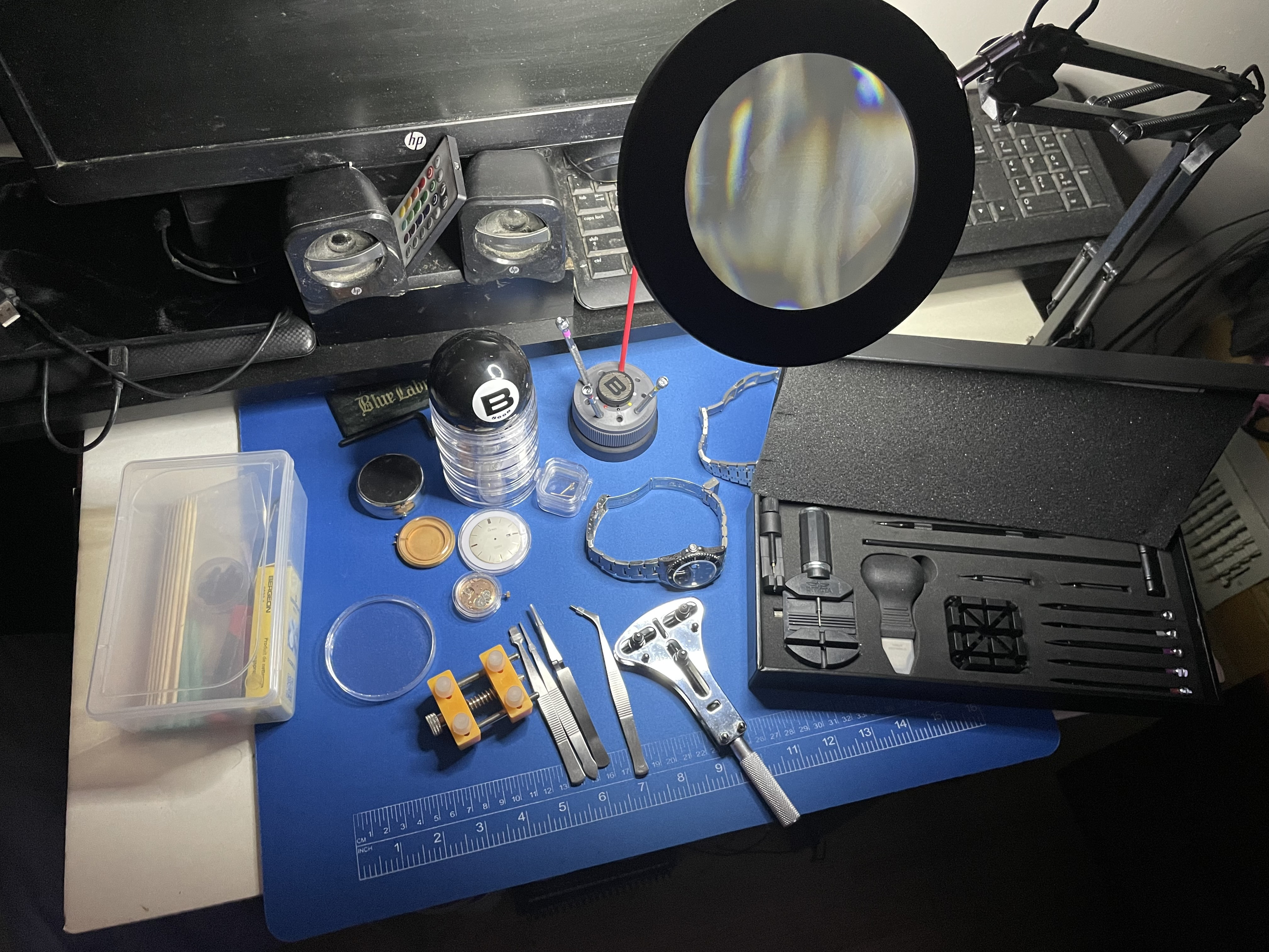

I’ve been hooked on searching for tools to put together a bench set up ever since @Feefo and @dpd3672 recommended using the $ that I would spend on a service, gathering up some watchmaking tools and starting some practice on clone movements. I found some really helpful videos online. I already found an open shelf computer desk I plan to use as a work bench. Thanks to you guys, I was able to find some great pieces on esslinger and eBay. Believe it or not I was able to source a few things on Amazon too.
I plan on starting slow, replacing the bezel pearl on a friends 126618lb. Already ordered the pearl, and picked up some G.S. Hypo Cement. I watched a few videos looks pretty straight fwd. I’ll post some pictures of my set up once everything gets delivered. Would definitely appreciate any positive/negative feedback I can get. Any advice on what I can do better or what I might be missing would be extremely helpful. Many thanks for the motivation and the push to just get started learning. Cant make it to the end goal without taking that first step.
Good luck! Looking forward to see some pics

I have parts tray, air blower, loupe and oiler needles coming in next few days. Waiting on hand pushers and levers until I need it. Can you recommend any particular books? I’ve looked at a few but haven’t been able to land on one I know would be helpful yet.
