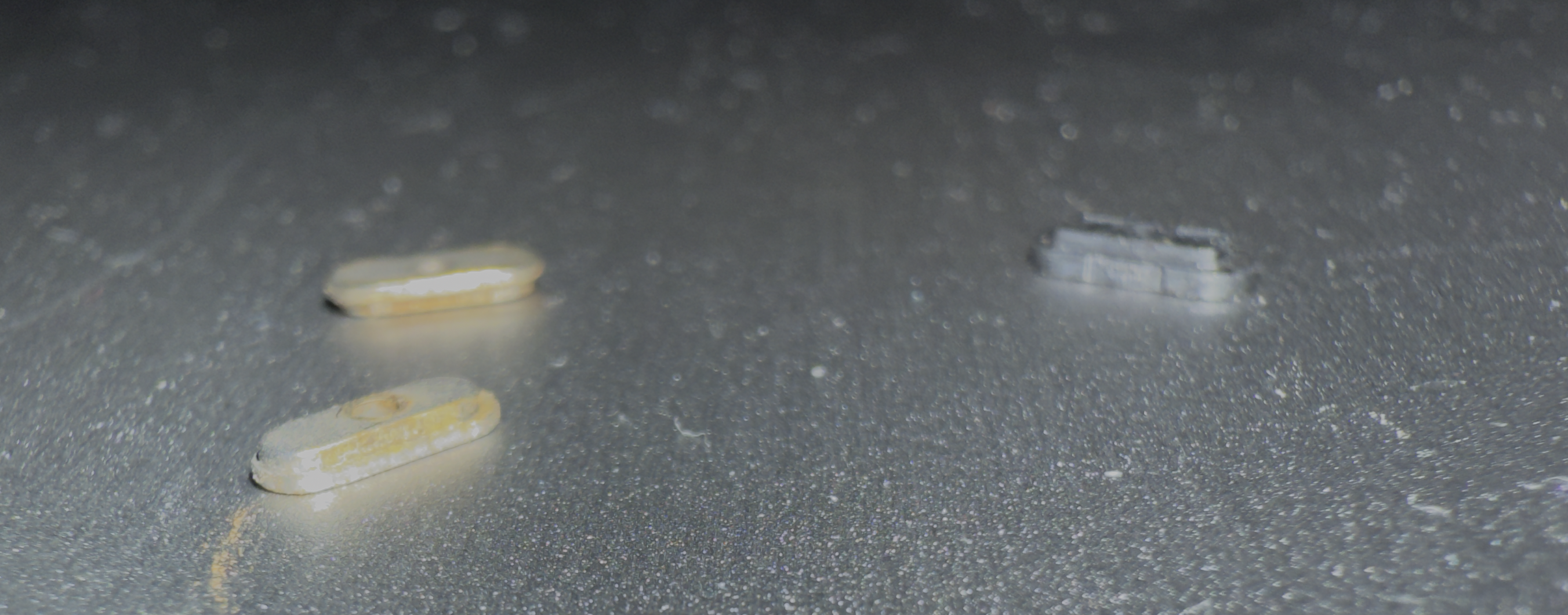

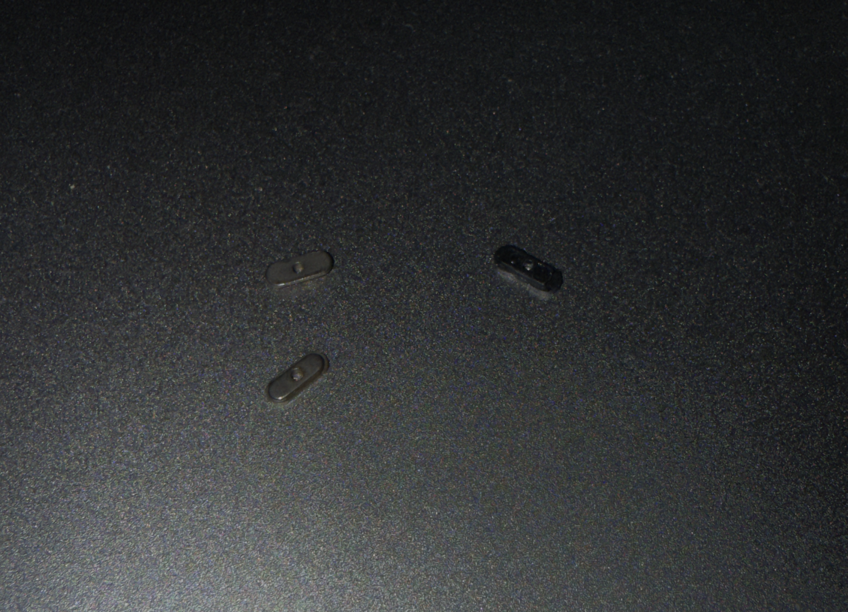

A huge update: Found an ancient Sub (like 5 years old probably) that also has the glidelock mechanism. Took it apart and replaced the ones in my VSF. The ones in this (terrible quality rep BTW) has metal sliders whereas the VSF (2025) has plastic ones. The metal ones are 10x better and more durable. Not sure why VSF is cutting corners and not using gen spec parts, but it's something everyone should be aware of. I was down a $600 watch due to the carelessness of VSF and their watchmakers.
The sliders on the left are metal and from an off brand rep. They are a little dirty but I cleaned them up with warm water and soap. The right slider (I only have one, not sure if the other one broke due to it being plastic or if it didn't come at all with my watch) is from VSF.
I am not making a big deal out of it, but if we're paying top tier super clone money (ie: $600+), we should be getting metal sliders like the gens. Ridiculous.
I appreciate everyone with their kind wisdom and help on this matter!
I really don't think its cost cutting, I think they figured out exactly what you're showing in this picture - they wear down, because they rust and catch all sorts of grime.
At first I was confused as to why is it made of plastic, but the fit is pretty much exact with very tight tolerances, plus the plastic seems to be hard enough to resist wear in the groove it slides in, so it helps abrasion, corrosion and I would imagine its smoother than the metal ones.
But hey, maybe Im just bullshitting myself. 😂

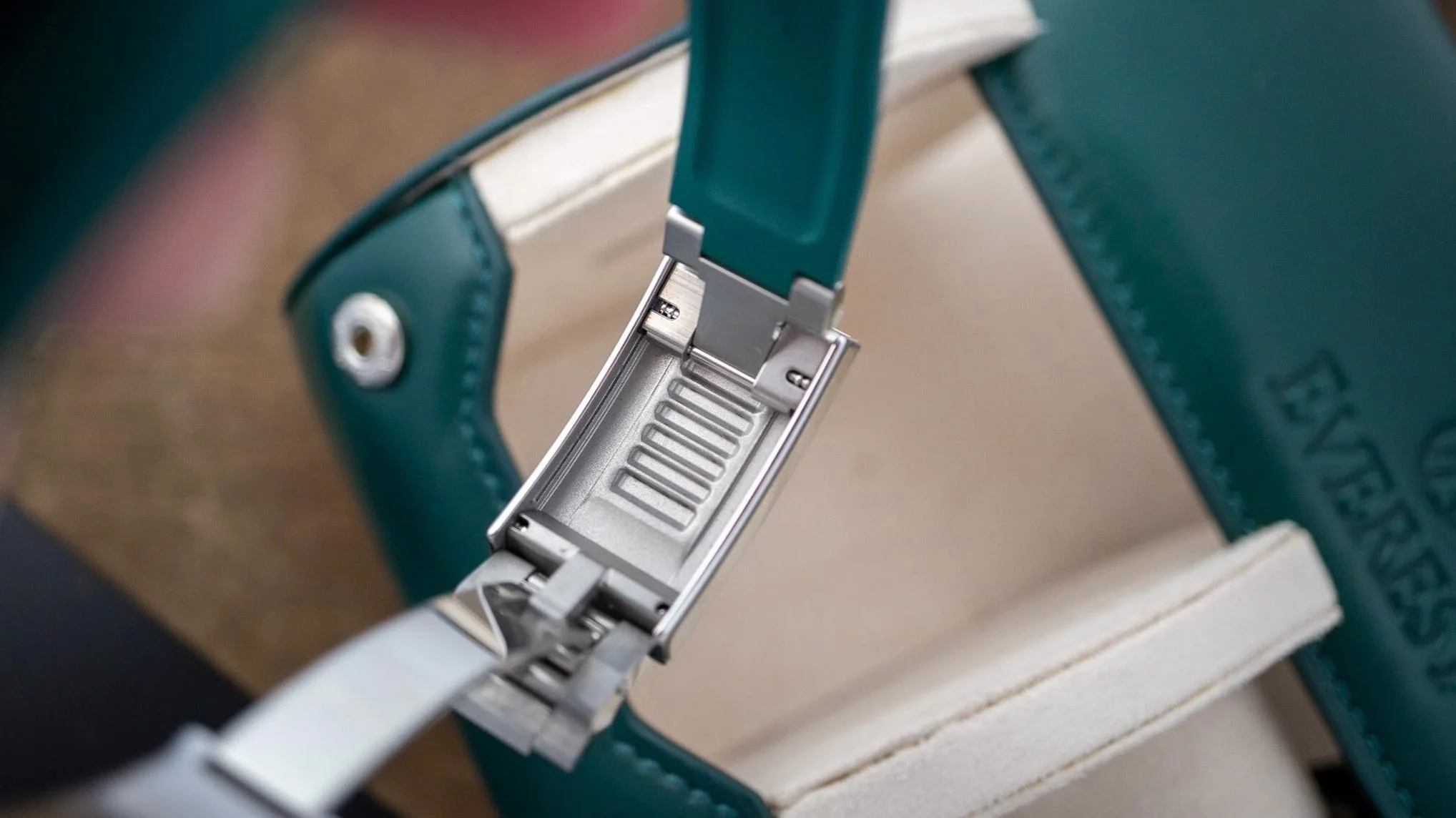

So I was looking around if I can find picture of one of my gen Subs from the past, but for some reason I didn't think of taking a detail glidelock shot.
What a dumbass.
But over at Everest they show a pretty well lit detail and it seems to be black plastic as well:
I would assume that Everest is not using rep clasps for their promo shots, but maybe they are. Im sure someone currently owning at least 1 gen sub can help you out to verify.
8,476
23,687
I think gen uses plastic as well. You want cheaping out, this is your 12,000 USD luxury watch 🤣
In reality I think it makes sense. Metal on metal part would be very hard to actutate smoothly if tolerances are not extremely tight. This part experiences alot of wear and plastic is quite sturdy, can last many years, when it goes into service cheap to just replace.
