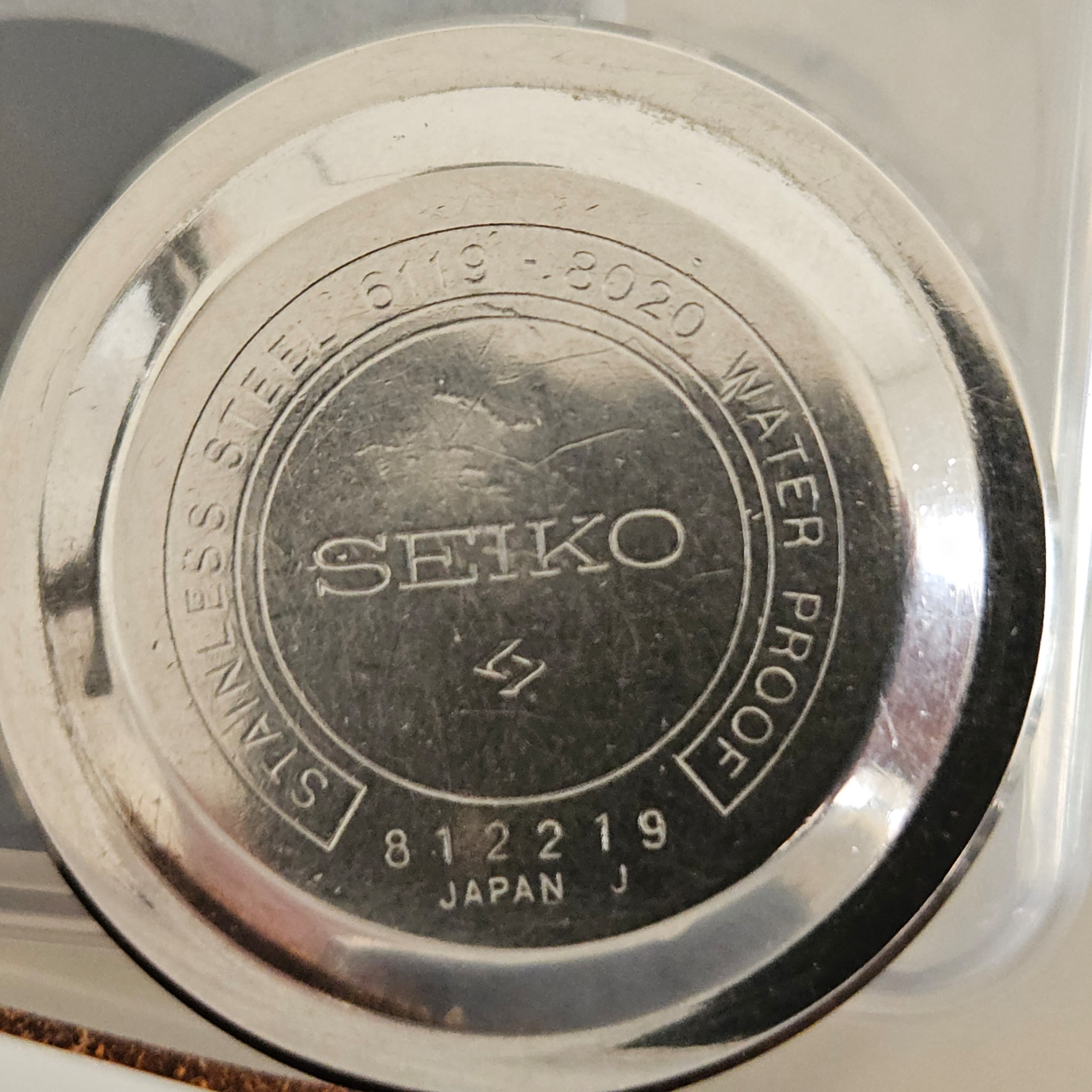

Early 2023 I had the opportunity to buy a nice civilian issue of the 6119-8100, with a working 6119 movement.
The caseback was a "clip" one as it should be but it was marked 6119-8020 and, of course, the dial was not a military one.

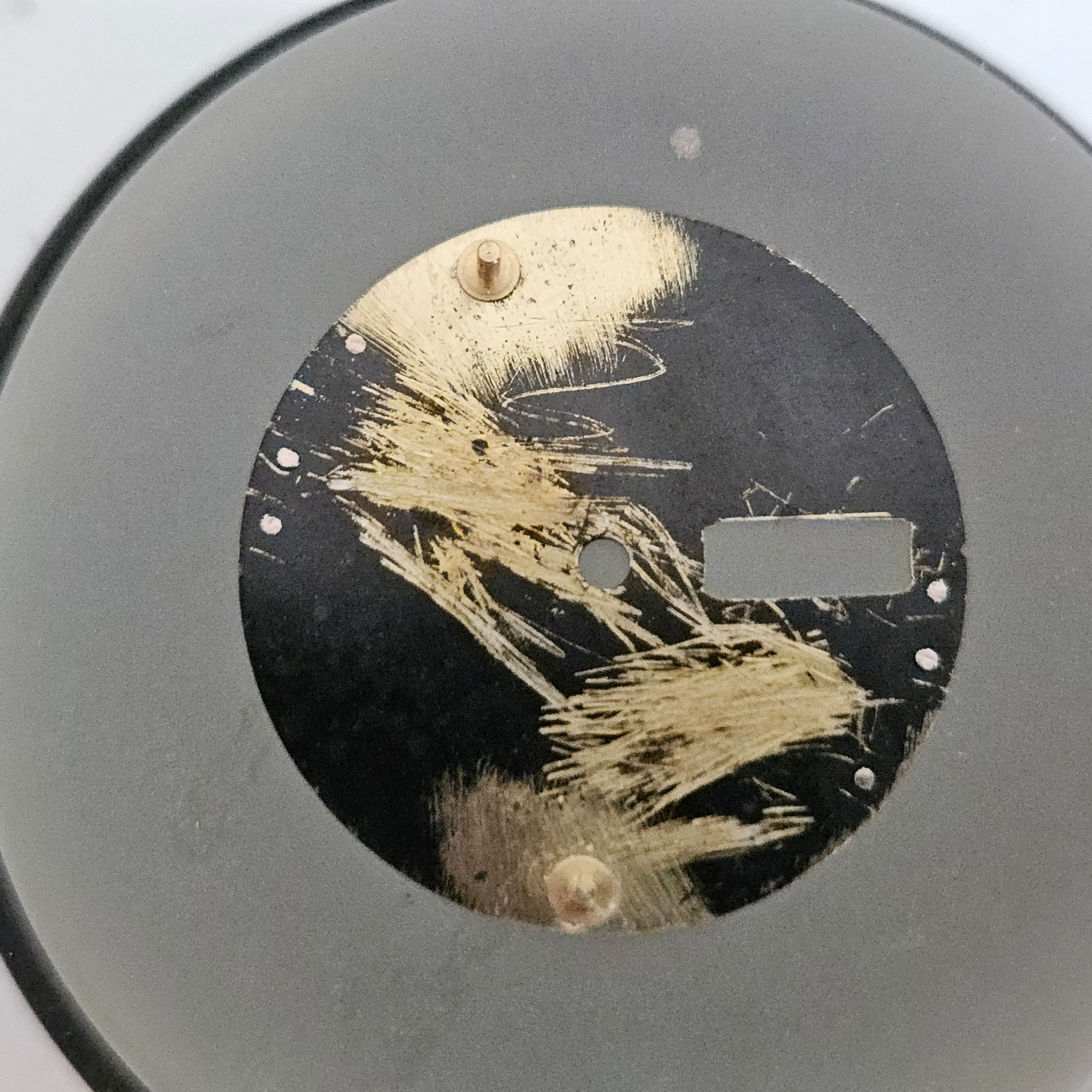

STEP 1 :

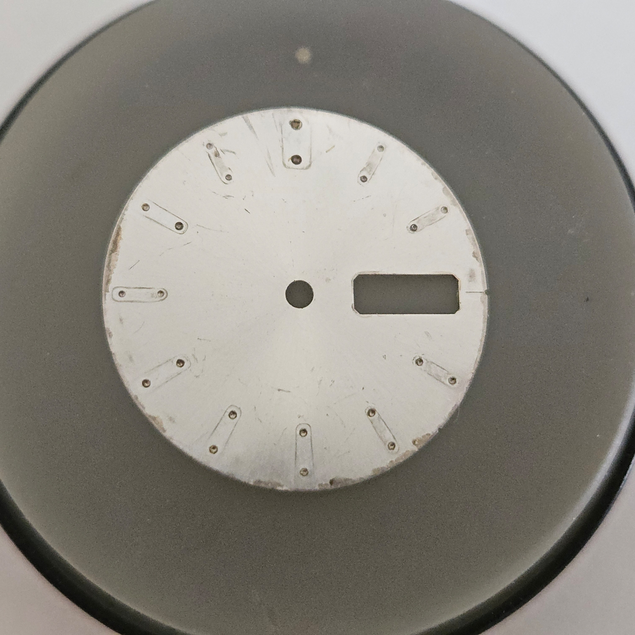

I fisrt started with the old 6119-8020 civilian dial, marked a small dent at 3:00 and removed all markers and the steel surround on the date window ...

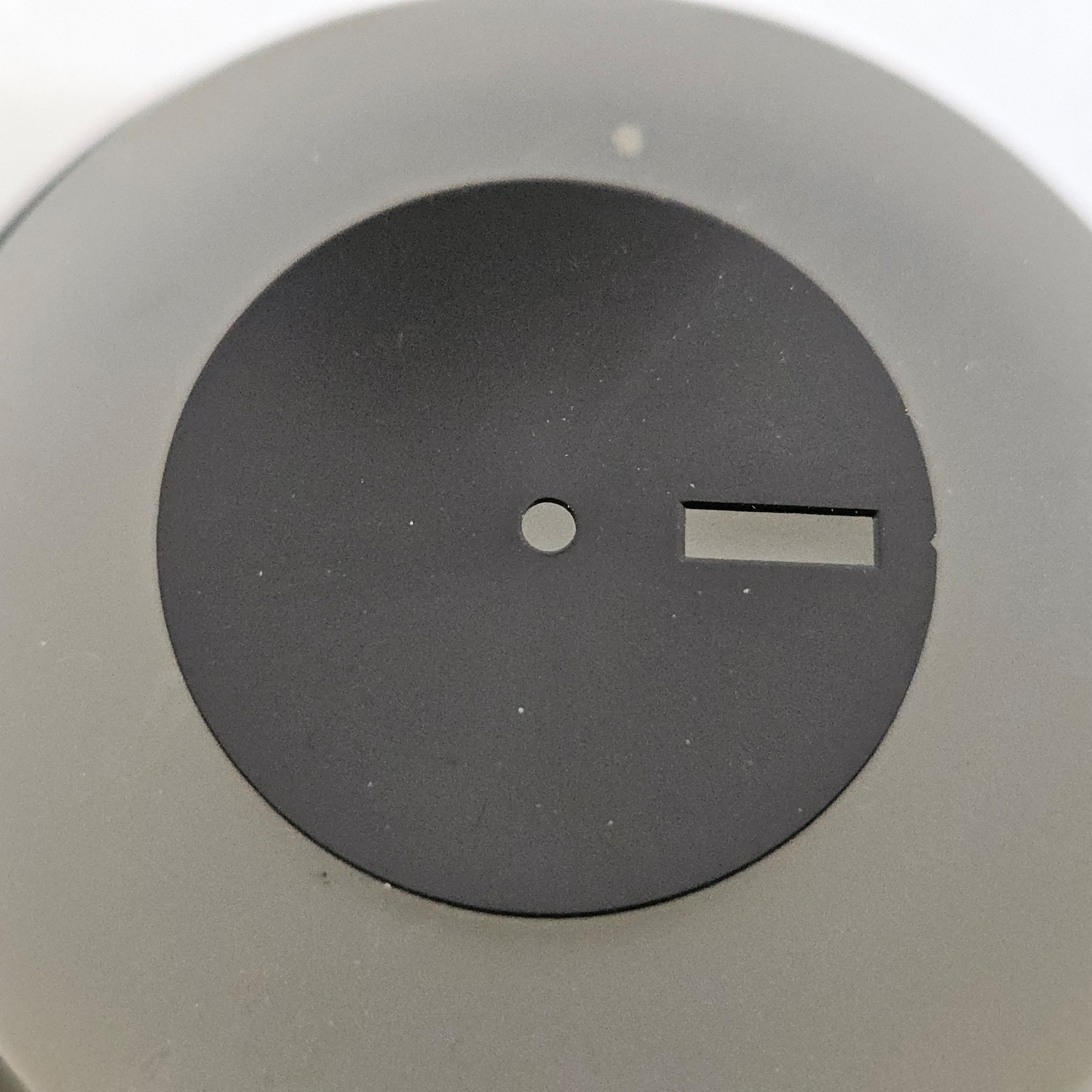

STEP 2 :

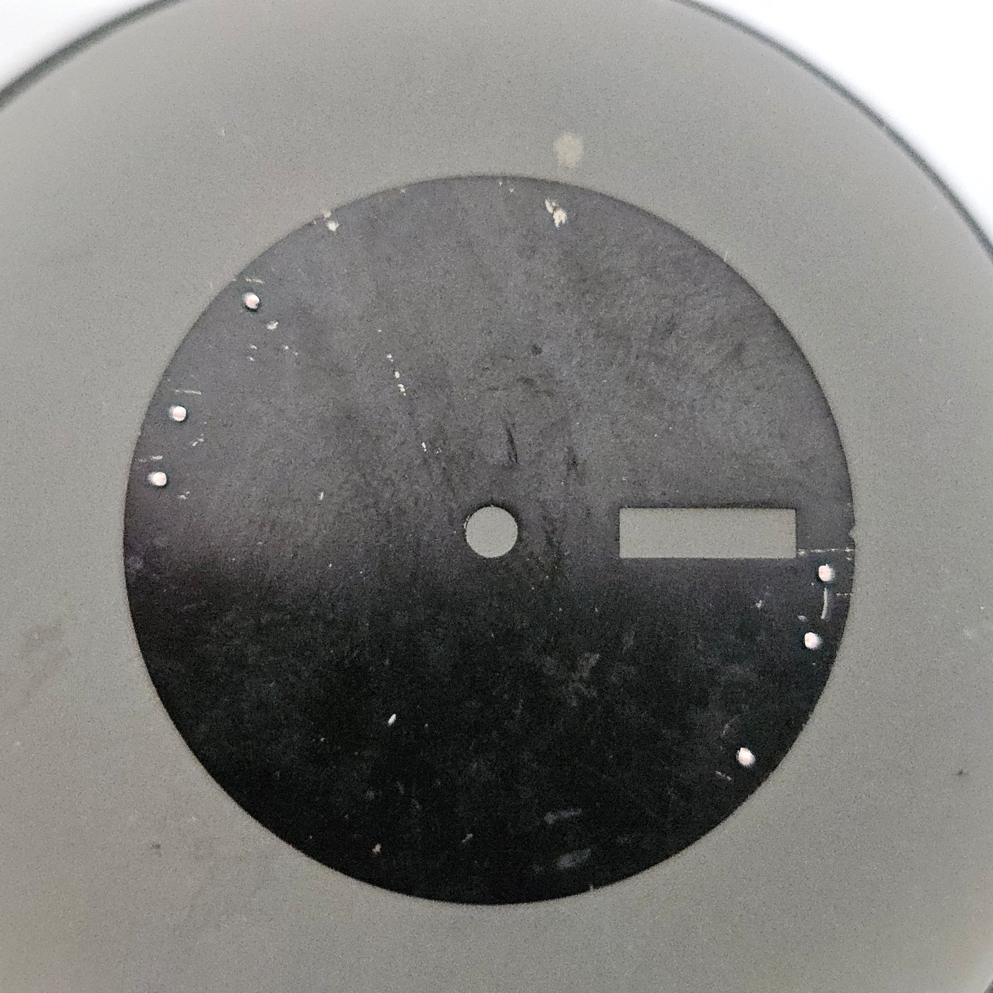

I had some dark grey sunburst NH35 dials and removed all dial feet as none of them fit the 6119 movement ...
STEP 3 :

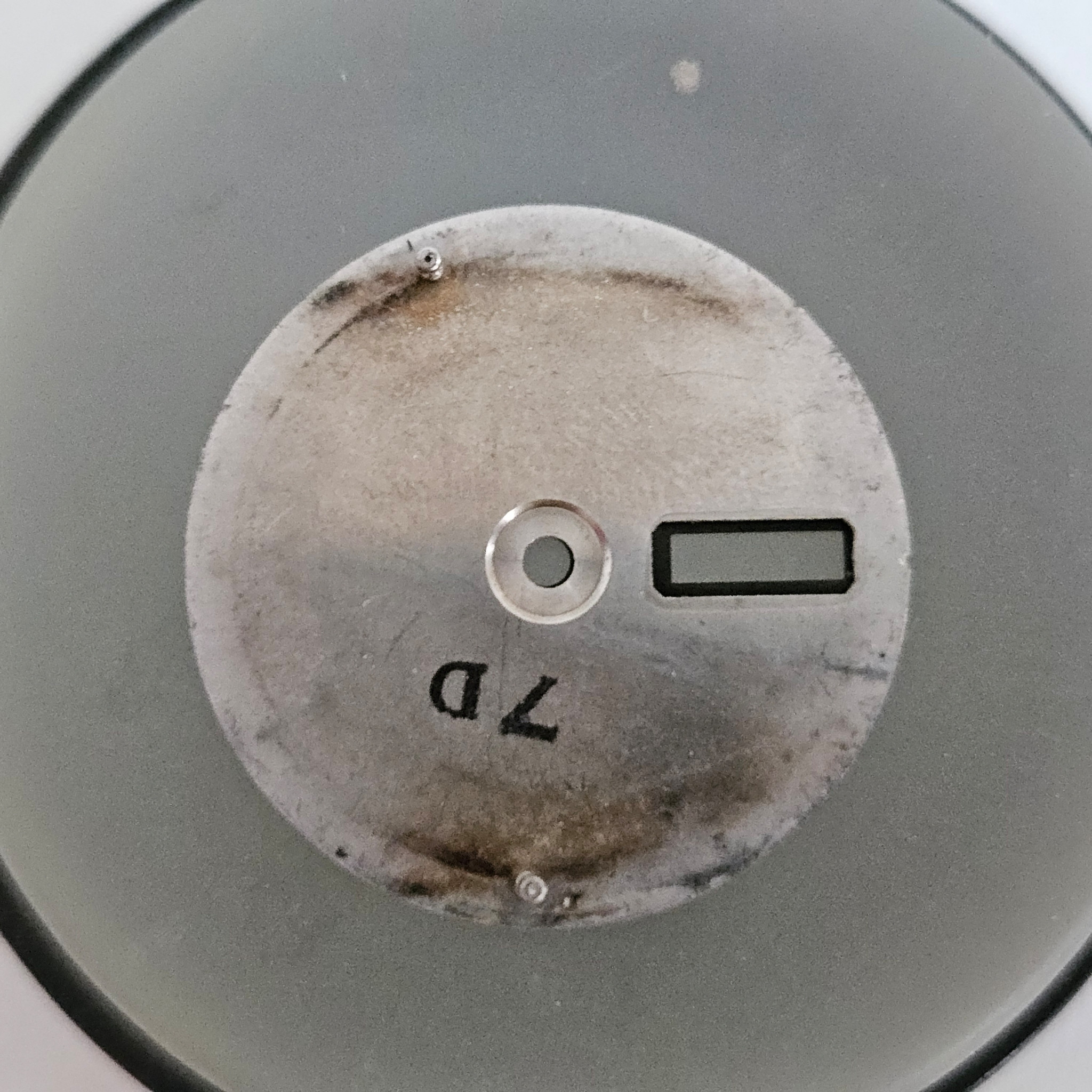

I placed the original 6119 dial backwards on the NH35 dial and marked where the date window should be modified ...
STEP 4 :

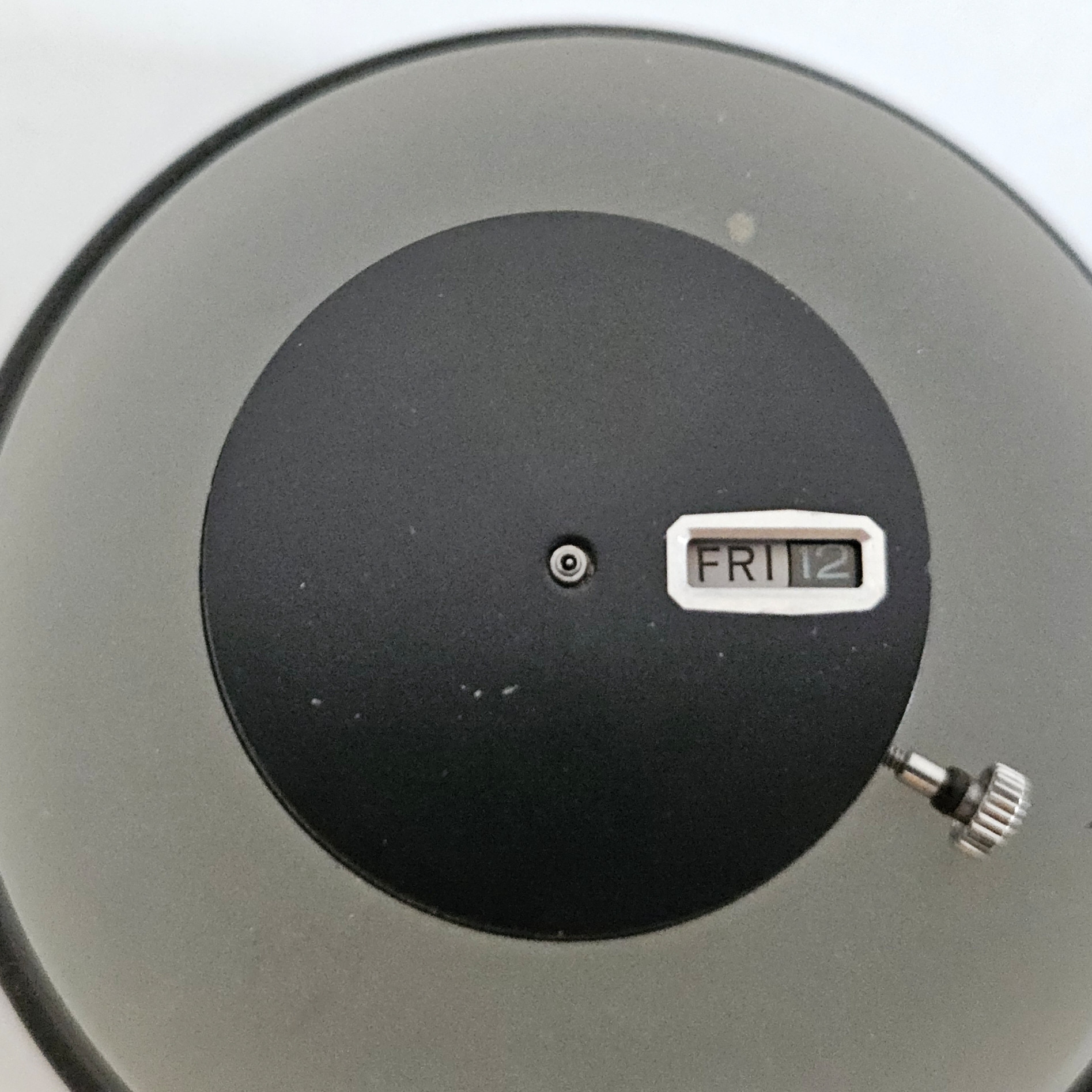

I reworked the date window until the original steel surround can fit and add dial feet for the 6119 movement ...
It's just a first test so the dial feet are glued but I will try to solder it ... if I can do that without ruining the sunburst finish on the front side
STEP 5 :
I put the original steel surround in place and bingo
Here's a nice dark grey sunburst dial that fits on the 6119 movement !!!

STEP 1 :
STEP 2 :
STEP 3 :
STEP 4 :
STEP 5 :
A good starting point for a 6119-8100 MACV-SOG dial
