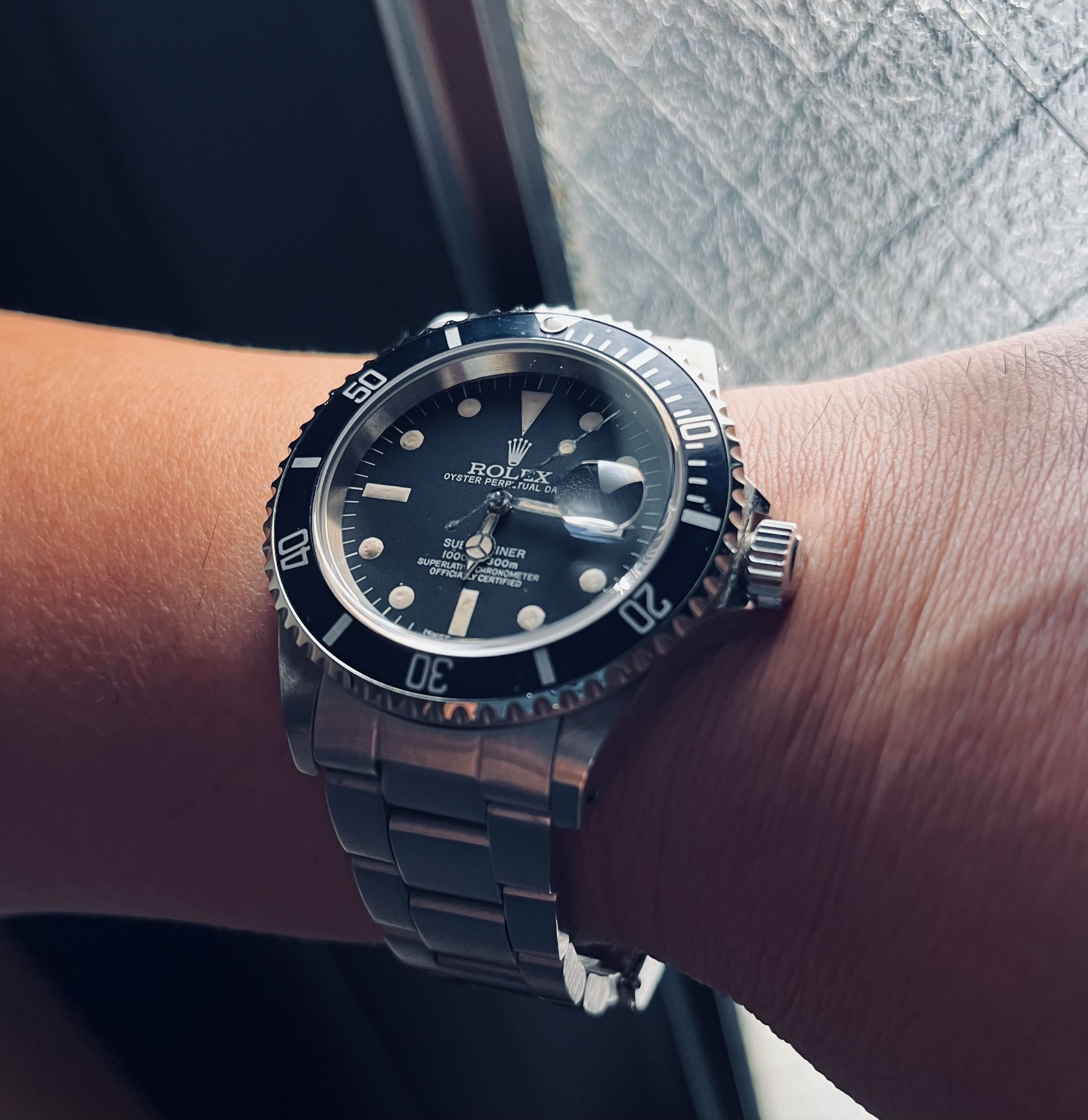

Good eye! Dial, crystal, insert, tube, crown, 3035 are all Gen. Hands are actually from Yuki that I re-lumed with Noctilumina to match the dial. Case is Ruby. So basically it’s all gen except hands and mid case.
Last question, did you age the hands, or is it the just the photo angle and perfect lume that's tricking my eyes? I was 50/50 with hour hand, minute and seconds hands totally fooled me into thinking they were genuine. Damn, they look great in that picture! Beautiful build man.
Again with a great eye! I use a Bergeon Dial pen that has the little leather pad on them and I just sort of wipe the hands down to knock off a tiny bit of shine, then re lume. But that’s it.

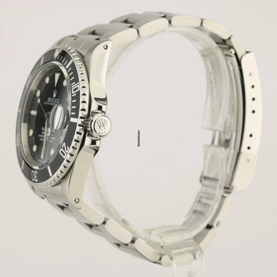

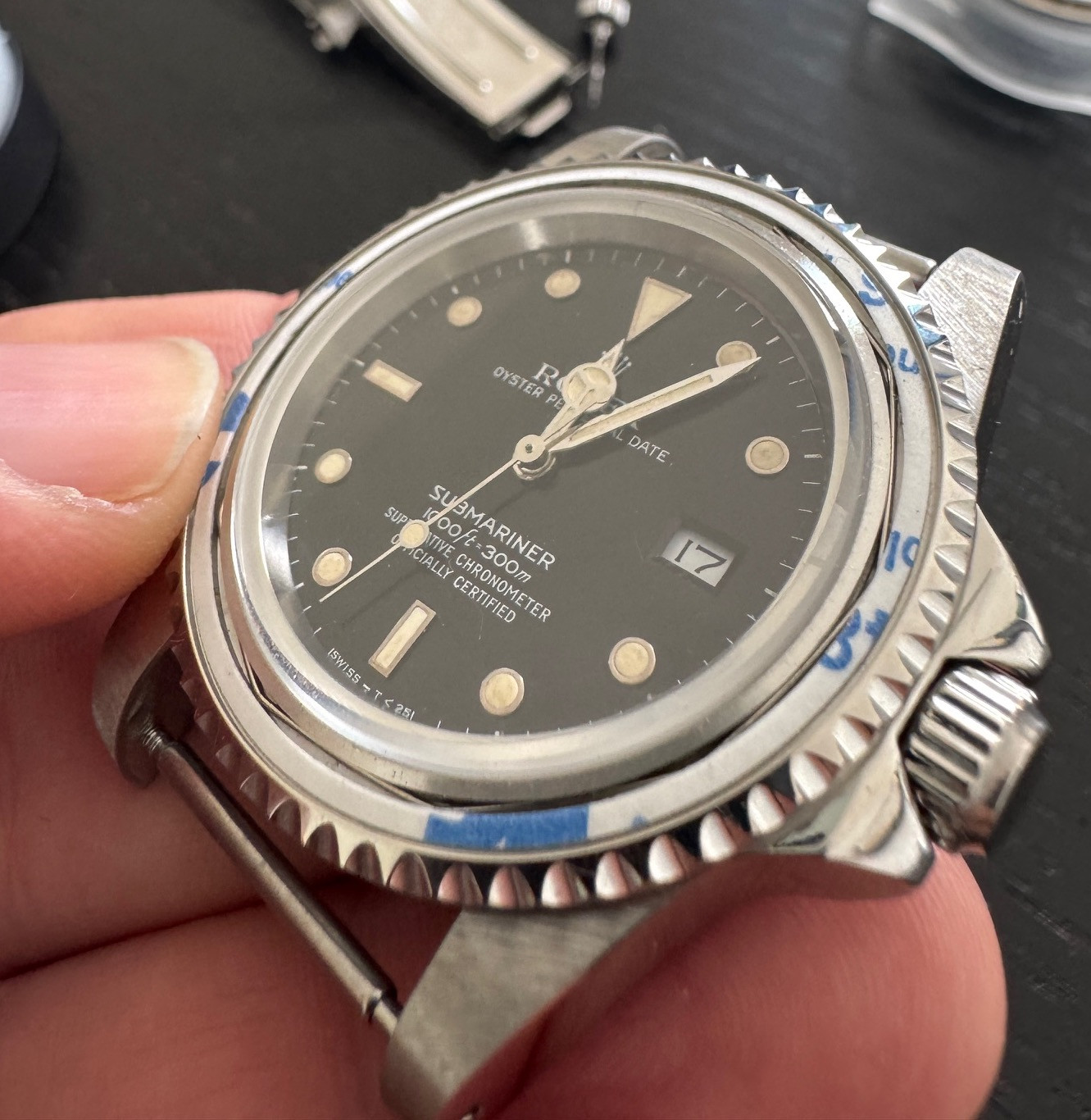

I am quite happy with my MBW case, it has the right look with one exception, the rehaut which is a bit too deep since its originally a case made for 16610. And that bugs me a bit.
Since the Gen 16800/0 is equipped with a 3035 caliber which is taller than its successor 3135 (a little bit thicker above the stem), the 16800 case had a shallower (and also a very perpendicular) rehaut and for a long time I was not aware that it was exactly that what makes me immediately think that a 16800 had the correct signature look.
One could now think to just file down the rehaut on a 16610 case but that will not solve the problem. Then it will look shallower but only because the rehaut is shorter from the top down and also that would result in a visually larger distance from crystal top edge to rehaut top shoulder. And you would need to file down quite a bit which would make it look off.
The real solution would be to shave the rehaut on the inner side of the case which you can only do with a lathe and a lot of knowledge. But then again, a clone 3135 will probably not fit because the stem alignment will be off and could also causing seconds hand clearance issues.

-AliX case: Got a sub case on Aliexpress not branded for a specific sub model but with nice shallow and perpendicular rehaut and lugholes (too small though, need drilling). Gen dial fits. Has a sapphire crystal installed with no cyclop, so need a replacement. Downside is that the case shape needs to be heavily reworked in several spots (lug shape, thickness, CGs etc.). Need to check if Eta 2836 fits regarding stem height though. But I assume it does.
It has a wire spring mounted bezel, so not gen spec but on the other hand I could install the perfect MBW bezel, might work (hopefully).
