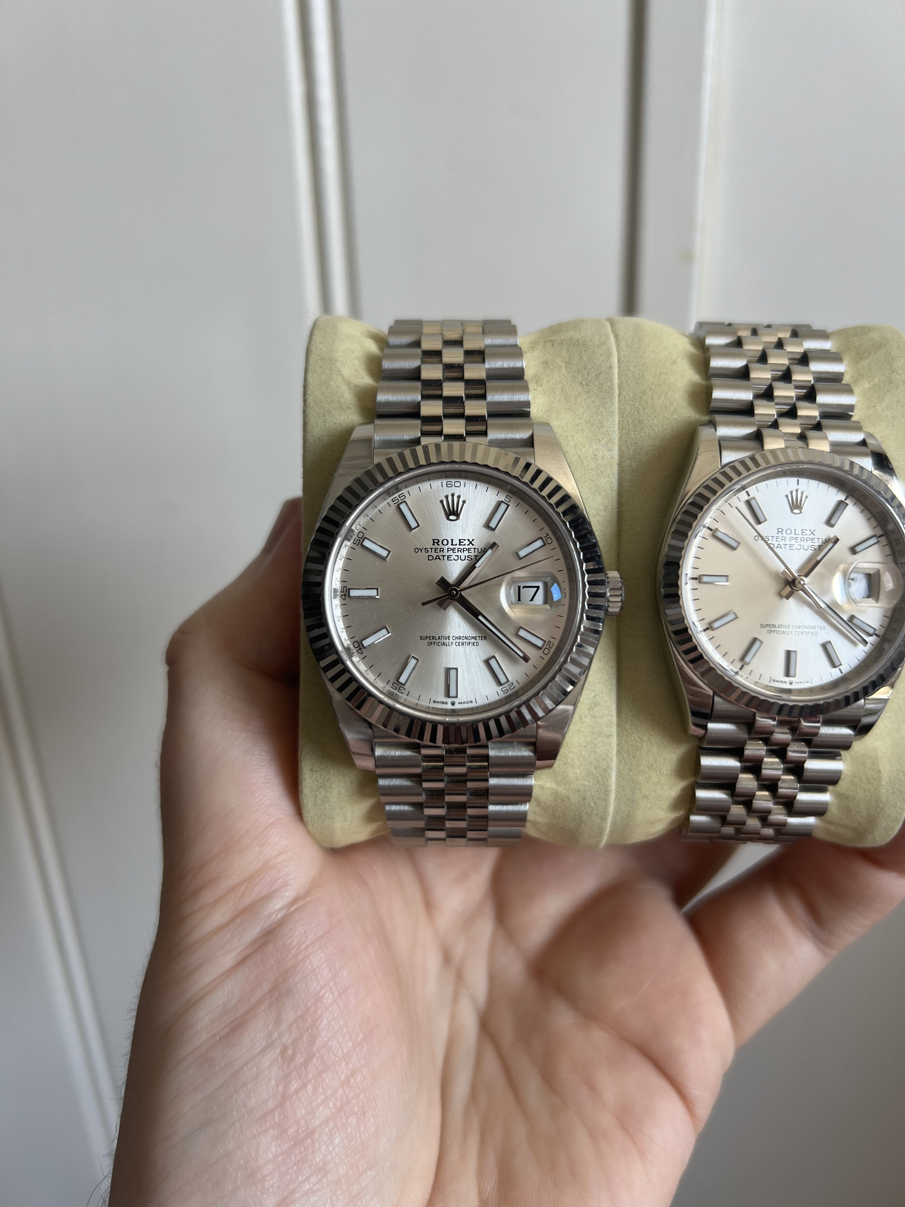

Today I "perfected" the blue build a bit more!
Left: fully assembled Clean DJ - Right: VS3235 with genuine Rolex date disc:
Removed the VR3235 movement, bezel and crystal:
Stock rehaut:
Polished rehaut:
Assembled:
Detail:
In short
  • Case: Clean 36mm 126234
  • Movement: VS3235
  • Date disc: Genuine Rolex
  • Dial: Genuine Rolex, blue
  • Hands: Genuine Rolex (White gold)
  • Crystal: Genuine Rolex (Blue AR)
  • Bezel: Custom plated
  • Rehaut: Polished with “Cape Cod” polish cloth

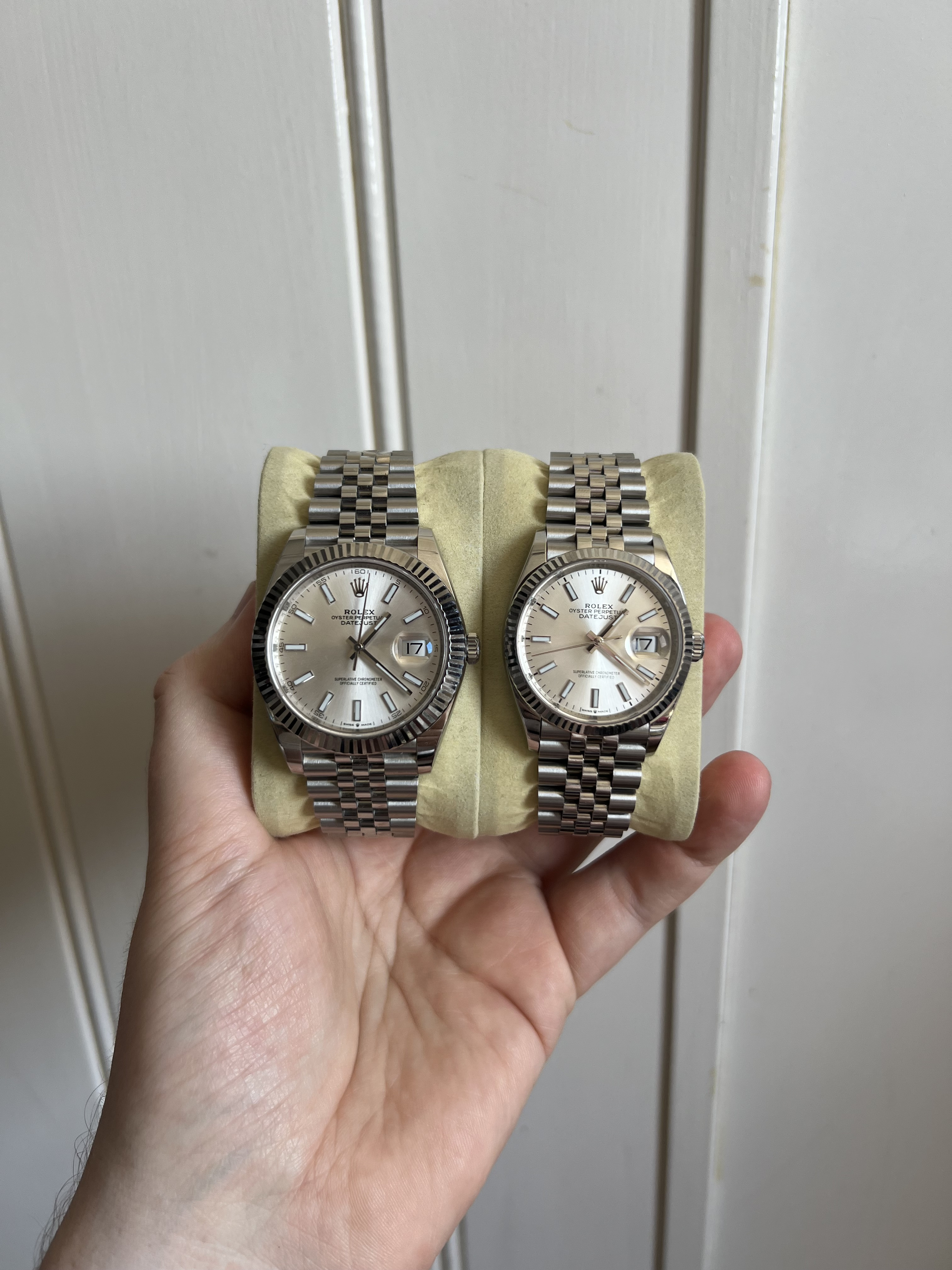

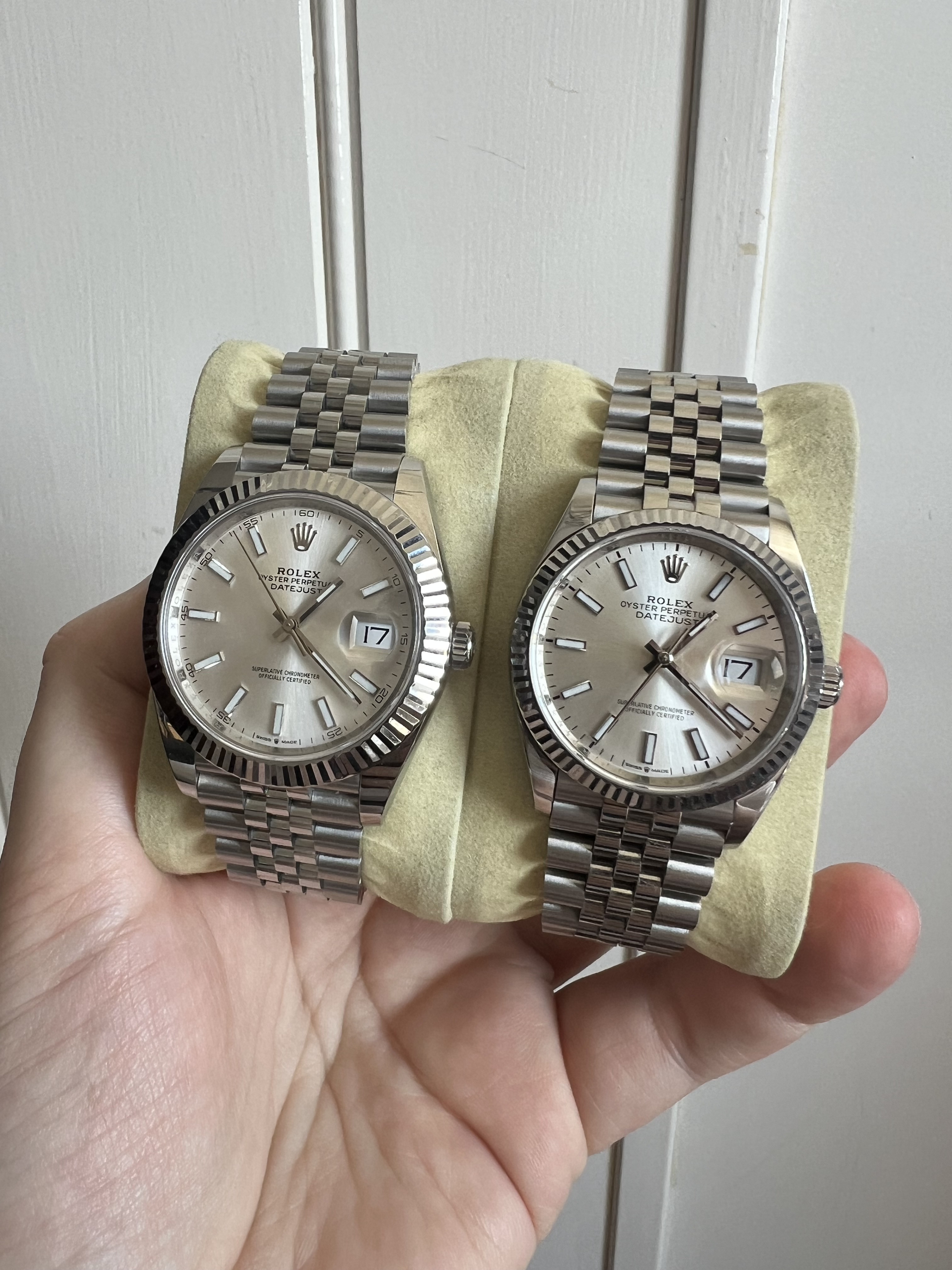

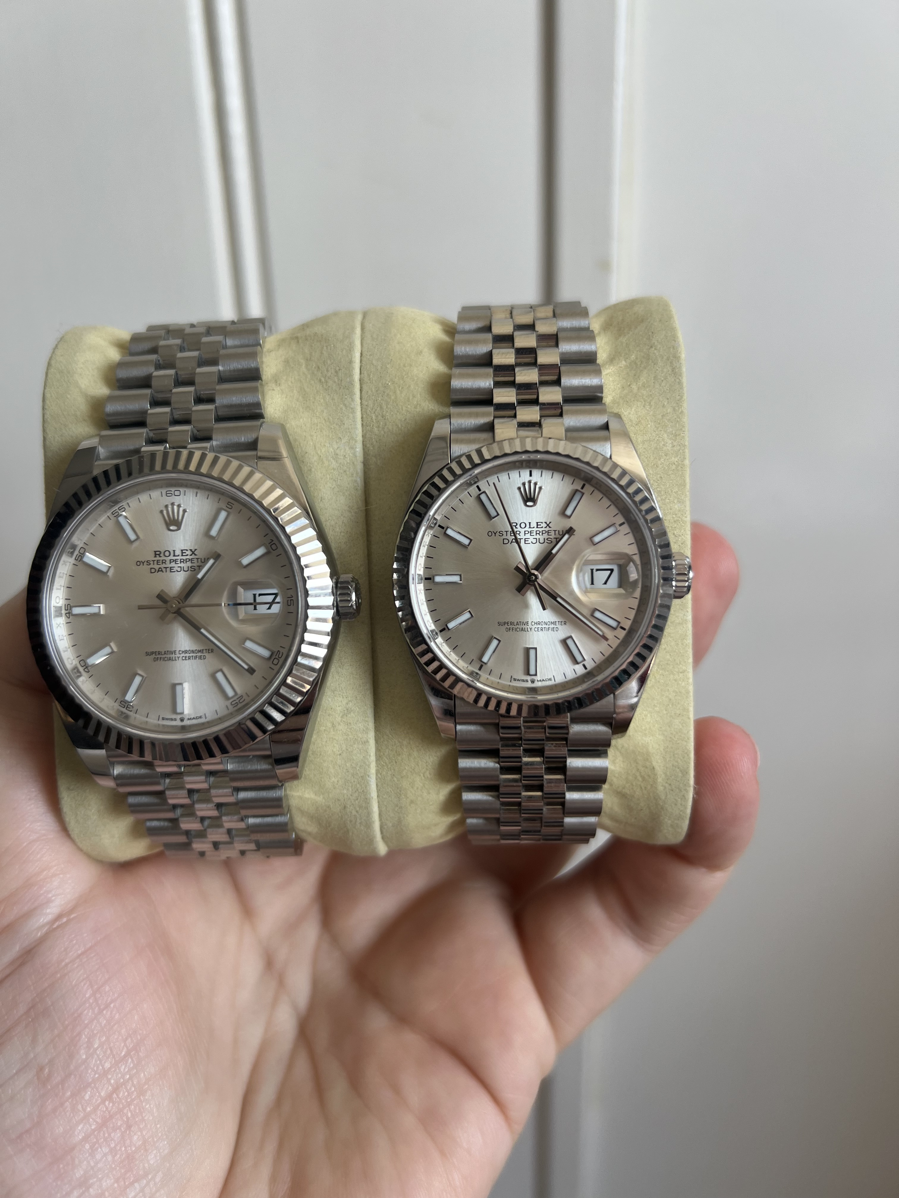

They're both done, I just finished the silver one this night with a set of genuine Rolex hands:
All done, installed and back together:
Only difference now is the date wheel on the blue one, that one is genuine.

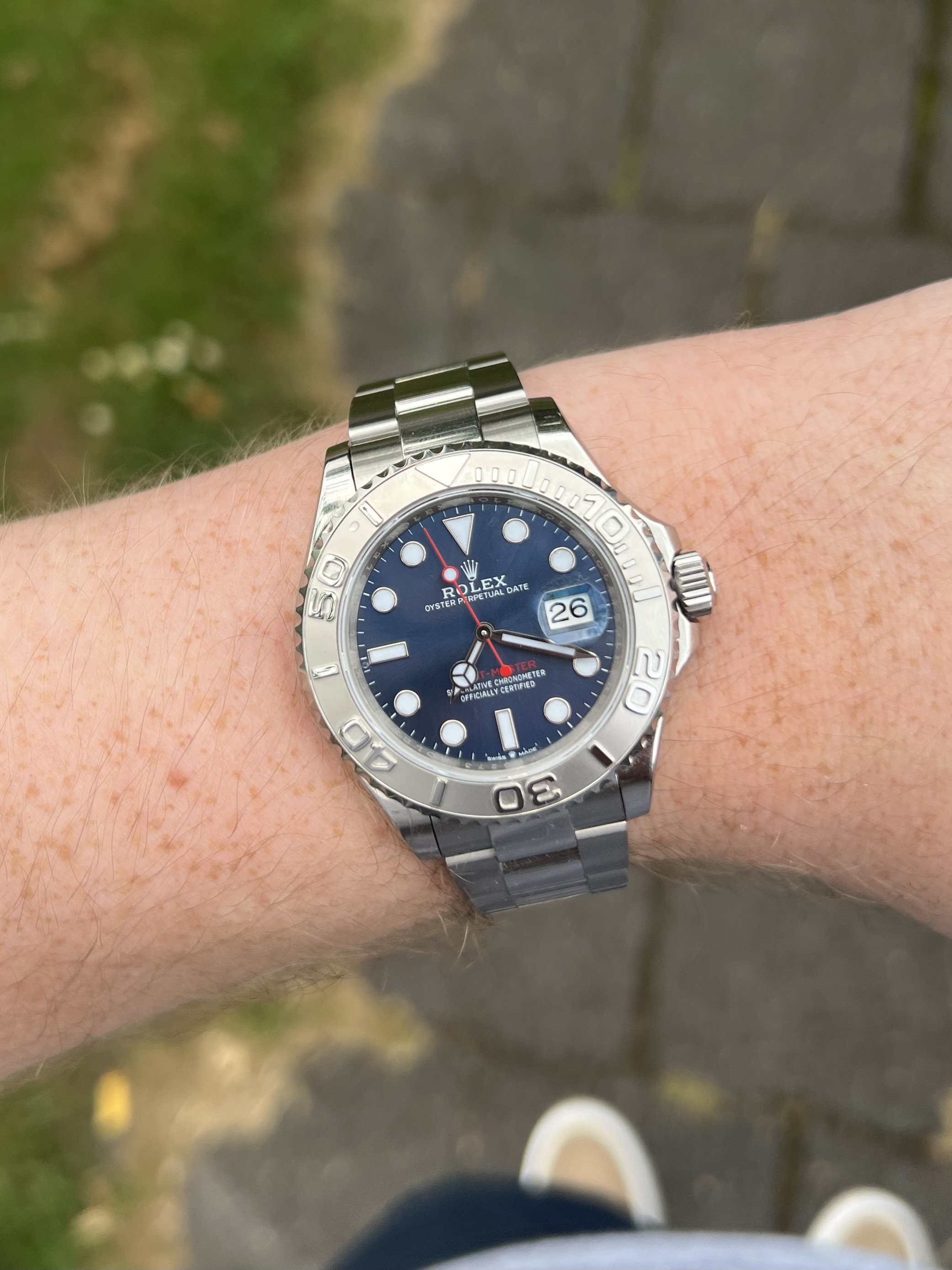

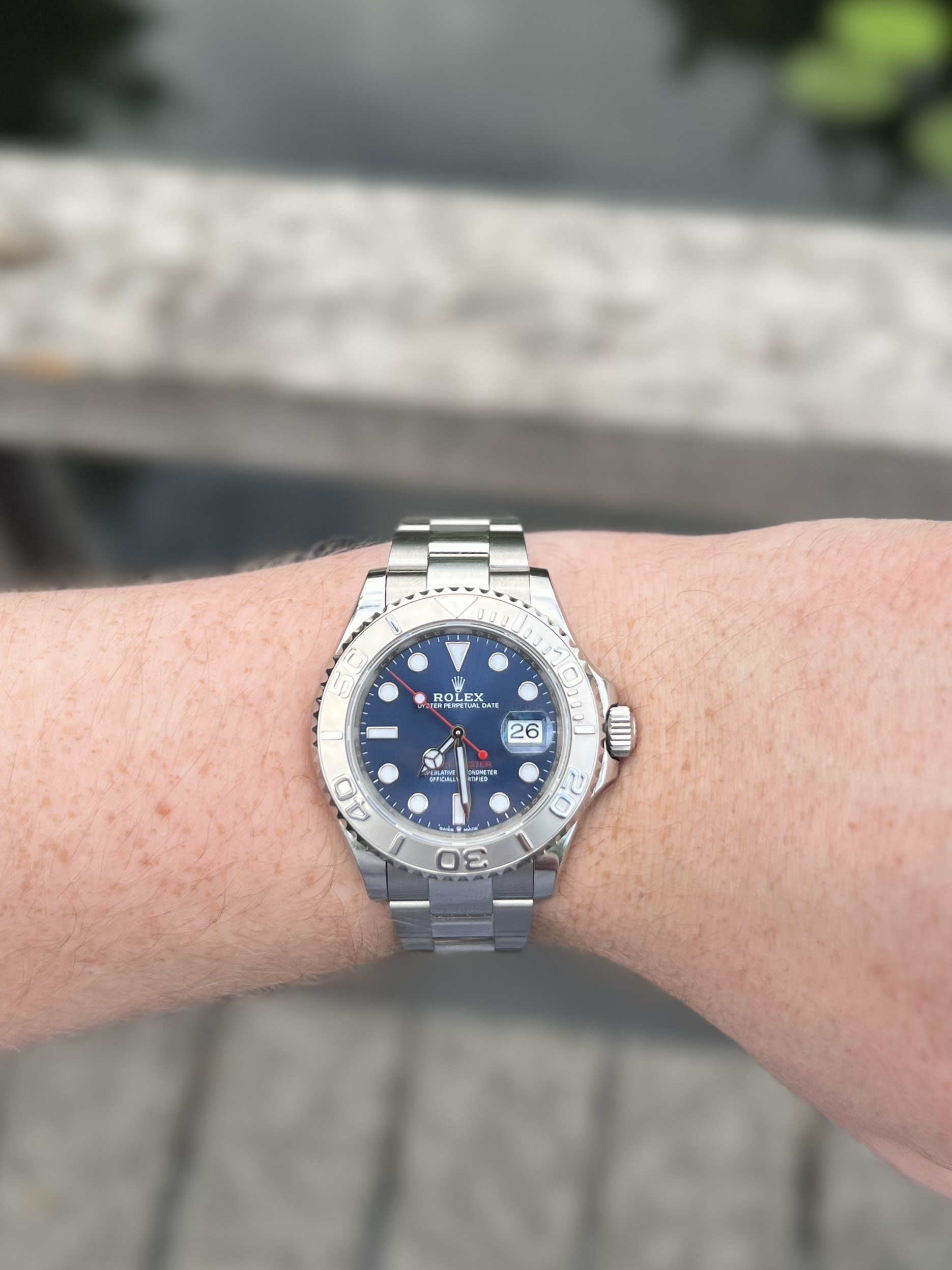

126622 Yacht-Master blue build:
The start of all this, VSF 126622 Yacht-Master:
At the end of last year I lowballed on a genuine blue Yacht-Master dial with red hands, suitable for the 3235, so the 126622.
I already had a brand new genuine 3235 date disc laying around (B3235-1-102-K1), I always felt bad about unboxing something that's brand new.
BUT, luckly I came across another 3235 date disc on eBay, still it was brand new in blister. But now I still have one. Call me weird.
Here it is, the VS3235 with a genuine 3235 date disc. The font is a tiny bit thicker. Not as thick as the Clean 3285 date wheel, but just a hair compared to the stock VSF date disc.
Genuine blue dial:
Genuine blue dial, back:
All installed:
All in all, it was so worth it, the sunburst is perfect. The color is a bit darker, but I love it!
