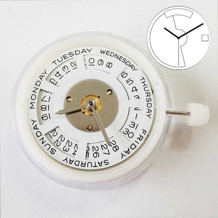

Another option for those who wish to avoid tricky DWOs, some sellers appear to have a 2834 with Rolex day and date wheels already installed. From what I can work out, not just Rolex font but also correct placement for day and date.

I’m following this!
The Alibaba link is interesting though
