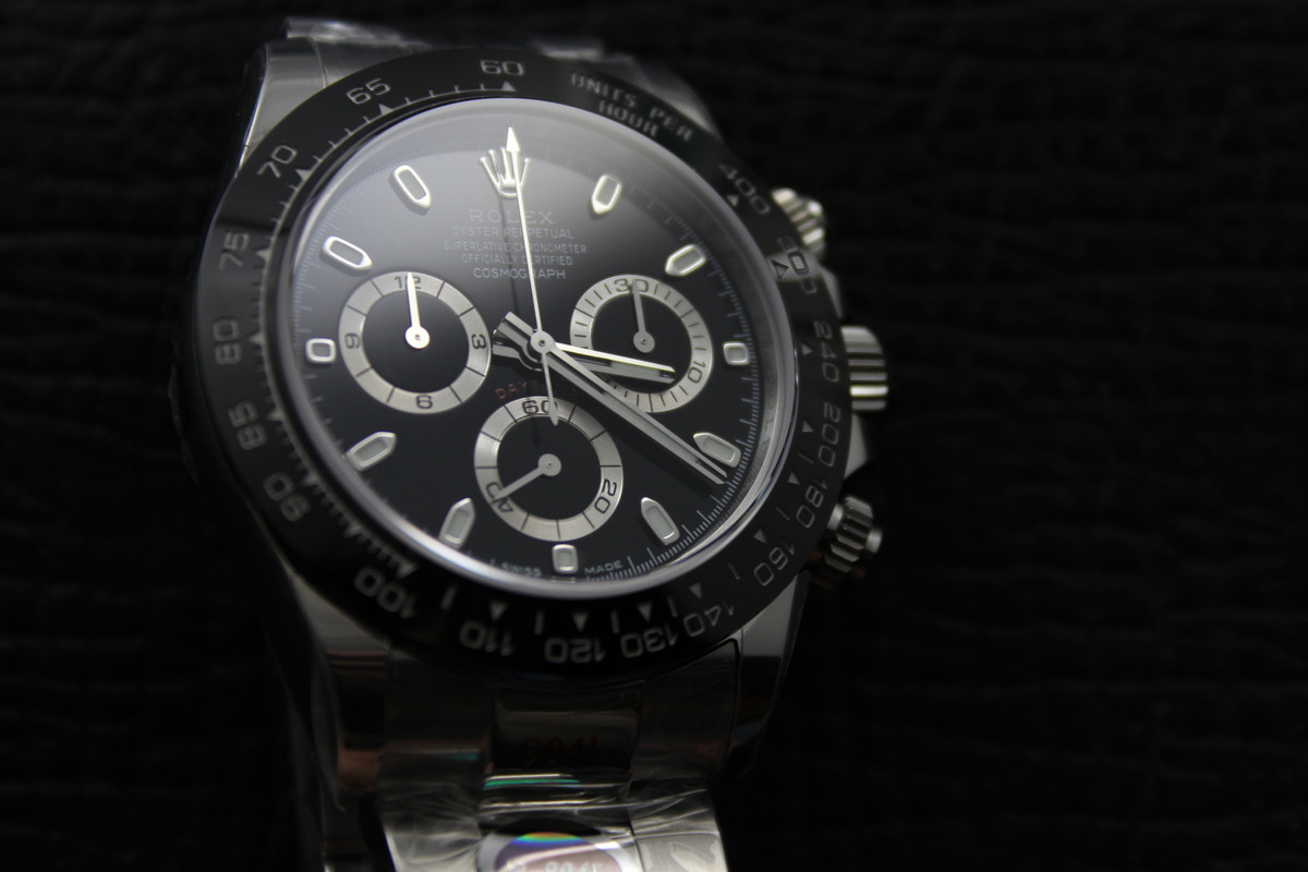

I know a lot of you have removed or replaced the ceramic bezel on the Noob Daytona. I just need to realign mine. Seems I got a newer stock so I believe the 60 & 120 are in a straight line, but they are both a fraction off proper 12 & 6 alignment.
Is removing the movement and popping the crystal & bezel from the inside the only/best way? I've heard trying to pry it with a bezel knife can cause the crystal to come with it. I've also read it requires a crystal press to properly seat it back on. Elucidation is always greatly appreciated.

Yes, if you are gentle you can easily do it even with a case back knife. The bezel holds the crystal in place so for sure it is loose. But you don't need a crystal press to put it on. The press is rather needed to press the bezel back in place. A cheap 20$ press does the job if you are careful.
