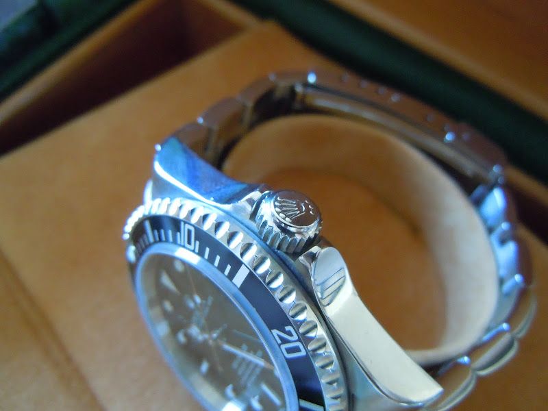

Surf, here is a pic I found on the good ol web and the crystal on the BP looks pretty close in hight to a gen? Atleast to me it does.
surf
26/8/12
1,818
98
Yeah it appears close I have another in the mail to compare and am also going to get unique with the Crystal gasket.
