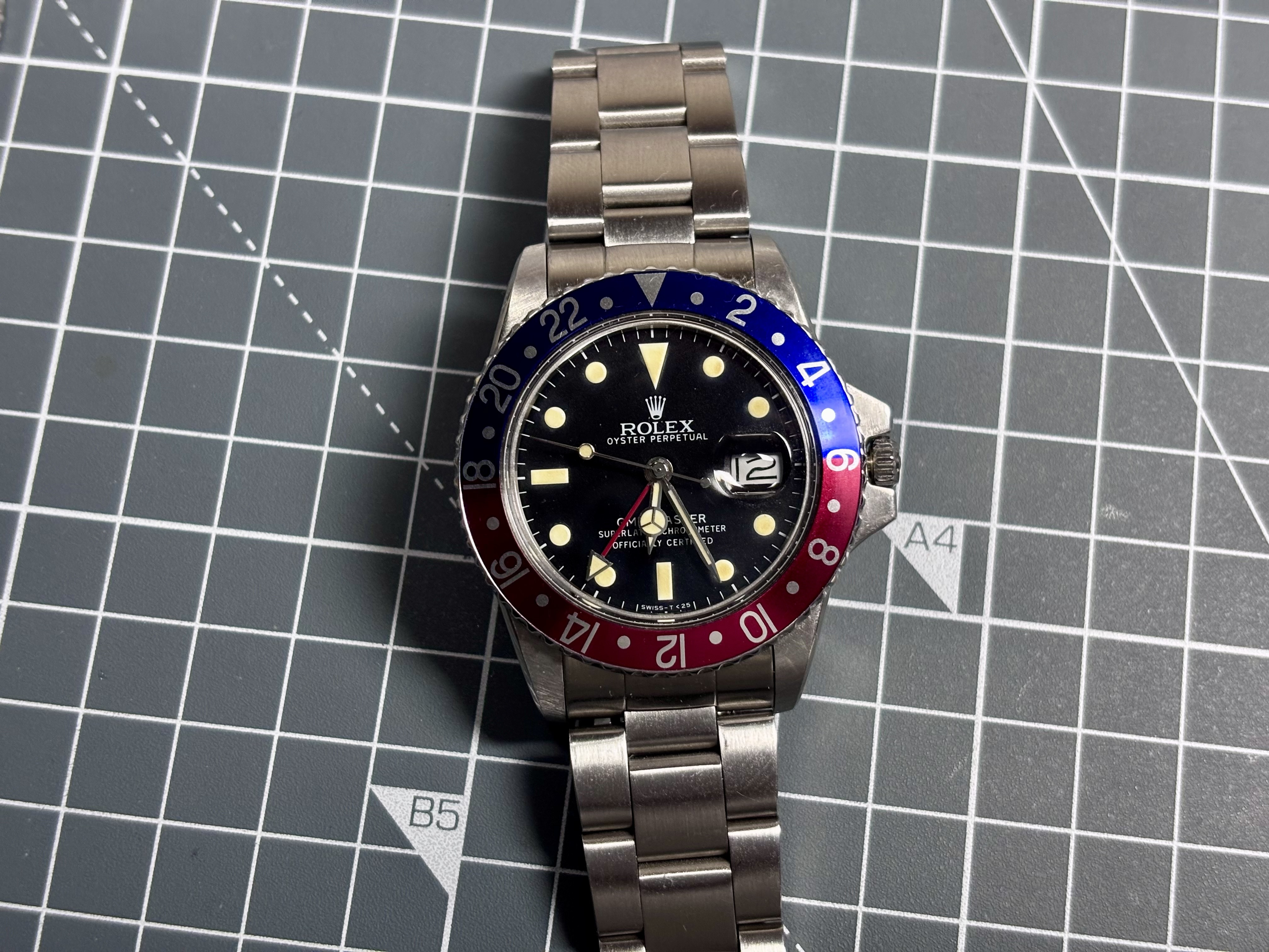

Built a 1675 based on the Raffles case in small steps. I like it as it is now, but thinking on doing some changes to improve it. The movement is a NOS ETA 2846 converted to GMT, dial and hands are Raffles, bezel set is from Ricks, crown tube was replaced with one from Cousins and crown is Athaya. Bracelet is a hybrid from many sources.
Tested to be waterproof to 3ATM.

@Unpede - Does your bezel from Ric's rotate?
I purchased the bezel set from him along with his 25-116 crystal and the bezel is solid.
Same for me, stuck. Will take it apart because need to find our where the problem is. I also have the Ricks set on a 5513 and it rotates as it should and looks great. One of the items on my to-do list.

I see a lot of people have a gap between the bezel and case which makes sense as I believe the 1675 bezel is supposed to be pushed down to rotate. Perhaps I need to back off the crystal retaining ring a bit to allow the bezel some room?

If you see how the retaining ring is mounted in a video, I can't see how it can not go all the way down. It is pressed down as far as it goes. We'll sort it out :)

I agree - it appears to only go on one way. I am going to take my apart tonight and try to do some fitting.
Anyone else have this issue that wants to shed some light?

Did is come with the flat metal spring? If so try fitting it without it.
Also does it rotate when you fit it together off the case?
Just be sure the crystal isn't interfering with/rubbing the bezel insert.

Did come with the tension ring and tried without it, same problem. Didn't try to rotate the set before installing it. There's a gap between the crystal and the insert and also tried without the insert and wasn't turning. Either friction in the ring slot or at the bottom against the case. Will have to remove the whole thing to find out.

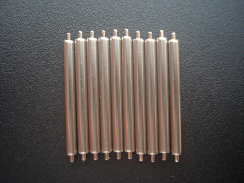

What spring bars fit the case and the raffles Oyster bracelet? The ones that Ken offers that come with the bracelet don’t go all the way to the log holes. Does Cousins have the right ones?
Unpede
24/1/24
Yes, you can fit 20mm (2mm diameter) stainless steel ones from that store.
