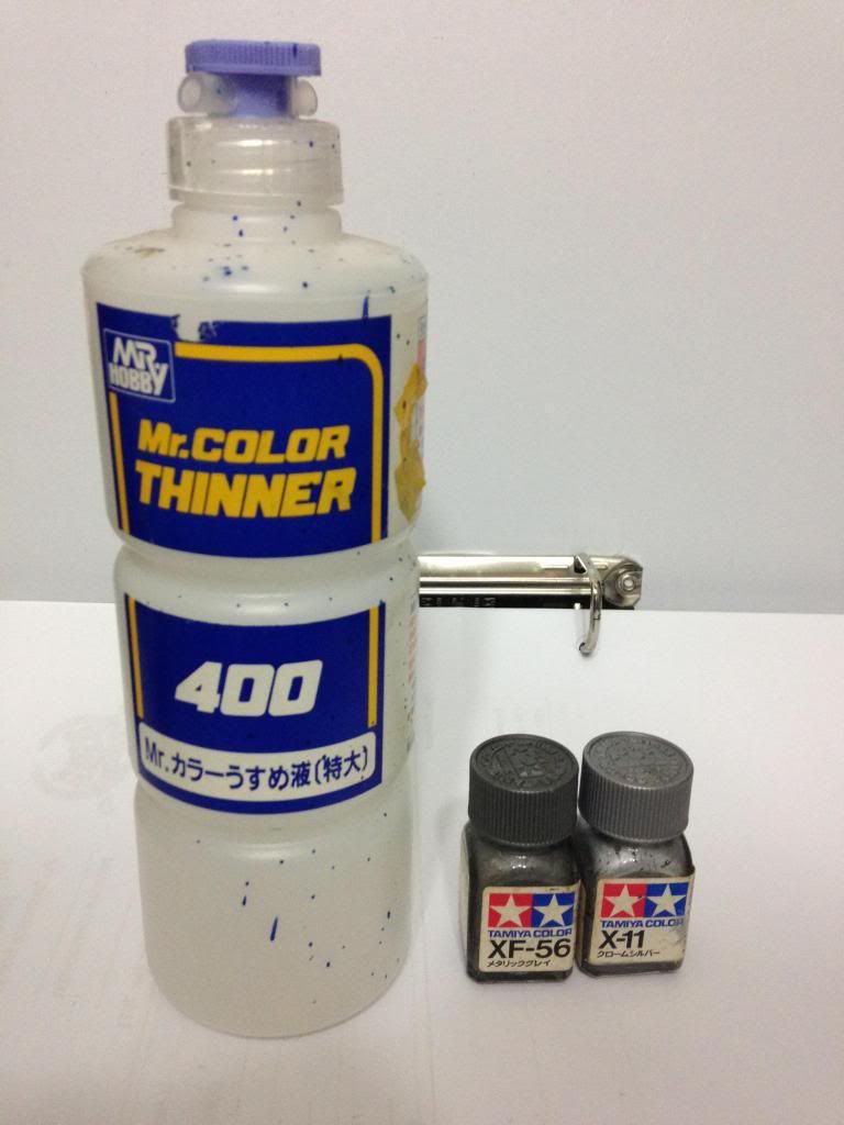

Hi guys, thanks for everything. try to make it as clear as possible for you guys so that its easy to follow. Please forgive me if any of the part is unclear and the poor photography. Any question feel free to ask or even PM me. So here we go!!!!
Item

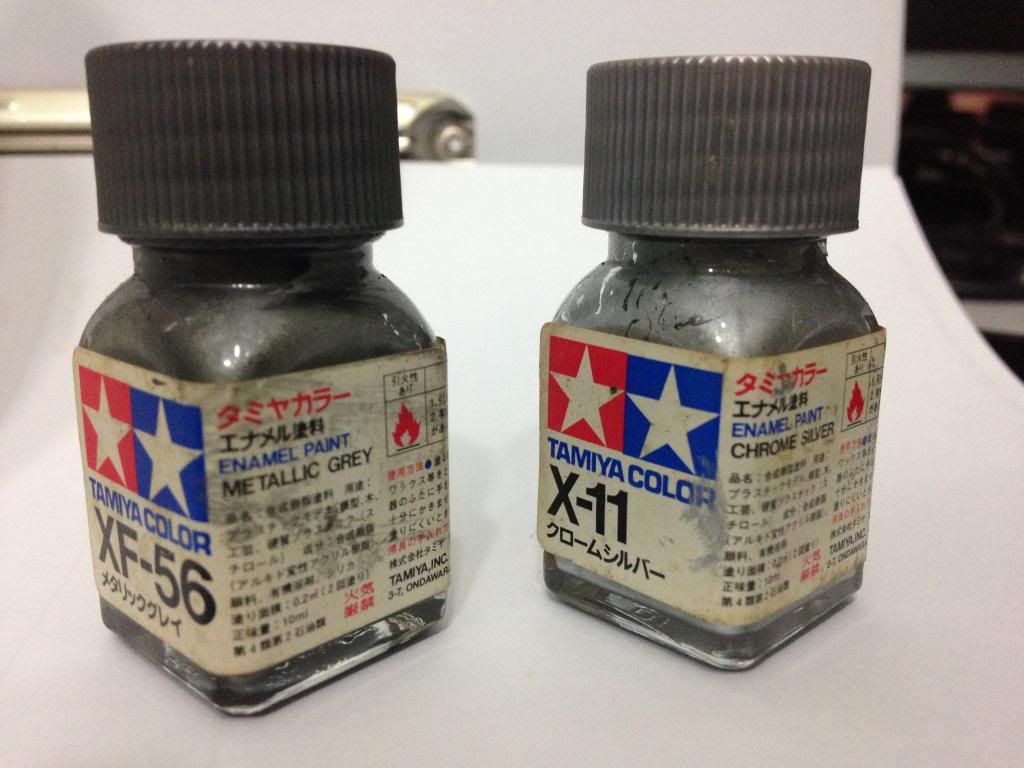

-Mr hobby Thinner 400 & Tamiya Acrylic Paint
-Tamiya Acrylic Paint XF-56(Metallic Grey) & X-11(Chrome Silver)
NOTE:IF YOU DO NOT WANT TO MIX THE PAINT PLEASE USE XF-56 AND NOT X-11
I prefer to use Acrylic Paint (aka Enamel Paint) than water base paint as they are easier to control perfect for small detail stuff and there are harder to fade off.

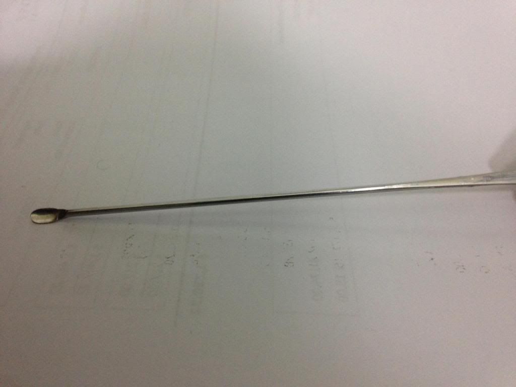

-Paint Stirrer (to mix both paint at 2:1 ratio, 2 part XF-56:1 part X-11)

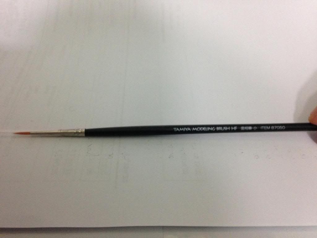

-Tamiya HF Brush ( If not any brush will do, try to get the better grade brush as the hair from the brush will not drop out and get stuck on the paint job)

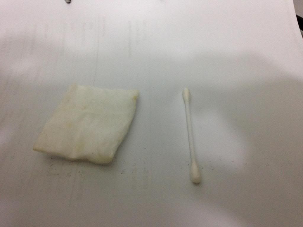

-Cotton Wool and Cotton Bud

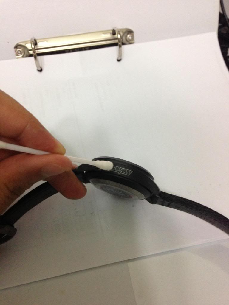

Remove the paint from by using the cotton bud with the thinner, this is to make sure you remove all the paint from the edges.

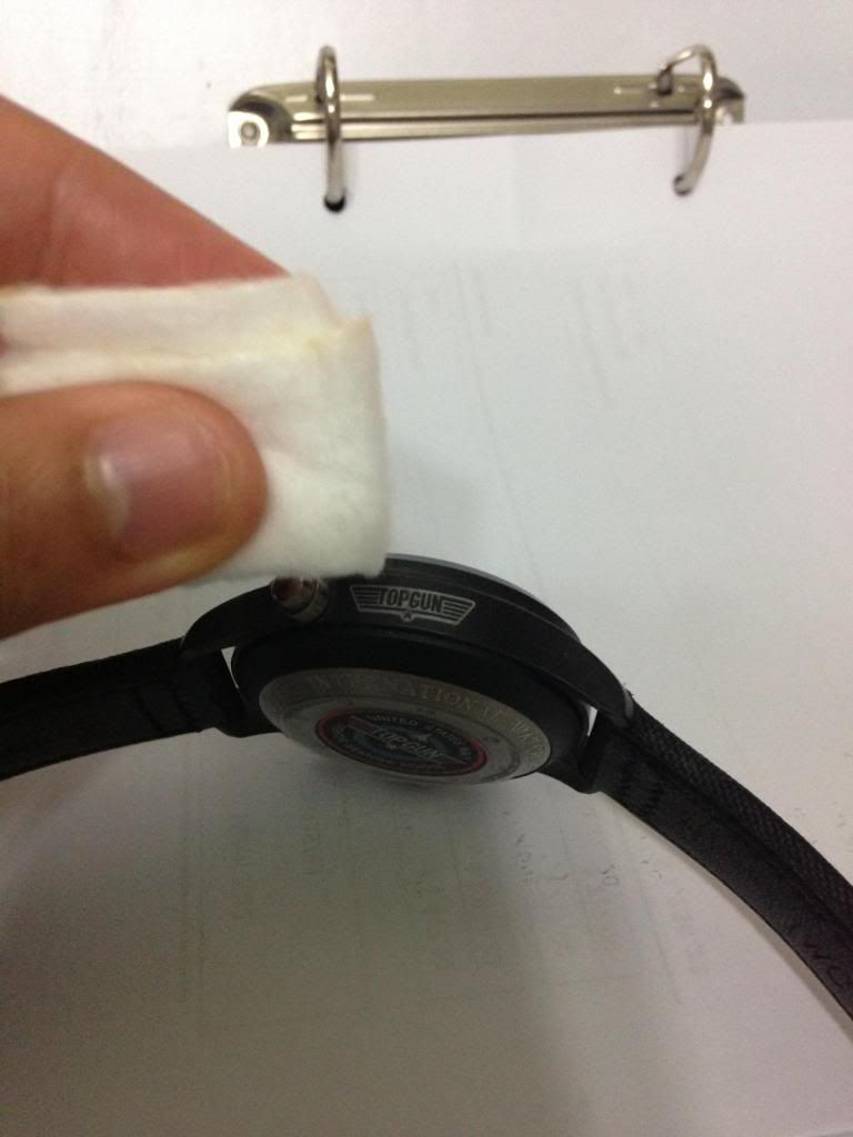

Paint over the Top Gun logo with the colour. (I use the 2:1 ratio)
Now apply a small amount of thinner on the cotton wool and whip over the logo lightly until there's not more paint outside the logo . Due to the engrave, the paint in the logo will not be remove.
REMEMBER DO THIS WHEN THE PAINT IS STILL WET!
PLEASE NOTE!!!
- Do not apply a large amount of paint at the first time, this will actually fill up the logo with paint. Kind of like filling up hole with cement. The trick to get the perfect coat and look is to apply a thin layer over and over again.
- It ok if some of the paint in the logo get remove the first time, wait for the paint to dry (30mins -45mins), clean up than apply the second coat. For me to get the desire outcome i did 5 super thin coat.
So this my 1cent to mod your top gun. Please feel free to PM or ask me question. Once again please forgive me for my bad english and poor photo.
Cheers!!!
A very happy topgun owner!!!
