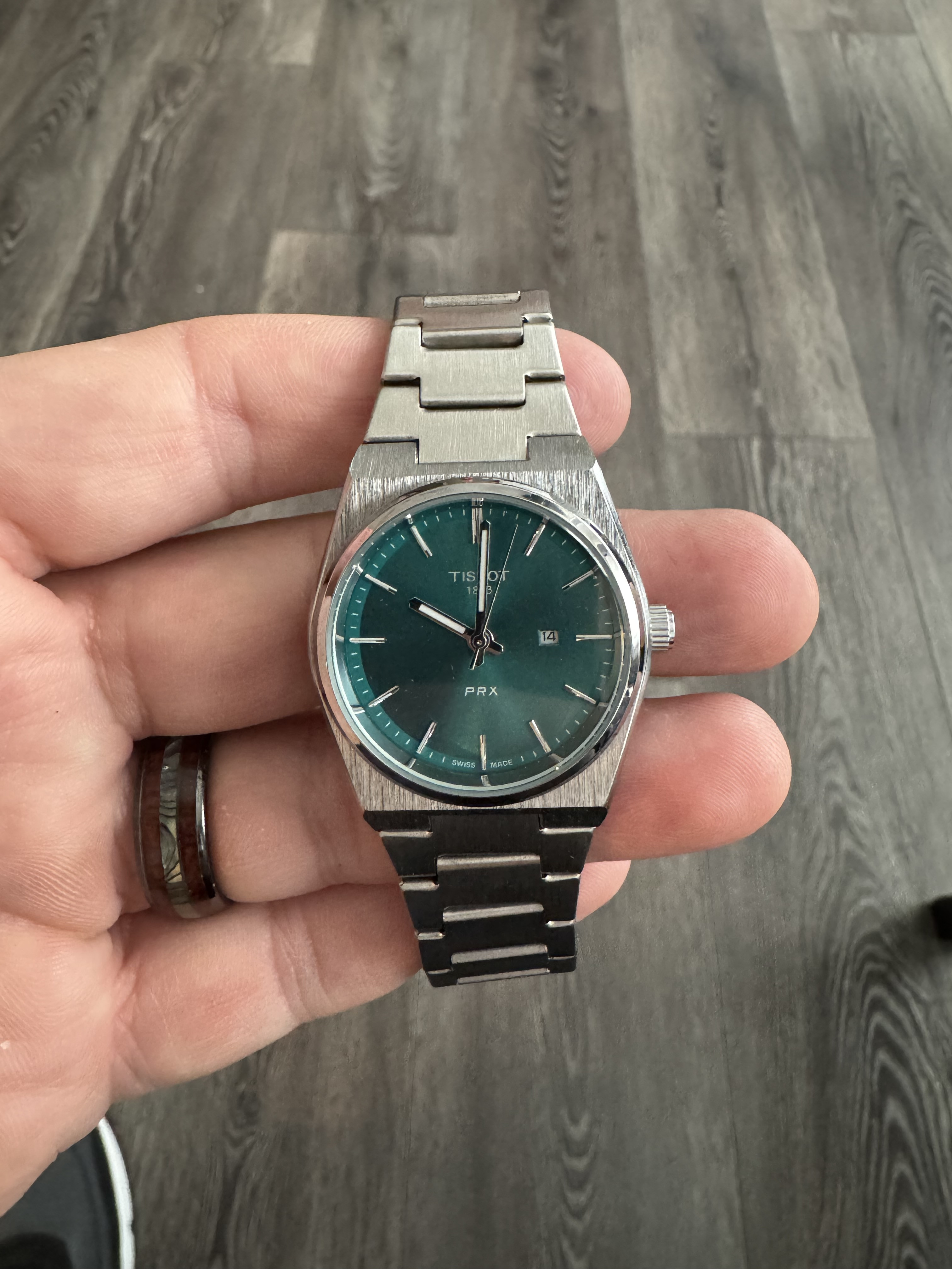

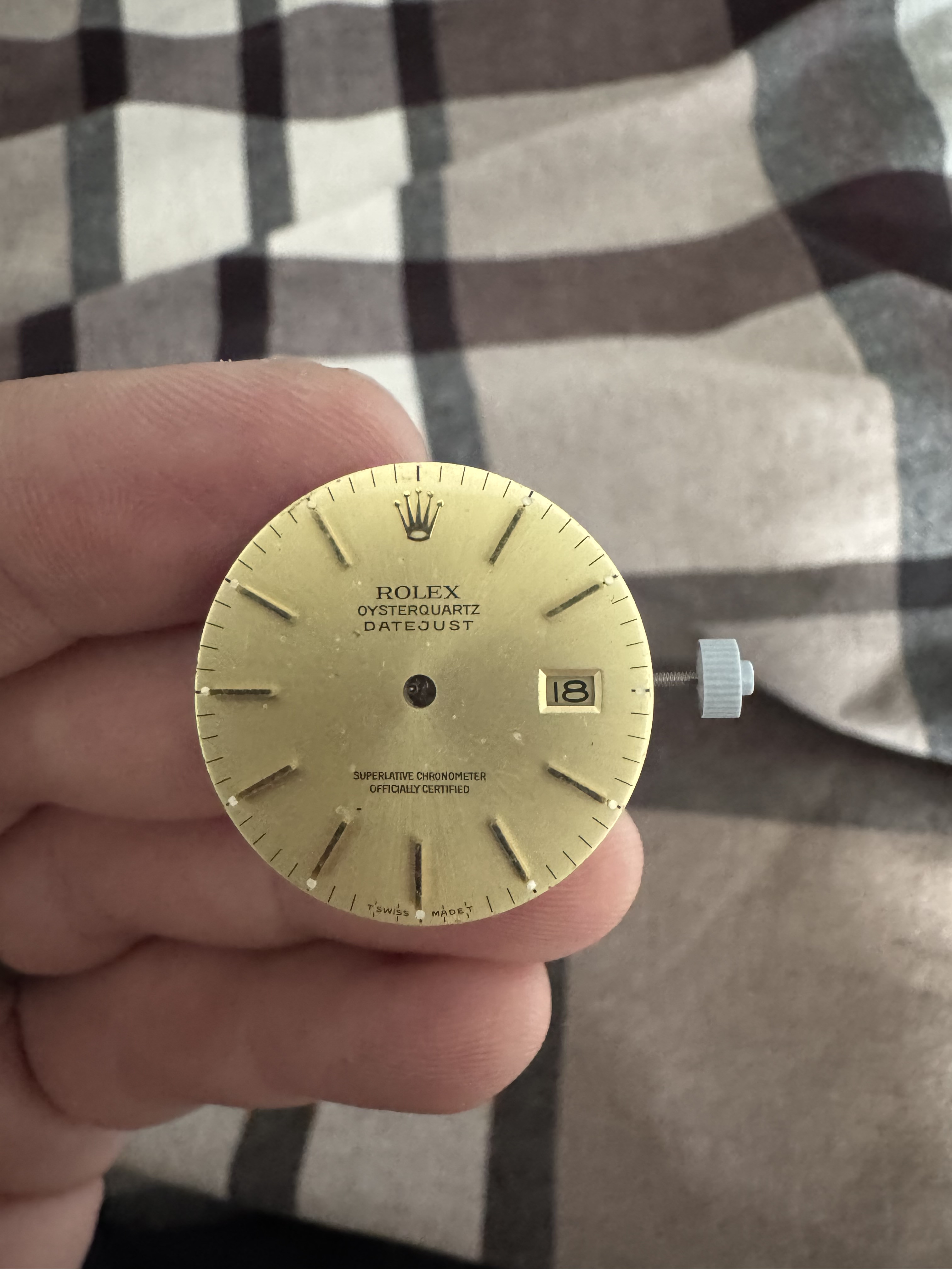

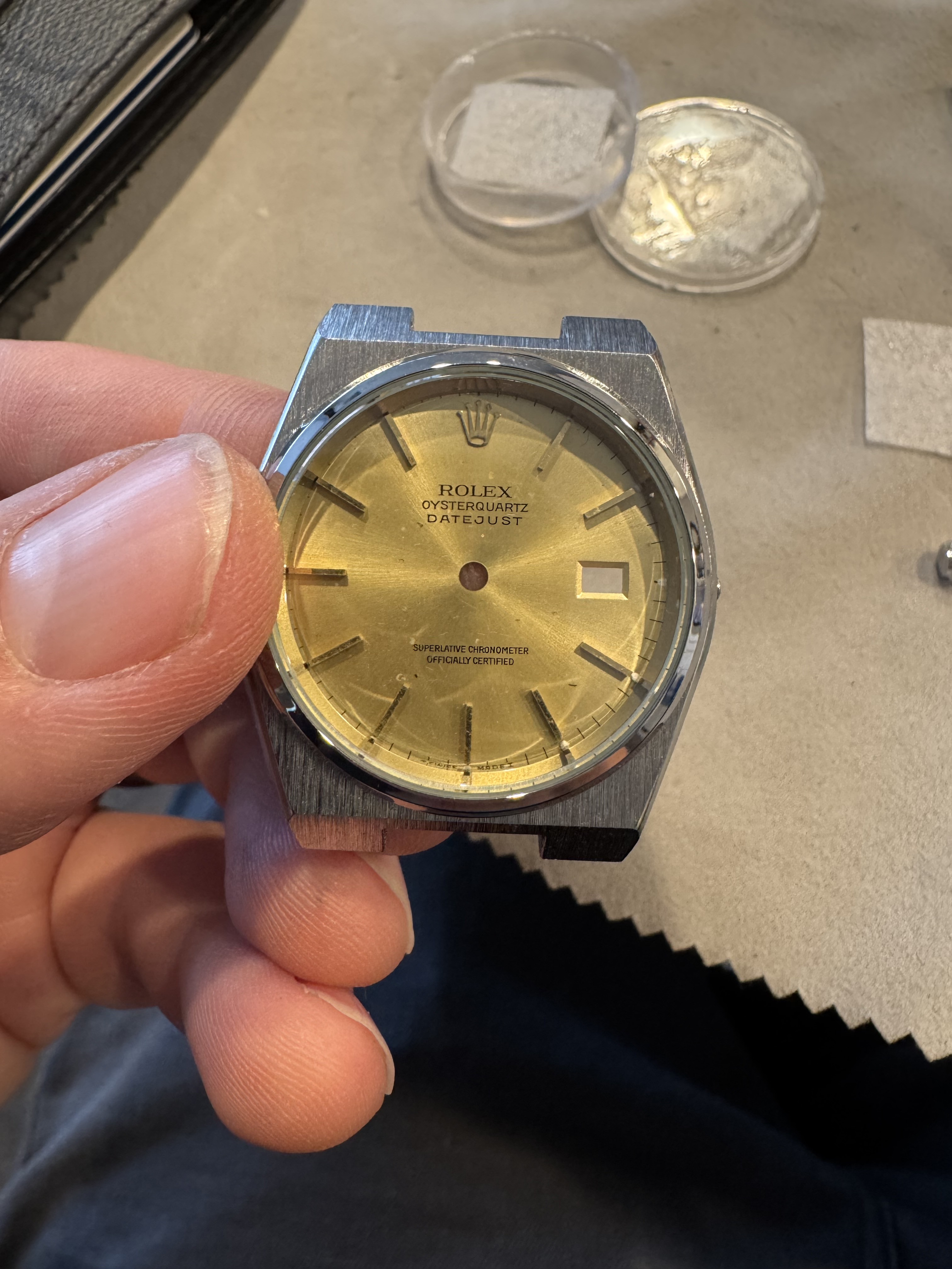

Quick mock up. Gotta figure a good method to secure the dial to the Ronda quartz movement and secure that in the case. I have gold quartz hands and a champagne DWO arriving soon too.
If I can get it all to play nice then I’ll grab a gen gold Tissot and drop it all in.
It really does come toegether pretty easily, doesn't it? FWIW, I popped out the glass crystal that came with it and added a gen Rolex acrylic crystal from a 34mm OP Date. It had to be sanded down a bit, but gives it a bit more of an authentic look. Otherwise, you can get an AliX cyclops and add it to the glass.
I’ll definitely look into that for the finished product. I wanted to make sure I had the ability to do it first on the cheap PRX.
I’d like to do a fluted bezel as well. That’s going to be tougher to find I have a feeling.

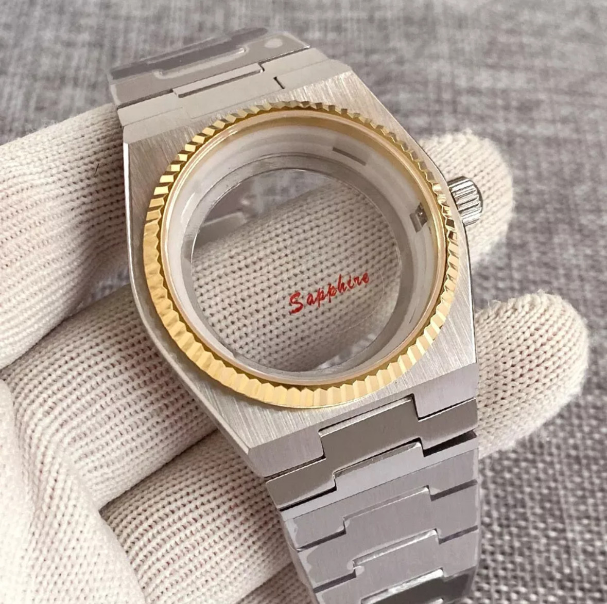

I wonder if this will work for the quartz version.
Just grab a full gold rep and slap this bezel on with the crystal you suggested.
dpd3672
29/5/23
1,939
3,241
I would imagine it's the same case...is it 35mm?
