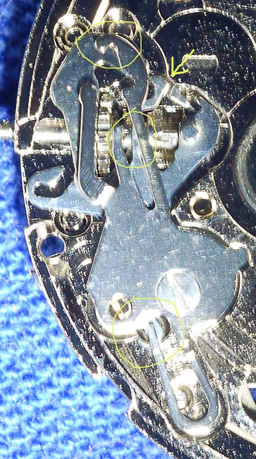

Another item which is annoying me now is, the 'ghost date' issue it clearly has and possible implications to modding the piece.
The movement does have the 'ghost date' and because i have a new dial & hands from Helenarou here (the dial having the dials pins on the back of the dial, is this going to cause and issue because of the 'ghost date' being present?
Also, can anyone inform me what i need to do in order to remove this issue. I know about the setting lever but i have no knowledge as to where to acquire the correct one or what needs to be done to rectify the issue.
What happens if the movement has a spacer underneath the dial?
What do i need to do to fit the new dial correctly?

1. ghost date.
JKF puts a stock asian clone 2836 with the calendar works totally removed. However, the movement keeps the standard setting lever jumper with 3 positions. Which is normal as the 2836 is a day date
You need to change the jumper to a 2801 movement jumper witb 2 positions. No hard but not newbie stuff. At the very least, you need to know how to reset a keyless work
You can find them at CousinsUK

1. ghost date.

Last, it's the 'ghost date' issue - Can you point me in the right direction as to what is required to fix the issue, thanks friend :).
THX

I've read that the part in the image you attached can be modified without the need to purchase the one say from CousinsUK

Something to do with filing down or removing one of the notches that the setting lever pin 'moves' through...the position of the settings per se

It isn't a huge issue in actuality to be honest. I can do the mod later date but would've preferred to do it in one go *sigh*
In actuality, once the time is set anyway what does it matter? - The watch will function normally and it's not doing anything to the aesthetics of the watch so...maybe i could just mod that later date.

The ghost date erase piece is 'out of stock' until the 8th March.
I can place the order but it won't arrive until they come back in stock at CousinsUK and then sent out to me.

For those that read this, i have managed to hunt down the Setting Lever Spring to remove the 'ghost day/date' function.
On eBay UK, there's a seller selling NOS parts for various calibre ETA movements - They have only 2 remaining of these parts as i just purchased one, instead of having to wait until March 8th from CousinsUK (they have none in stock).
The item number on eBay UK is: 165955732842

Is it straight forward to replace the setting lever spring...? Is it a straight swap over or are there any tutorials or information i should know before doing the change of piece?

if you follow the guide I linked above, it's straightfoward.
And you will learn to reset a ETA keyless, which is a great skill to acquire.
You will need a magnifying gear, good tweezers, a movement holder and screwdrivers. ideally an oiler and lubrication while you have that opened up.
Just make sure you work in a clean and uncluttered area...if a part flies from your tweezers, you are in trouble.
