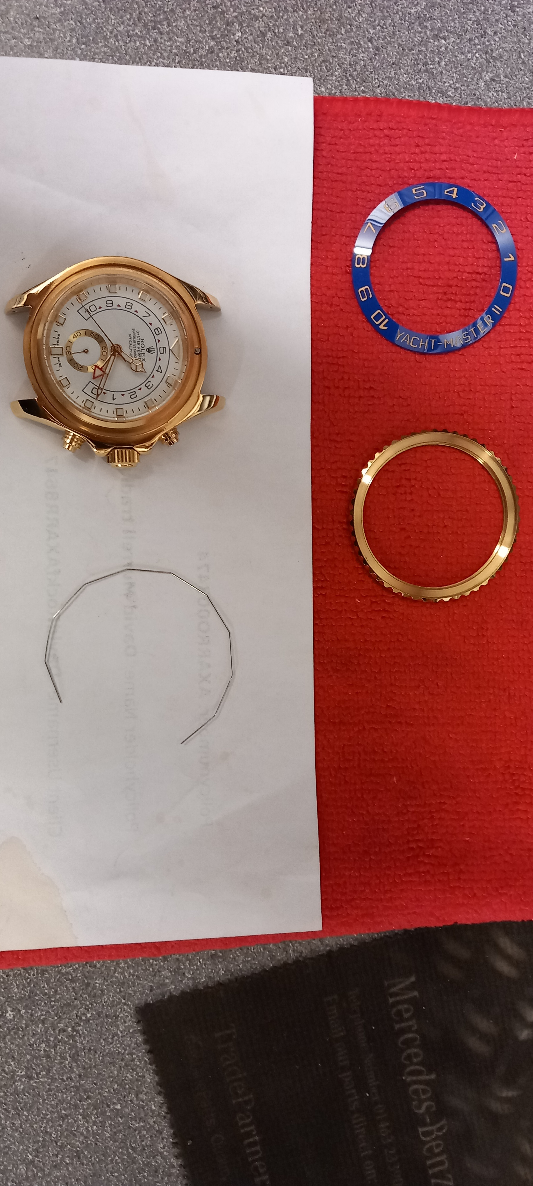

LOL, it's more about time, Sunday is best quiet day, and today I have to take my dear Minx to the hospital in Inverness which is 120 + miles round trip so today is screwed.
The other thing is that despite searching I haven't found a replacement insert for one of these, and I am a sossidge fingered old git when it comes to being a learner to these repairs.
If I had a replacement it would be out and done by now.

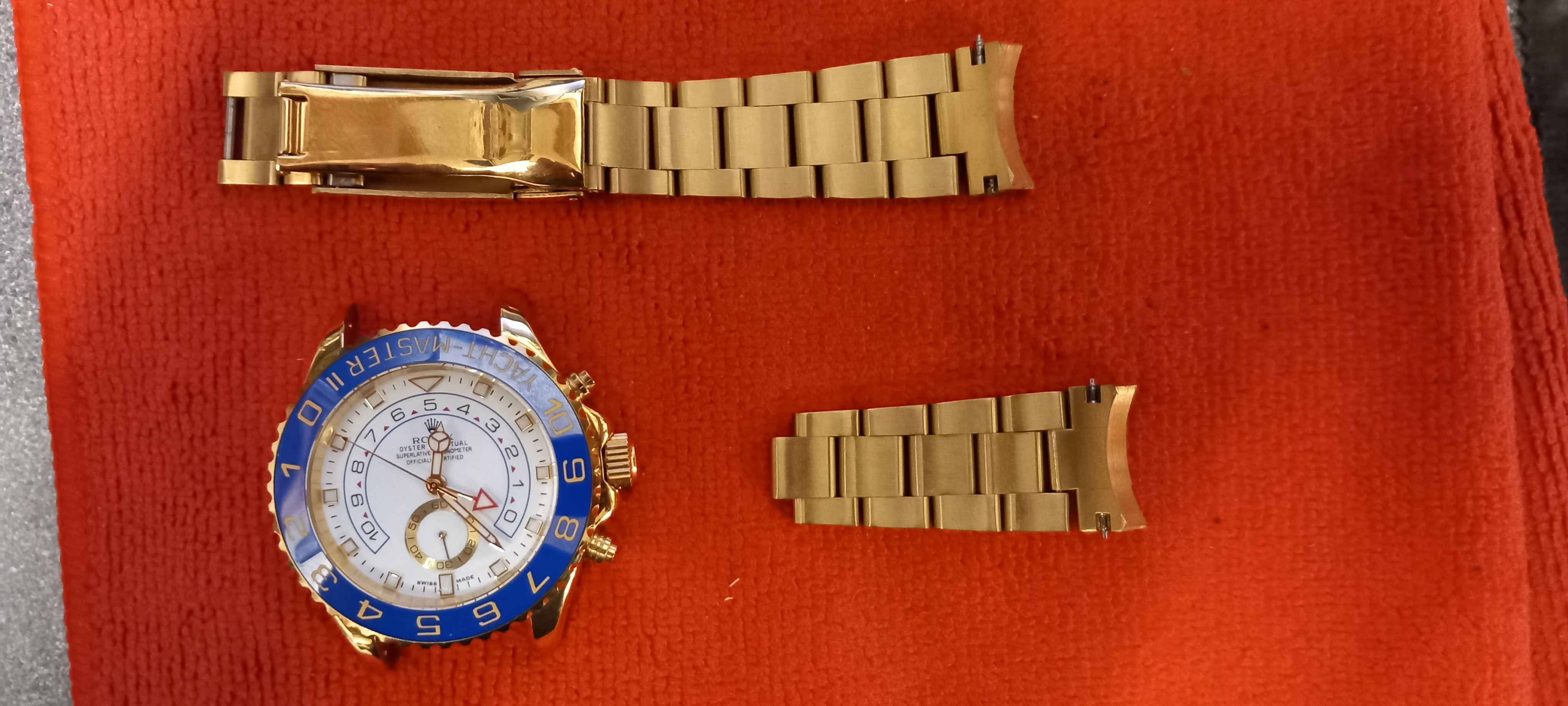

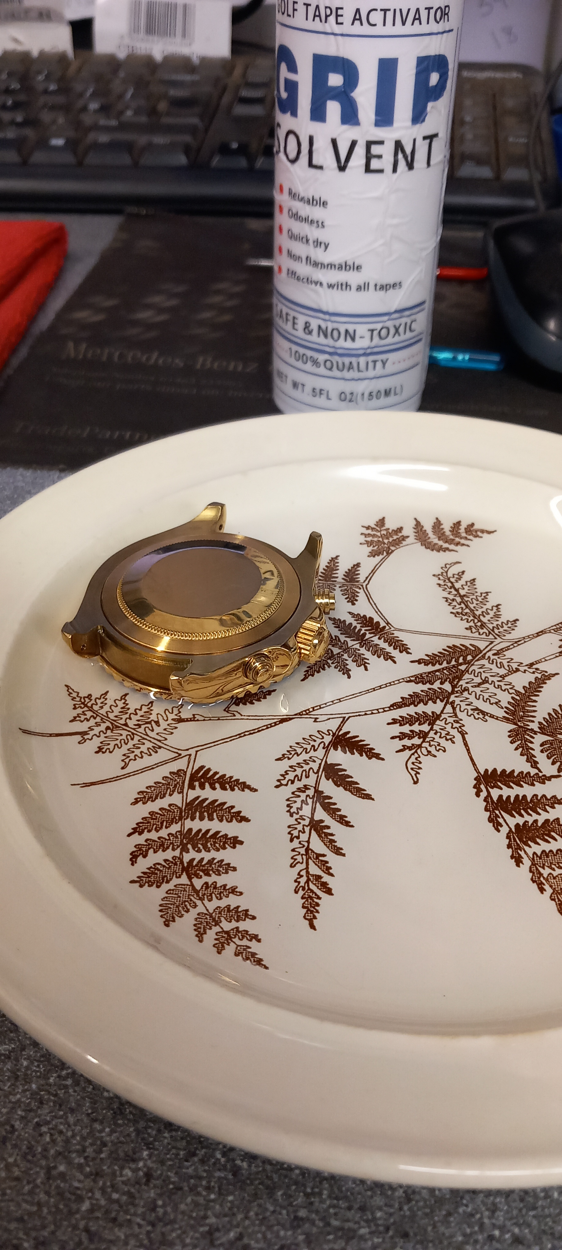

Golf club grip glue solvent arrived today, I will get to this Bezel repair ASAP, which is weather dependent as I will be working on an outside building project each day it is fine weather, forecasts (yeah yeah yeah) suggest the next 2 days might be good, so likely be this weekend coming (y)

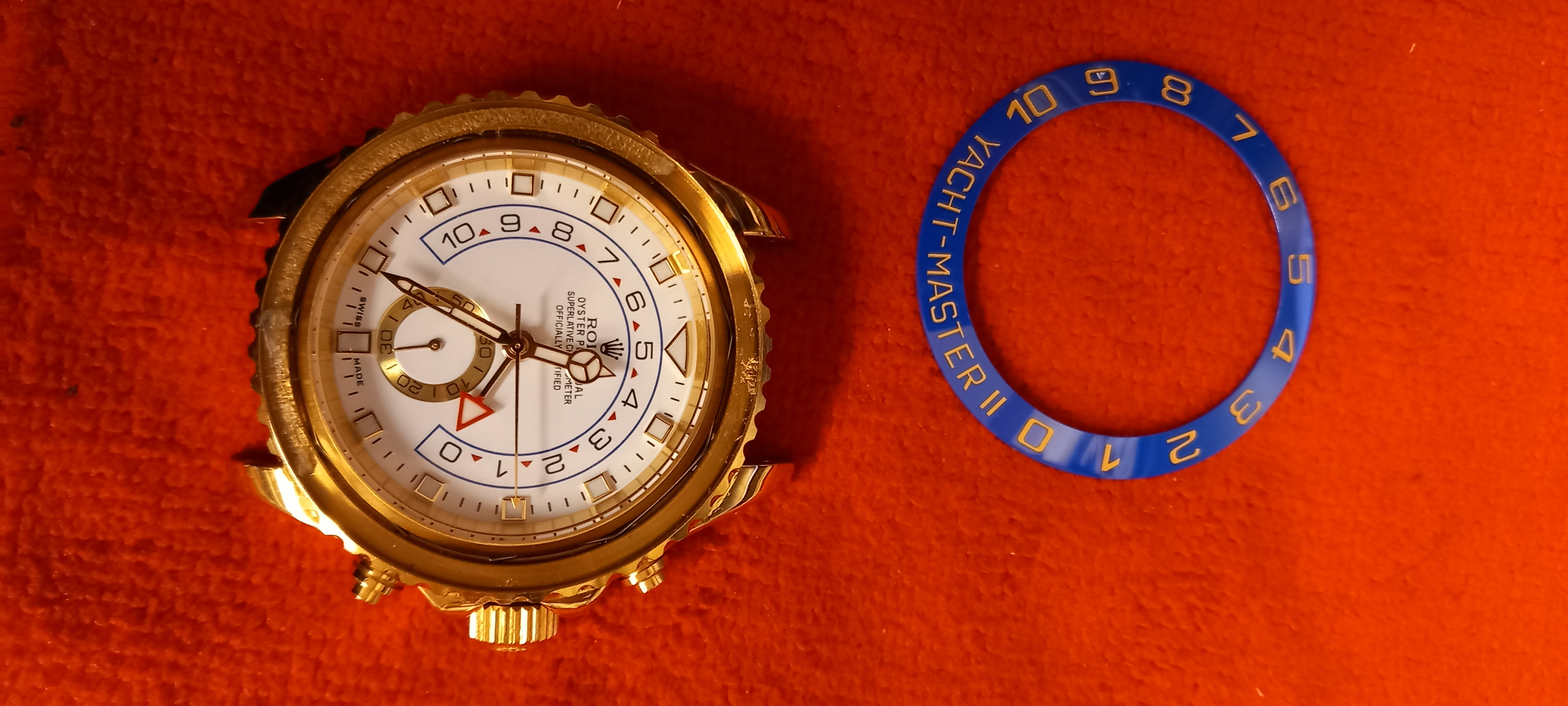

Thanks guys and apologies for not getting back earlier, I started the watch literally as I was posting, because I'd had a reasonable day at the buildings work, (currently the Carport / Workshop extension), and at around 3 pm it started to pissistently rain, so I dragged the power tools in, and as Mel had a friend round, I decided to grab the 'Goldmaster' and get to it.
I did the whole job inside half hour, then of course the rain stopped, so I cracked on with the building work.
After that, Hot Tub Beer and Dinner, and now I am doing the update ...............
Thanks for your concern re the blades but since I work with tools most days I'm used to doing my best not to chop bits off myself, even tho it doesn't always pan out that way.
Anyway, suspense over, the watch is fixed, not a single scratch or bit of damage.

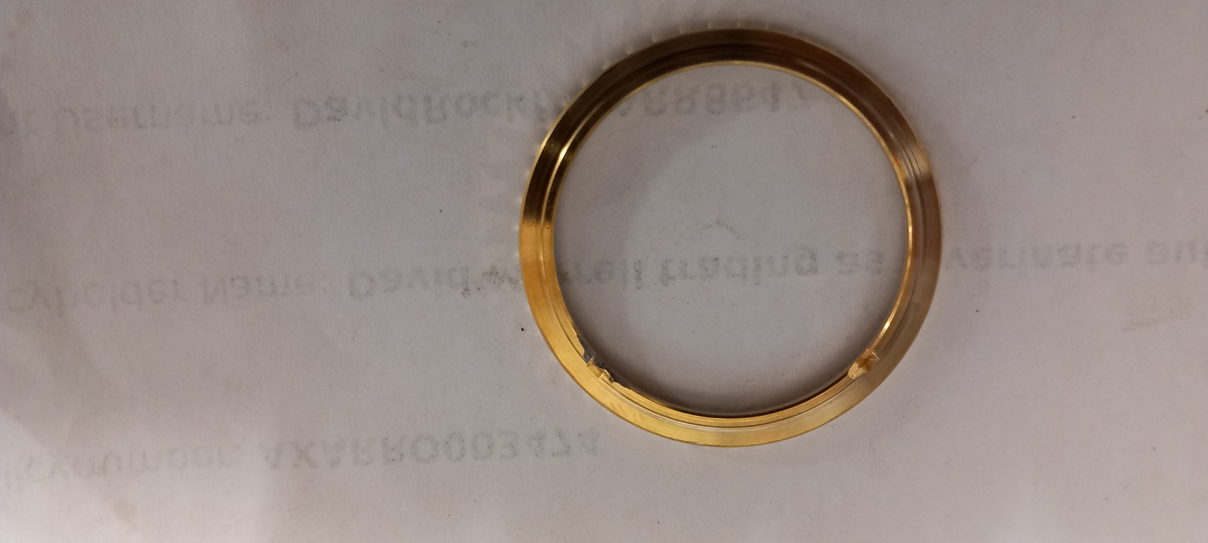

The issue was the Bezel Casting had been machined wrongly, and so the spring loaded pin would lock it after about 1/3rd turn either direction. This of course meant that the Yachtmaster II text could not be positioned at the bottom at point zero of the 1 - 10 Regatta Hours.
A new correctly machined Bezel is the answer, but since I haven't found one, and since I am an Engineer, I came up with a novel solution that I am happy with especially bearing in mind this is not a perfect 1:1 replica by any means :ROFLMAO:
Basically, I used a dremel to machine a "double slope"on one of the 2 Pin locks on the Bezel that were badly machined, and left the other one as was.
This now means that when turning the bezel clockwise I can just rotate away all day, align the bezel wherever I want it, but when I turn it anti clockwise it will turn all the way until it reaches the lock pin, so lets say it starts just off the pin, it will go 359 degrees and then lock.

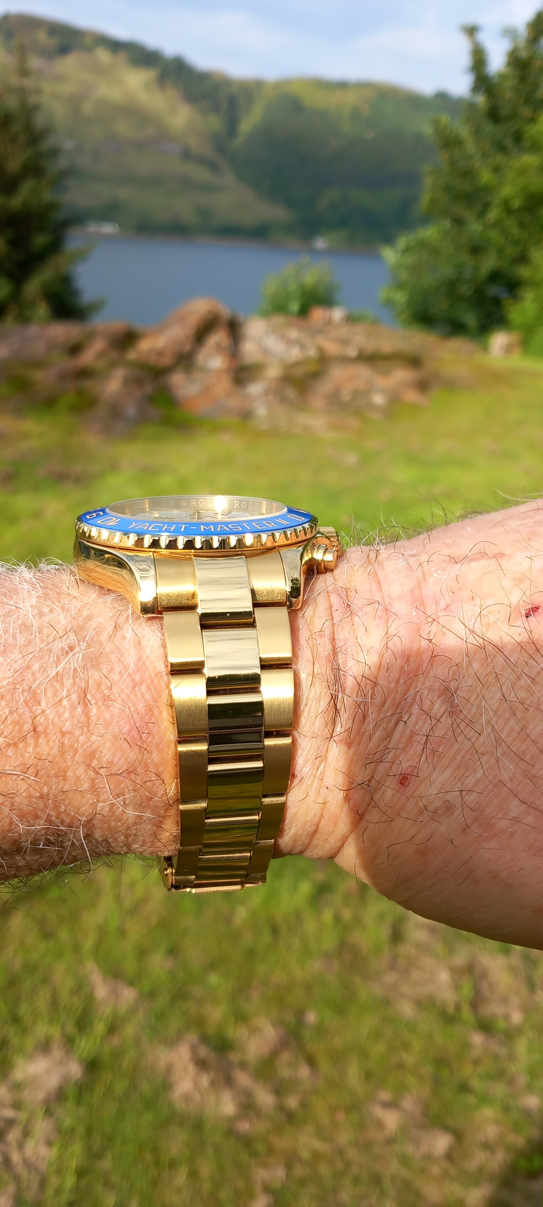

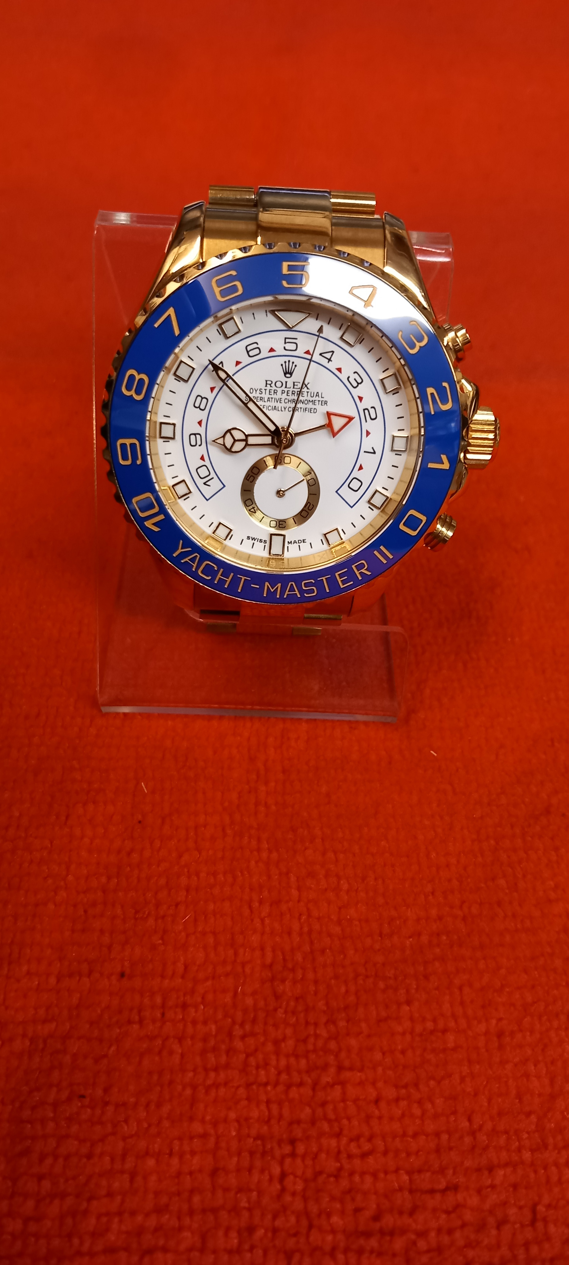

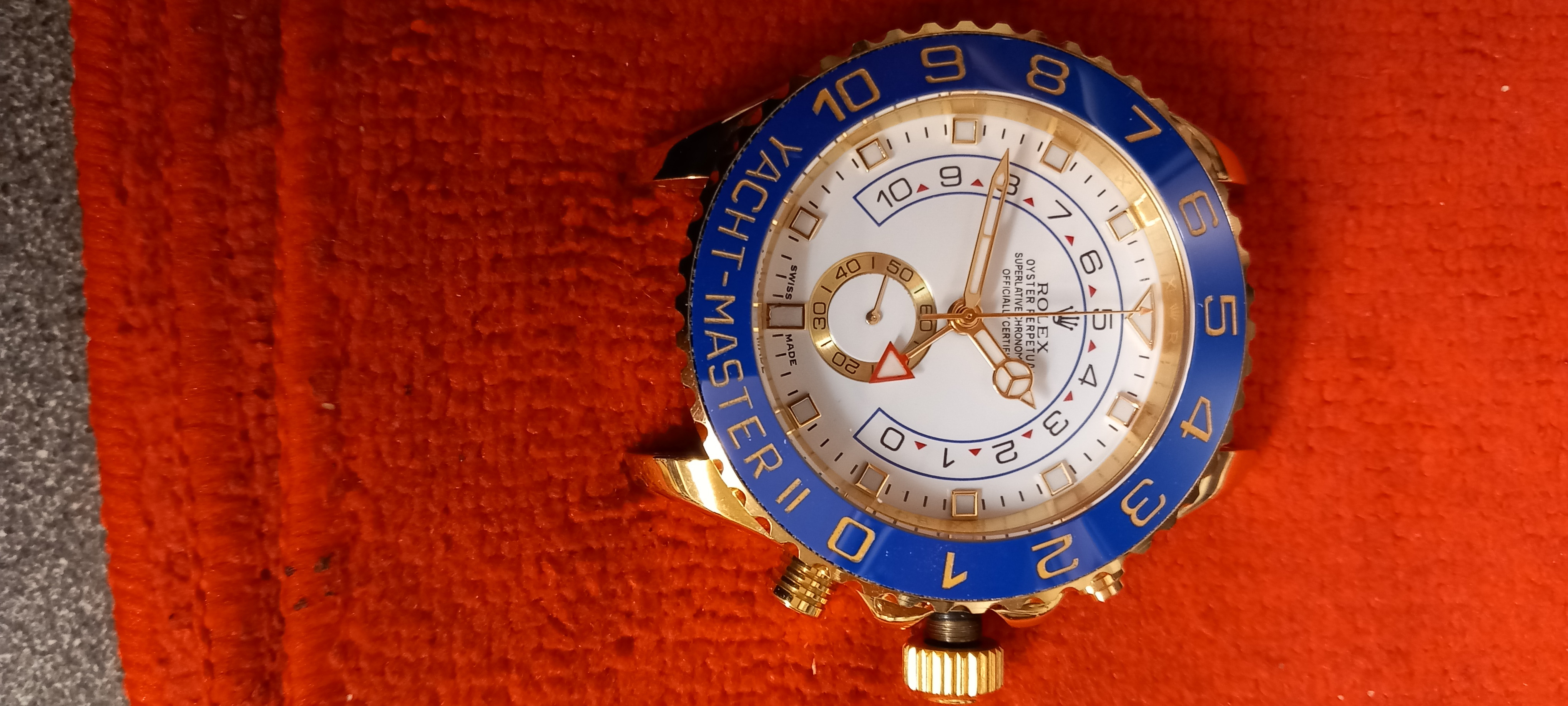

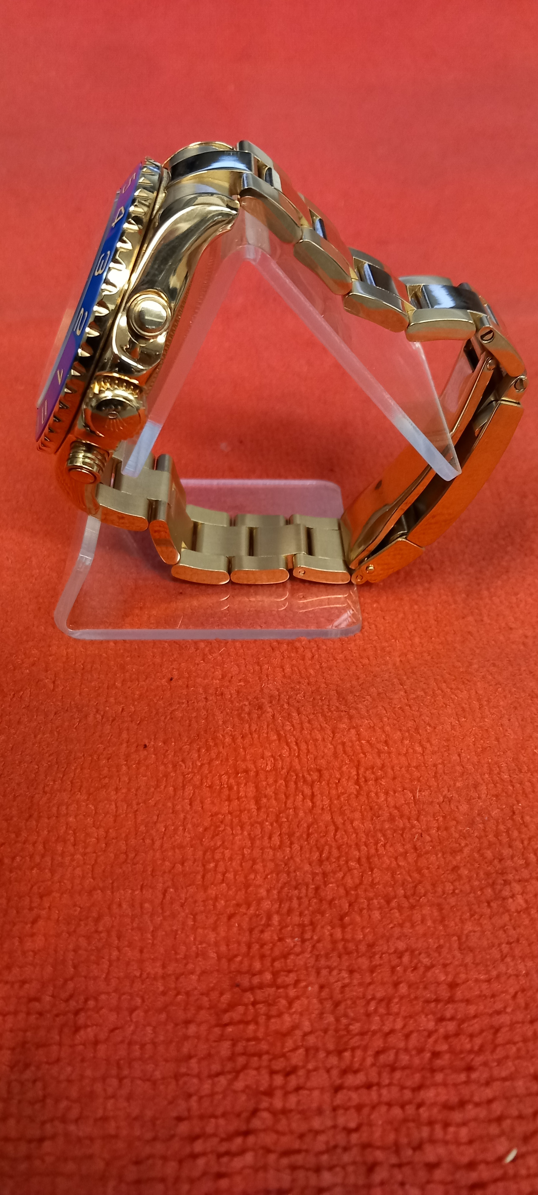

This is exactly where I have refitted the Bezel Insert so the "Yachtmaster II" text stops right where it should on the bottom of the dial area, and Regatta hour 5 is bang in line @ 12 marker.
So yeah the watch is now perfectly useable, and I will be happy to wear it wherever / whenever :)
Piccies below .........................
