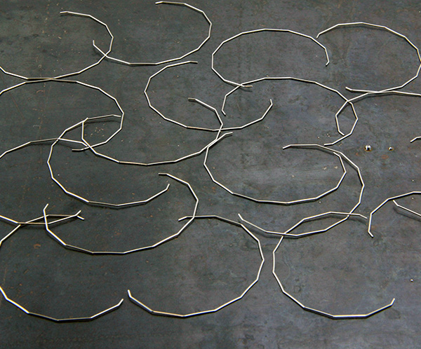

I have a feeling that this is one of those bezels with a bezel wire that keeps it in place which are very annoying. But, it's the affordable way to get them on and hold. I call it the Sturmanskie method.
I would recommend one of these that exert equal pressure on the bezel to get it off.
Do not follow the picture on how to use it on Amazon. The watch would be on top of the tool, dial down.
You should then be able to just pop it back on by hand.

The wire circlip may be too tight to remove with the bezel tool, you may have to remove the insert and pull the circlip out from the top.

Chances are it’s held by an adhesive ring. Warm it up with a hair dryer (not a heat-gun) to soften the adhesive and then try to pry it out or if you have some strong tape, like gorilla tape , you can put it on the insert and try pulling it out.

I have used a needle to help pry out the insert with minimal or no damage from the xtal side, after all of the heating and solvent treatments.
Once you get that puppy out you can see whats wrong in there easily. And then you can re-assemble it to perfect functioning order. Last step is to throw in the trash can since it's a YM2, then you're all done, good luck!
P.s. double sided thick 3m tape stuck to the top of insert will help lift it to a tool under it.
