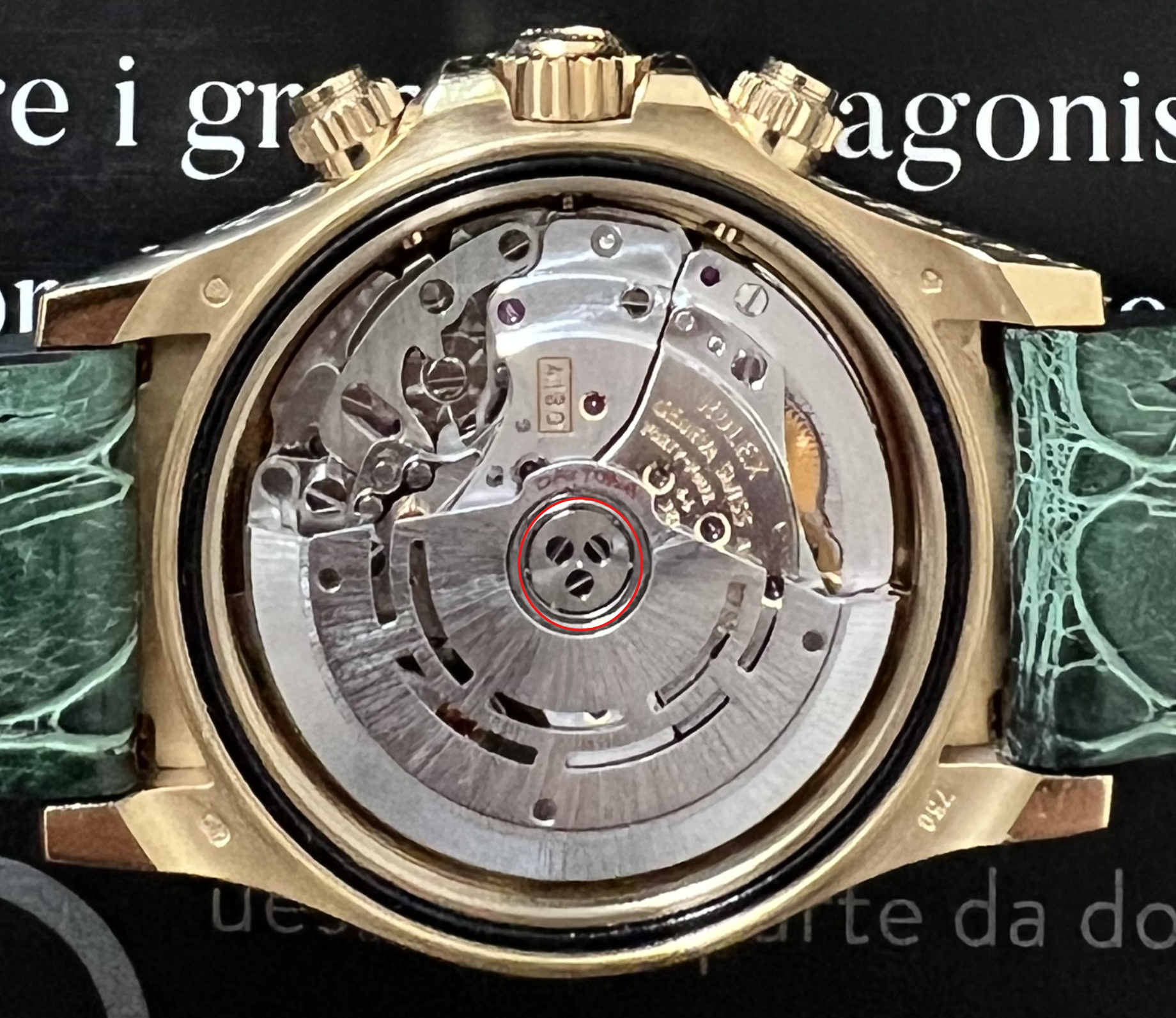

Be sure to add 1/2 drop at max because if you drop too much oil it will block the parts right under the rotor

Sorry, I don't understand. Where did you put the oil? Where I drew the circle in the picture? Could you draw it for me on the picture? I'm afraid of ruining it.
