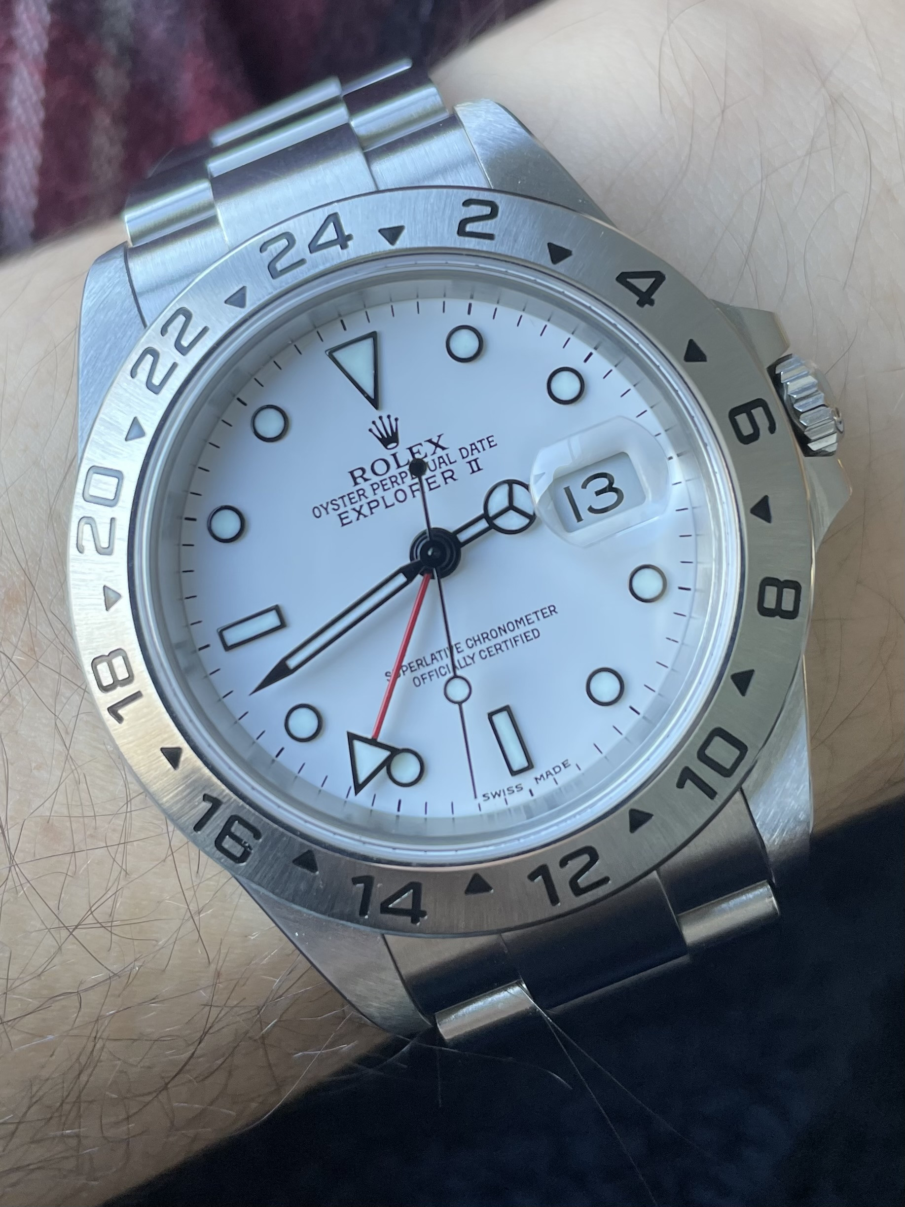

I’ll get back with pics when she’s all done!
Pre-op shot:
A rarity in NOS condition - hence my extreme OCD 😂
Thanks again mate ~
