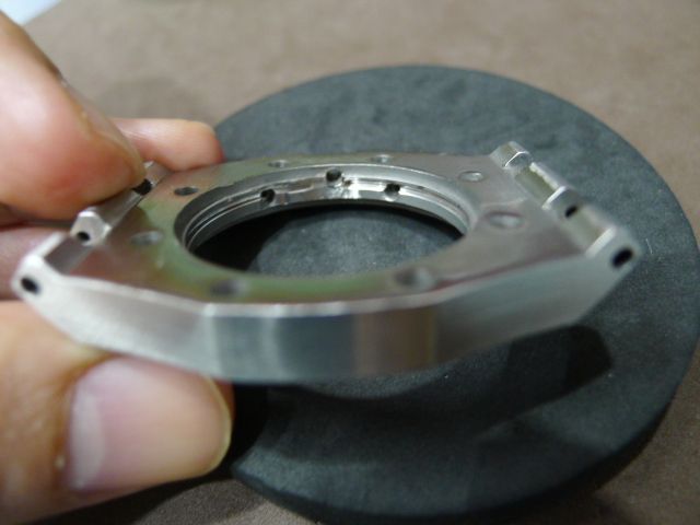

dun see any thinning of the case or caseback. it just look quite standard to me .. the engravements for the rubber rings are still there. may i know which part is actually thinned ?
i have did the thinning of the case and caseback. it doesnt look like this. The back of the "sandblasted" finishing is all gone in fact..
Please advise.
Pratt
24/4/13
4,116
132

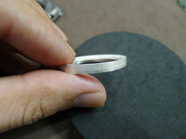

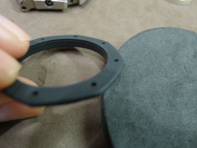

updates for the case , caseback , rubber , tachy thinning.
How do u get the sandblast effect on the back of the case later on ??

Nope...it's been thinned. The engravings were milled back in after the case was thinned out.
Use walnut-shells to media blast the case to get the texture back.
