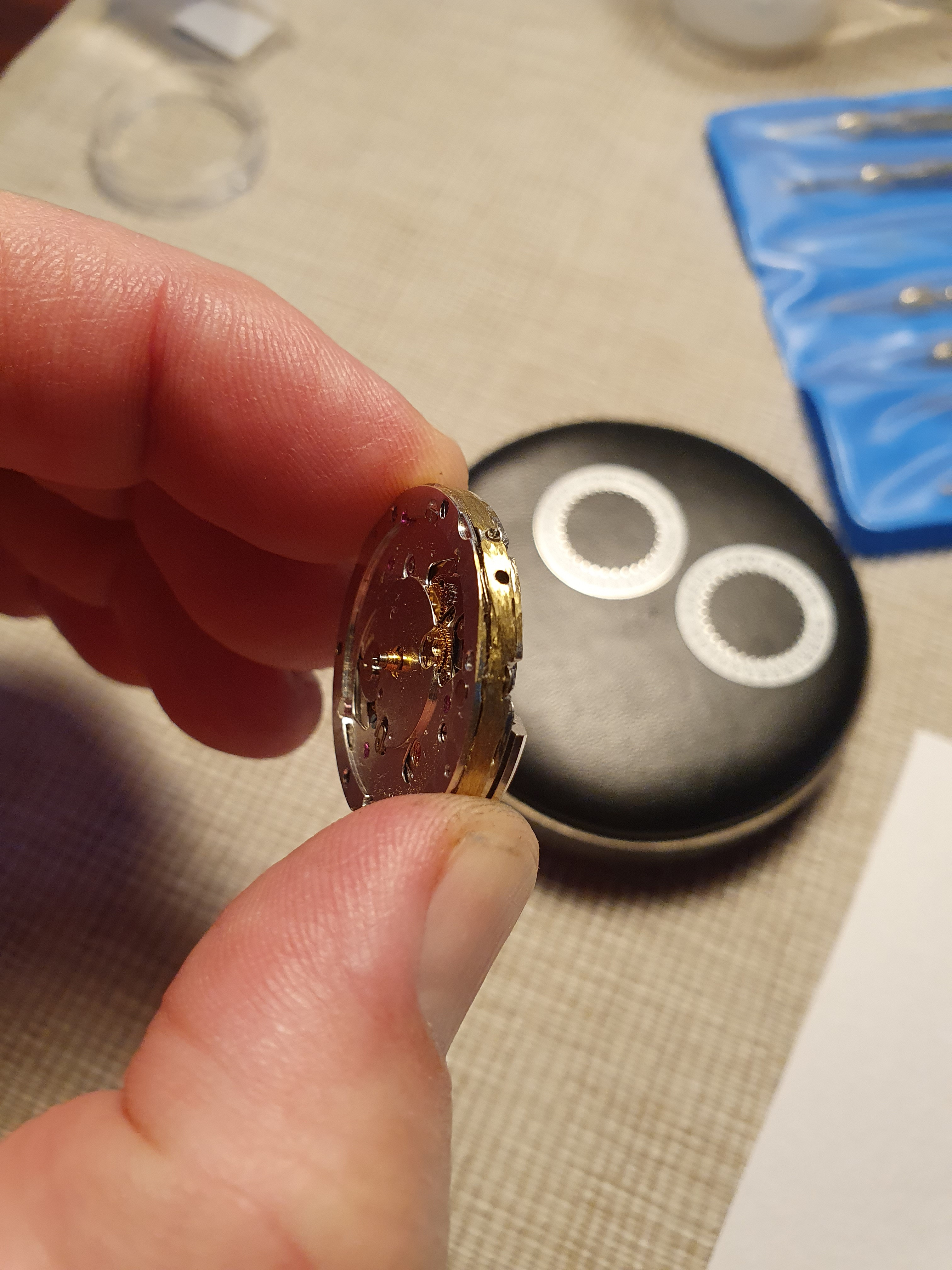

Here comes the story about putting everything together. The Rolex 16030 case was delivered with a 3035 movement. The fact that a lot of people remove the movement from the Datejust and use it as replacement in more popular watches, the Datejust parts are affordable. I decided to buy a VS 3135 movement because I had some good experience. It is reliable and most similar to the original 3135. But what I did not know, it is not identical in size to a 3035 movement. To fit it into the case, I have to reduce the diameter of the movement or increase the diameter of the case. Working on an original case is beyond my limits. So, I decided to work on the movement and dremel it. It was a painful process and the first time that I realized that the movement is built from bras.

Yes, it's still running. Just like it was initially. The rate values are good. My biggest concern was that I would spread fine grinding dust in the movement and the movement would have poor rate values in the medium future. But it seems to have gone well.

Which part of the movement did you dremel? I heard Someone somewhere sanding down the date plate down.
I am having a similar issue with a VS3135 in a 15000 case meant for the 3035. The clamp screws will not fit under the lip of the gen case.

i am currently thinking about installing a 3135 in my 16800 which also features a case for 3035. Maybe i will give it a try.
As far as i see its "only" the date plate which needs shaving? So you could remove it from the movement to make the handling a bit easier.

Well, it is now over 2 years ago. I don't remamber exactly where i removed material. It was just at the outer diameter. Here I Put another image I've found.
If you already started reducing the diameter at the movement. Add a dial at the movement, but it into the case and check if the dial touch the case. If not, you have to remove more material.

Yes, that would make everything much easier. I did not had the bolls to do it.

I’m right there. I dremeled the date disk plate down to the dial size, thinking that would be enough. Nope. Still can’t get the case screws under the lip. Now I’ll have to dremel more of the movement. Fingers crossed I dont get any metal shavings into the gear train or balance.
