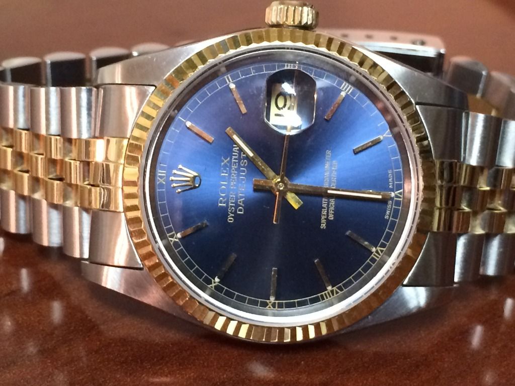

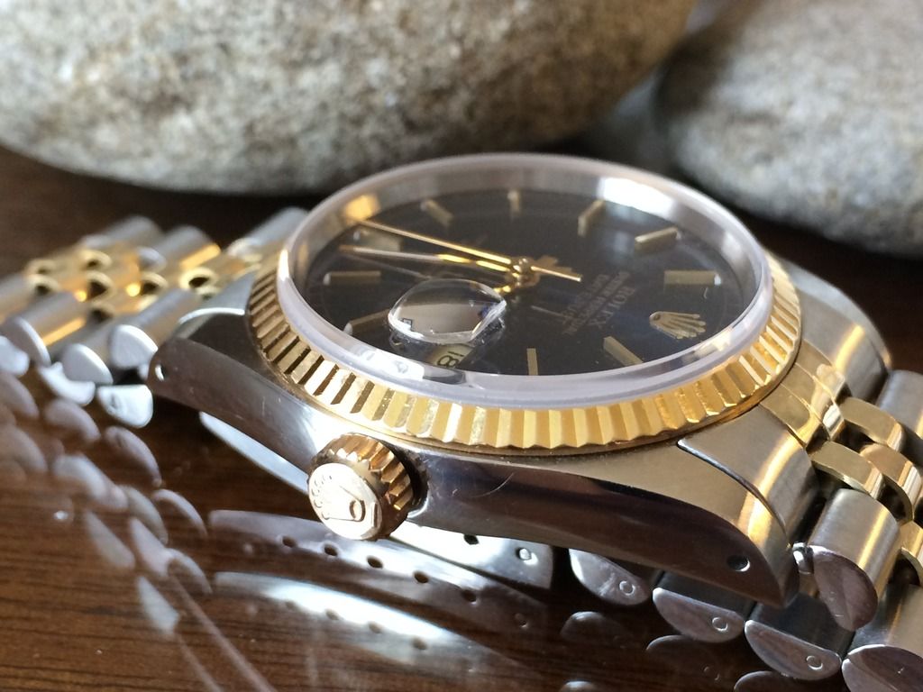

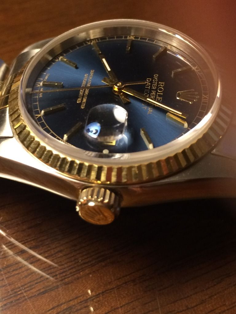

I built this 16200 DJ just this year, and I can tell you that it takes some doing. It is a JMB case, MyManMatt bracelet, hands, DWO, dial from eBay, crystal from Clark on eBay. Bezel is gen from eBay. Crown and tube are gen from eBay. Movement is a Swiss-made ETA 2824-2. Had to drill and retap the case for the gen tube. I think I have about $900 bucks in it. That's what happens to you. $1000 for a fake watch...go figure!
The advice to buy a junker and play with it is good advice. I have been doing this since 09 and can tell you that I have destroyed about as much stuff as I have completed. Make one slip and you destroy the balance. Blink your eye and bend the sweep second hand. Take your time...you'll get it.
BTW, Matt has a lot of parts both gen and rep. He is a great source and a true gentleman.
