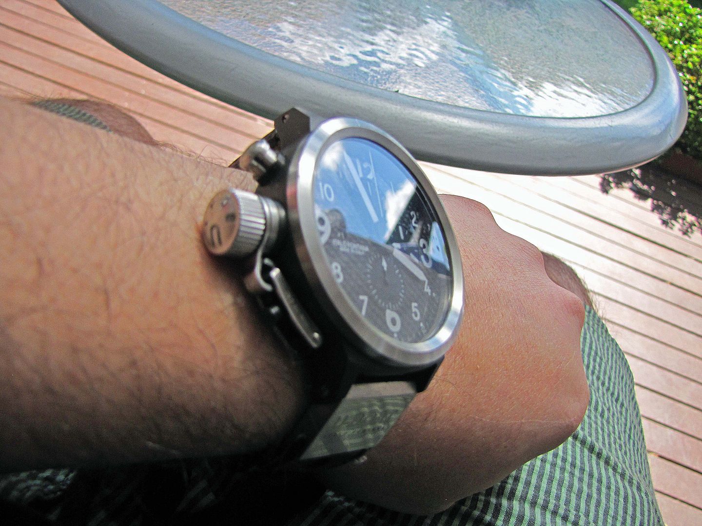

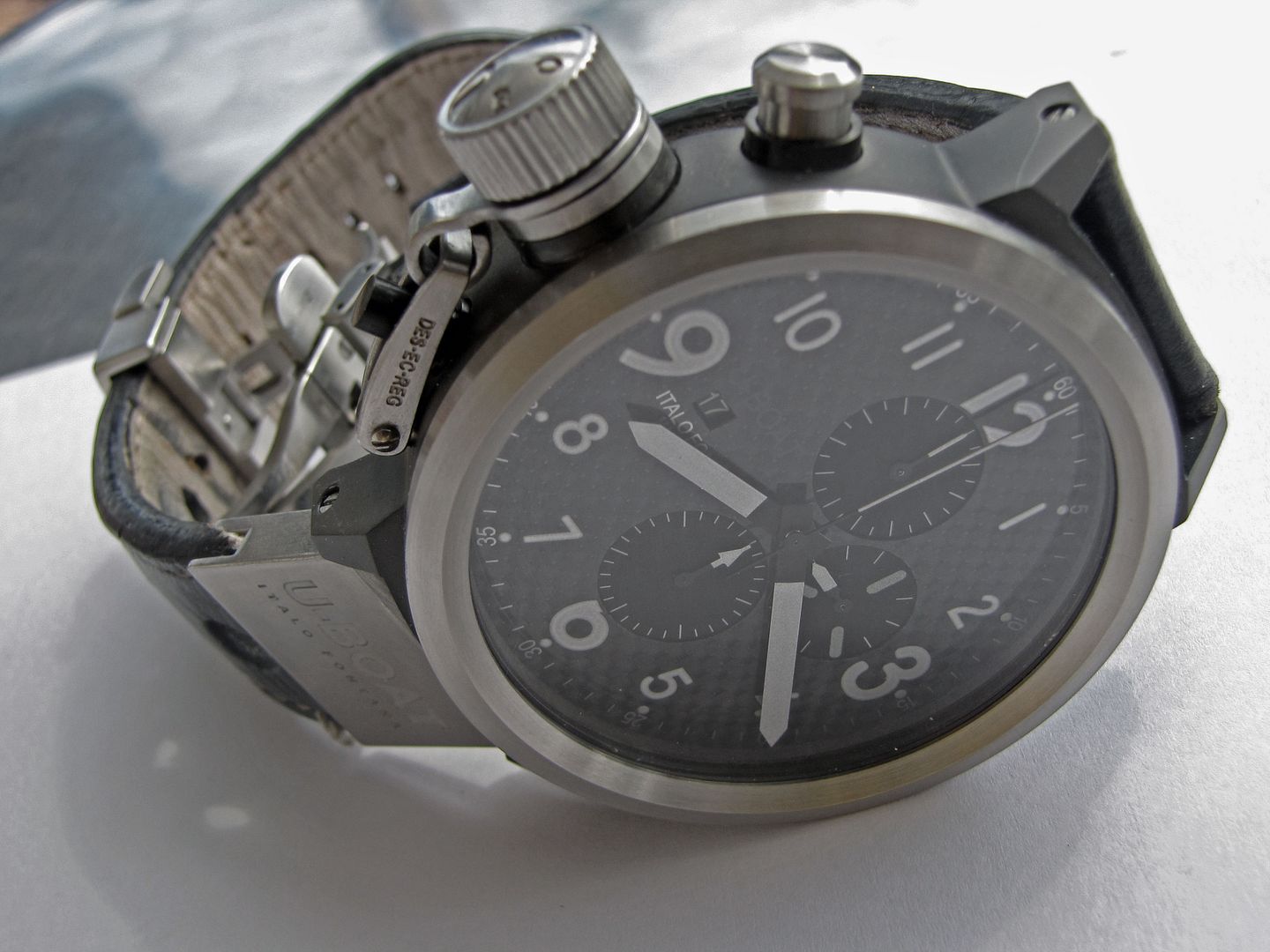

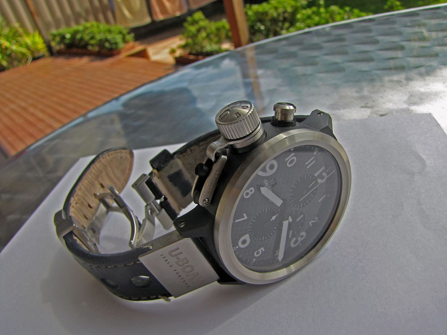

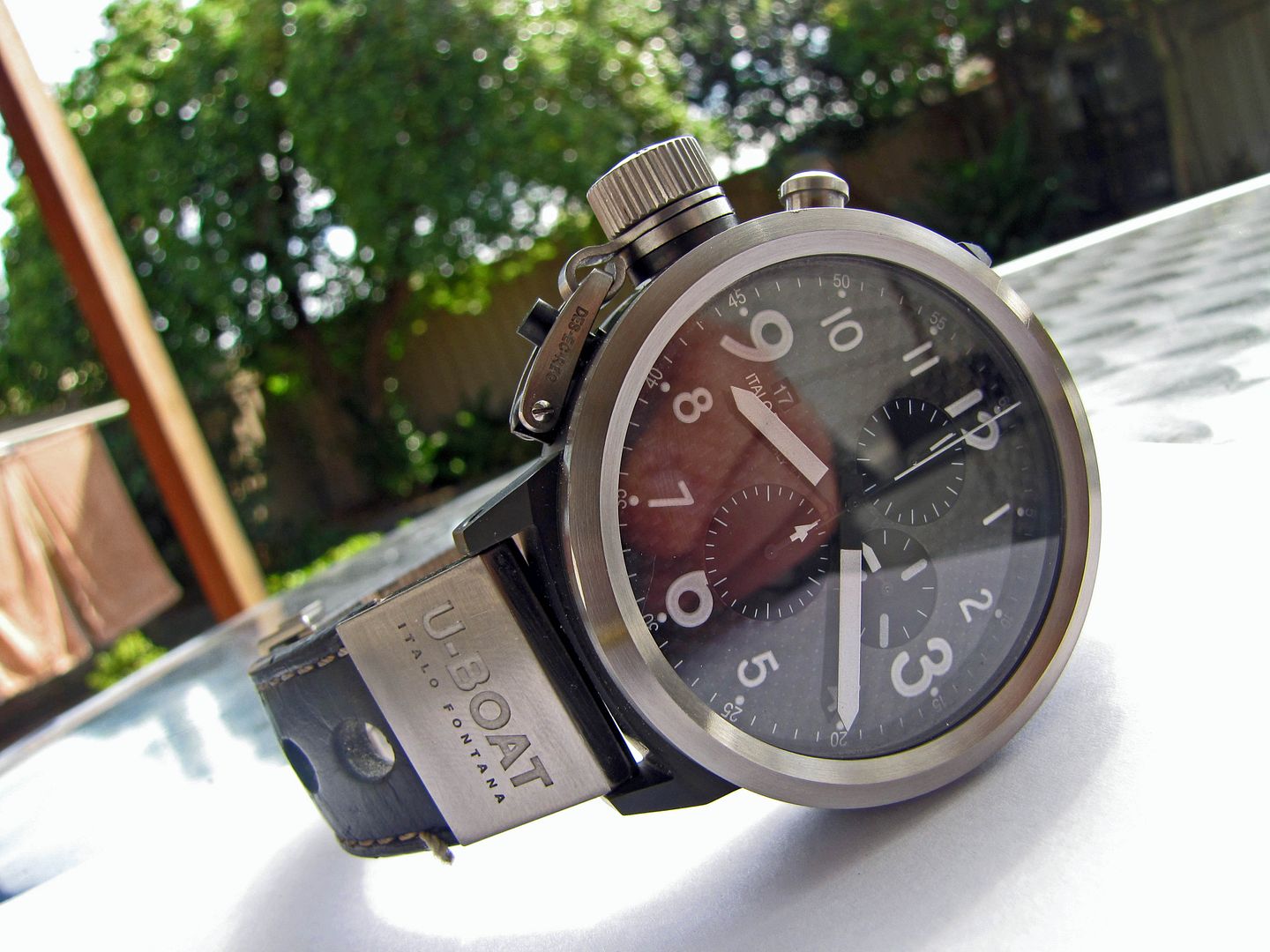

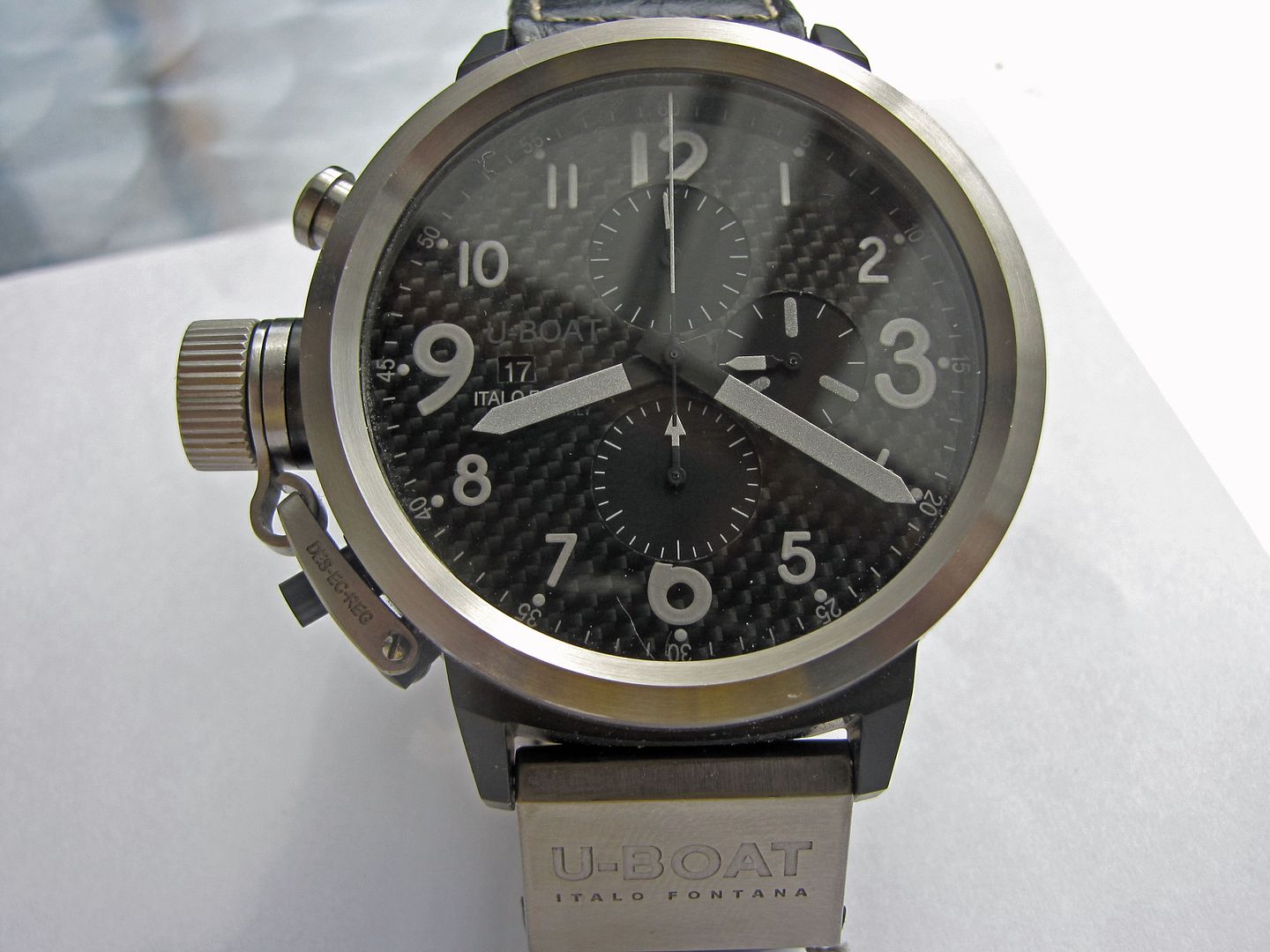

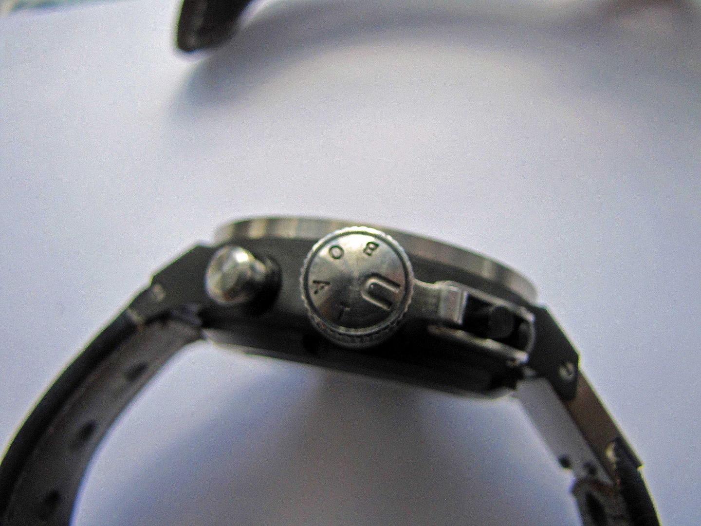

Hey Guys,
I know there is a couple of old threads I posted, but I thought I would create this one with just pics of the end product.(anyone need help with this, or a similar conversion, don't hesitate to PM me)
Originally, I purchased a black pvd flightdeck with carbon fiber dial from Rochest and Mary (Thanks Mirage). I also had the parts in silver to modify this watch into a flightdeck steel bezel 'model' (Check out uboats website and check out the steel bezel model. Its pretty much the exact same as that now. I did however, order a pair of silver chrono buttons as the top button was about ready to snap from trying to take off.

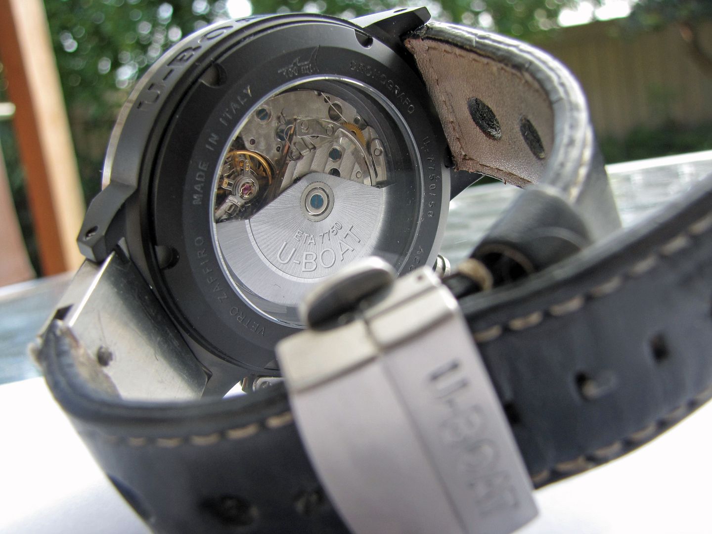

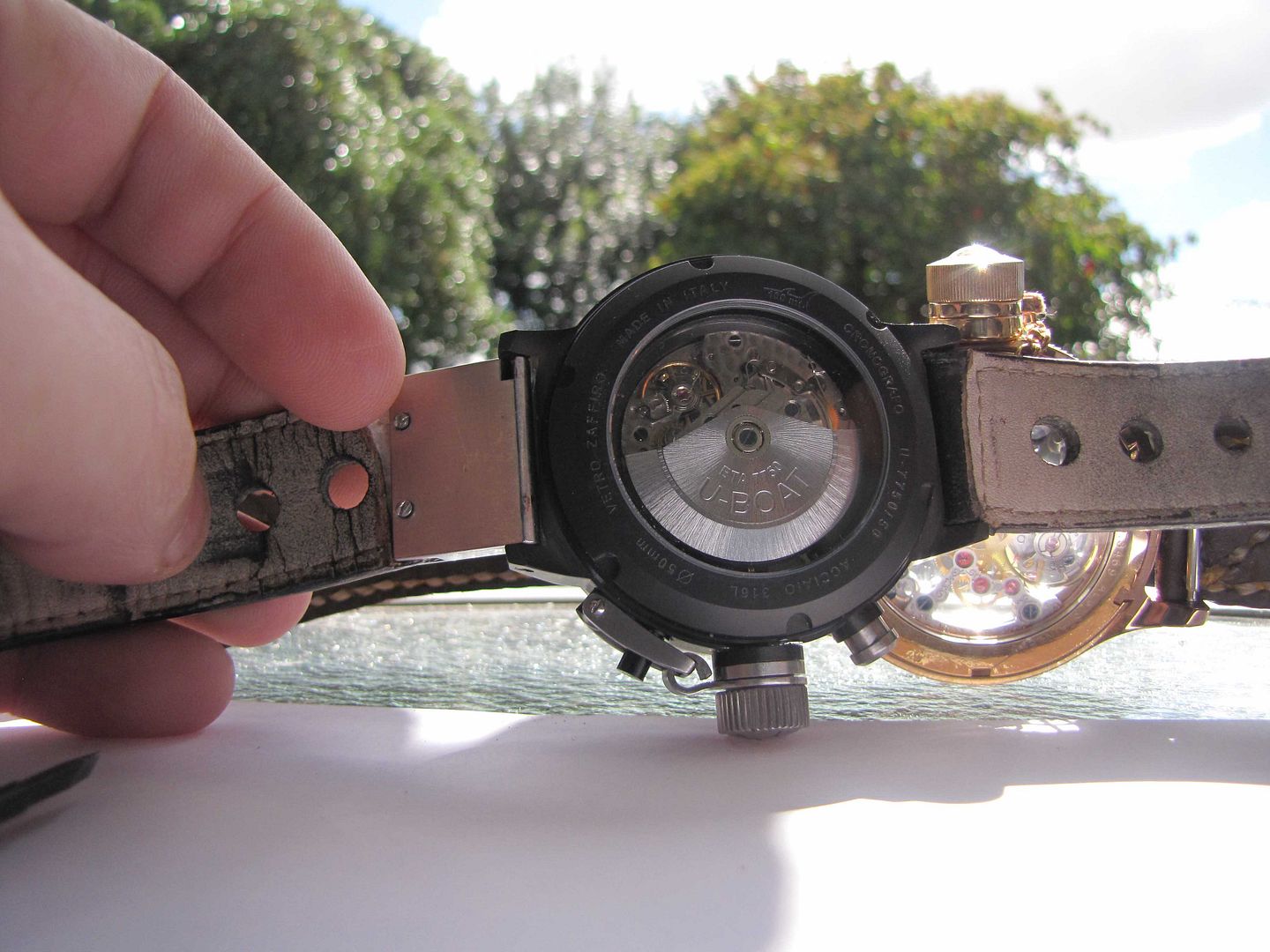

Items converted: Bezel ( of course, requiring the whole watch be disassembled so the old bezel can be knocked out) replaced crown cover with holder to silver, used new SS top chronograph button to use on the top (only item I didnt have but was ordered by Rochest in the end) button was a pain, being the SMALLEST clips to remove and re-add. There are also 3 real difficult screws to put in after the watch is assembled again. These three have little tabs so they catch the thread on the movement cover. Taking off is reasonably easy but putting on again was a pain (tab rotates as you try to screw them again (tiny screws, taken alot of time)

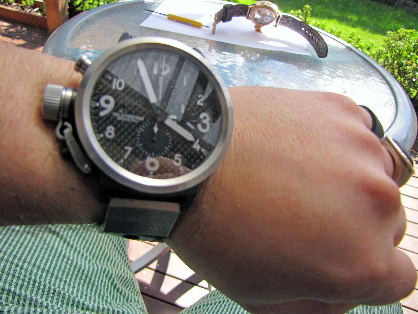

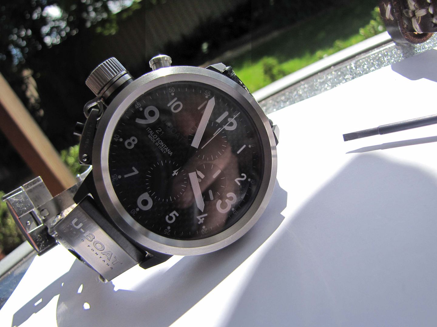

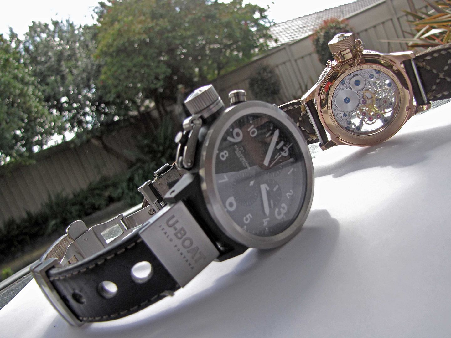

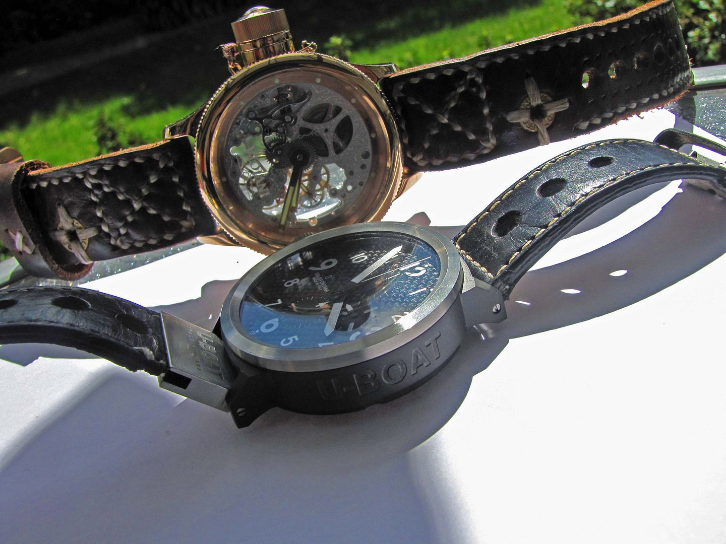

Real happy with the way it turned out. Heres some pics (note: custom carbon fiber with various stitching being made, and I requested silver dial, handset and markers be silver)
