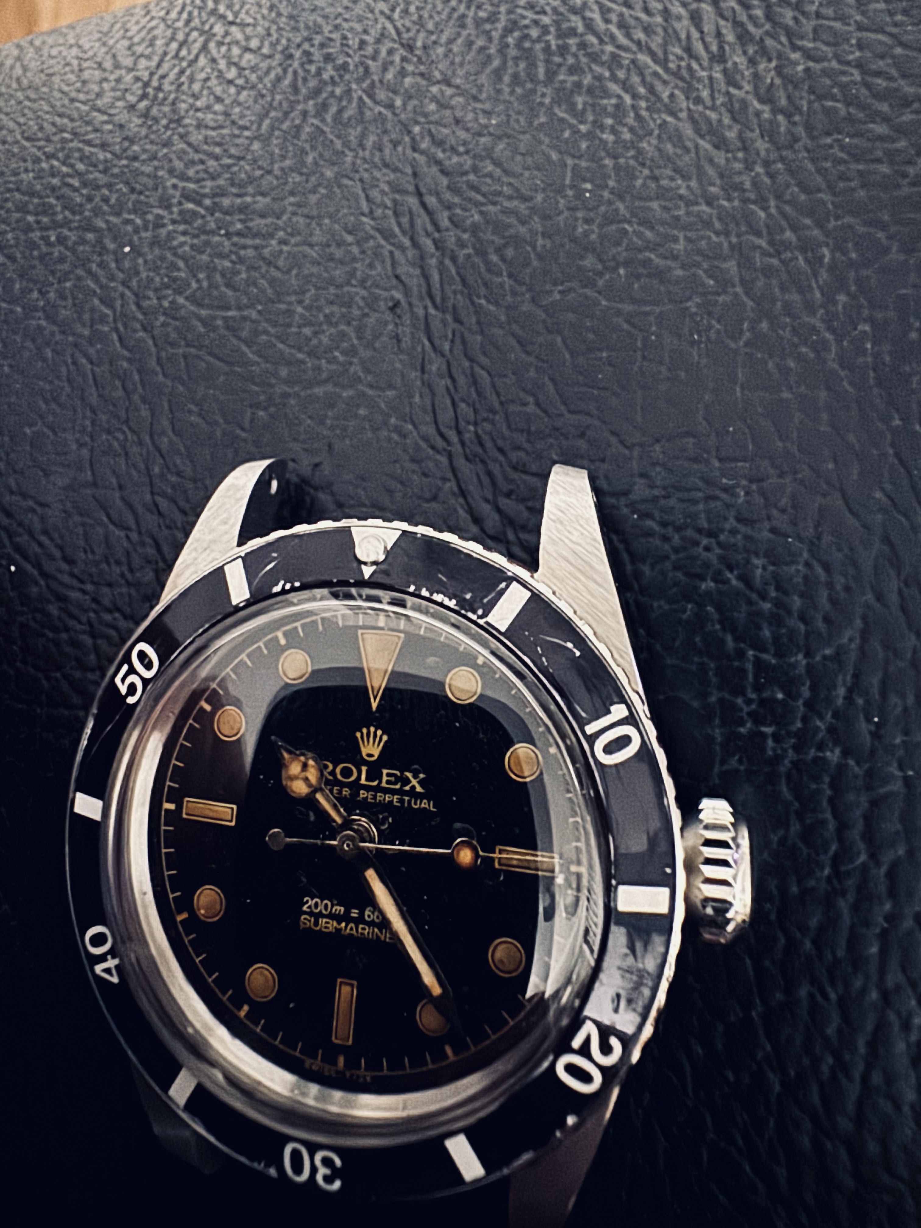

Thanks, good to know. I’m sure I have a spare nh seconds hand lying around, got an nh38 coming over the weekend so hoping that’ll fit the case

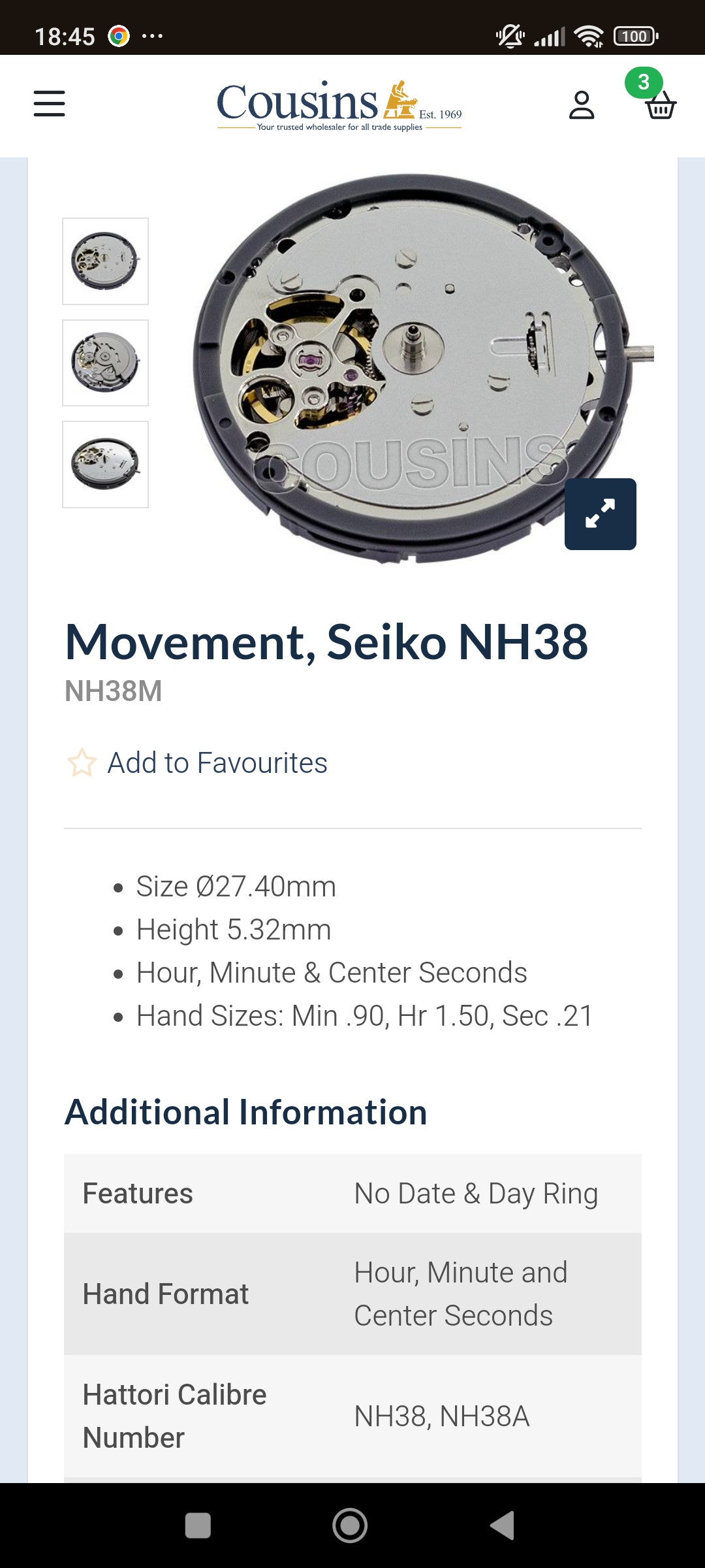

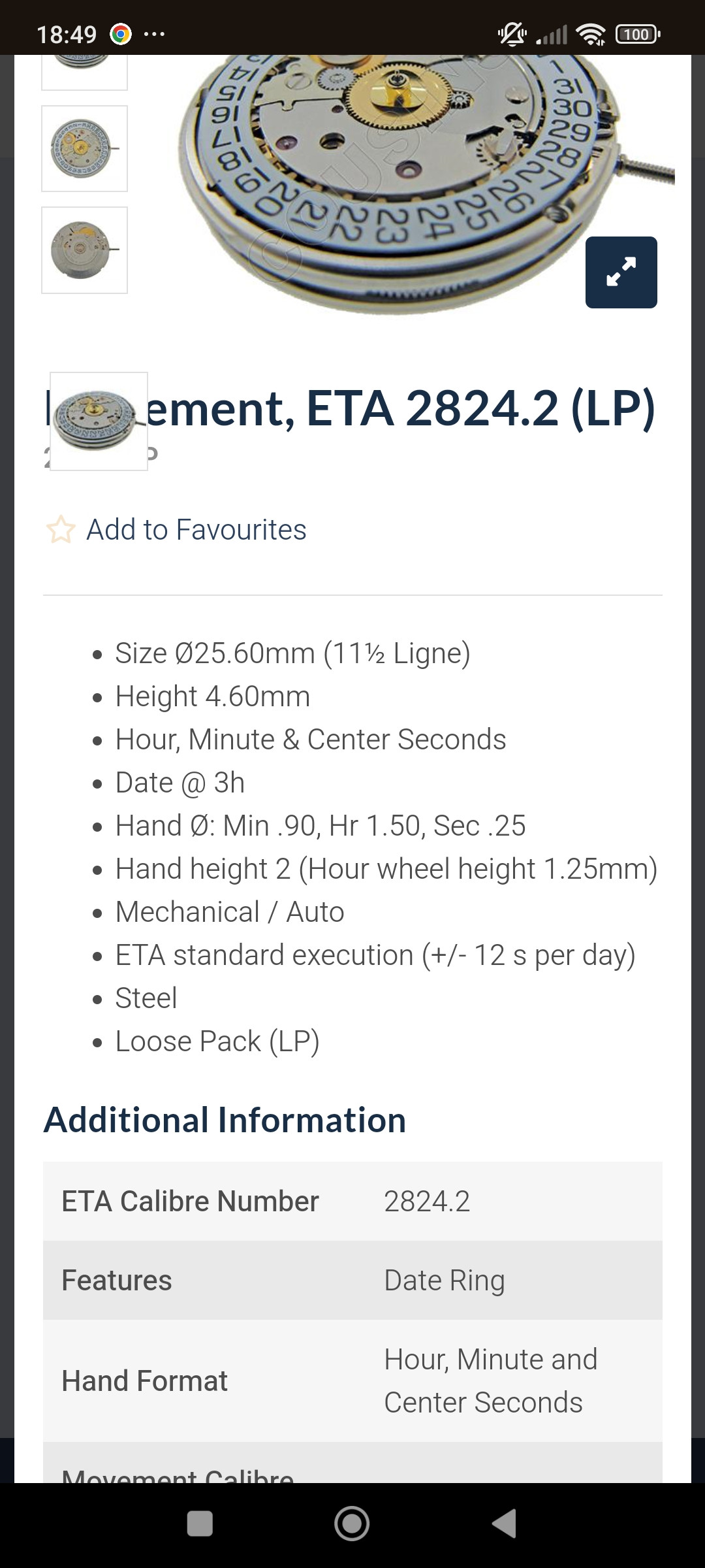

Nh38 1.92
A2824 1.80
It can work. I have seen people put a nh38 in a 2824 raffles case

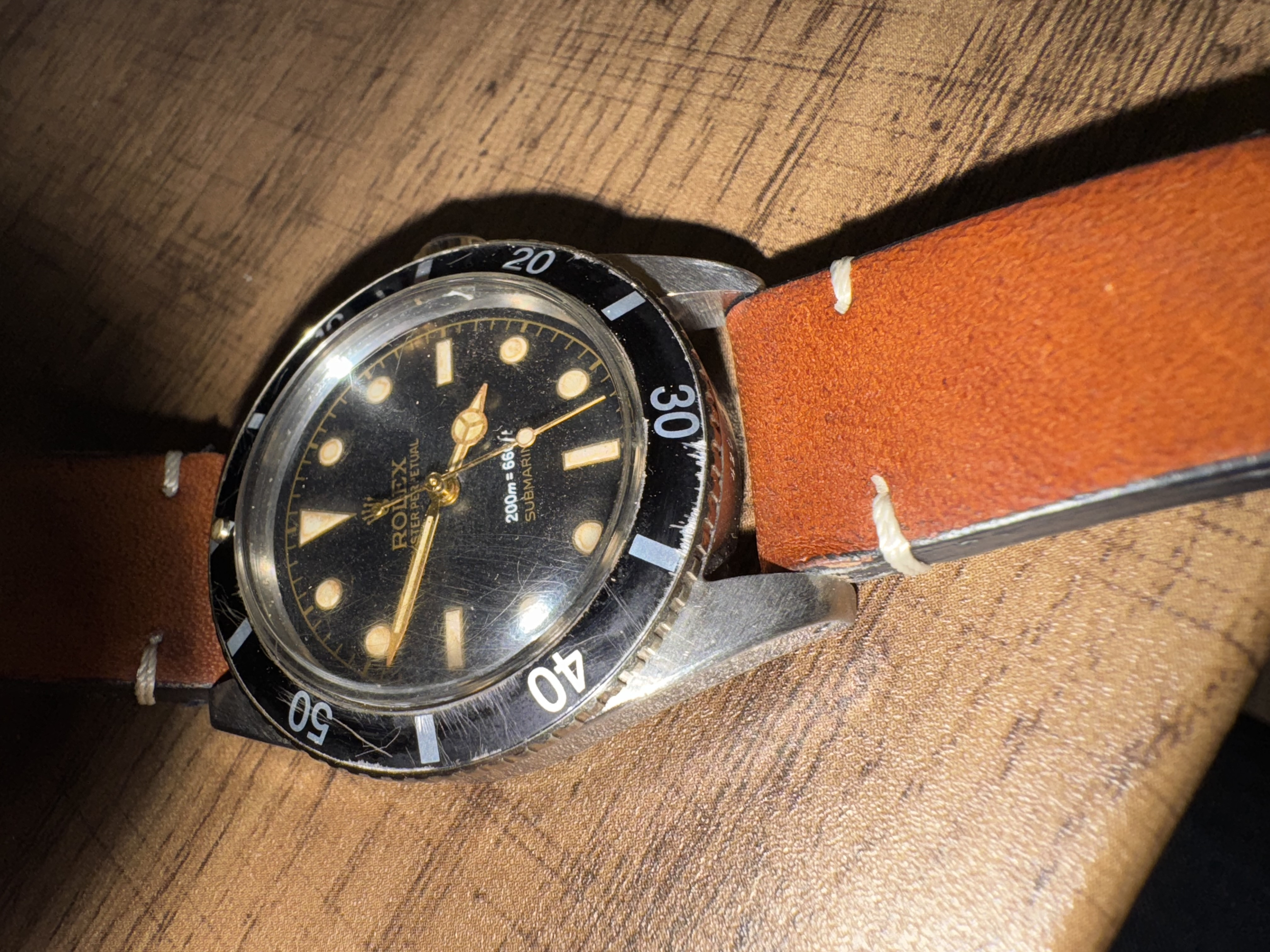

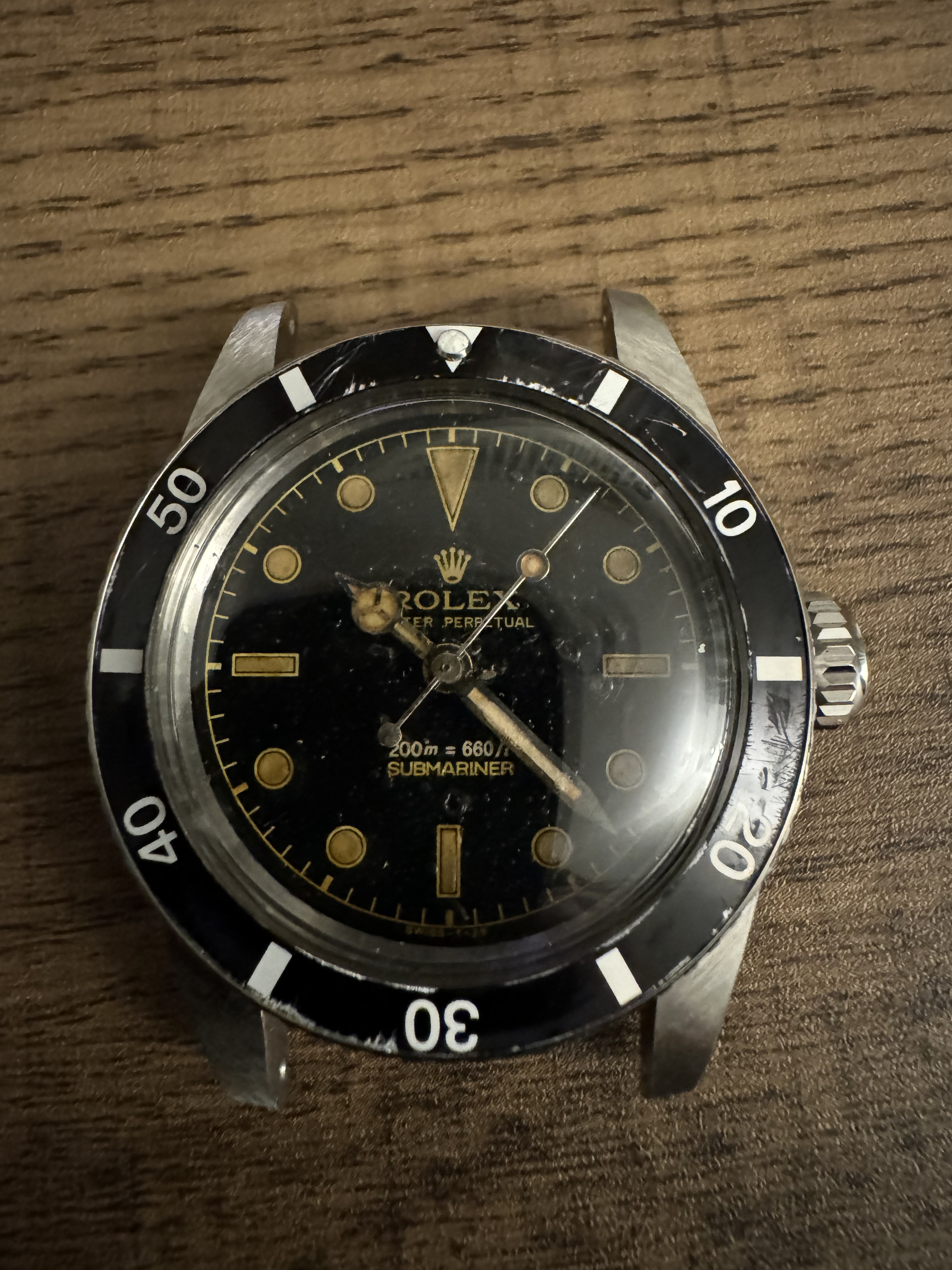

Also the minute hand didn’t fit the nh38, hour hand did. Maybe I was a little heavy handed removing from the 2824. Anyway I raided my baggie full of hands iv been practising luming and aging on. Means the minute hand and second hands are a little brighter, I can live with that, looks like they’ve just been swapped out along the way.
The story so far

@Jip7645 - looking good.
Now if a watch has had that much of a hard life, the brushing on the lugs would be much less obvious by now....I'd add some nice bevels to the lugs, polish them up, not too much and whilst your at it, polish the brushing on the lugs, 70 odd years of manual sleeve polishing would have taken place....

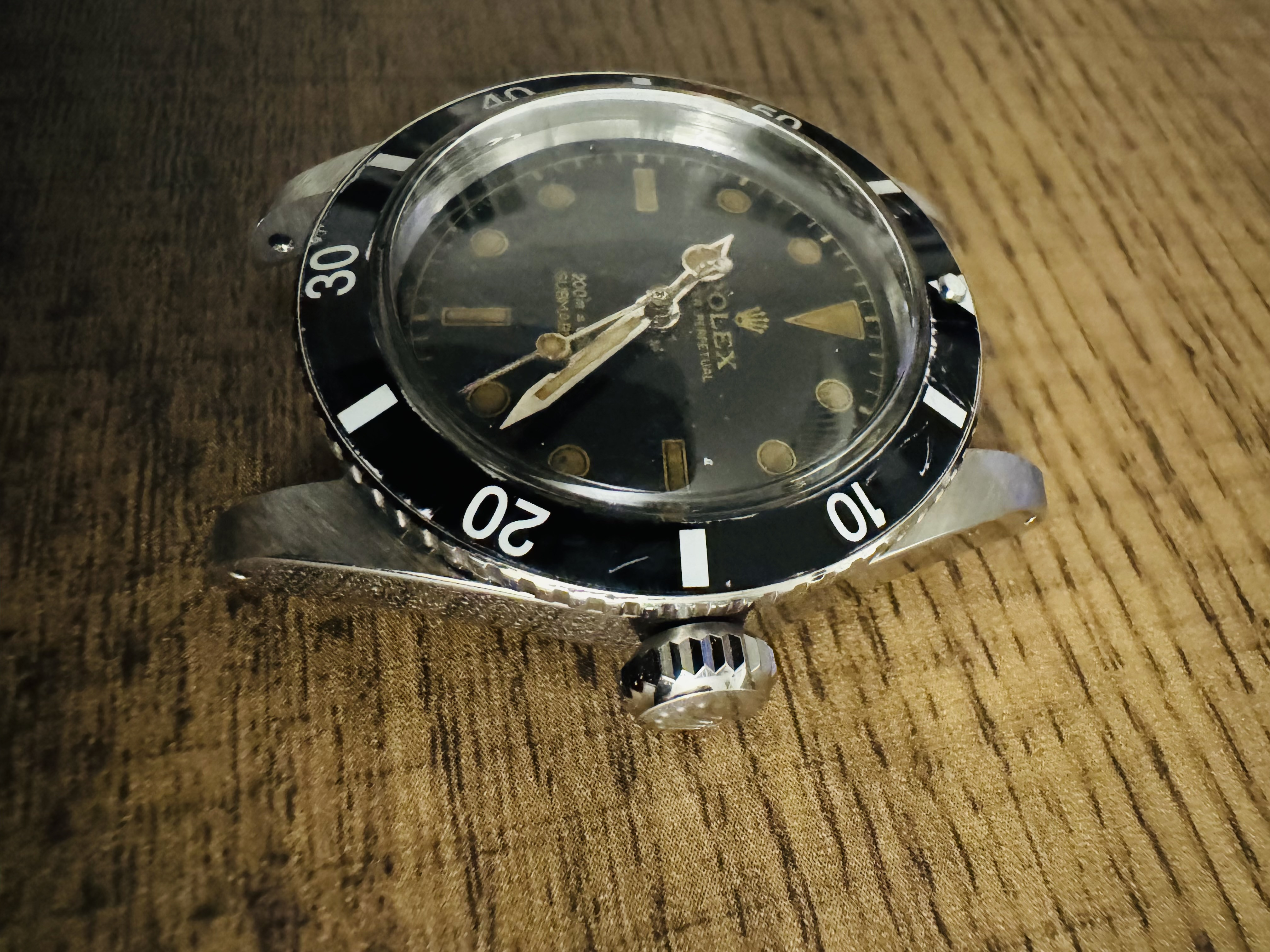

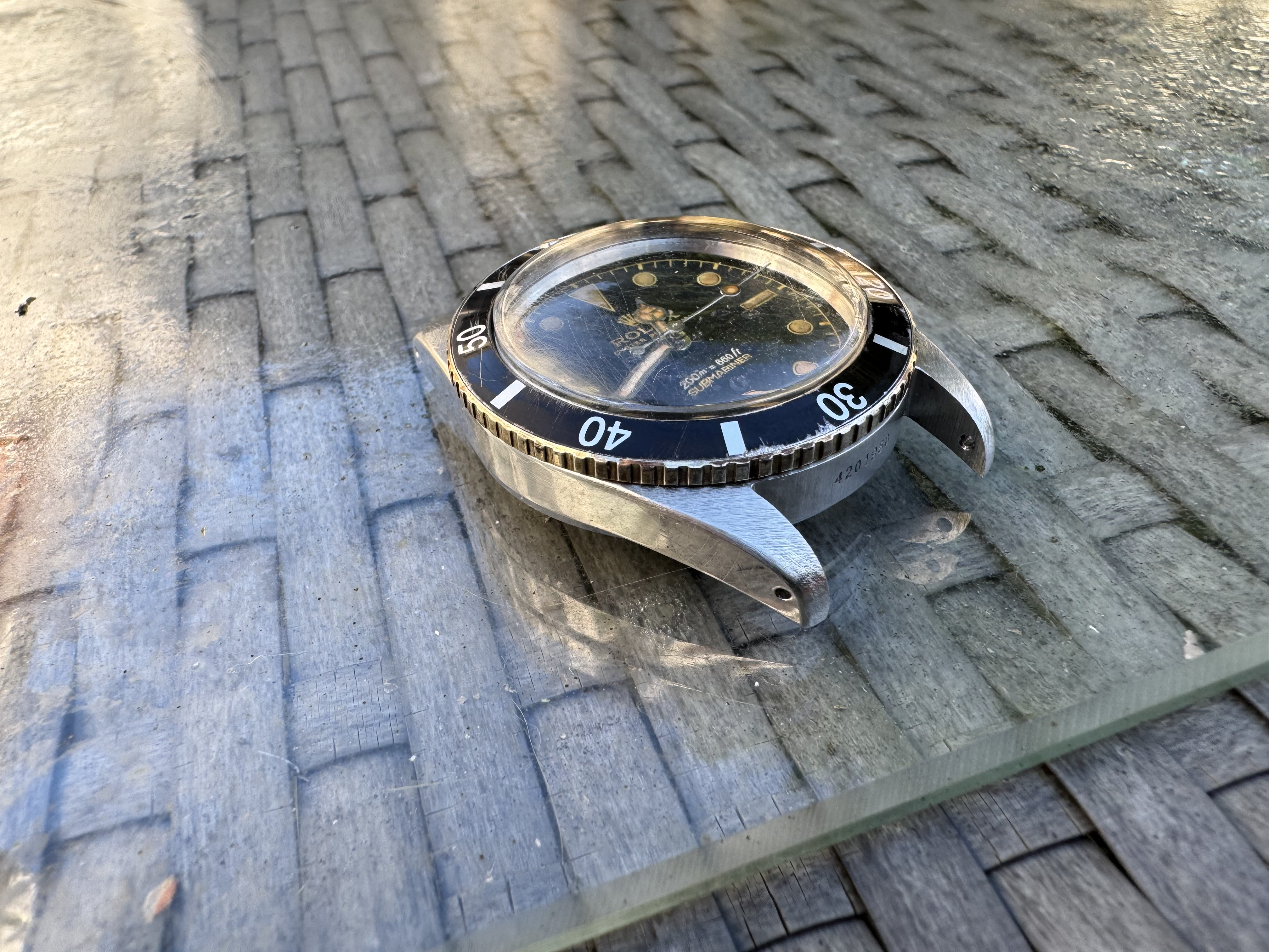

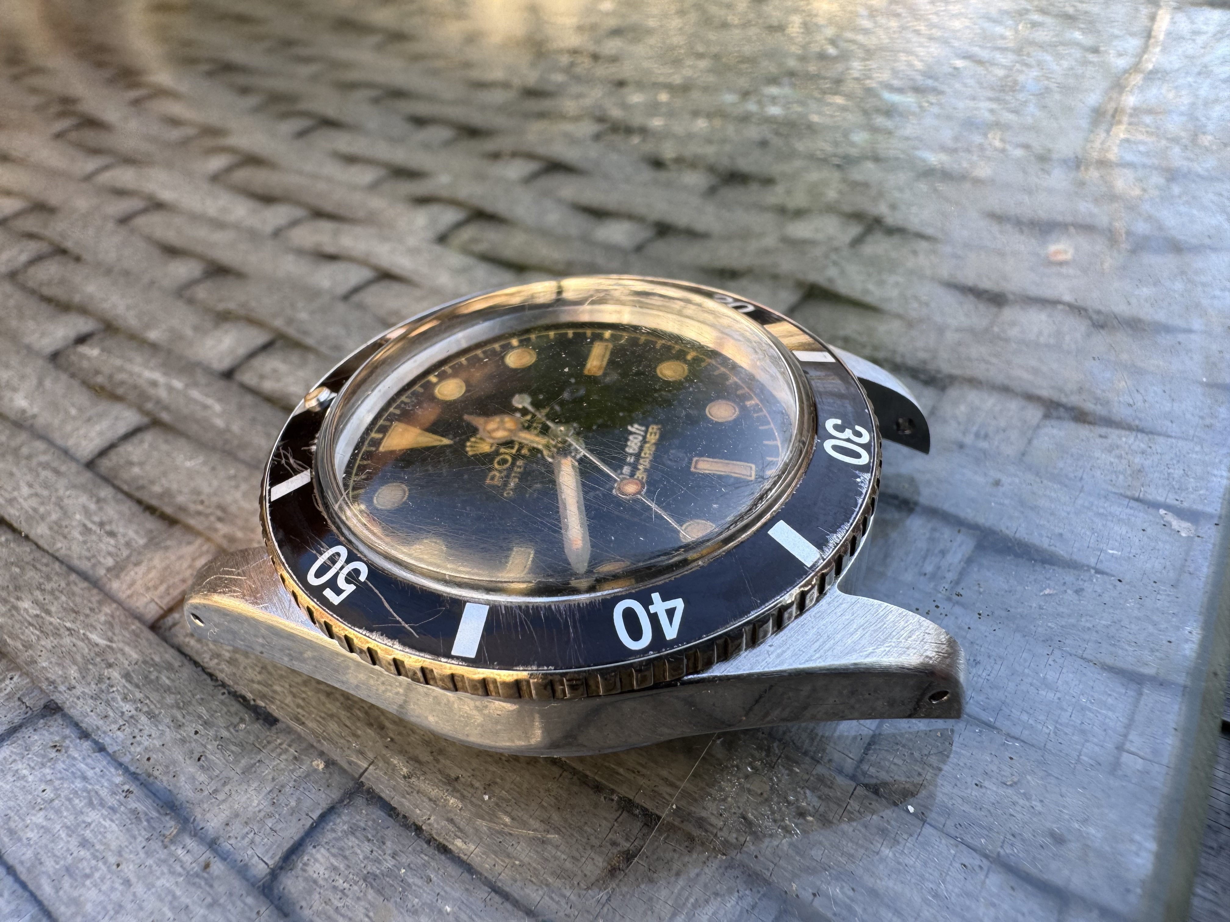

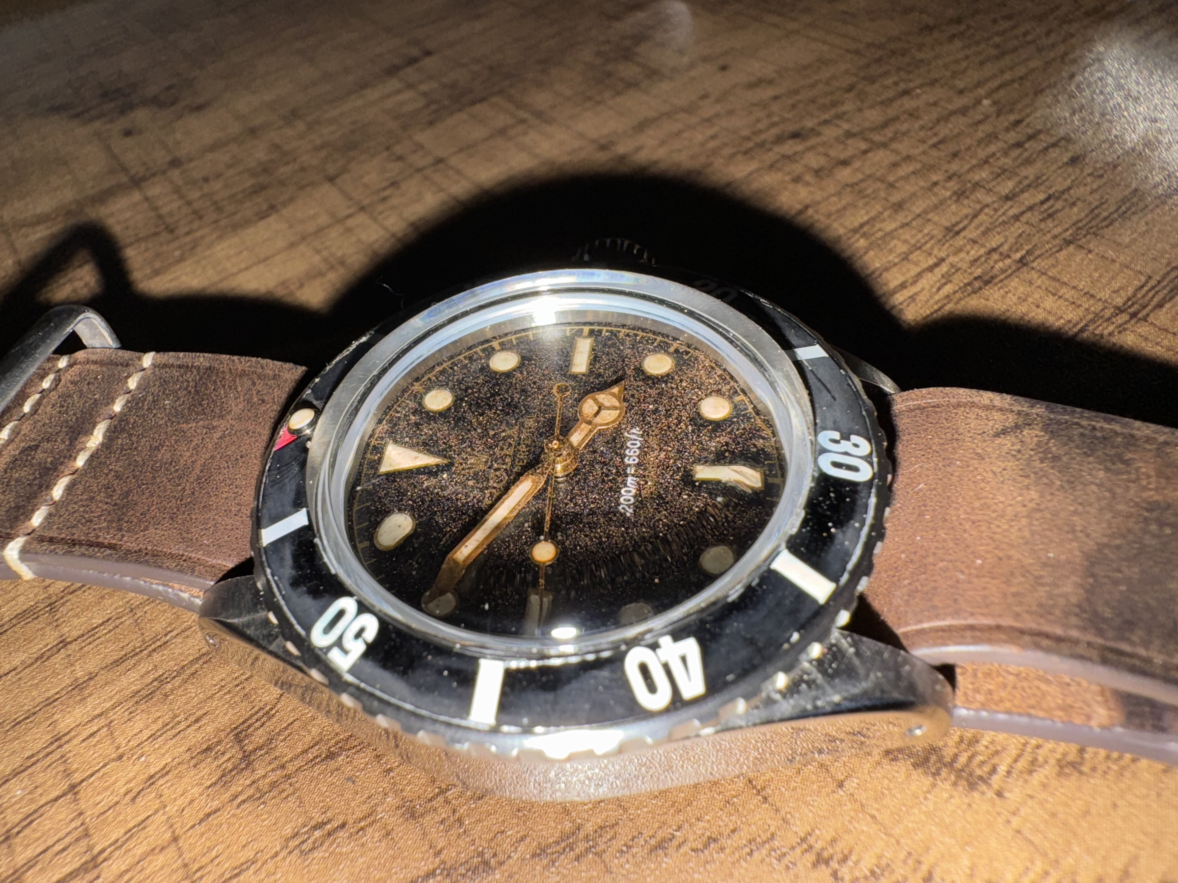

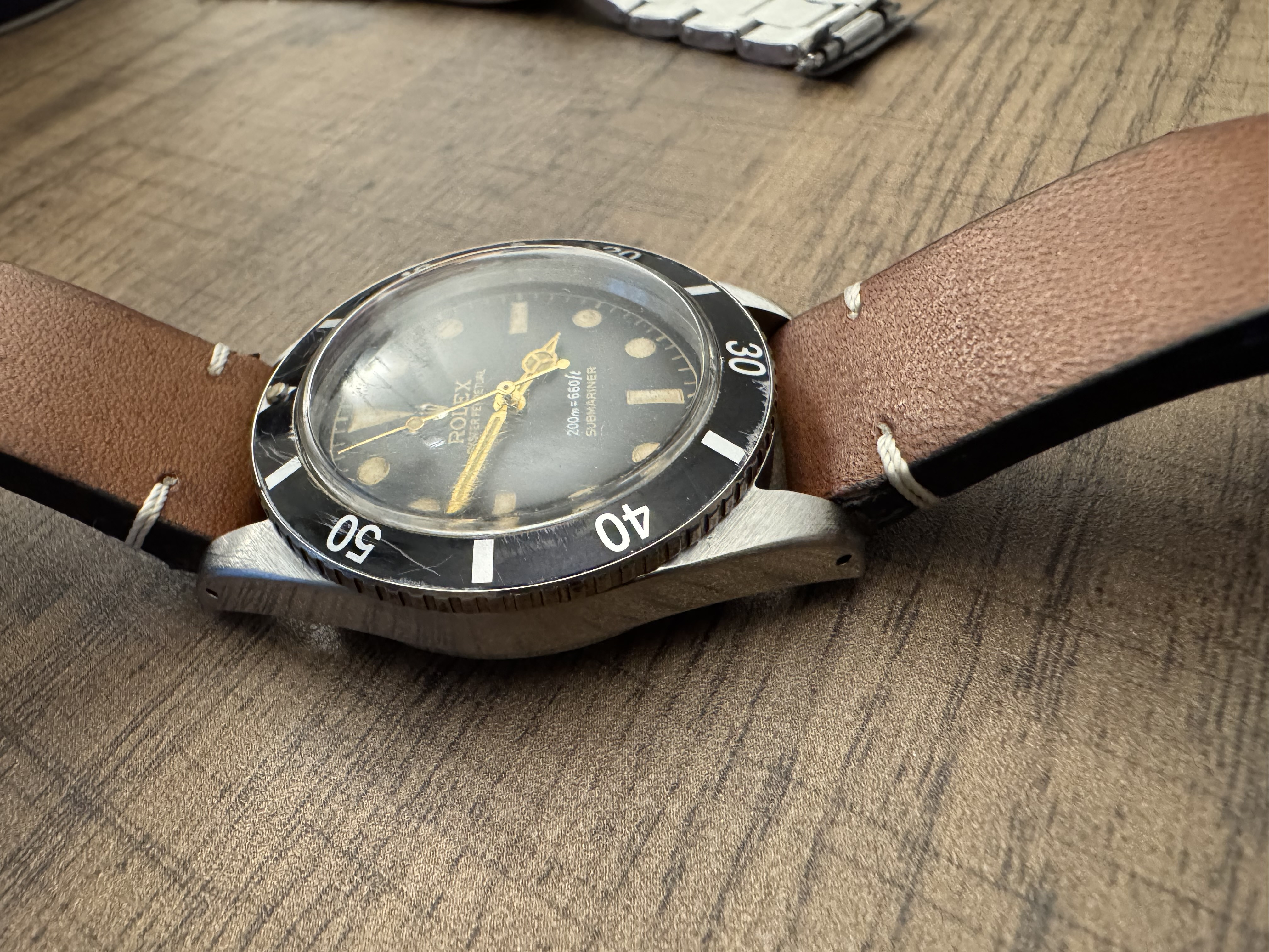

Started on the case, slowly making progress with the lugs and mild grassing of the bezel
geoffdragon
Member
18/5/21
784
1,283
Uk
Great. What "brassing" method are you, did you use?
Remove it and heat it up?

Have to say I’m enjoying tweaking this so much I’m now tempted to upgrade to a better dial :ROFLMAO:
Reactions: geoffdragon

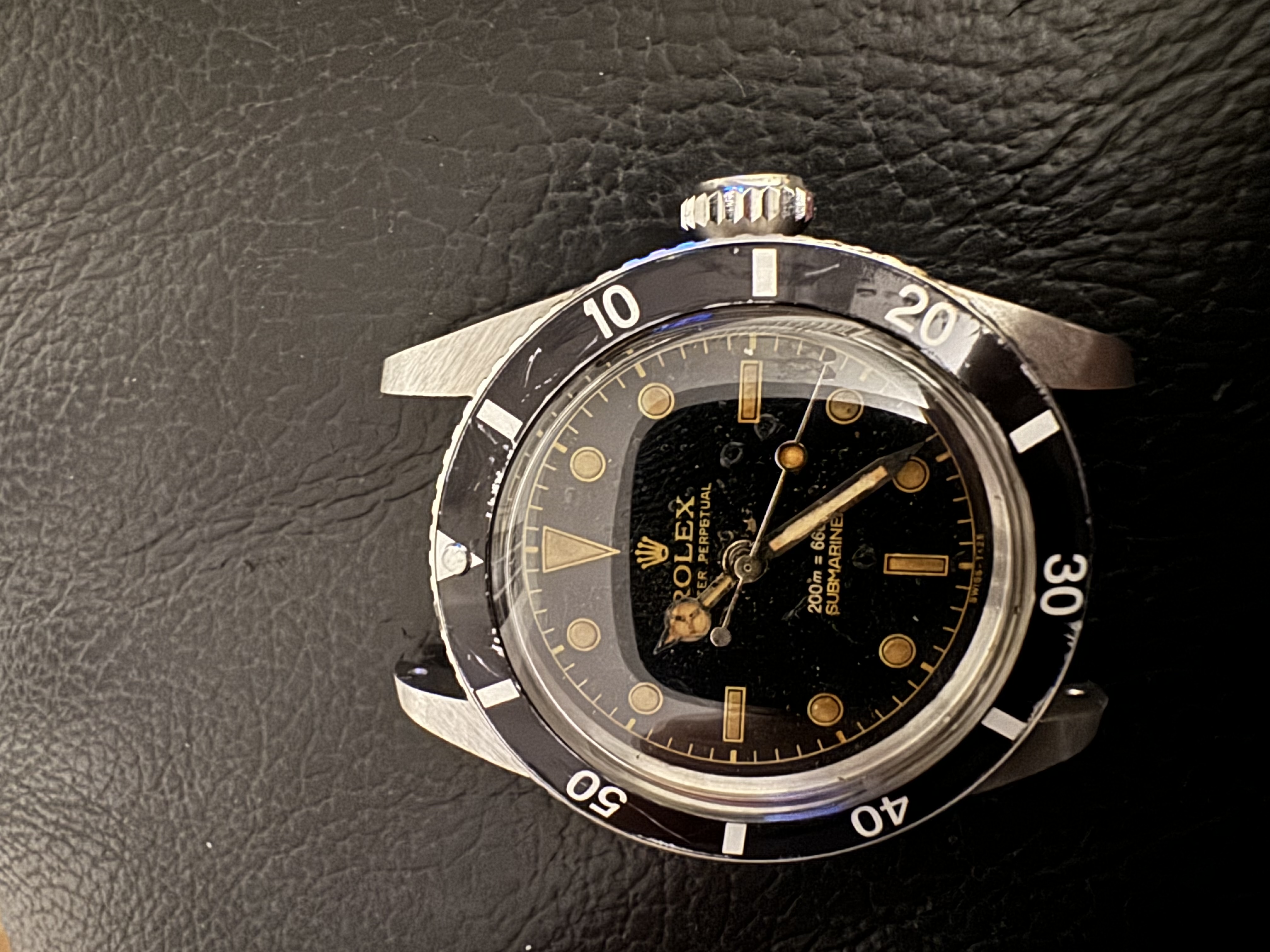

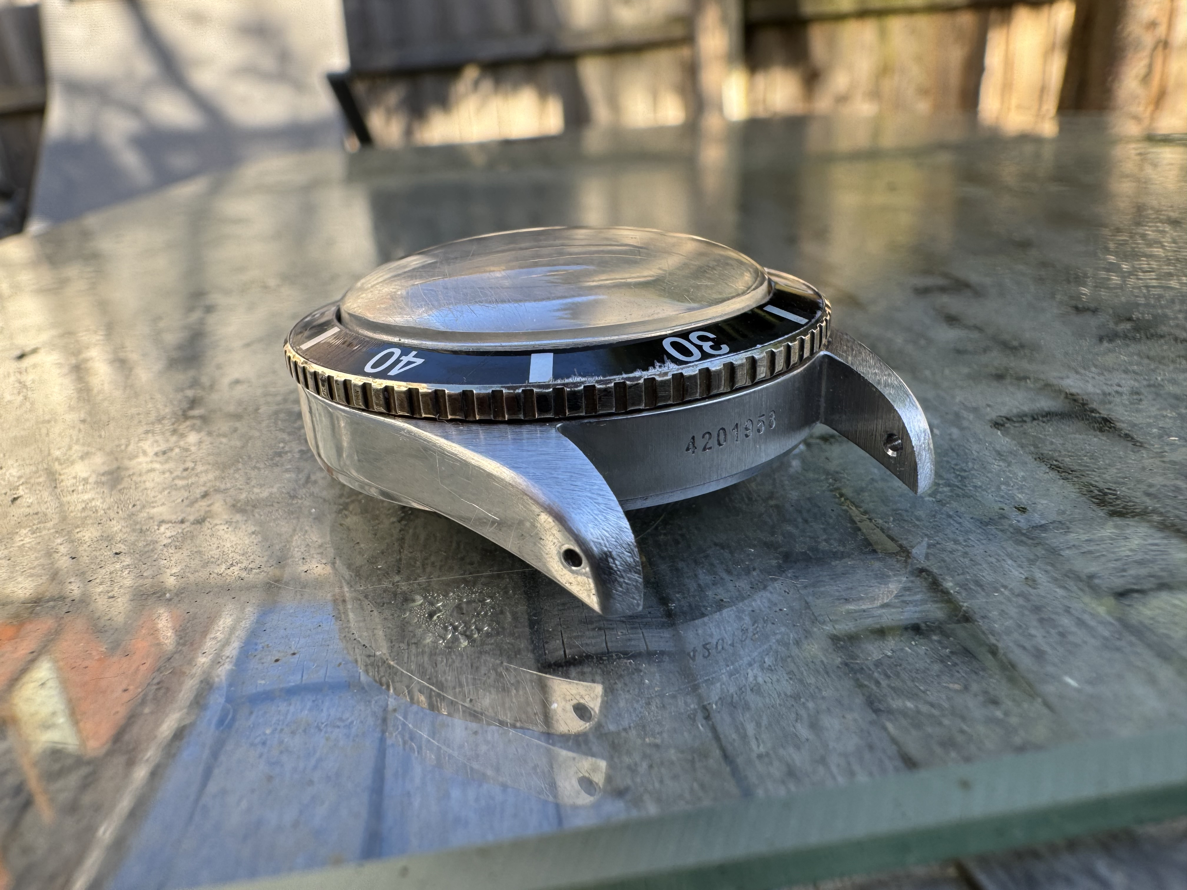

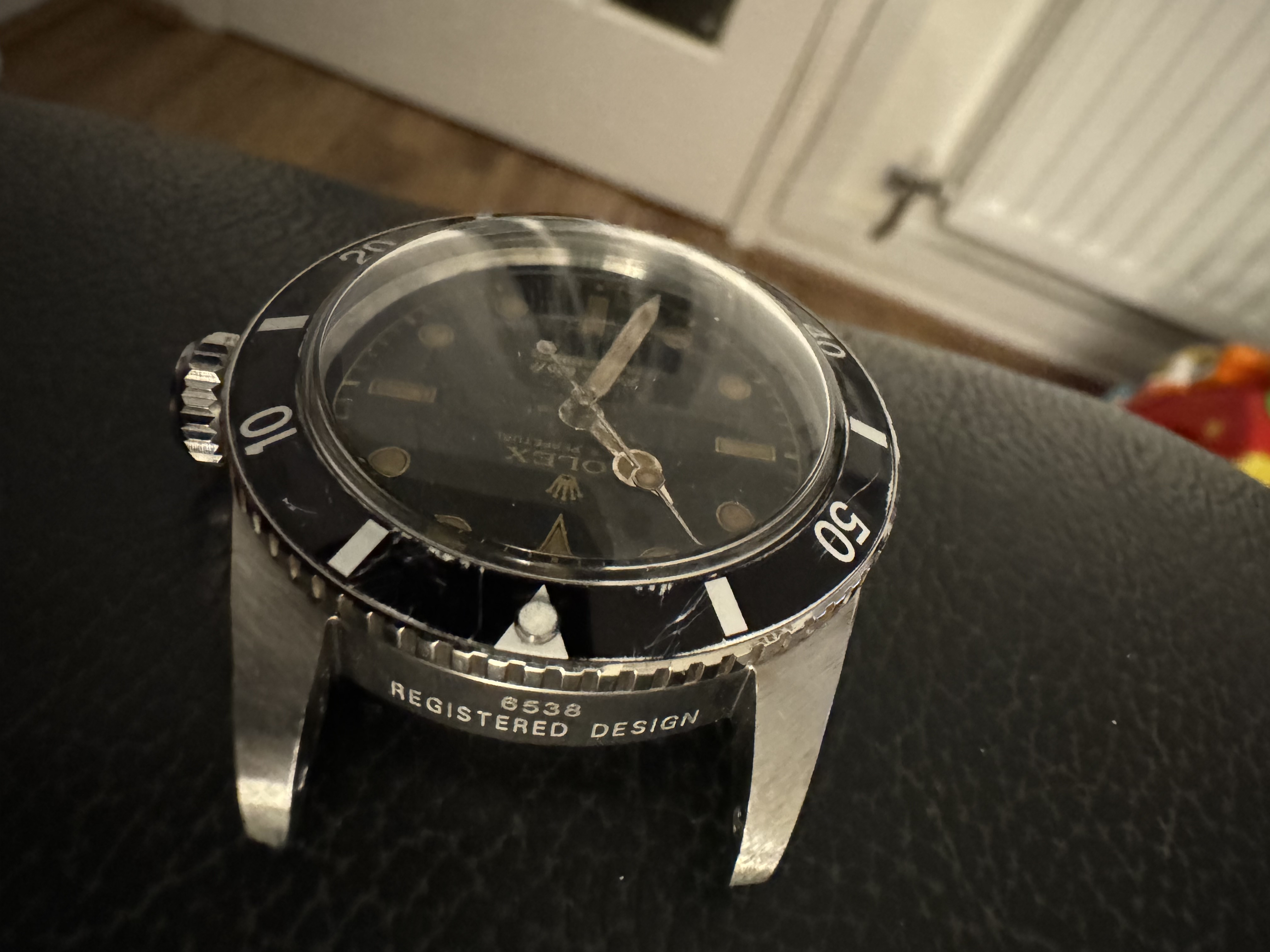

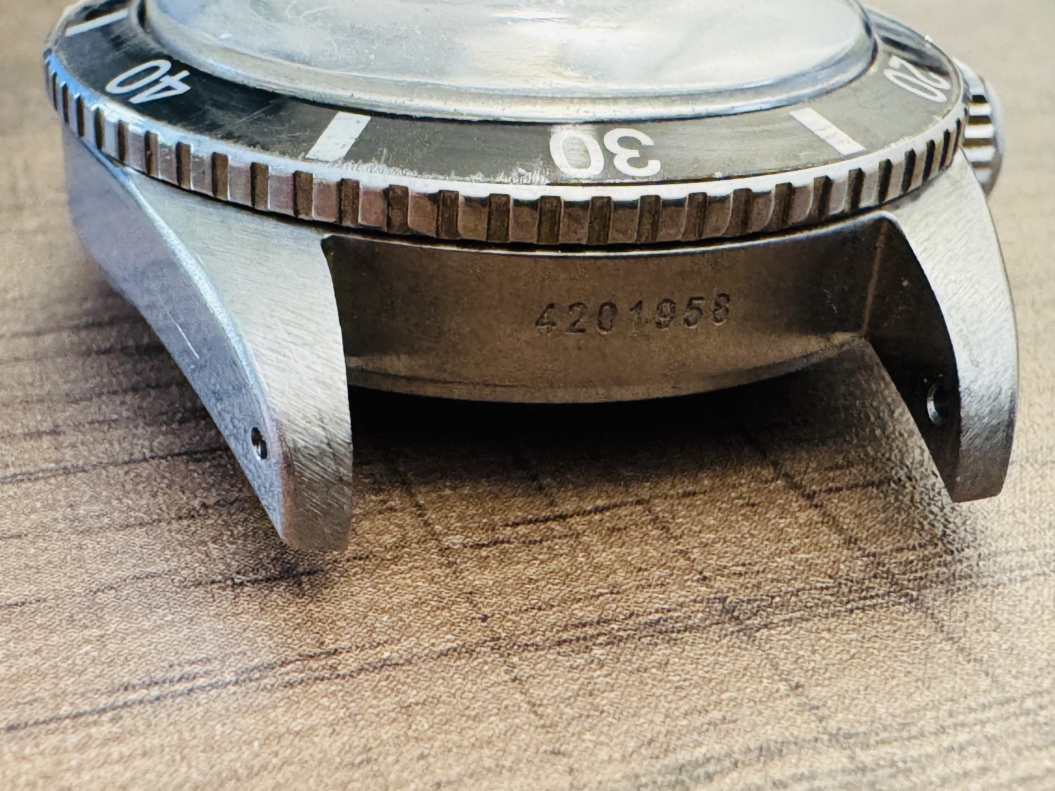

More casework today, starting to get really happy with it. Definitely going to upgrade the dial after all this effort on the case, all done by hand so going to take a break as iv got wankers cramp.

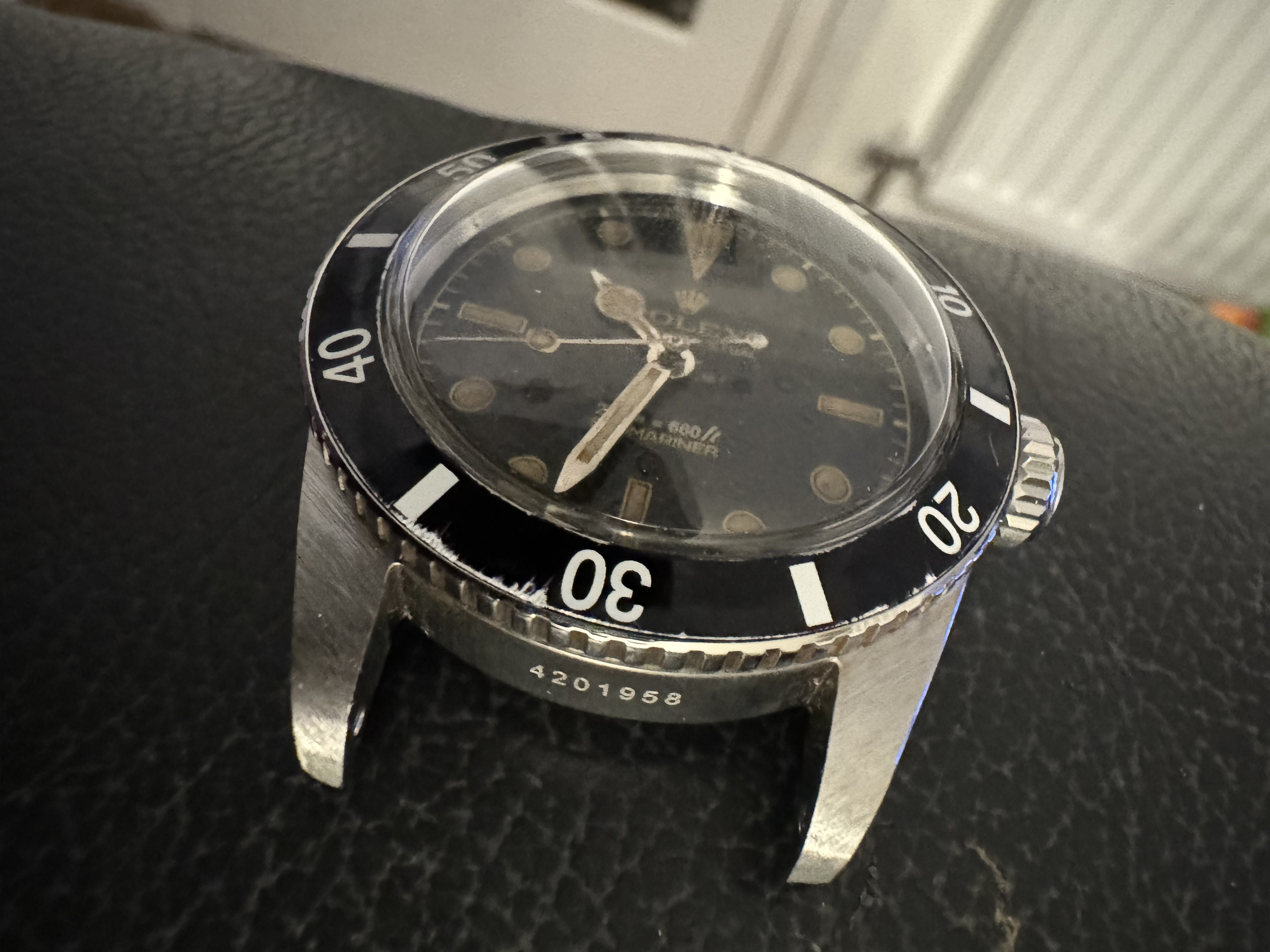

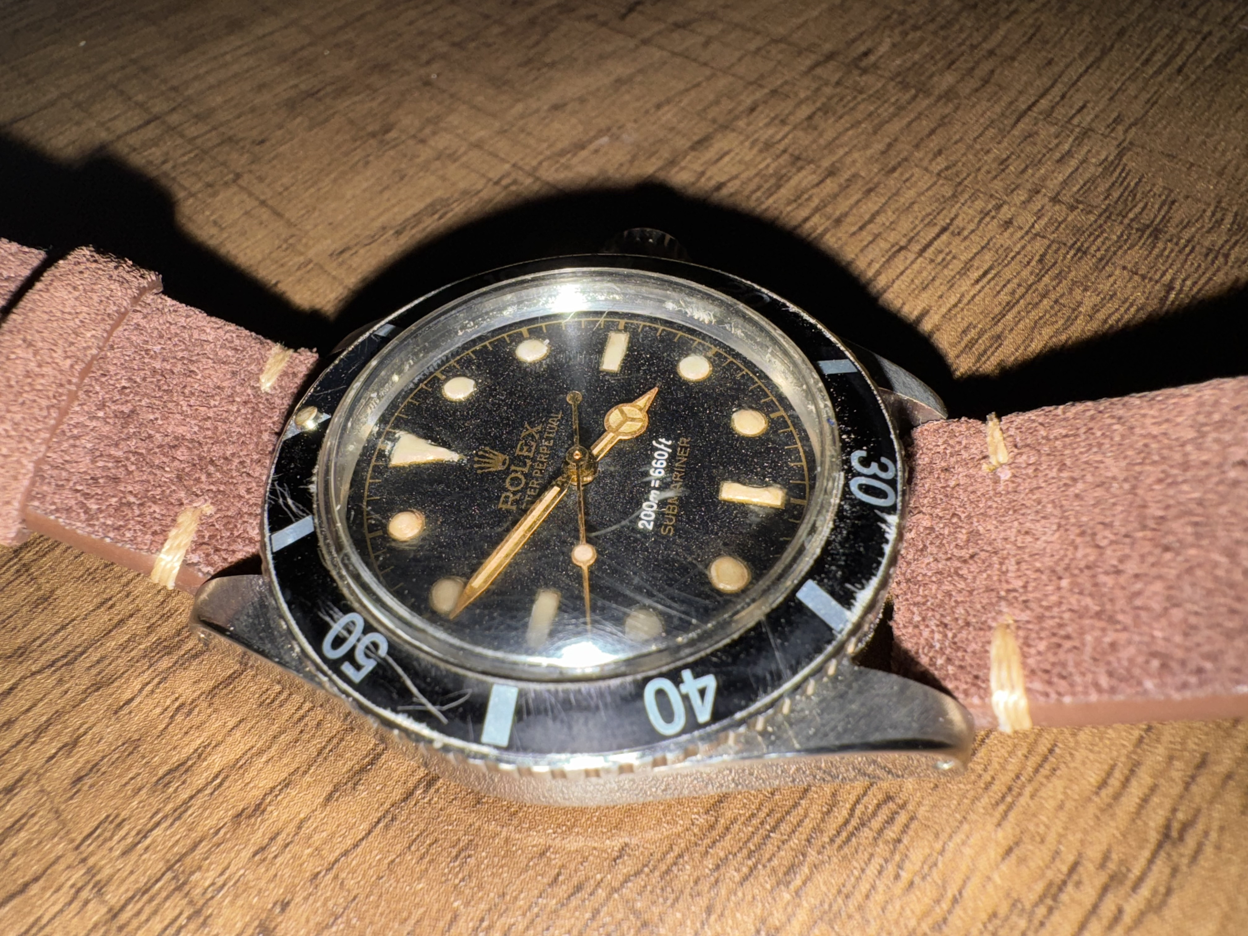

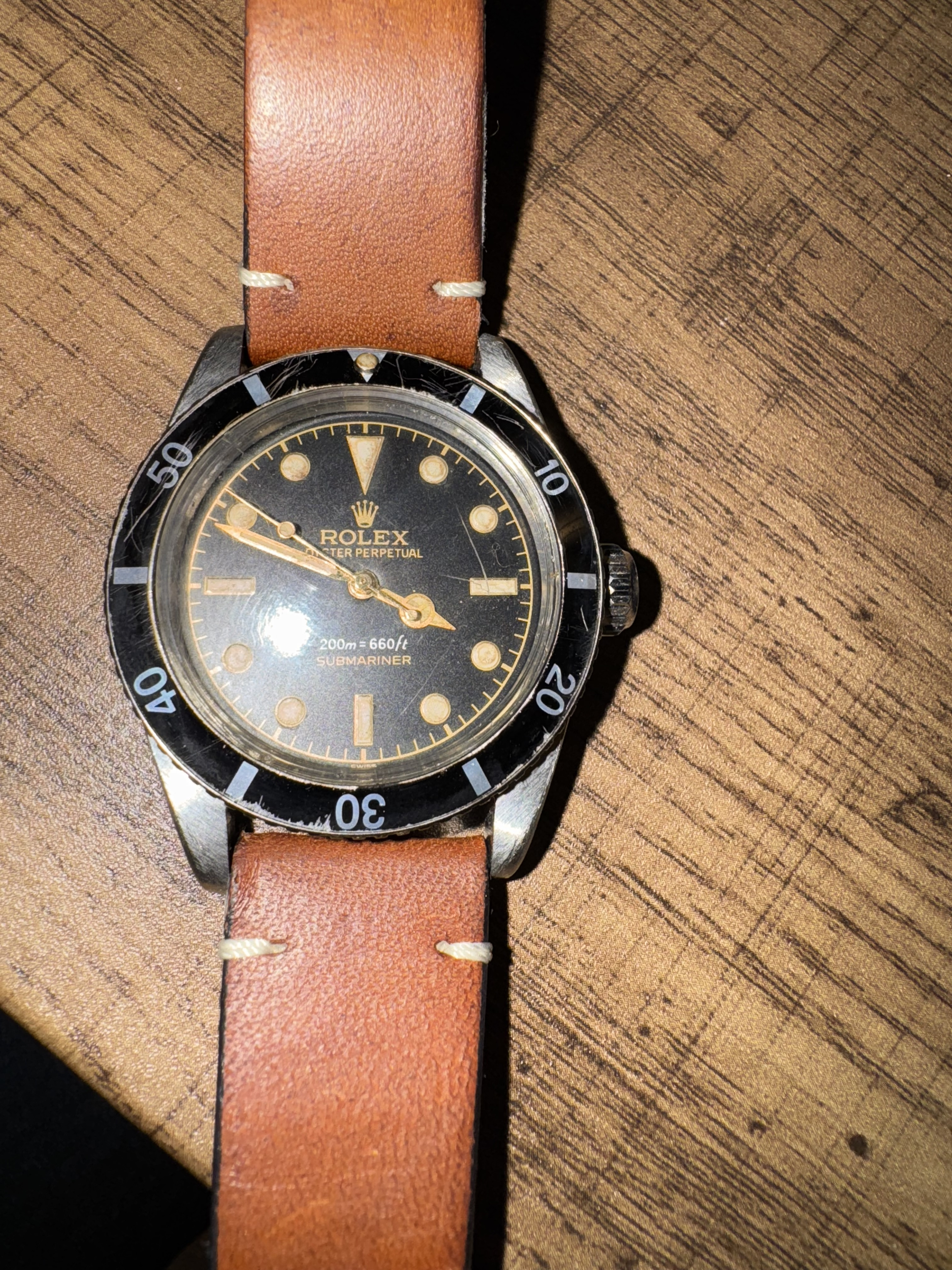

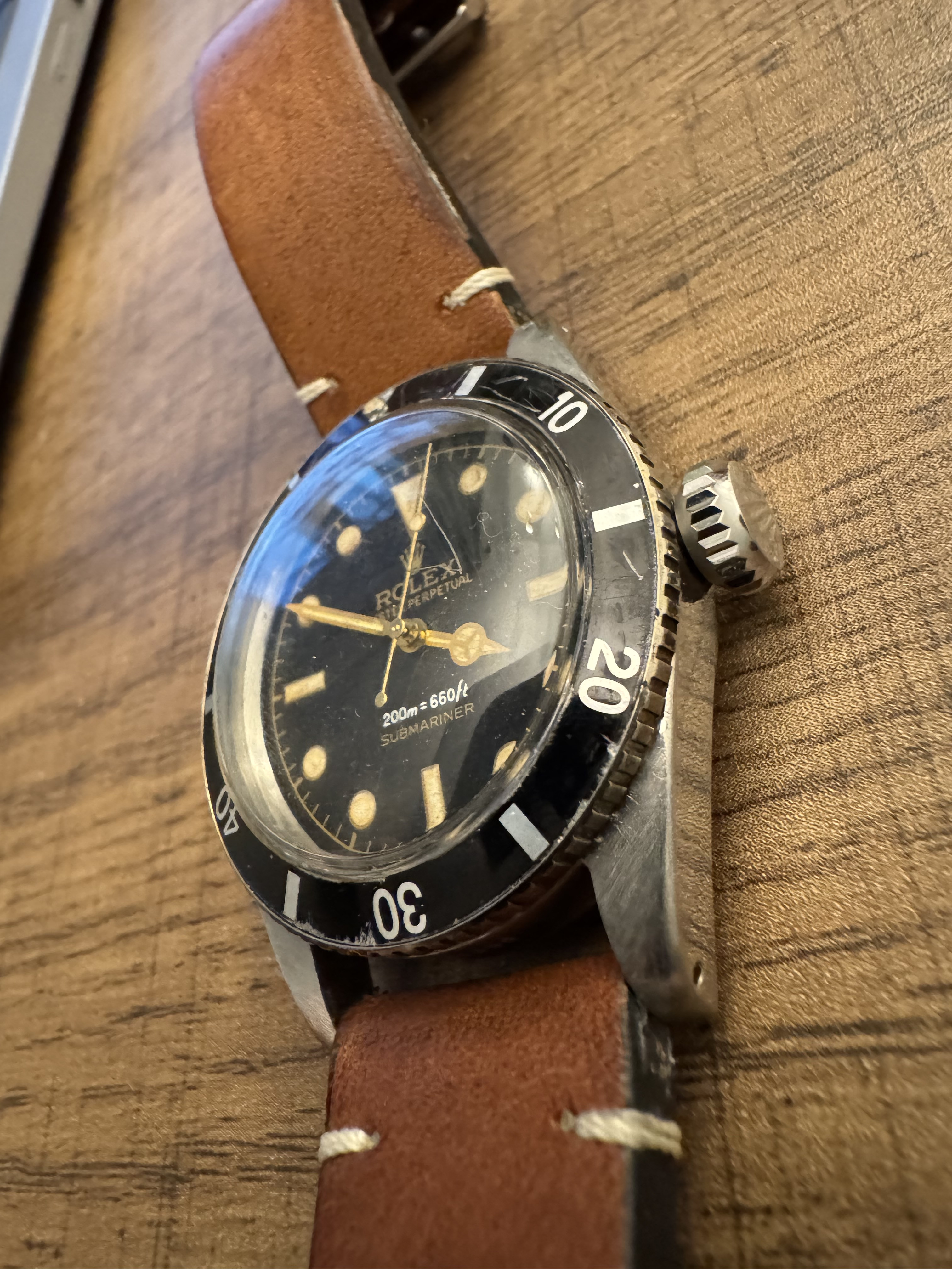

Ok so I forgot I ordered two dials from raffles for my other build. Wasn’t happy with the cartel stock dial so iv aged this one a little more subtle, also got some new hands delivered today. So I’m nearly there with this, but I’m so obsessive il probably find something else I need to do soon.
I think this looks better with the new dial, what do you guys think?
freddy333
Former RWG Mod
10/10/24
135
241

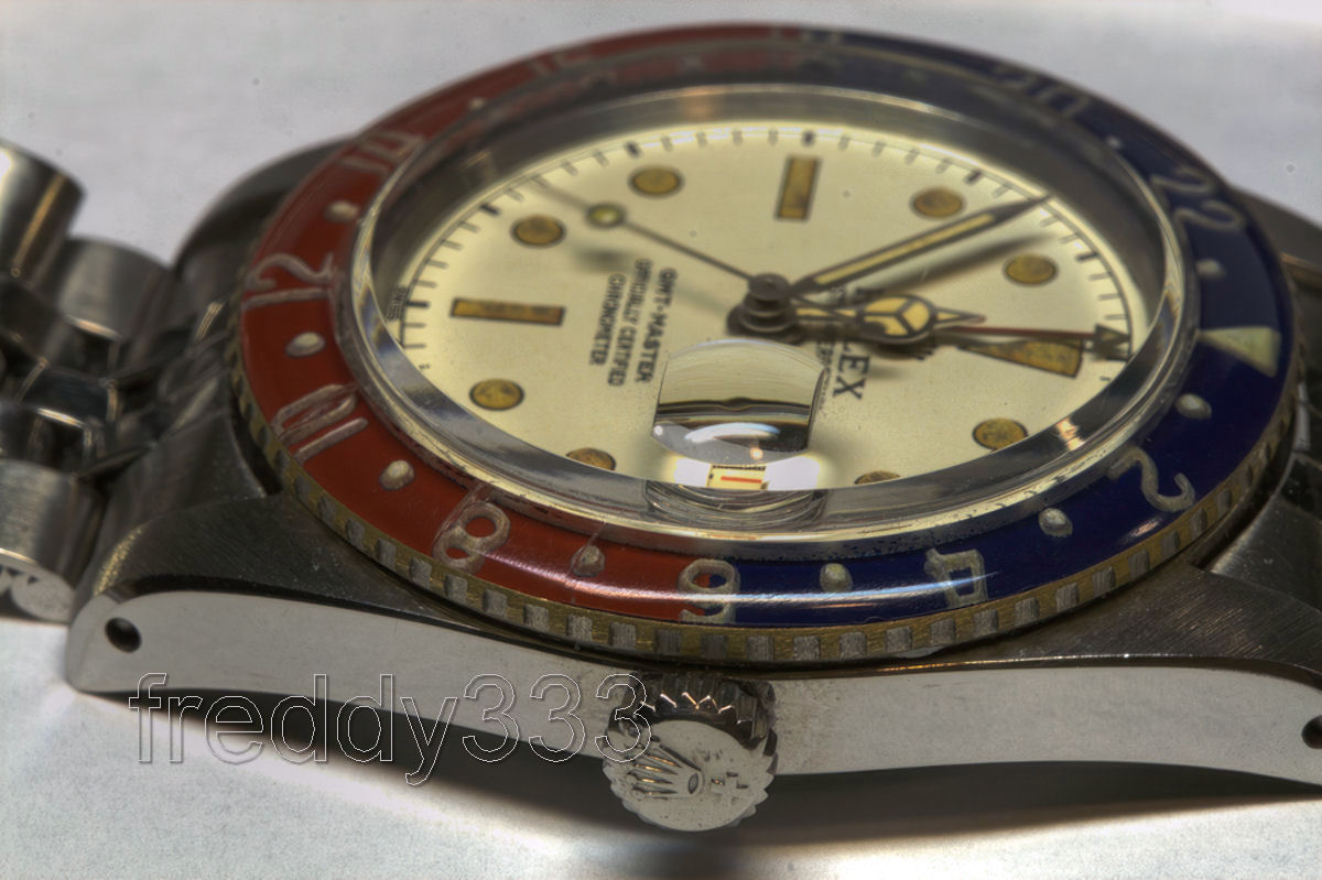

Excellent work & I see where you are heading. But I think you need a bit less patination of the dial & a bit more on the case & crown (so the watch looks more cohesive with the parts appearing to have similar life experiences). There is a fine line separating natural patina & what looks like induced age/wear.
Jip7645
18/9/24
711
1,175
Totally agree, think I’m starting to learn less is more when it comes to the dial. Good advice, thanks 🙏
Reactions: freddy333

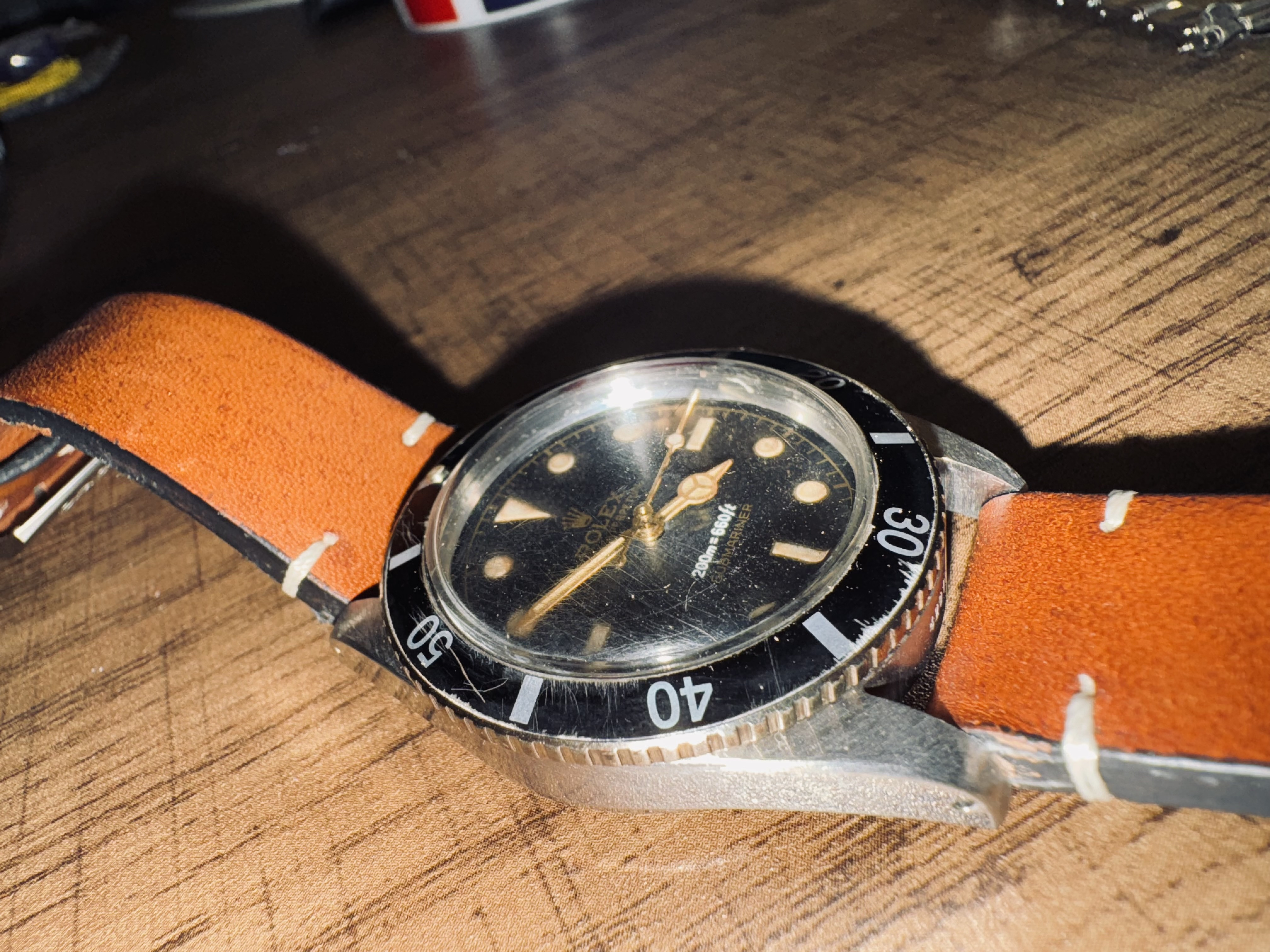

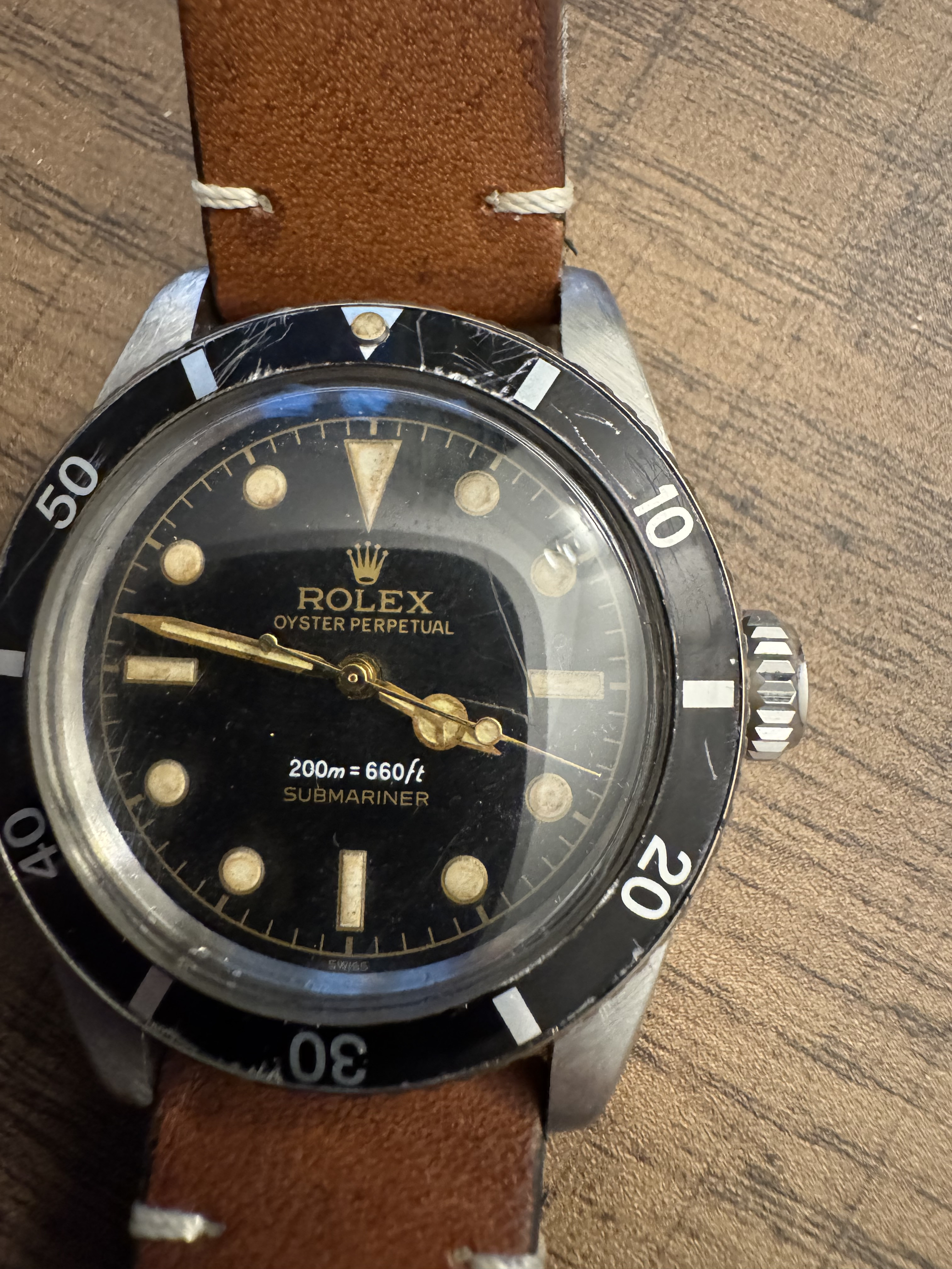

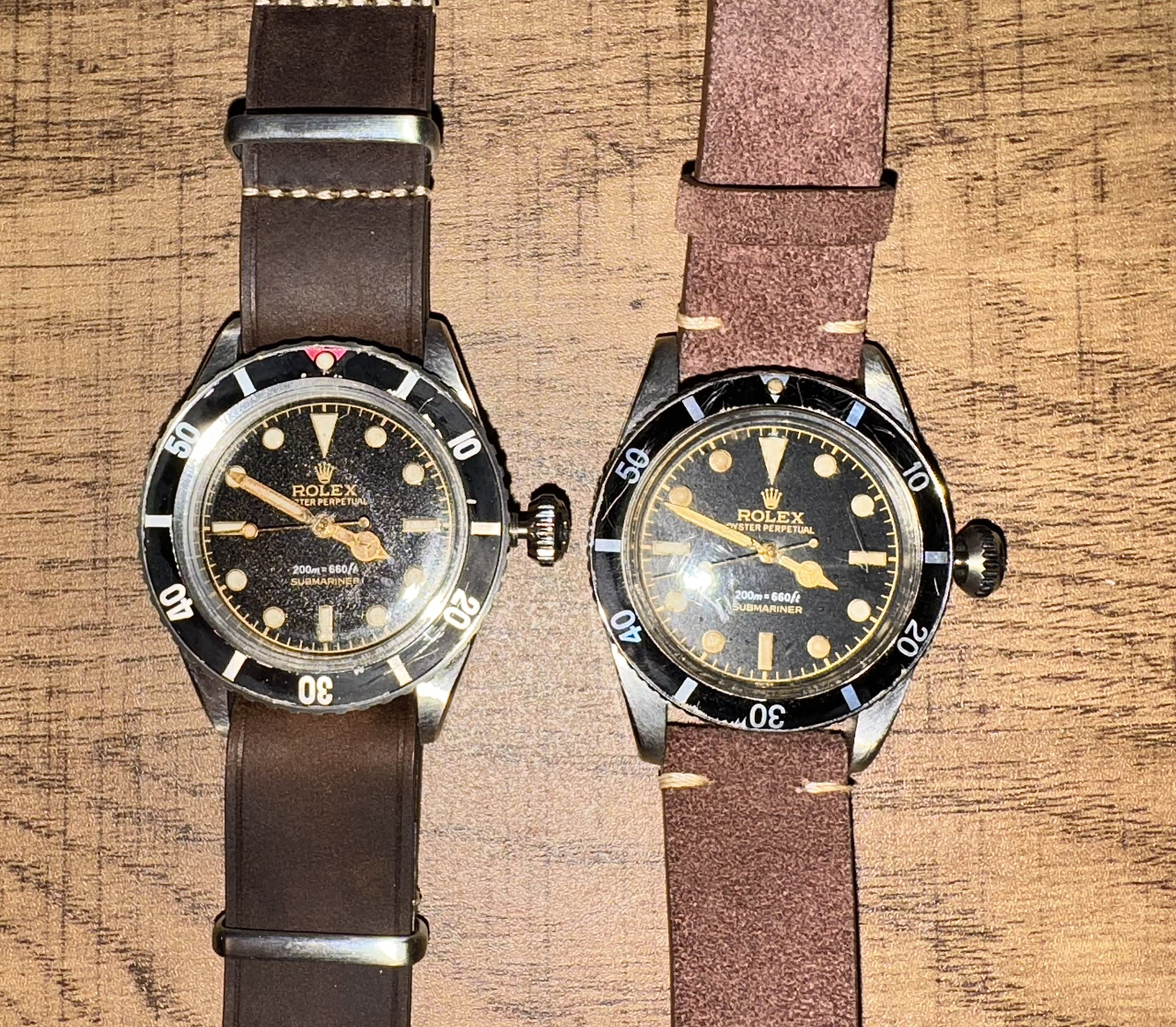

Right, I’m putting my budget 6538 build journey to bed. The insanity of keep coming back and tweaking things is officially over. On the left we have pure raffles build except for what I believe are bliger hands, significantly aged all round. On the right cartel base, reshaped slightly and my attempt at chamfers, with raffles dial aged and relumed (not pretty but not bad for a second attempt). That’s it, we can all go home and stop thinking about 6538’s.
……ok so I’m going to build a slightly higher budget 5512 and 5513, here we go again
