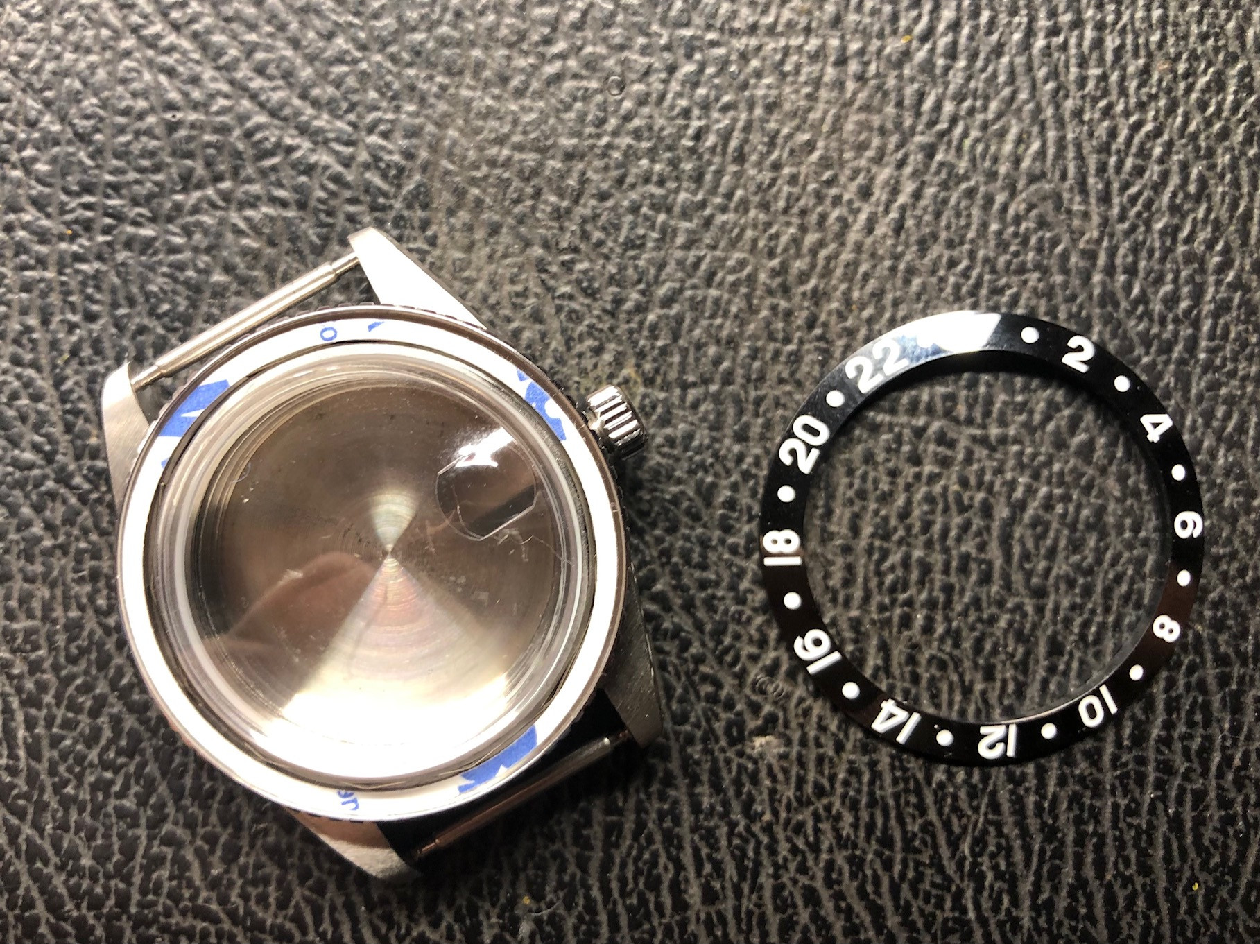

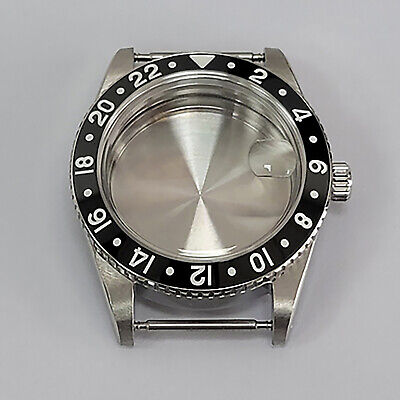

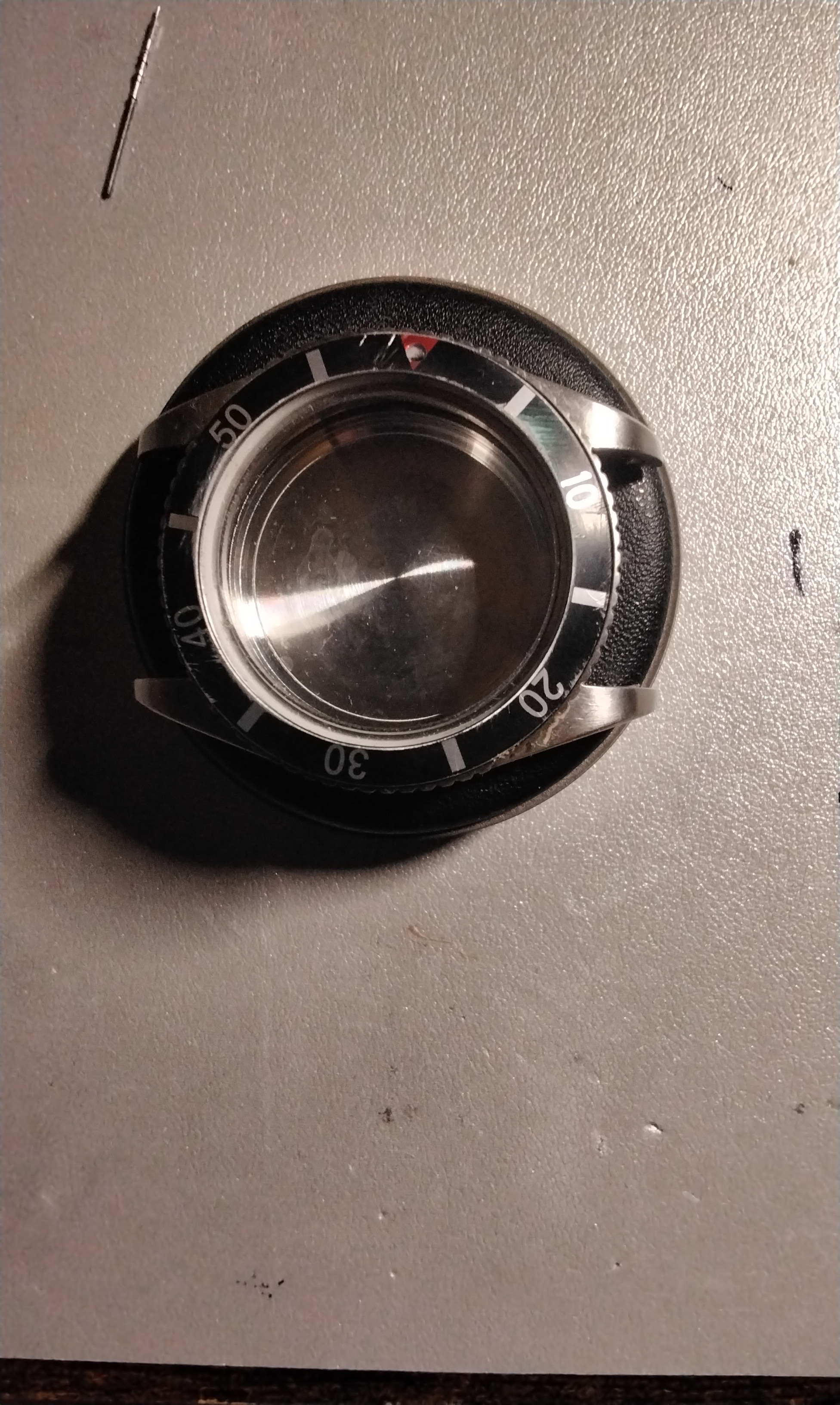

was cruising ebay , looking for parts and came across this case set.
It arrived today and good news. I was looking for a thinner case set for a 6536 /5508 build and I think I may have found it!!
case dimentions mm the flat sizes make it look thicc but its quite a nice size mid case.
38.1 d
15.6 h
lug height 5.3
case has lug holes , that look like they could be drilled out to 1.3
rehaut 28.1
dial seat 29.4
36mm raffles movement holder fits perfect.
will fit raffles sub dials no problem
bezel
uses wire - not gen spec - only disappointment the bezel is fine however I was thinking it may be good for a milgauss but a smooth bezel wont fit the mid case without some machining work. a bit above my pay grade. I think that because the way the crystal mounts I would be plagued with that gap between teh bezel and dial , that ruined my first 1019 build. But for my 6536 it will work just fine!!
uni directional with click spring removable.
insert 37.3 od
30.6 id
the insert it comes with I thought may be acrylic and could be repainted for a 6542 but it is a solid plastic with engraved numerals.
raffles inserts pop right in and fit nicely
raffles 6mm crown fits
raffles 5.3 crown fits
raffles 8mm may fit. I will try it later
crystal has cyclops and is acrylic . the WSO 116 gmt crystal fits loose. would need some GS glue , but maybe a T19 or a clarks 25-116 may be tighter I can provide dimentions and if any crystal nerds can cross reference the sizes to a clarks piece, that would be cool .
it is not glued in so it can be swapped for one without a cyclops or you can sand off the one on the og crystal
I have not done a comparison between the raffles 6538 and this case but this one feels slimmer and better suited for a 6536 project for sure.
I may swap in my 6538 guts to get a feel and see how it looks. so far its quite promising.
Always happy to find and share new options for projects and builds!!
if there are any specifics I missed, ask away and I can take measurements.

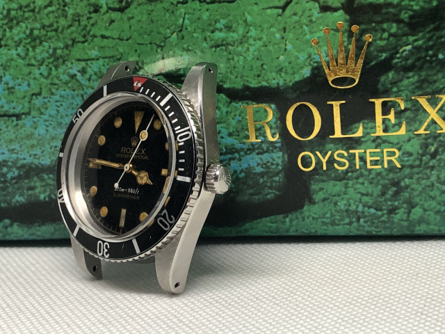

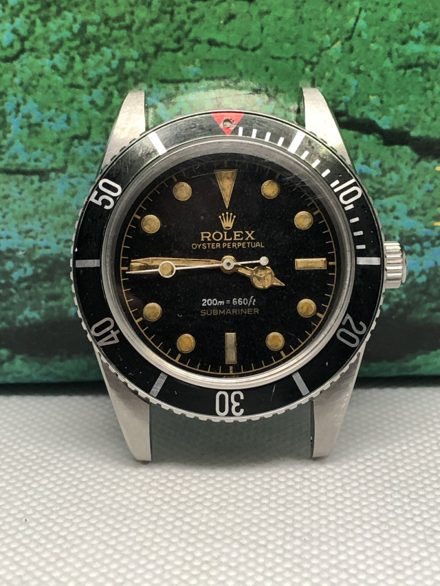

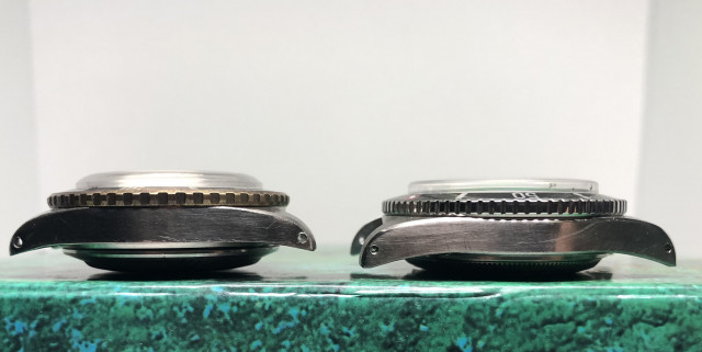

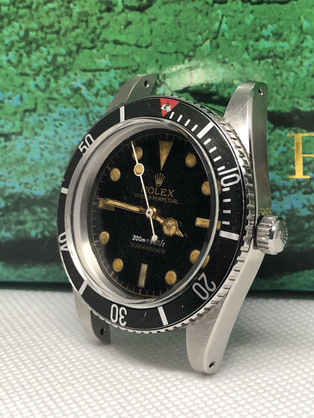

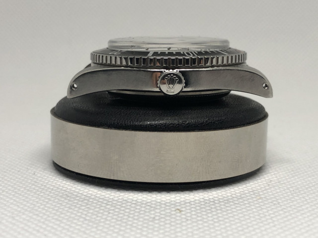

youre correct
gen for ref

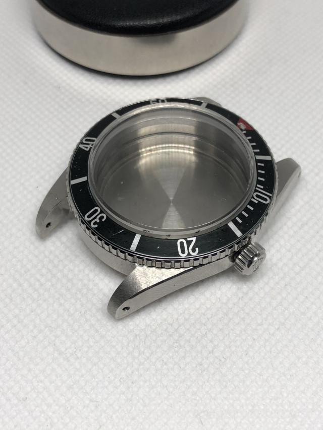

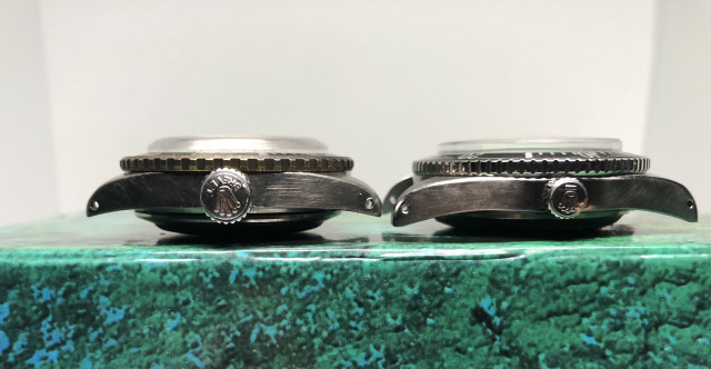

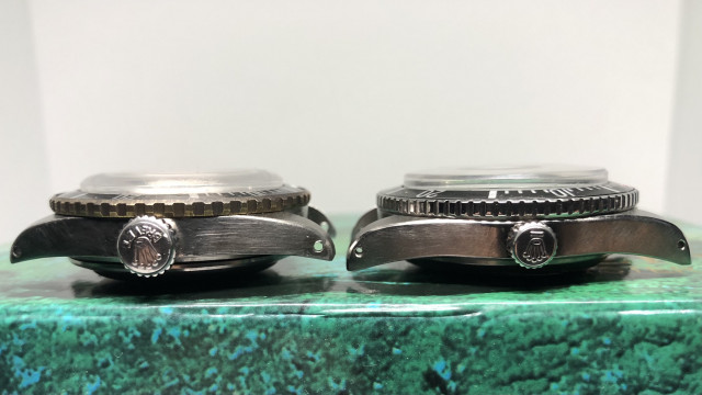

I did a quick look at this case and my 6538 the flanks of the case look slightly smaller than the raffles case. but it feels more svelte than the raffles. maybe its the crystal ?
the bezel as you mentioned looks more accurate.
have yet to compare the lug holes position

at closer look this case is not anywhere near thin enough for a 6536 but the finishing is nice , it has nice chamfers
overall its a nice affordable alternative to the usual suspects from china and vietnam.
it could be passable to most except vintage experts.

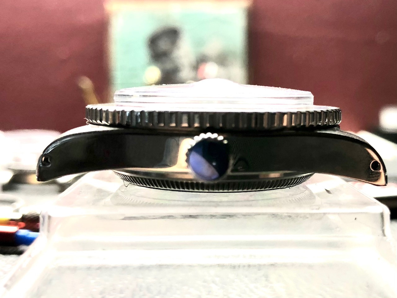

UPDATE:

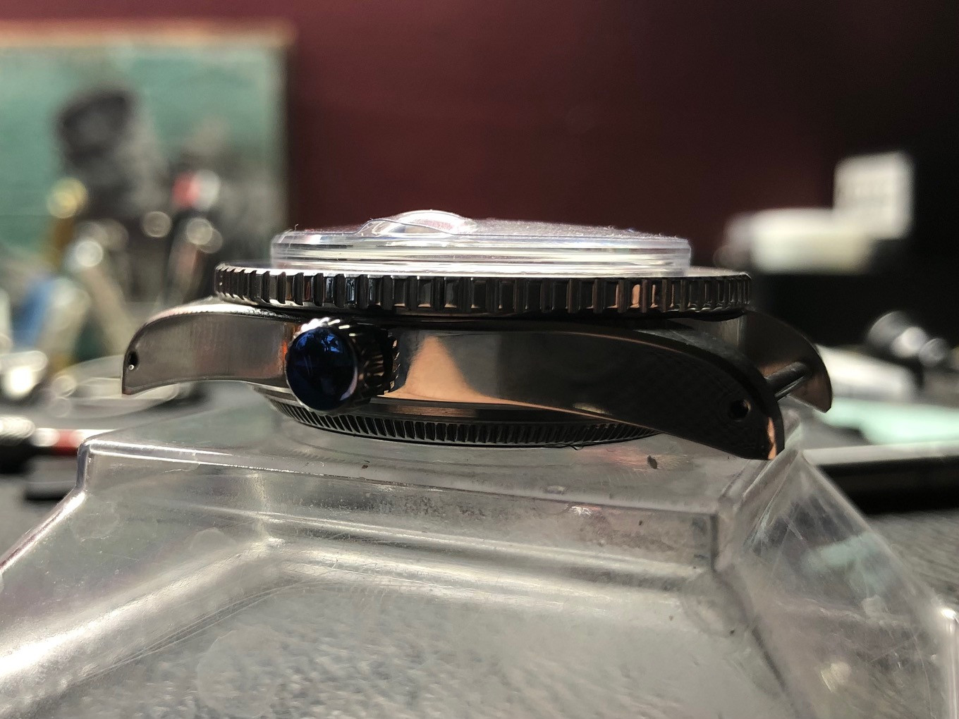

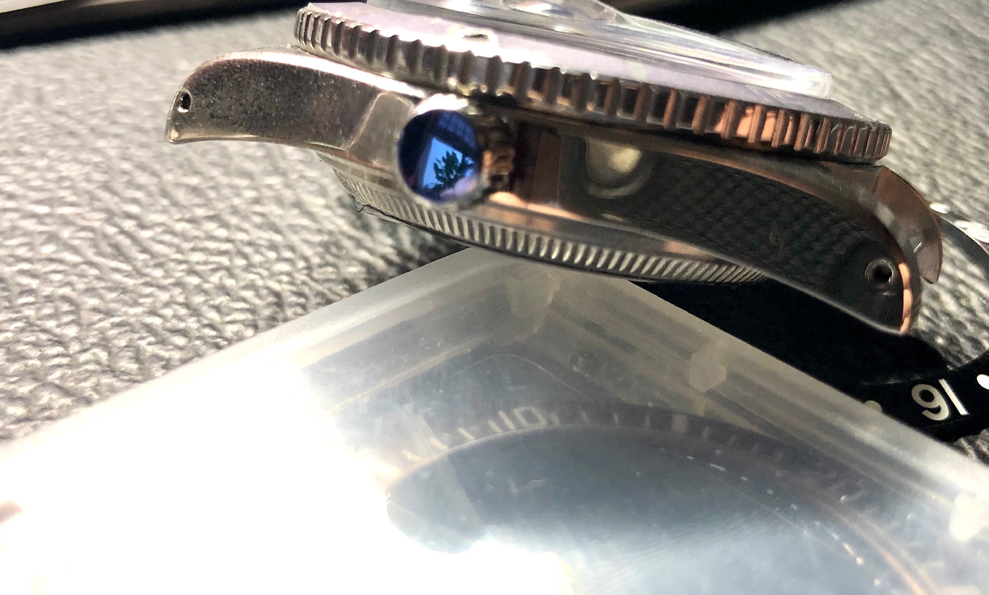

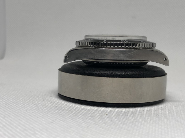

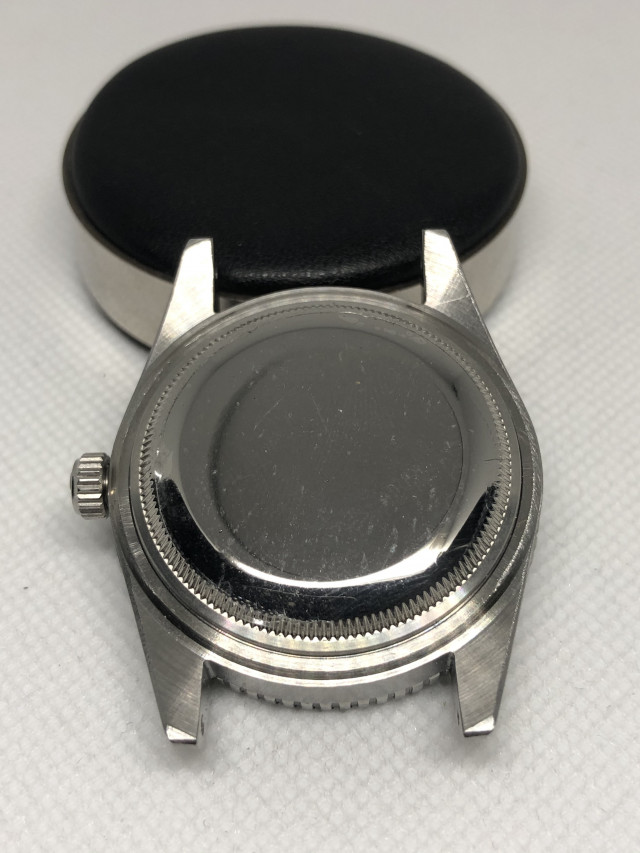

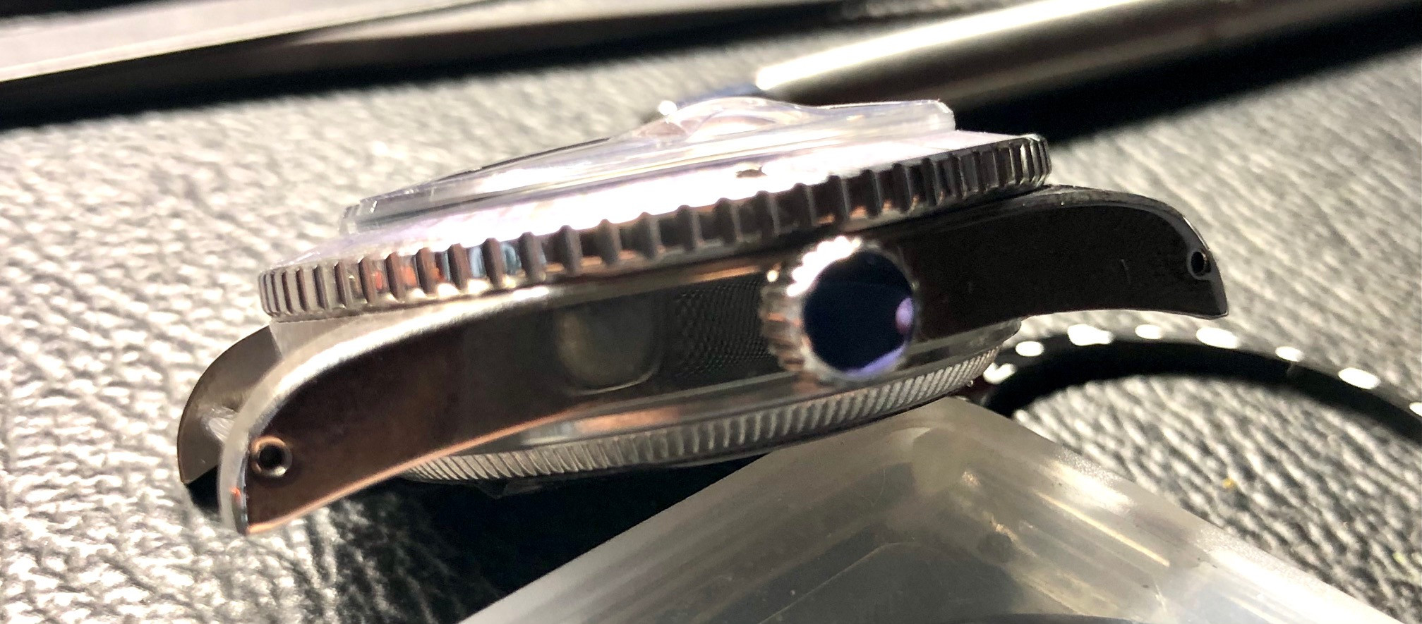

So I thought I would attempt a bit of shaping yesterday evening using needle files. and I must say I am pleased with the shape this case is taking on!! I address the underside of the lugs, the very bottom edge and reduced its height slightly and softened the bottom edge

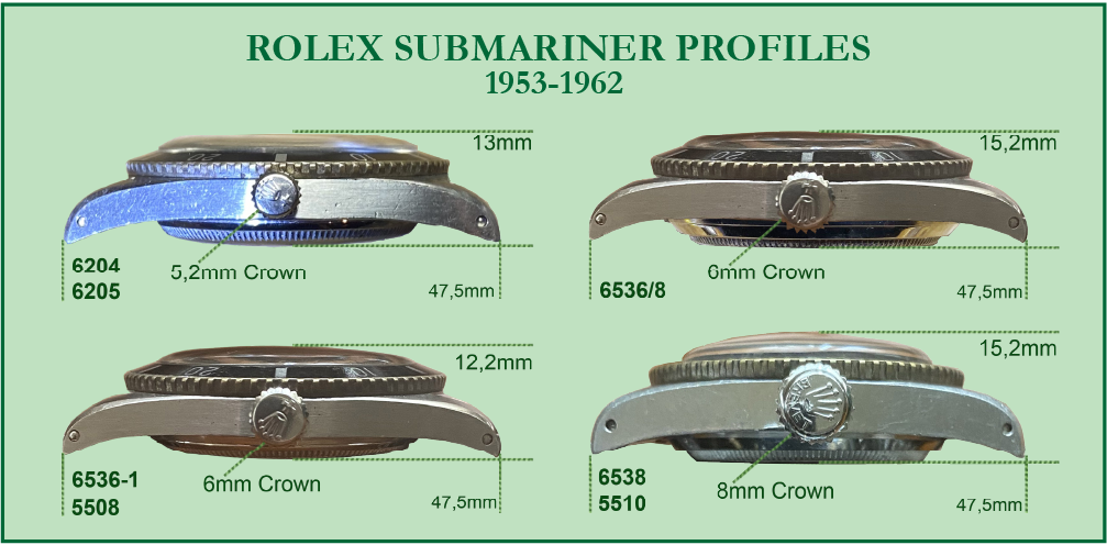

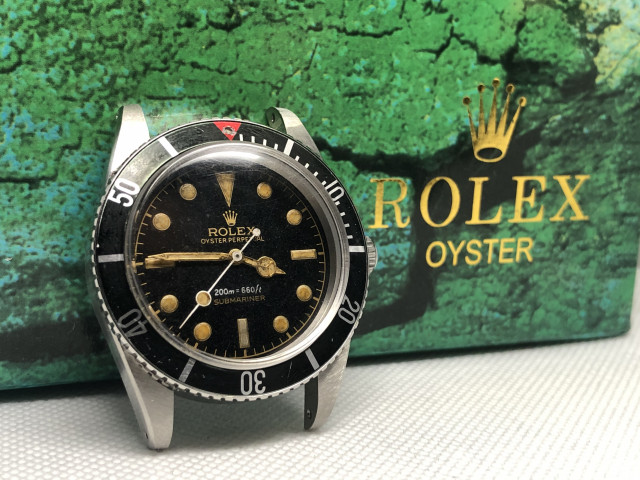

I think its quite similar to 6536-1 profile shown above.
the way the caseback is designed on this , the threads are somewhat inset to the opening so there is little chance of accidently hitting them with a file and wrecking the threads so you can really work on the flanks and reduce height.
I am 95% satisfied , it looks like it can use a bit more near the ends of the lugs to form a bit more of a point.
There is a gasket in the recess that holds the crystal I have not tried removing it as I dont want to damage it. however a T22 would not fit. , but I tried it with the gasket installed. I think it might just fit if I remove the gasket. perhaps Ill try today.
I want to drill out the lugs but I am a bit concerned on the position. I will enlarge them but may not go to 1.3
In reality a great option. I wonder if @Winni1611 could chime in as he had built a 6538 using a tiger concept case and to me it looks similar to what they offer. Could this be from the factory where he gets his parts? plausible.

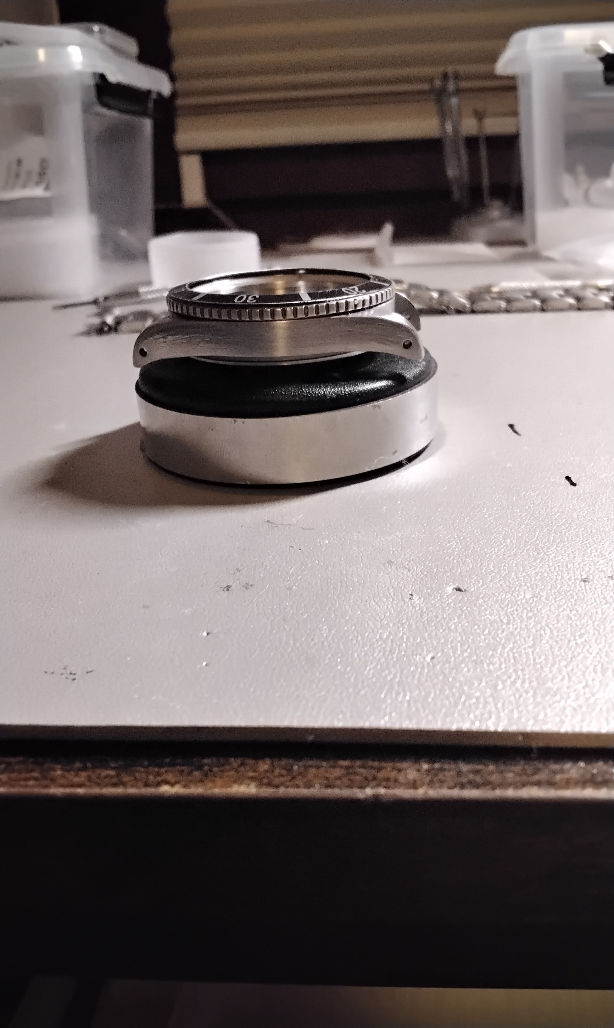

a couple quick pics. I think Im going to swap over the 6538 and see how it looks and make sure everything lines up with an eta before I go all in on this.

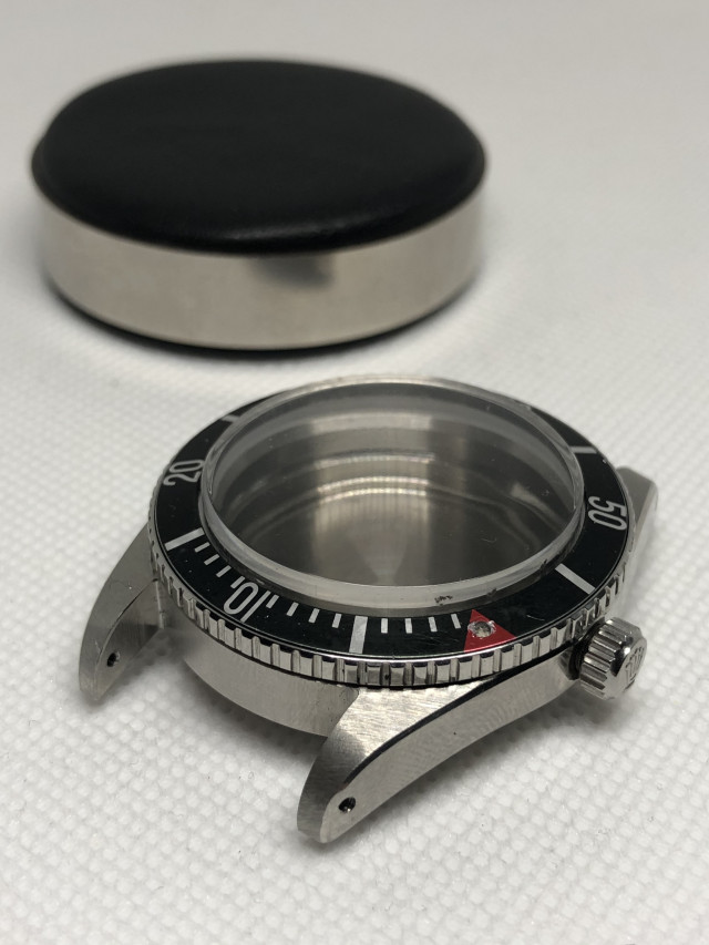

Update:
Swapped the guts from the raffles case into enay case it and they fit. No problem. In fact the rehaut is slightly larger so you see a bit more of the swiss and a bir more area ourside the chapter ring
Tabs need to be modified to fit the case. Slight variation to the raffles. Probably since the case is intended for nh movements.
Its just a moke up but overall i do like it morw than the raffles case. Its every so slightly more svelte Other than that. Not much difference.
The raffles 8mm crown doesn’t fit. You will need to swap in the tube.
