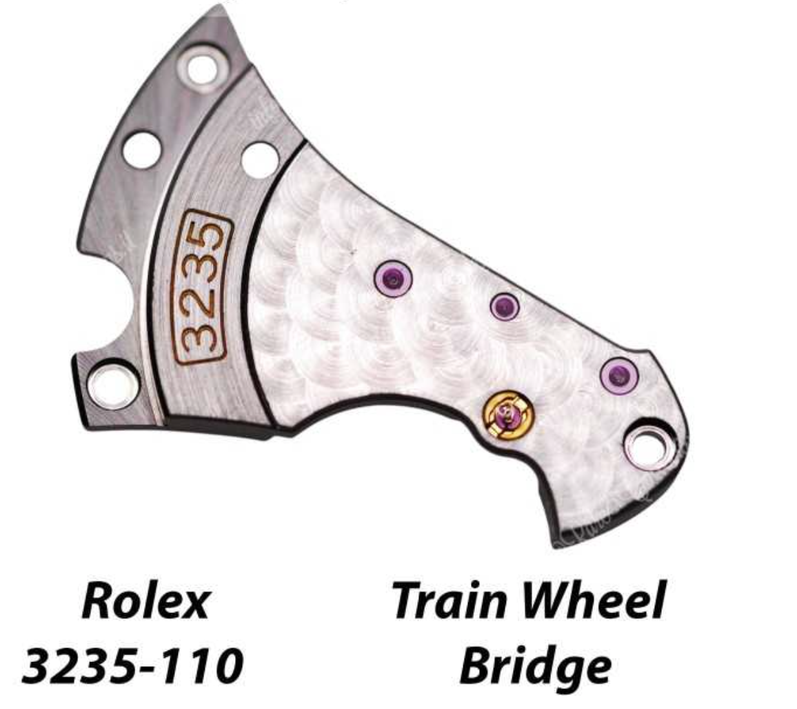

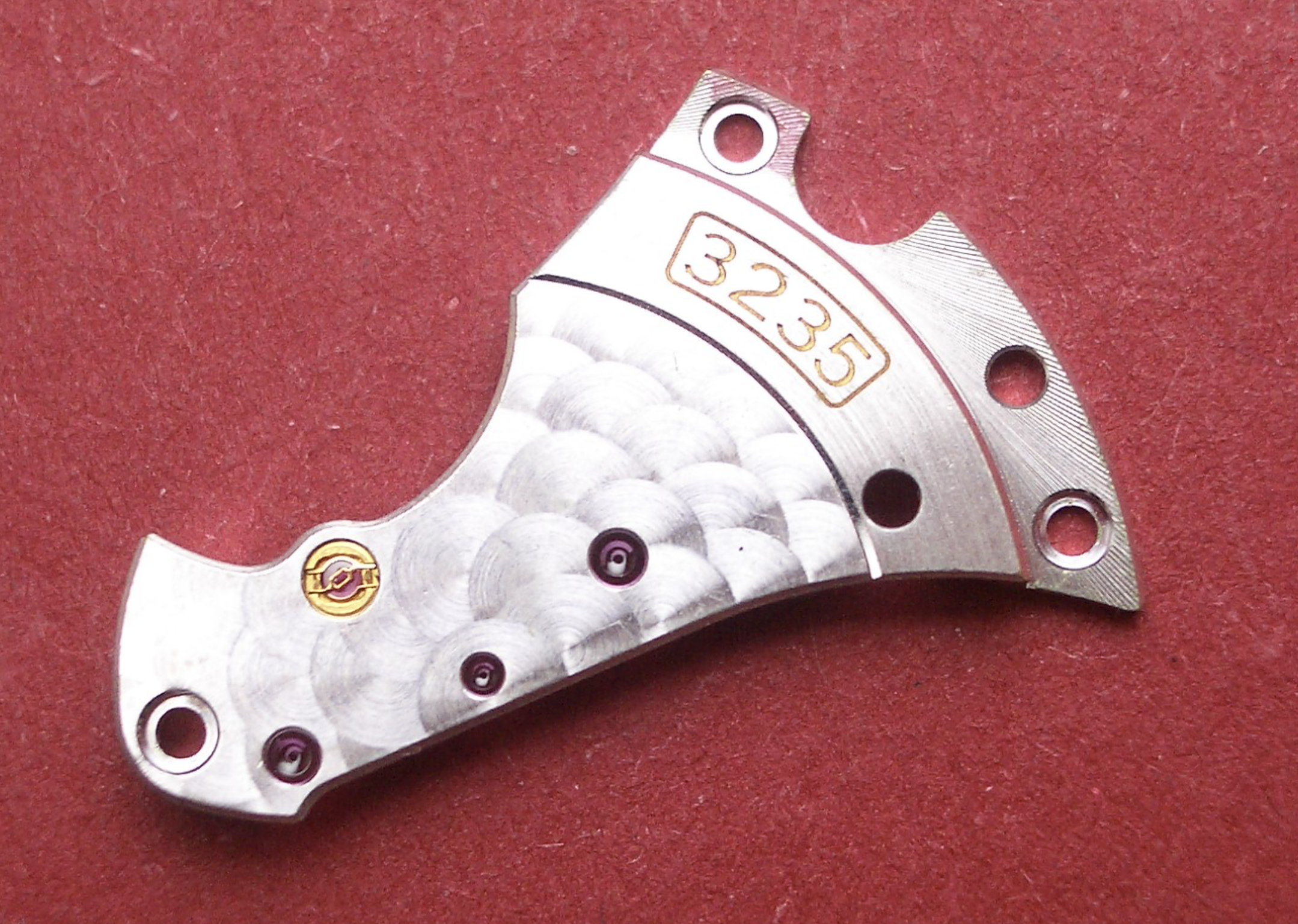

Hi, I just found out that my Train Wheel Bridge (3235-110) differs from the one that can be found on ebay or comparisons of the gen 3235 vs VS/VR3235.
The difference is that it is missing one hole with ruby. I asked about that the seller and here is his response:
Hello, yes we are aware of that, but these bridges are the new model ones, where they took off that jewel because it's basically unused, don't worry they are 100€ genuine original. we can guarantee that.
I would like to hear opinion on that from RWI experts because it is confusing and not sure if I have to order other 3235-110 with additional hole or not.
Here you can find screenshots for comparison.

Often wondered why this jewel was present. I wasn't aware that the gen bridge had been updated to remove it.

Thank you, gents! I already had another bridge in the cart on ebay but thank to you did not order it 😅
