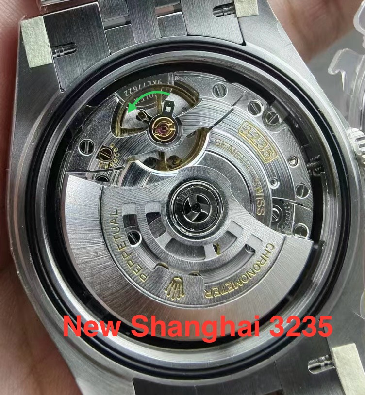

According to recent market rumors and news shared by WeChat dealers, Clean has recently improved their Shanghai SH3235 movement. The new, upgraded movement will be used by Clean in the near future, once their existing stocks of Datejust, Submariner, and Yacht-Master watches with the old SH3235 have been sold out.

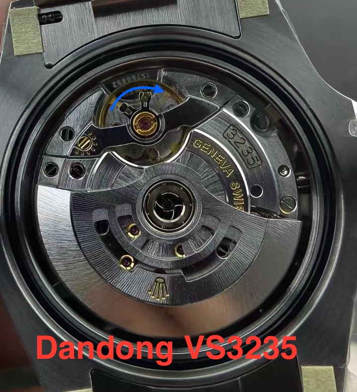

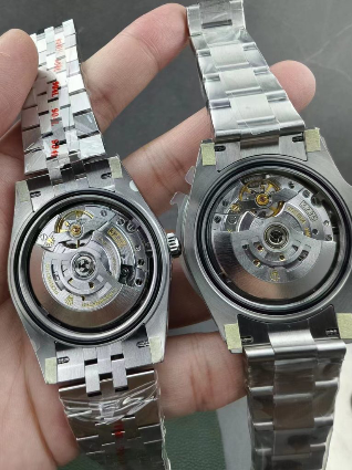

Looking at the picture below, the movement on the left is the new SH3235, compared to VS3235 on the right. You can notice some differences - the new SH3235 has the beat adjuster arm and the regulator arm facing outwards, unlike the old version where they faced inwards. Additionally, the new SH3235 has extra golden engravings added to the automatic rotor.
As per the dealers, Clean claims that their new SH3235 will offer a power reserve of approximately 70 hours with further improvements to its accuracy and reliability.

Interesting. I’ve seen rumors about this on WeChat too. It’s hard to see but I think there will still be an easy way to tell the VS3235 from the new SH3235 — the VS3235 hairspring spirals inward in a clockwise direction, and although it’s hard to tell I think the new SH3235 coils inward in an anti clockwise direction. But that’s impossible to see in these pics and is yet to be confirmed.
Regarding the power reserve, that will only reach 70 hours if SH has implemented a chronenergy escapement (high lift angle and skewed pallet fork). We didn’t see this in the SH4131 but it is present on the VS3235 and looks to be present on the dd4131. So my bet is that the 70 hour power reserve claims on this new SH3235 aren’t true.
