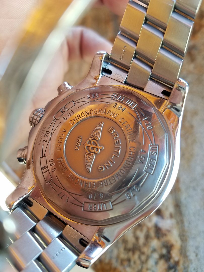

By the way, if this thread isn't sarcasm or a parody or something like that, but actually meant to be serious, taking a computer-generated marketing photo off the Panerai web site to prove "how it's supposed to look like" is slightly delusional. 😂
This is how the case backs actually in real life look like:

That's a stock photo used for advertisement. The genuine Panerai doesn't have a caseback that lines up like that. My gen Omega doesn't line up either.
Even better, the logo on my clasp is slightly off center.
